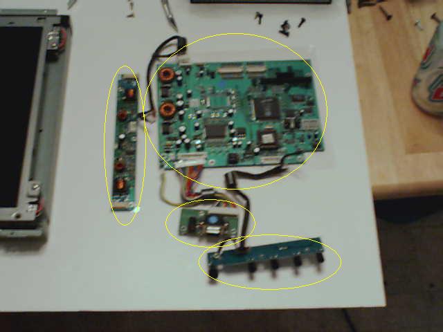

I should have mine today like yours, and i will start stipping it tonight and post pics as i go....
thx.. make sure u post alot of pics and info for whne u get to the specific circuits and how to get them out of the metal panel.. thx

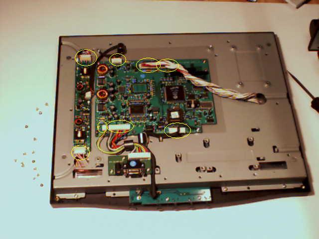

Just get you soe colored sharpies and mark your connector and reciever ends so you know what goes where.
Gives me alittle piece of mind when traveling into uncharted waters.

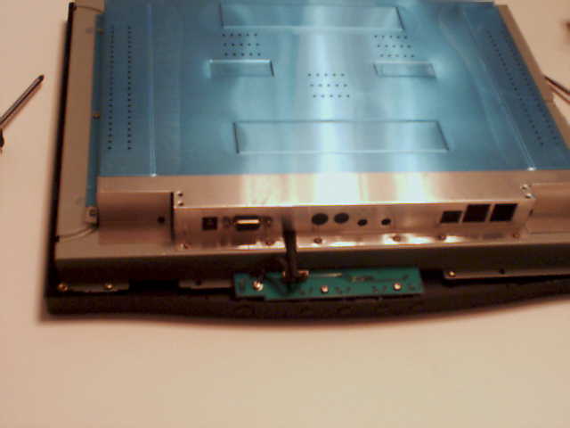

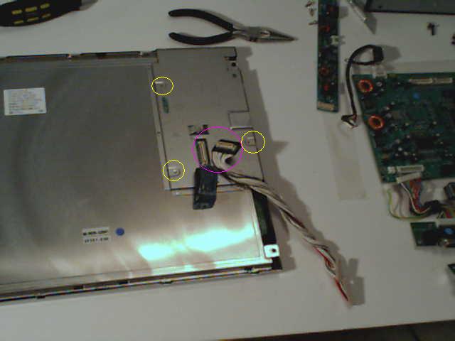

im having trouble getting the screws off in picture number 8.. i got one off but tyhe other two just wont come off
Yea Same here, I got the one on the right off. but had to use a drill and drill out the head and you can tell when to stop because the head starts spinning. also use a drill bit slightly smaller than the head but not to small.

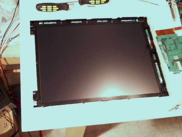

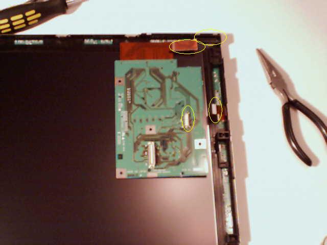

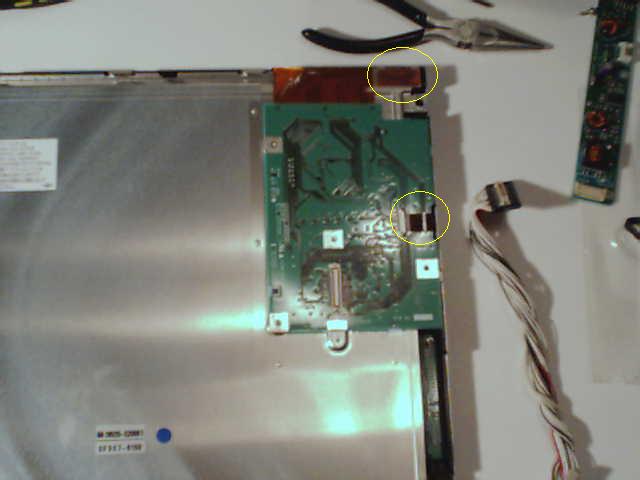

All in All except for the One connector that needs to be extended it looks to be a good one. because of the FFC cable on the side it alows the board to be put at a 90deg. angle.....
