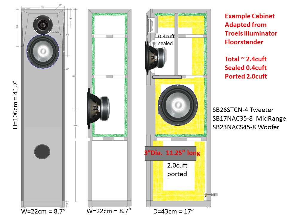

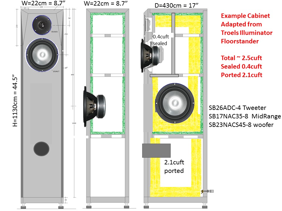

Attached an example 2.5cuft cabinet for a 3-way with 22cm front baffle and 8" side woofer. Can you bi-amp?
SB26ADC-4 Tweeter
SB17NAC35-8 MidRange
SB23NACS45-8 woofer

Phwoar thats still a big speaker... (tall and deep) - I'm fine with the side-woofer thing, and width. - Smaller version possible? I know, a bit of wife-factoring here.
Planet10 mentioning smaller woofers x2, but I'm guessing that doesn't magically lessen enclosure volume need?
Bi-amping... pretty sure I cant. (integrated amp)
No mounting the dali's... for risk of driving a screw into the crossover?
No. If the woofers are similar. Given how many woofers there are you shoud be able to pick one that fits the size you can afford.
But it will dramatically lower the load on the box so it does not to be near as heroic. We have built successful 2 x 10” subwoofers out of 15mm BB. Box can b lifted with one hand, with drivers it is near a 2-man lift.
And if you go sealed a linkwitz transform can be used to push response down, you have tons of power. i’d look at something like 8 x SDX10 or 12 in 4 woofer boxes (~60 litres each, althou i took mine down to 44 litres hich worked fine even without a transform. Different choices in Europe. I did a design for at least 1 big Scan driver.

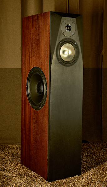

One last look at 3-way side mounted woofer cabinets.
Hobby HiFi magazine has a side woofer design named "scan by side" which provides design and build information.
Scan By Side
The kit is delivered with the following drivers:
- a Scan Speak D2905/930000 tweeter
- a SB Acoustics SB17NAC35-4 mids driver
- a Scan Speak 26W/4534G00 woofer
size (HxWxD): 1075 x 230 x 380 mm
Kit without cabinet, price per speaker EUR 462,00
speaker kits | hifisound.de | Your online hifi specialist

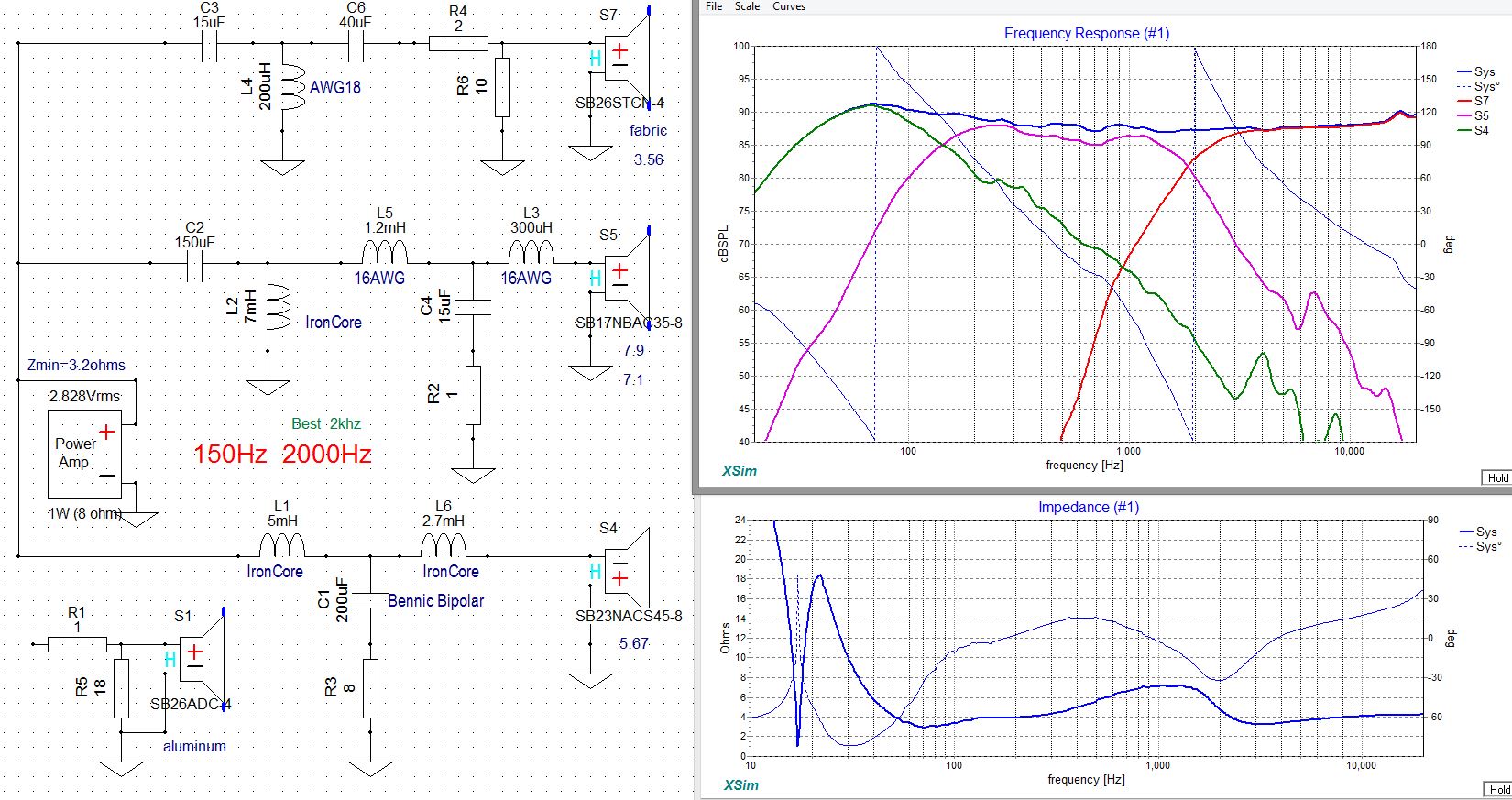

My DiyAudio side woofer design is based upon Troels Gravensen's Illuminator Floorstander construction techniques. You will need to sketch/CAD you final dimensions before you cut wood.
1) Height 1060mm = 41.7" Width = 220mm = 8.7" Depth = 430mm = 17" Total Volume ~ 2.4cuft
2) Drivers:
SB26STCN-4 = 1" fabric dome tweeter.
SB17NAC35-8 = 6" aluminum midrange. Butt tweeter to midrange for shortest C-to-C separation,
SB23NACS45-8 = 8" aluminum woofer
3) To reduce cost, use average quality passive LRC parts, start with Bennic Bipolar capacitors for large(150-200uf) values. Research bi-amping options.
4) Includes 2db of baffle step to compensate for adjacent room openings
If you feel you must reduce the cabinet depth, I can calculate the new -F3 and port dimensions

I did a bit of a mock-up with rulers and cardboard... - thanks for the suggestion Moondog55. And I have to say that my previous estimation of available space was a bit optimistic
Linesource: Your suggestion is unfortunately still way too big, I really appretiate it though. - Once I saw a real mock-up it was pretty clear it wont work.
Not entirely sure what path to take now, I did however buy some lovely wood for the front bezel for when I do decide, cause why not impulsebuy! 🙄
Perhaps the kit mattes suggested is the best bet still, both for ease of first build, and size.
