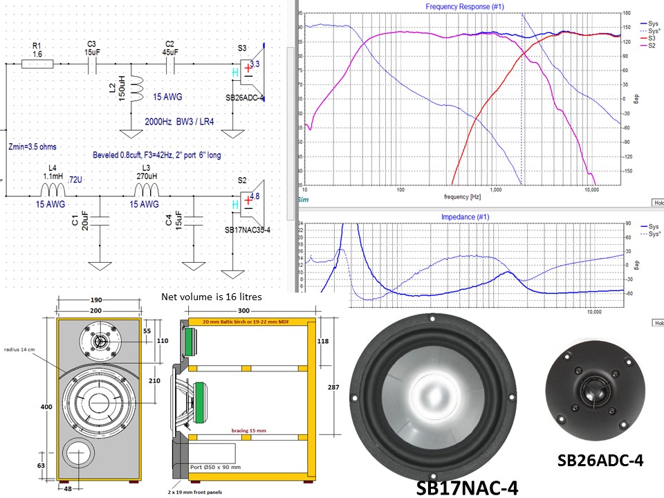

This two way design uses high rated SB_Acoustics aluminun cone drivers in a 1100mm tall cabinet to put the tweeter at ear level and extend bass performance.
SB17NAC-4 6" midbass
SB26ADC-4 1" dome tweeter
$200 for drivers + crossover parts
200mm wide x 300mm deep x 1100mm tall
2" internal diameter port, 6.7" long
- or -
3" internal diameter port 16.2" long
- or -

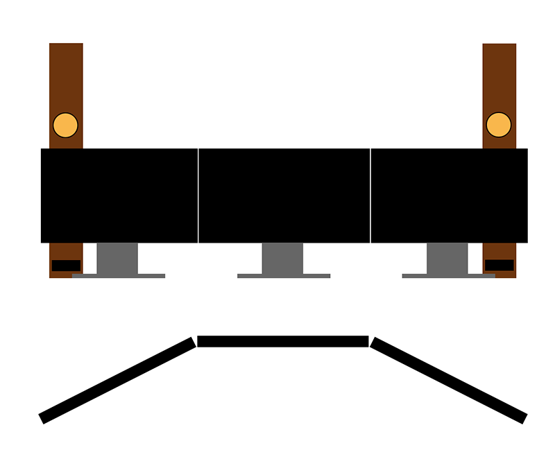

Crazy thought! Could one have a table standing mini/midi-esque tower? I do a lot of music listening in my office/playroom. The problem is I have 3 screens taking up a TON of space side to side.
Would something like this be remotely viable? - size not to scale but to get the general idea... black lines at the bottom is just to show the screens are angled. - bear with my quick mock-up 🙂
I know this is sort of off-topic of the original idea, but it just hit me that maybe it would be better than my current setup, both ergonomically (I want to move my screens further back) and speaker position (no position, basically). - I know this is still a big compromise compared to anything "good" setup-wise (worried about screens being in the way).. but could it work? Feel free to hack it down if it's a terrible idea.
Sorry starting to get all crazy - I guess my idea of what I would like to try is changing. :innocent:

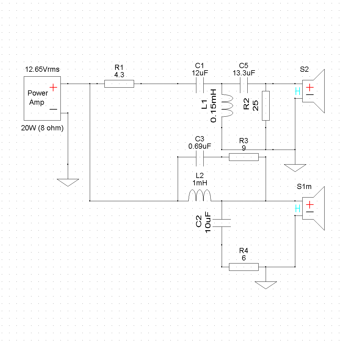

You could build these for $200 if you like. Cheap drivers and a very simple, low cost, low parts count crossover. Can't get much slimmer than this. The woofer works well in small sealed to medium-size ported enclosures like this one. Listening axis is slightly above tweeter and box is kept short for this purpose.
Woofer: Peerless 830657
Tweeter: Peerless/Vifa XT25SC90-04
Box is 164mm wide from edge to edge.

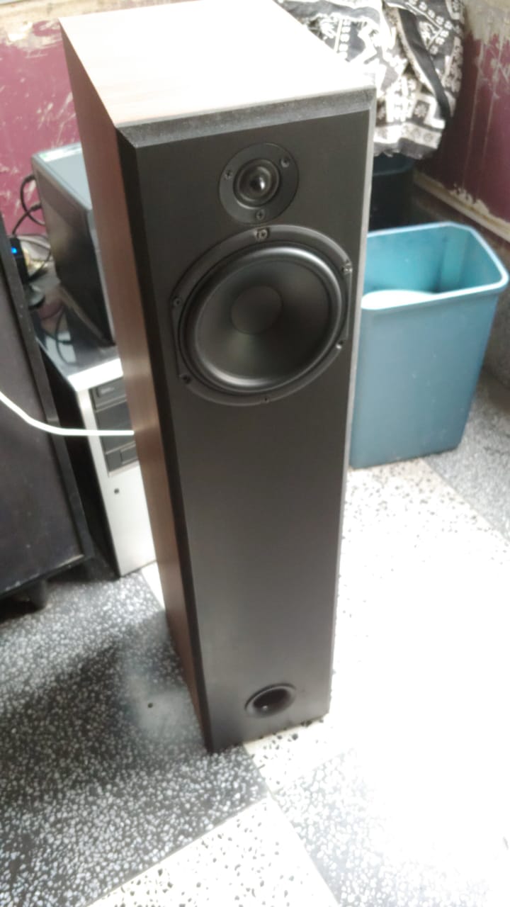

You can find a crossover and the build plan attached. Crossover isn't fantastic because the drivers are a little difficult to work with, but the sound is well-balanced.
You really need to watch the power in this box - the driver will hit its excursion limit with as little as 2 watts. For listening real close (like a couple feet away) this is not an issue.
If you need to sit a little further away you will want a bookshelf enclosure (sealed) and cross over to a sub. The driver used has a good amount of overload capability and I could not hear it in distress for even loud levels from a 4-5 feet away. But YMMV, all rooms and all people are different. Also, the crossover here isn't suitable for a small box or for listening at a distance.
The one mistake that I worked out after the build is that the port hole is 75mm diameter, but the tuning calls for a 75mm port. Tubes for a 75mm port require a 78-85mm diameter cutout. 8.5 inch depth may also be tough to fit into the depth of the box so you would need an elbow or make the port downfiring. You can downsize the port to 50mm and then you only need a 84mm deep port, which is what I ended up doing.
Similarly, the cutout for the terminal cup at the back would depend on what you are using.

Jinxid,
Has your education & research advanced to where you can decide between a <$200/speaker 21cm baffle 2-way ported midbass design, and a <$300/speaker 21cm baffle 3-way design with a sealed midrange and ported side woofer?
-OR- do you favor another design path?
