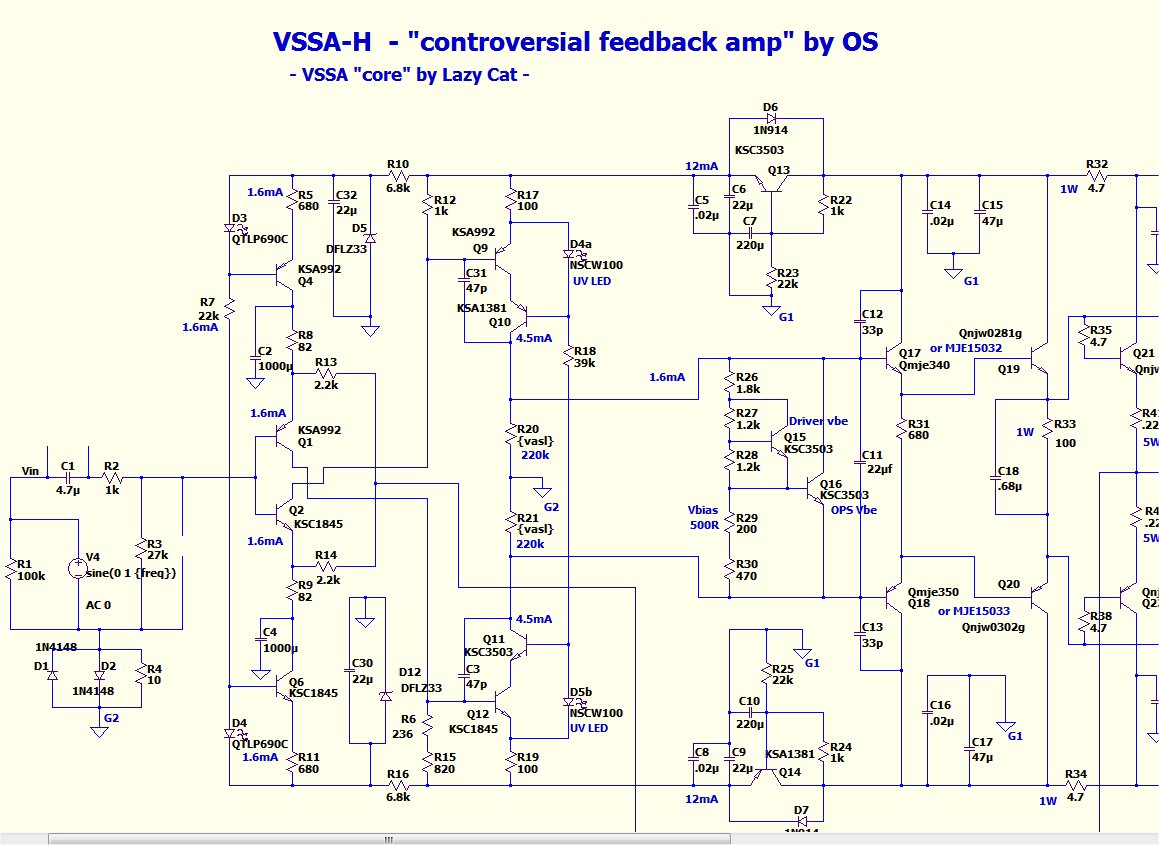

I did not see any pictures , BUT ... with 50-60 V rails , the monster
could most likely do 1 -2R . Especially using the rail busses and
semitech MGxxxx BJT's.
This one is designed for it (outputs as drivers) , this is the "key". 😀
ps - being a triple EF sure helps , too !
OS

PS- here's the monster !! (copper is fine) ... screen labeling is unfinished.
OS
Y'all realize , in a 250mm (10") PCB , I could get 6 pairs for this OPS !
Same performance , more power.
I calculated that about 8 pairs OP/2R would finally approach the SOA of a single
pair of NJWxxxx drivers running at 75V. 😱
This is real , not "best case" !! (not a "toy" , either)
OS

That would not be a "gamble" either. Both the Slew master/monster are the
H/K 680 OPS "in the flesh" .... the only "tweak" that I foresee would be
the use of the NJWxxxx drivers. H/K uses 2sc4793/2sa1837.
The secondary vbe might have to be tweaked to thermally offset
the larger/ lower hfe drivers (resistor value ratio change).
The H/K will stay 1mv Re from -0C to 40C - the most stable EF3 Vbe
I have EVER seen !
Also , whatever IPS I splice onto it ... max performance (PPM everytime).
OS

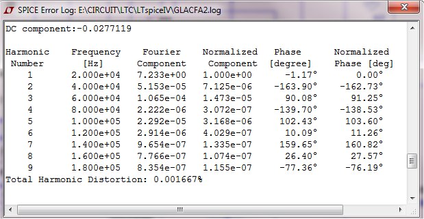

You like the VSSA ?? Ha ha
See it on "steroids" below.
110V p-p/ 3R load running on the EF3 !
OS
