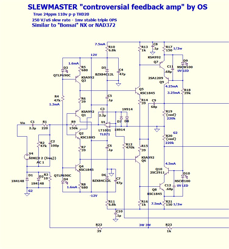

Just use DIP footprint, not SMD. When everything is TH we don't need just one part to be of microscopic dimensions. I think LF411 is good for the job too.
TL071 .... $.62c
below is the damage ...
Same # of parts , did not need the IC Vcc diodes/e-caps ... just used .1u decoupling caps
at the IC Vcc-/+ - left the protection diodes at +/- IC input.
With a Jfet op-amp , 680k input resistor (real high-Z) ... smaller integrator
cap -2.2u.
Simulation is 20ppm 10hz - HF (much cleaner LF!)
No trimmers needed.
Improving the amplifier with current sources penalized me with "resistance"
to manually adjust offset. A resistive loaded Diamond would be easier to
adjust with a trimmer.
The NX (I was told) ... will start at 15mv and settle with time to 1-2mv.
This one will stay <1mv- regardless !!

Can a servo be "tricked" ?? Going from 0V, (no signal) to a 20-200hz full
power (120Vp-p) signal ... the first 2-3 waveforms are offset at .1-.2V.
After 4-5 cycles , all is well at the <1mV range again.
This "settling time" only happens at LF and with a large transient at LF. It is caused
by the charging of the integrator cap C3 at U1. Reducing this cap brings LF
rolloff up into the audio range.
2.2uf has rolloff of about 5 hz , 1hz is down 15db.
For this design , we are nearing the best quality to price ratio. DON'T
let a small IC scare you. As I have stated , the ne5532 servo in my
japanese unit has been "servo-ing" for 33 years. 😀

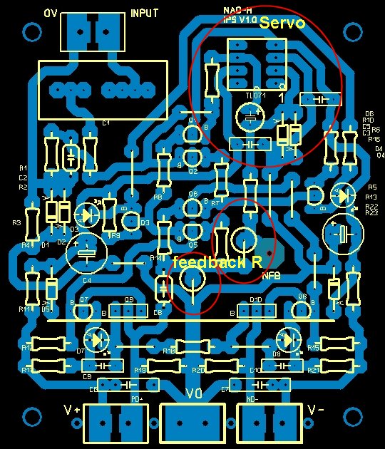

Is tripper, please look at the front end I posted, there you see a less signal intrusive way of implementing a servo.
I could not find it ... link please ??

OS, what's that resistor you are using?
You mean the thick film 25 watter. Bob "turned me on" to these.

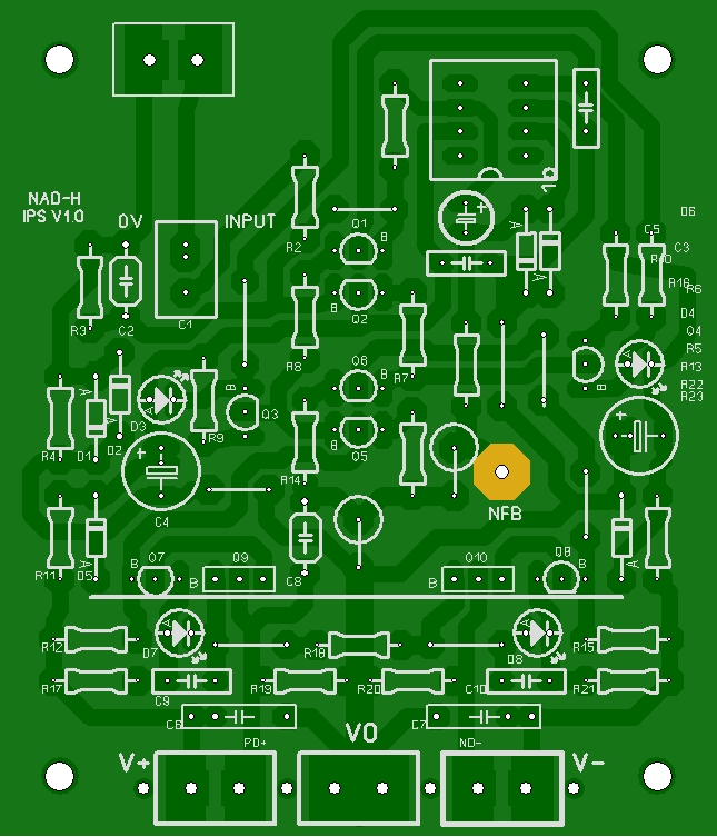

BELOW... 300dpi .bmp for printing (copper) , schema , and silk/parts (topside color). "Slew-OPS" is the EF3 and "Slew-nadH" is the IPS.

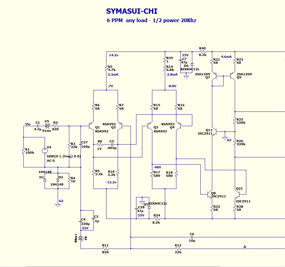

"SYMASUI-CHI"
Thank you !
Please check out above artwork and material. It could have bug (s).
next is wolverine and "symasui-chi " ,
a unique blend of many designs .....

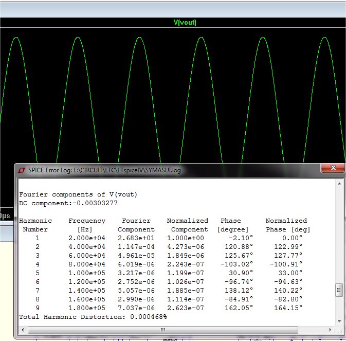

Part Symasym and part sansui , this "MONGREL" 😀 is a beast.
Belts out PPM THD and is so simple !
First installment "AMP of the day " saga .... ha ha
(I have 100's)
Later I will post .ASC for this little gem and completed CFA-nad "slewmaster".

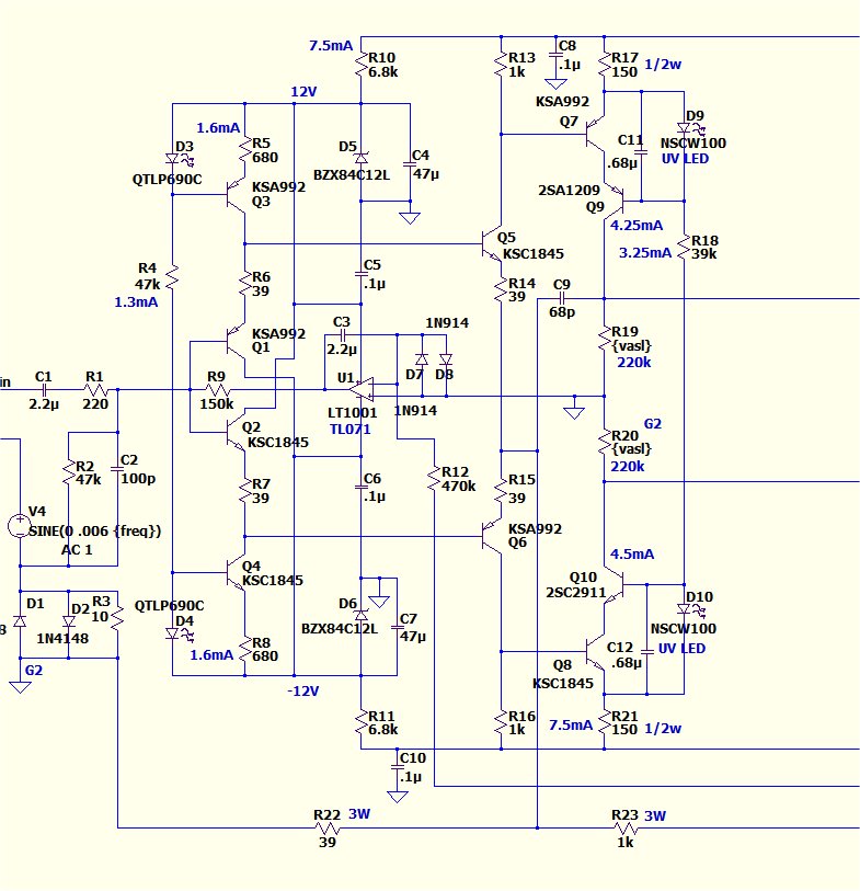

Please check connection of R110 on your PCB (Slew-OPS). Is it different from your schema?
THANK you !!!
It would of worked with that mistake - but not as well . Now R110 goes from
emitter to emitter (Q105/106) and now R111/112 JUST go to the driver bases
(Q107/108).
I added the stoppers later in the design - my mistake.
ALL fixed - "Slew-ops-V1.1" 😱 .
AND ... added a cap to the CFA "NAD-H" servo.
Both are below , any more errors - please tell !

Revelations !
I looked at the akaido headphone amp -Aikido SLPS & Hybrid Headphone Amplifier
...and many other diamond buffer based power and headphone amps.
They all use the inverting integrator DC servo (as my circuit does).
A "trick" to improve operation is to increase R9 to 470-680K on the
slewmaster IPS. AC is down into the nanovolts from the IC ... you would most
likely see worse on your "clean" ground rail or supplies.
The IC has to increase the DC at this point which makes the "settling time"
of the servo less , as well as being a more accurate at LF .

"Tuned" the Servo !
Never used a servo before. Looking at a lot of OEM ones -
equal resistance between in/out seems to be the ticket.
They all use the 1uF integrator cap , as well.
(Below)-is the best that can be done ! (nV static) 😱
PS - noise is from the amplified Diamond buffer.😀
Another revelation .. one could buy 8 of these op-amp's with what a
big cap and precision trimmer would cost ($6.30usd).
