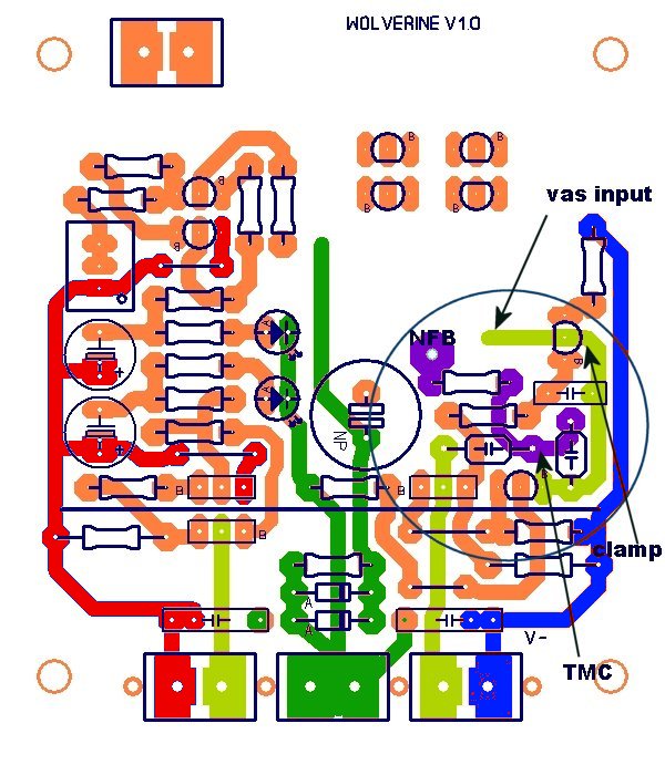

OS

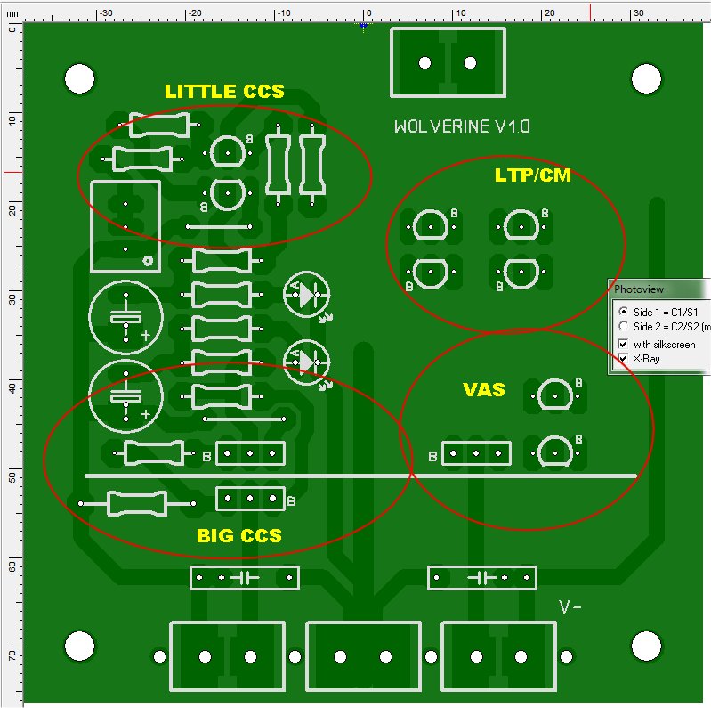

Wolverine is evolving ...
Put to the CAD , the layout is immaculate (below).
On the smaller 75mm X 75mm standard - plenty of room to be
"anal" .
Each section of the amp has it's own "real estate" , CCS's together
share the positive side of the layout -VAS the negative.
Below the VAS heatsink , all sensitive TMC (compensation) components will be
very close to the VAS (B-C) .
With these IPS's , the full OPS signal will be brought right to the board ...
so the NFB pad will be further away from the LTP + "guarded" by ground traces.
This means the DC cap , and the FB divider will also have a separate piece
of "real estate" separated by several mm's from either the mirror or LTP.
The "wolverine" should run in the same pack with cousin Badger.

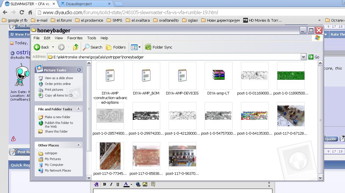

what i like in OS designs is that they are mostly single sided so that a diyer making his own boards can do so easily...
i am old and hands are not as steady as when i was younger so that OS boards are very doable for me....
I already have PCB's in hand for such a beast - the TGM7. I haven't had time to build the CFA version, the VFA is up and running. I'm hoping 'Pinnocchio' will be able to help out - I sent a pair of boards recently. It has both variants on a single pcb with very very few differences between the CFA and VFA versions. Once I have built it I'll let you know what I 'hear' - I assume the more the merrier when it comes to collecting our experience on this topic.
thanks for the heads up, i got involved in the badgers when someone bought all parts and gave them to me to build for him, i am hooked...
i am sure your project your project is likewise good, just that smd scares me at the moment...

Wolverine "fine tuning" ...
The VAS and the TMC compensation is the "foundation" of the famous
"blameless sound".
The layout is crucial ... since the main pole of the amplifier is determined
here , short traces and "compactness" is required.
(below) .. The 2 silver mica caps are VERY close to the beta enhancement
and main VAS device . The feedback resistor from NFB to TMC is also
VERY close. A long trace here would possibly add parasitic C to the "mix".
On the "wolverine" , a saturation clamp is also employed. It's traces are
also " anally" short ... as it is a "full partner " in this close tolerance
section of the amplifier.
Now , we are down to the LPT/CM ... No issue here , just separate it
with a couple centimeters of board space and run direct V- to the CM Re's.
The LTP is "set" with the "badger style" 2.2K resistor from the small
CCS.
Input will be standard fare ... referenced to the lifted ground (green traces).
This will be the most fault tolerant of the "blameless'es" , able to
even allow for 1.5mhz unity gain operation with VERY good 78 degrree
margin (super stable - below 2). In the simulation I used 220p/47p/1.5K for the TMC.
All this with E-waste or $.30-.70c mouser semi's.
VFA - VFA - VFA ..... Let me hear a - VFA !!!

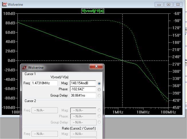

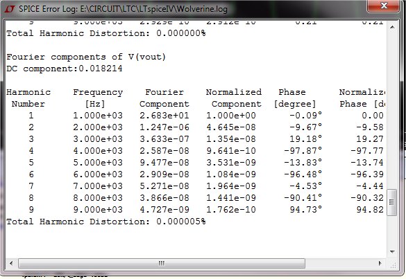

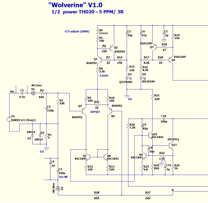

Broke the "record" with this one.
1Khz nearly full power - 3R load (below).
Doug Self would be proud ...
PS - I suppose that's why it is "blameless" ??

I have a question if I may, and its over how much confidence you can have in all of these results (generally, I'm not just singling this one out) ?
My reason for asking is this. Manufacturers of small signal opamps (vfb I know but the principle must hold true) always state in the data sheets that the distortion of 0.0000xxx of a particular device is below the measurable limits of any available measurement equipment. To get a real measurement the distortion has to be artificially raised by manipulation of noise gain (let the amp amplify its own distortion). Only then can the amp as a whole be measured and and a distortion figure arrived at. That all has to be done on a real device, not a simulation.
Does component matching play a big part here ? In the simulator all semiconductors (and all like parts come to that) are carbon copies of each other. If you hand matched real devices you would be lucky to get within a few percent of a perfect match. I've often thought it would be a good idea to have a set of devices in simulation that were "the same" but "different" by perhaps 5 or 10% in various parameters. When you sim a design you randomly pick from a list of say 10 possible versions, each "the same" within say the 10% figure of a reference device of that type.
Here you seemingly have power amps offering figures that on the face of it are truly remarkable (and then some) considering they are delivering serious power to a low impedance load.
The killer question and proof of all these is whether anyone with access to equipment capable of distortion analysis has actually tested one of these designs and seen how it compares to the sim.
No special matching , in fact ... once you reach a "sweet spot" in the bias
of the CM/LTP/VAS , this particular design does the rest.
The layout of the PCB is the final key to approaching what the simulator
tells us.
I do "cripple" the simulations slightly with C/R/L. A mismatch in the CM/LTP
would give me mid - double digit PPM (30-50) ..A VAS-OPS mismatch would
only affect offset.
So , I you used a curve tracer on the LTP/CM devices ..
I would say you could come REAL close to sub PPM with this design.
A hefty power supply
would also allow for PPM into high power.
Electrically , I have simulated countless real amps (for repair/troubleshooting)
... the models/simulations are within percent(s) of the real amps.
Shorting out one device on the simulation will tell me what other devices are overcurrent ...
and "fried" (did this on the "badger build thread").
It is just a very powerful "tool" .... same as a DMM/scope/iron .

Very good, what on 20k?
tells us.
only affect offset.
OS
