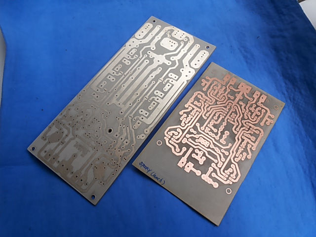

I thought you had the boards at 100mm width. 75mm works for me, much better, won't be the problem I wrote to you about. Ya!
On a NJW0302/0281 about 23mm (15/16") between where you
bend the leads to the top of the device.
13mm between holes and edge of board ... leaves 10mm of
OP extending beyond each board edge.
10 + 10 + 76.2 = 96.2mm ... you need 3-7/8" wide (tall) heatsink.
A 3 or 4 U heatsink/chassis ... will work.
With the ops/ips 90 degrees 177mm long OPS + 20+mm for the IPS.
A 200mm deep heatsink is minimum. The 250mm HS would be better ..
as it has a better C/watt rating.
One this big would be larger than BOTH HK990 HS's 😱 .
PS - Op hole is 5mm from top of the device 2X5=10 96.2 -10mm= 86.2mm
( parallel holes on the heatsink) .. roughly 3-1/2" apart ...
Edit - I would make the holes 88-90mm apart - the bends in the OP leads would add a
couple mm to the distance.

OS How far away are you from the Protection circuits etc. I am not pushing, just wondering...You have a lot on your plate and it has been a great edumuncation just looking and kibitzing and seeing the amp design process in real time. THANKS
Last steps on this NAD-S vers.1.2.Small progress in NAD-S ver.1.2.
Ostripper can i use 2sa1015 and 2sc1815 in this input stage?
Best regards.
Thimios.
It's time for cleaning and testing this ALONE.
I manage to power this with +/- 20v .
Ostripper what dummy can i put after this?
What about the feadback path in this first test?
Thanks.
