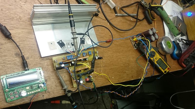

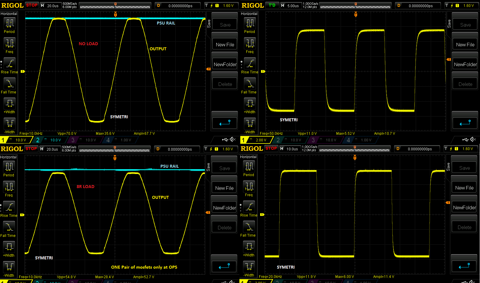

Continue on Symetri IPS.
I have only one par of mosfets for now (on order a few pairs), double bootstrapped mosfet OPS swings nicely nearly to rail.
No changes at all made at the IPS board (same as for BJT version). Looks stable on the scope. I will do some more tests next few days after I will get more parts.
Basicly very nice IPS board from bimo factory. Sounds nice, clips nice, speed is nice and looks nice 😀
Regards
Regards
Borys
What model Scope is that you are displaying your very NICE work on? I was thinking of getting a newer Tektronix but your overall display is VERY impressive to say the least.
Borys
I'm not Borys, but they appear to be screen shots from a Rigol 1000Z series scope.
That Rigol scope is very popular right now, up till recently there was nothing on the market with as many features in the same price range.
Only very recently have the other lower end companies have come out with comparable models. Such as the Instek 1000B series and the Siglent SDS1000X series.
