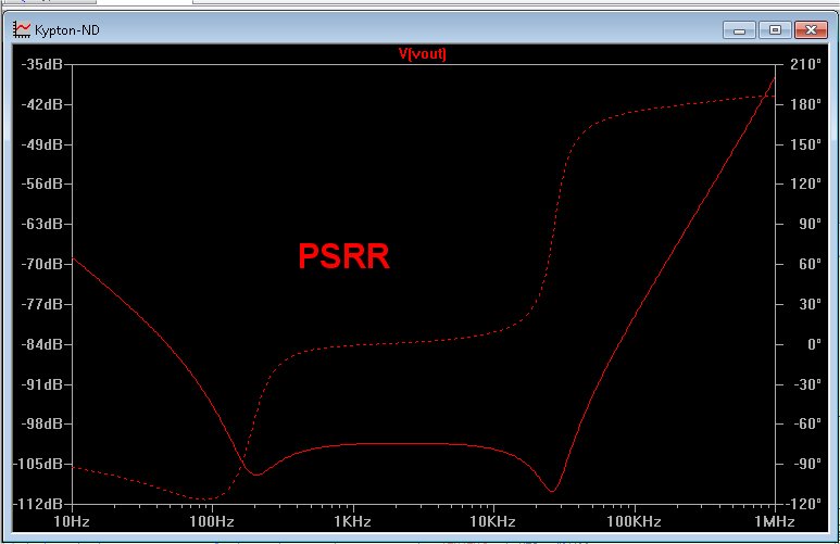

On my side , I don't have a VFA that comes close ... except the wolverine
at 20K.
Only a couple VFA's that exceed the psrr .
(below 1/2).

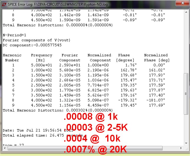

I have NO VFA or CFA that goes sub ppm from 500hz to 5Khz (like the ND).
Some serious cancellation of distortion going on here !
OS
Ohh ND, so you learned some Housekeeping tricks, still The VAS driven cascode has super gainn, so you end up with a greatdeal of feedback and Very very Good data, apart from The VAS, this is very close to my latest CFA, still the base performance and drive of the music will be better in the Leach types.
You really need to try the IPS, I showed you (and you improved with a driven casode) that one is the fusion of good's
