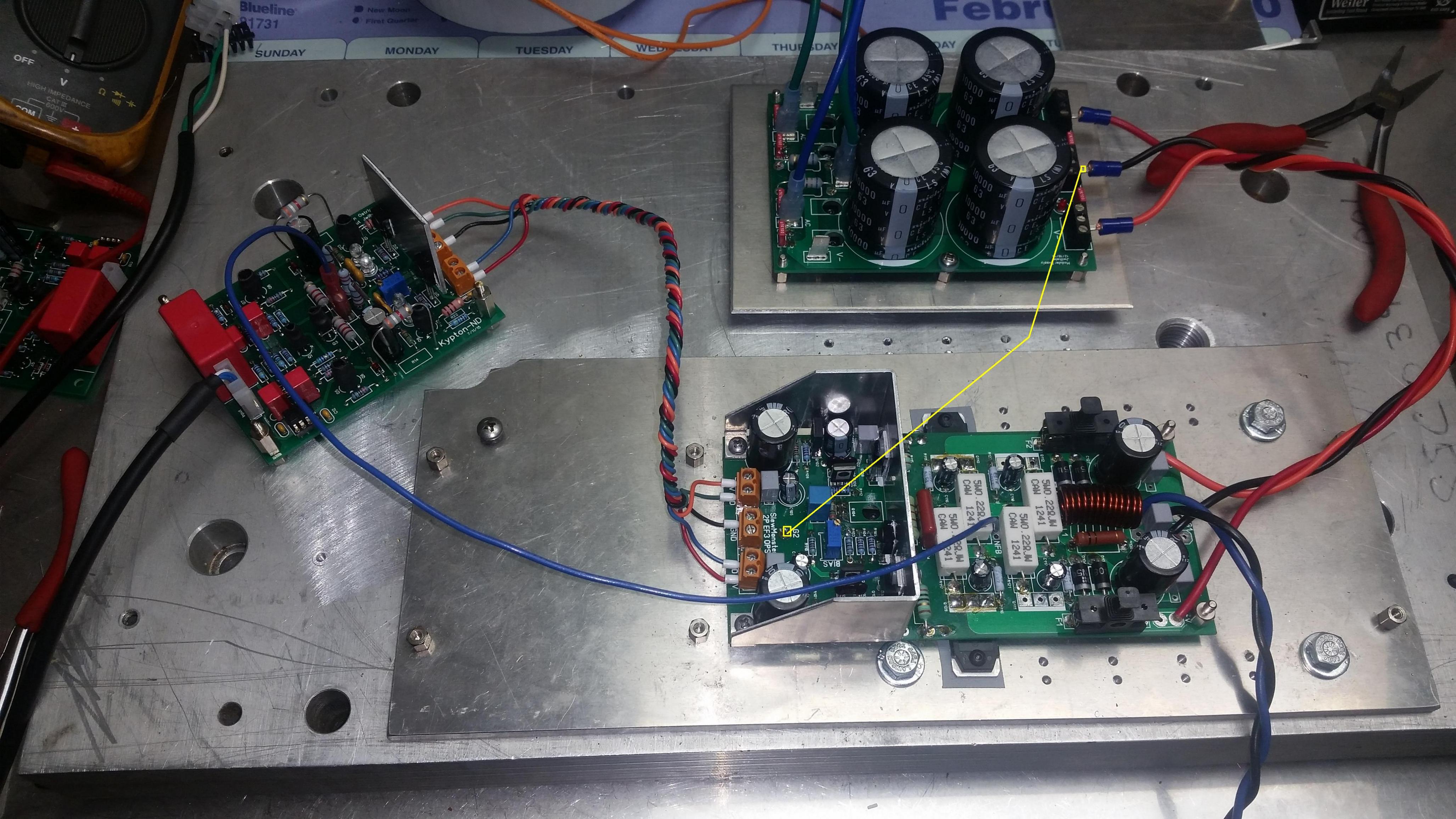

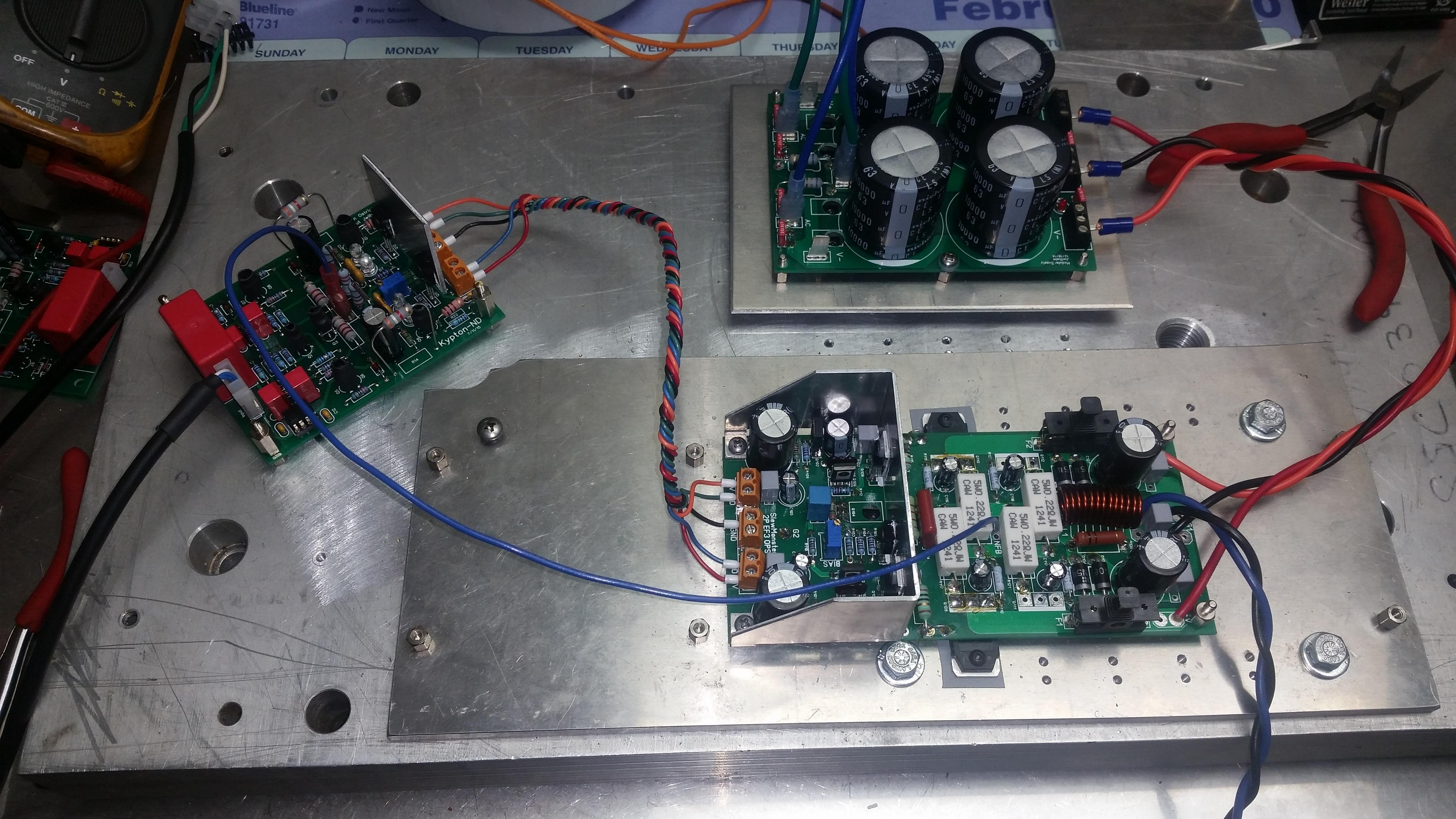

I took a break from the DAC and assembled a set of boards. My tester output board is getting rough. The zobel resistor smokes badly above 50kHz but the input seems flawless. No listening test yet but the board layout seems good. I'll shuffle some parts around a bit and touch up the silk screen, then send the files to Evan.

What IPS used?
Edit:Now i see,Kypton ND.
I can't see G2 to star GND.

In all my test G2 & speaker return connected directly on star GND.
My heat sink never connected ,open frame😀
That's how I did my finished amplifier too. This one is connected the way Jason recommended. There's a couple different theories on how the speaker returns should be run. Some say they should return to the amp board and back to the supply with the rail feeds.

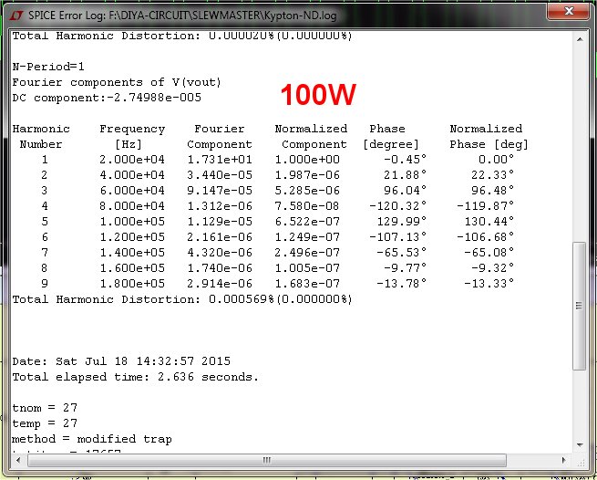

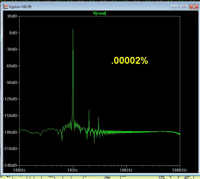

I'm in to but first need to be tested and compared with some earlier version IPS.

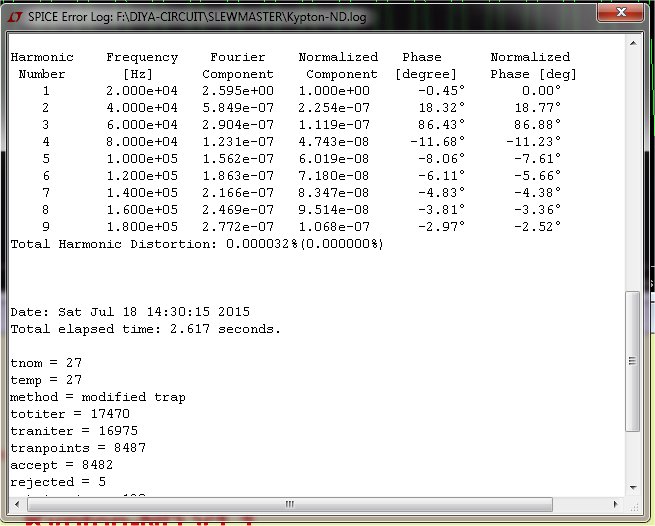

It was tested with the sweetest clip and square wave results.
It's "weak point" is >100db PSRR versus a spook or wolverine >120db.
Servo and 20hz THD is also <1ppm - It should be very good for LF SQ.
(below) are it's strong point(s). Unmatched low THD with the right combo
of feedback and compensation values.
The IPS layout would most likely make for those last parts per million.

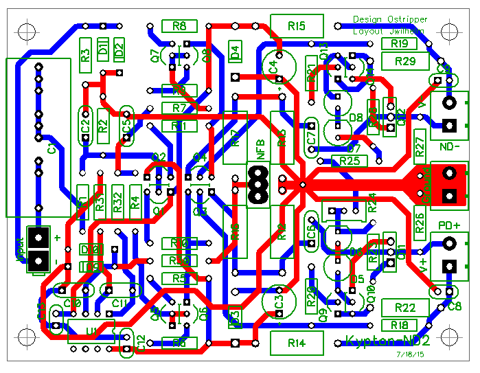

(Jeff !!!! ) ... Edit - show the tracks ....

I'll send you the files. It's tough to see in pictures.
I can't think of any changes besides fiddlin' with R18/19 to get the right
Ivas. Ivas can also be adjusted by R4/7.
C3/4 could be larger/smaller , as long as some reasonable value is there
(22-100uf).
Current feedback network could have a different value to a degree ,
if the 25:1 ratio is heeded. The 2 main compensation caps could also
be 22-47pf.
Any combination of these tweaks would just make "perfect" slightly more
or less "perfect". This IPS even has a wider tolerance than a symetri
or spooky. The last posted schema is 2-7ppm 20K - this IPS matches
the wolverine !!
OS

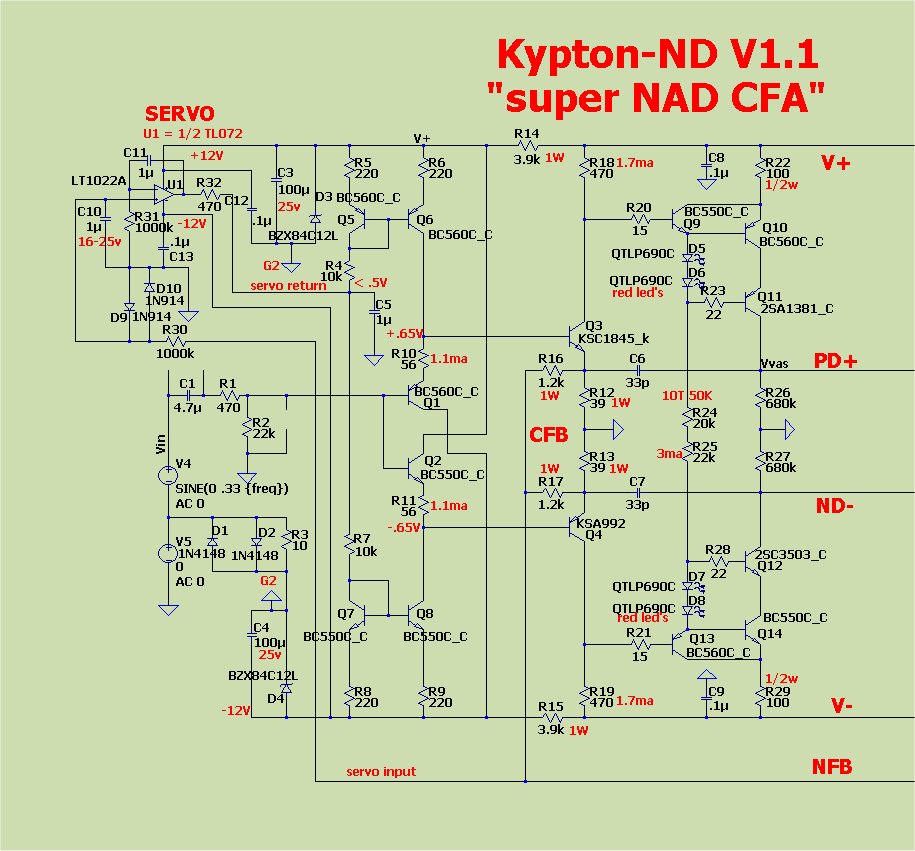

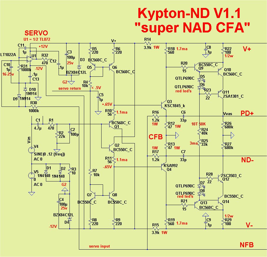

Hi Pete,
Is this the latest schematic?
Damn close ...
(Below) What I just got all <10ppm out of.
R18/19 might still need changes to get within the 5.3ma Ivas target.
If you get within 2ma of that , R24 should get you the rest of the way.
8-9ma on R22 will give a perfect 5-5.5ma output.
Thimios had no overshoot on C6/7= 33pf , 22-27p might be possible.
An amp like this would be >350v/us !
OS
