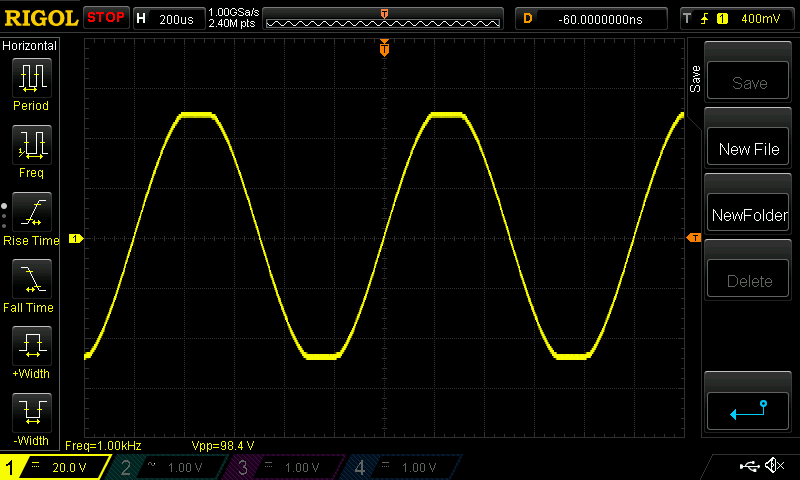

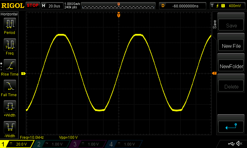

I got the symetri IPS up and running (a bitt differend values).
The bad news for bimo is that there is nothing to measure, the distortions are very low 😀
The distortion profile is changing with output power. Clipp is nice and soft, squares are nice, the VAS is running a bit low (9,2mA now), the LTP are at 3.7mA total. I will have to make a small adjustment and do some more tests.

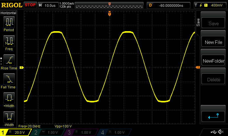

Hi Peter,
Did you try clipping it at 10khz? My clipping profile looked perfect at 1khz but at 10khz it gets a little funny looking. Just wonder if yours does the same thing.
Blessings, Terry

I am doing measurements in ''home made'' way so the may be not accurate but it is good enough just to confirm that amp is working without some hidden bugs, card is EMU 204 at 24bit/192k.
Terry
The clipp is OK at 20kHz. Bellow 1k 10k and 20k clipp.

I see the 20k negative "sticking". Not as bad as a blameless , not as
good as a ND.
Symetri clamps saturation down to a mA at the VAS bases. ND VAS
fully shuts off at this point (nA at bases).
So the current you run the input differentials at would determine
how much an effect this has on the resulting "clipp" (sticking).
I actually can see this behavior on my simulator.😀
PS - this is the compromise for having only 10 devices.

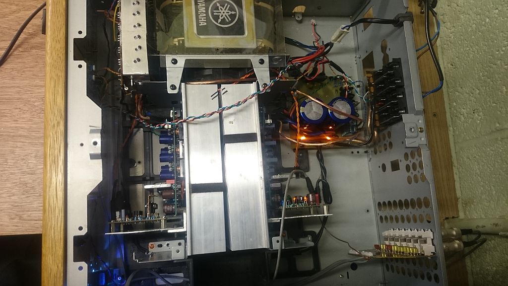

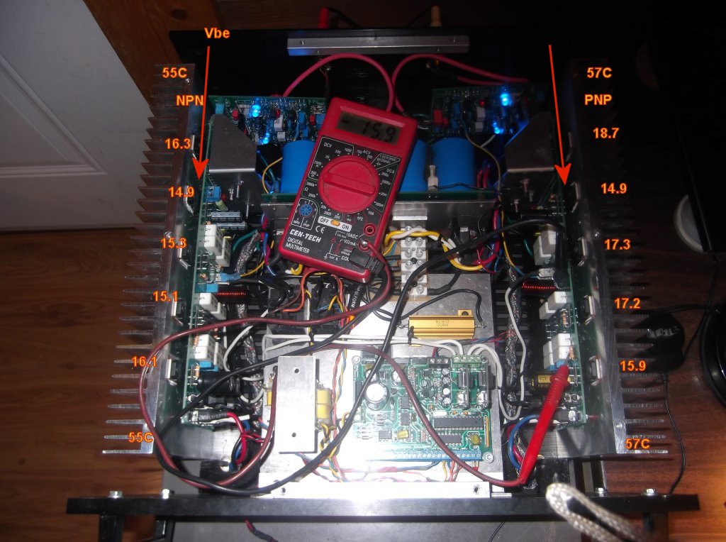

Borys , I'm now satisfied that the new OPS is ready for the test of time.
(below)
I really don't think a V4 is really needed.
I've just abused this OPS more than a normal user would in a year.
20-35C ambient and 20-57C extrusion , it keeps on tickin' ...
I left the worst unmatched "hogs" on the PNP side to see what hot
would do .... NOT an issue.
PS - your Yamaha e-waste makes a good shop amp !!

The DIY OPS is really bullet-proof. Temperature transfer with V3 is really good and it saves a lot of room in enclosure. Maximum performance in small box. The output transistors can be really abused a good bit, in real life they can survive a bit more than is written in the datasheet.
You can solder Symetri IPS in free time, sounds really good.

With the 55C and 57C end to end , I don't see how any more heat could
be transmitted to the room. Bottoms are >50C , but this difference is
either P or N. feedback will even that out.
Even running my 4R sub on one channel , still <60C.
You have a V3 , too ??

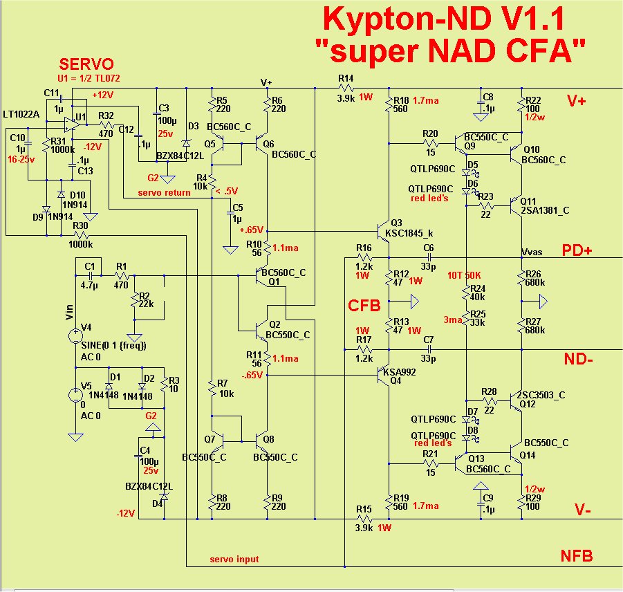

Post the ND schematic please, in free time I will try to solder it.
THX

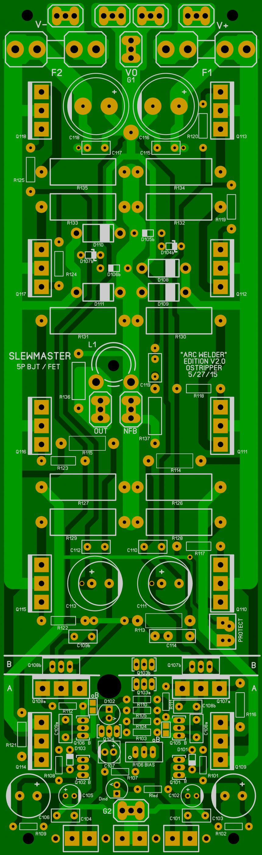

Did you do a new layout for the latest ND?
No , brother Jeff (Jwilhelm) did. After I try them ... maybe a "preferred"
IPS to go along with this "sweet" OPS.
Maybe jeff has some more ??

Is C2 supposed to be left empty?
I'm building up a Pitchfork DAC right now, but hopefully I can have the Kypton-ND up and running by the end of the weekend. If it's all good maybe that could be Evan's next group buy.
Sorry I forgot C2 (testing 350V/us slew 😀).
The amp would actually work without it , but might amplify AM broadcasts !
C2 can be 100-220pF.
