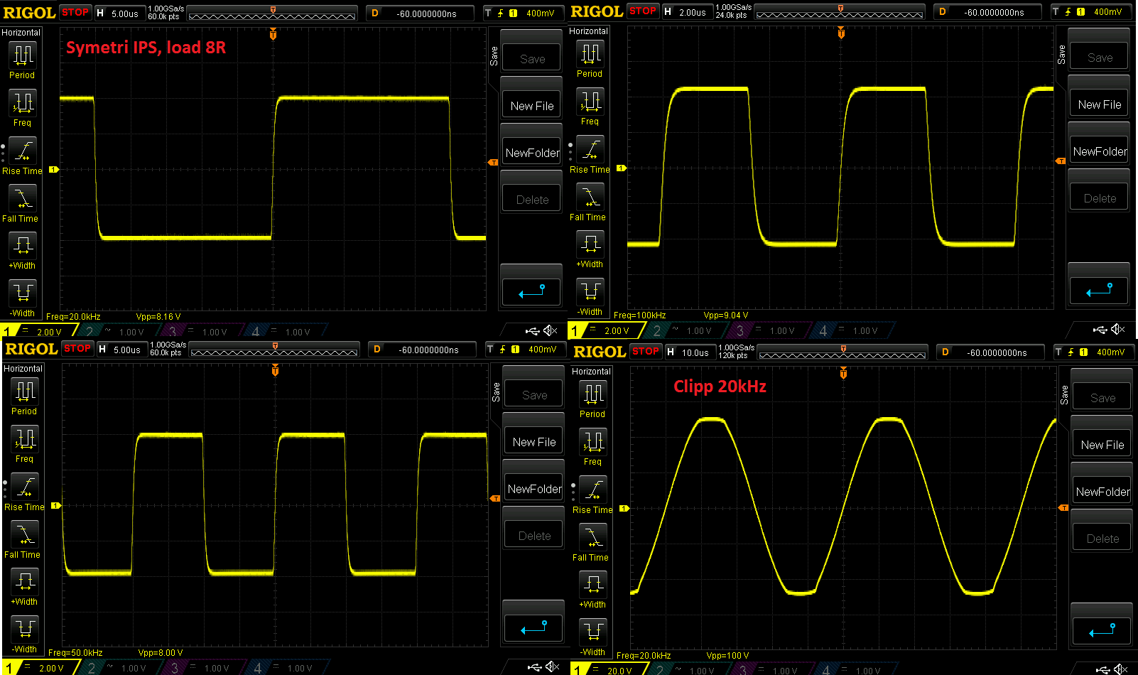

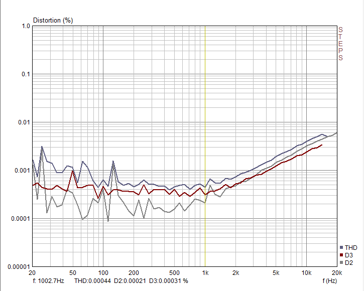

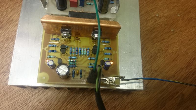

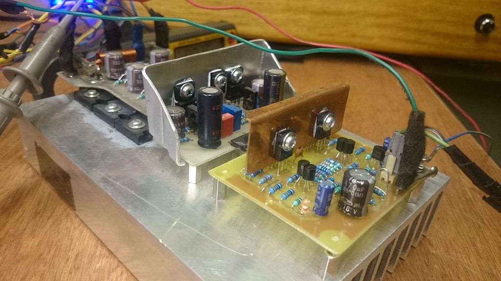

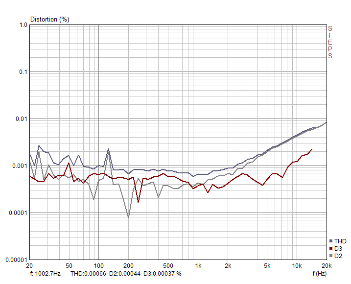

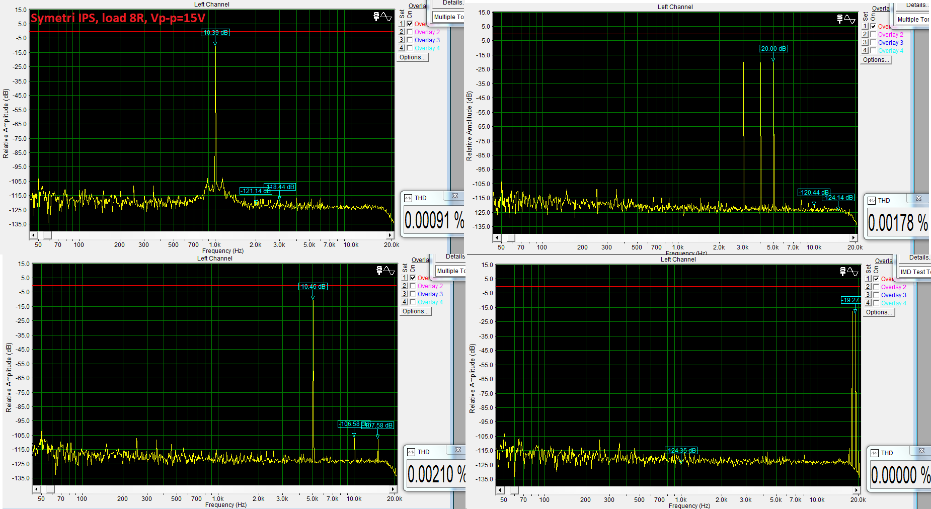

I got the symetri IPS up and running (a bitt differend values).
The bad news for bimo is that there is nothing to measure, the distortions are very low 😀
The distortion profile is changing with output power. Clipp is nice and soft, squares are nice, the VAS is running a bit low (9,2mA now), the LTP are at 3.7mA total. I will have to make a small adjustment and do some more tests.
Nice work bimo !!

Thank you for the measurement. I see D3 is dominant until 3kHz. I don't know this mean something.
What about listening test?
