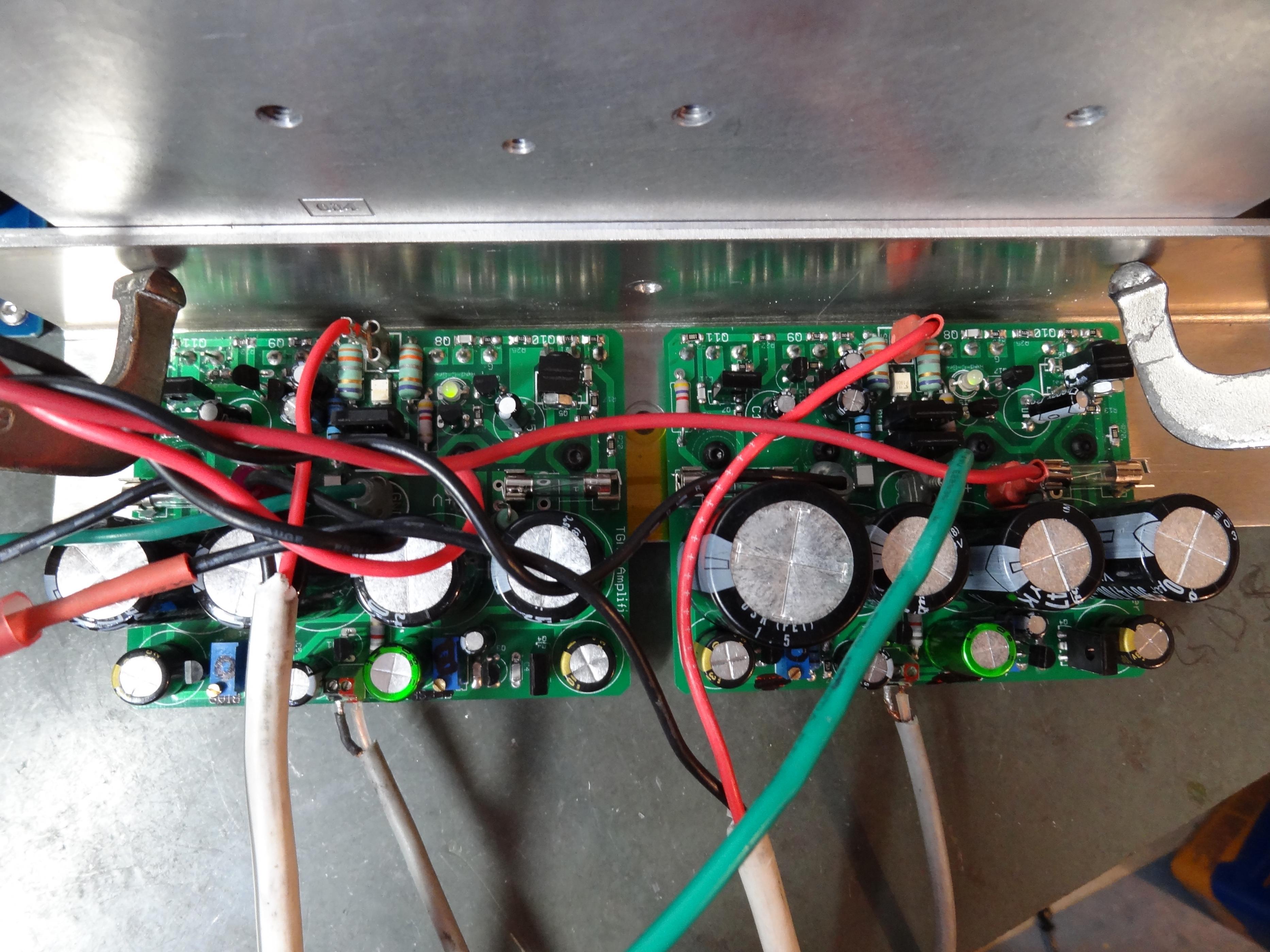

My KRYPTON...weekend test

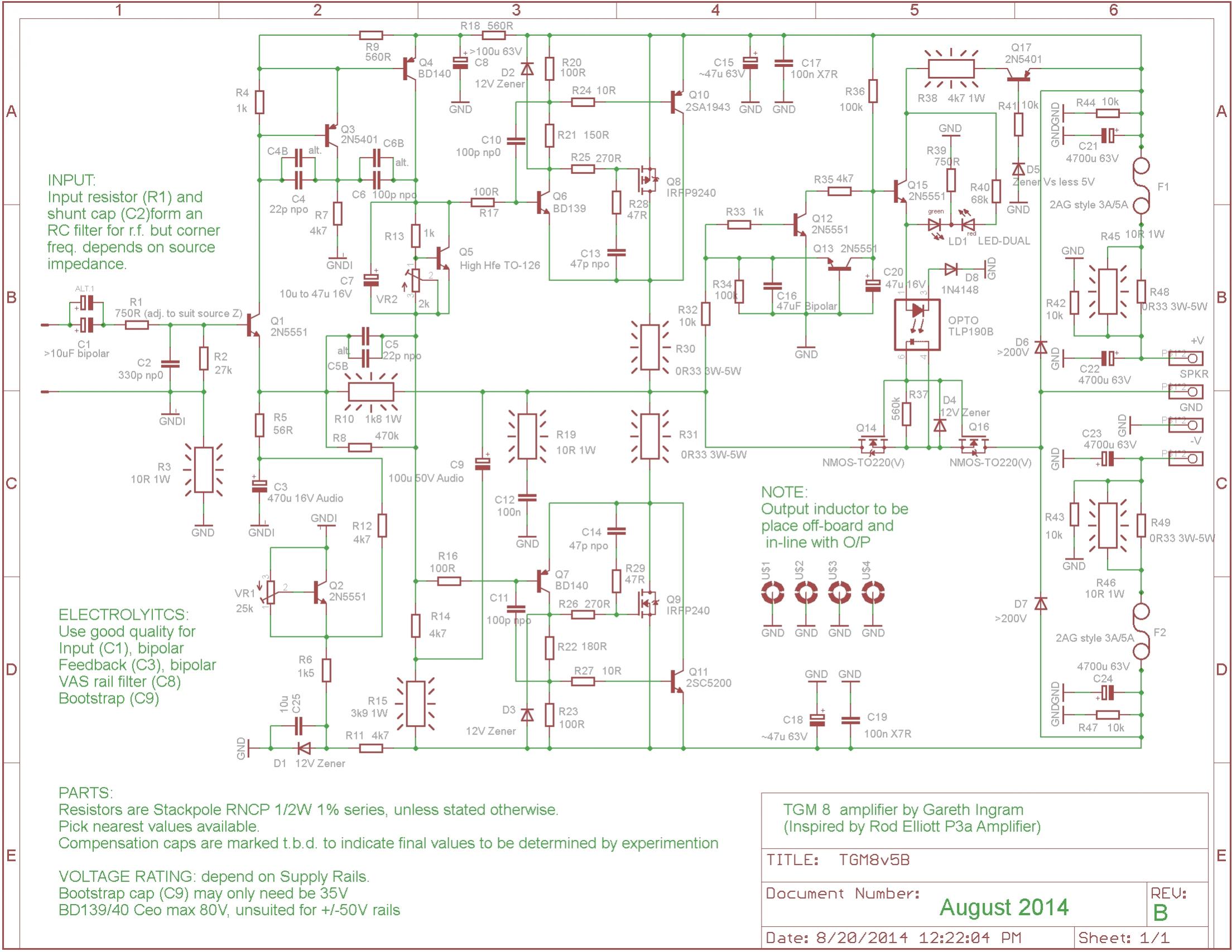

Continuing on with that rainy day idea...
One thought with the VMOS 'option', should there be an optional resistor between the BJT driver and the MOSFET gate protection diodes? Under severe overload would the driver be capable of destroying the diodes without any current limiting?
Other thought or comments?
