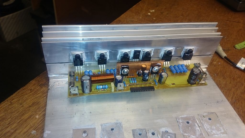

A small observation from today.
Few posts above I have posted pictures with simple mosfet OPS with only one pair of popular IRFP transistors soldered (82R gate stoppers), all was working really nice and stable.
Today I have soldered 3 pairs of irf540/9540 mosfets to the same OPS, it started to show some parasitic oscillation so I had to increase gate stoppers from 82R up to 330R (at 150R the oscillations were still present).
Now I am just wondering if It was caused by the two more pairs of OP transistors or just by the type of the transistor.
I will try to check it tomorrow.

Beware, base stoppers had to be set as close from the chips as possible: I was shocked by your wires as I am with the long transistor's legs in your photo. Remember we are dealing there with something around 10MHz.A small observation from today.

But the version with the wires was performing really good. My problems have started afted I have soldered 3 pairs of irf transistors. Maybe the irfp transistors are less sensitive to parasitic oscillations.
I have placed the gate stoppers just by the transistor leg, the track on the pcb is no longer than 1-2mm.
I am wondering how to match correctly the gate resistors, just by the hardware measurements and tests on the bench ?
On the mosfet amplifiers they have values from 47R up to 470 or even 1k !
The most used is approx 220R.

Indeed. Remember that any wire (track/leg) length is a coil and the gate parasitic capacitance are high on those IRF.The most used is approx 220R.

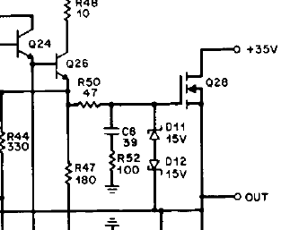

cordell has recommended series R-C from gate to ground instead with a smaller value gate resistor.
see attached excerpt.
might be worth a try ...

I don't know. In a way, it linearize a little the gate capacitance, in an other it increase the load of the VAS/driver at HF ...cordell has recommended series R-C from gate to ground instead with a smaller value gate resistor.
