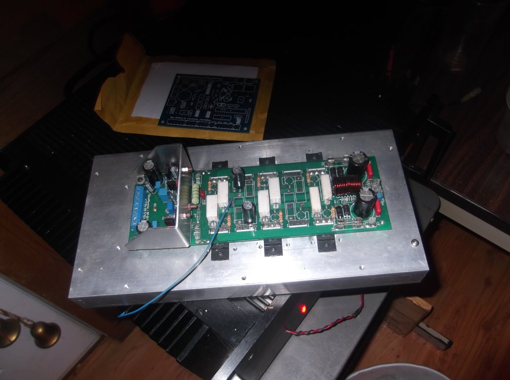

My newest OPS ("arc welder" slew 2.0) can actually be a modest 2 pair
50V rail precision class AB amp. Most builders of similar <100W amps will
use @ a 250mm 3U heatsink . Positions 2 and 4 on the new OPS will ensure
an equal thermal area for all 4 devices.
"Scaleability" with optimum performance is built in.
A small(er) amp is just as good on the slew.
2/4 = 100w , 1/3/5 = 150w ,and all 5 could be 250-400W (depending on device).
The MOST adaptable OPS on the forum !!
an equal thermal area for all 4 devices.OS
Sounds like I need to start looking for a couple of 250mm 3U heatsinks.🙂

One question. I understand how the center output could run hotter than the outer devices but how can this occur with only two pair when they are mounted on opposite sides. Each output sees the same amount of heatsink.
That was one of the improvements in V2.0. With the whole 175mm (9") of
device positions , the builder can choose the positions to maximize the thermal
"footprint"for each set of devices.
2 pair in positions 1 and 5 on the V1.x or positions 2/4 on the new V2.0 are
the EXACT same bolt holes. Slew 1.x and V2.0 are the same templates
+ 25mm added length and the extra set of outputs near the driver section.
On a standard 3U (especially) the outer 2 pairs (V1.x) have 2X the radiating area. 5U and up (like yours and evan's) , heat transmits in all 4 directions.
But , even with a 5U ... you could mount on the lower 3U for even more
radiating power (V2.0). Plus 5 pair MT-200 or IRFP is possible. NO need
for 4 different OPS's. 🙂
OS

Yes , if you do 2 or even 3 pairs .... A 3U heatsink with the old V1.x OPS
is quite Ideal. Each device in the the one (below) will stay within .5mA
from cold to 60C. Much better than my 5 pair amps.

I was thinking about the 5-pair "slew monster" boards. That's the one in the pix.
2 or 3 pair is absolutely perfect wattage/thermals !!
There are 2P boards , but the pairs are next to each other. While that
would make the 2 pairs the same temp. , the same 2 pairs spread out
5" would be the uniform AND @ 10C cooler.
Thermal derating on a output device is about >20W(per -10C) , added to it's power rating.
A cooler amp is a more powerful amp.
OK, so what I want is a used pair of the "Slew Monster" boards with 2(preferably for me) or 3 pairs of output devices?
