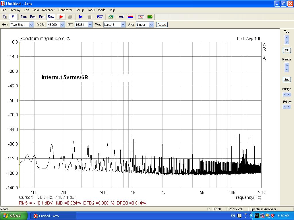

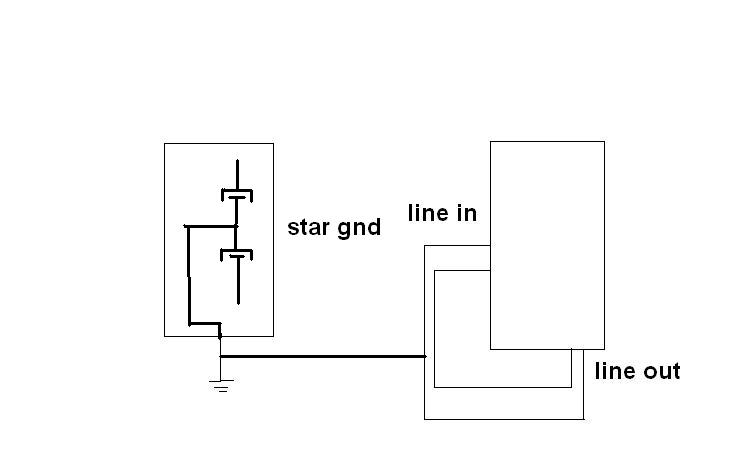

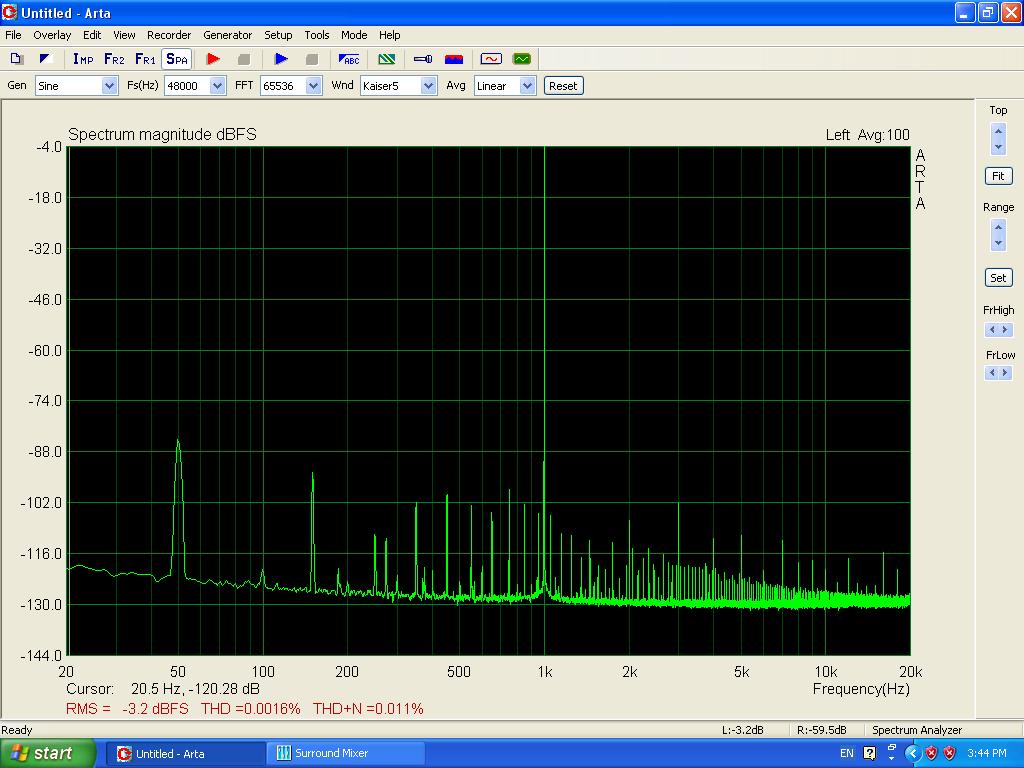

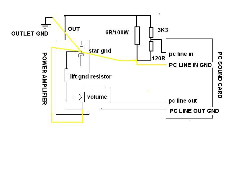

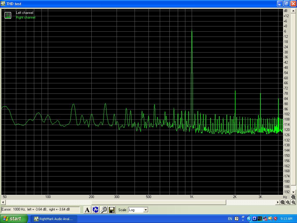

Do you mean something like this?and make again loopback measurement, compare this with "clear" loopback. Results should remain unchanged, it should be the same picture as above. According your pictures, connecting input cable shield (so creating ground loop) worsen results more than one order of magnitude, for the same amp.
Yes, amp should be on. How looks the same measurement with disconected conection to amp ground (output GND)?
I can repeat this soon .Yes, amp should be on. How looks the same measurement with disconected conection to amp ground (output GND)?

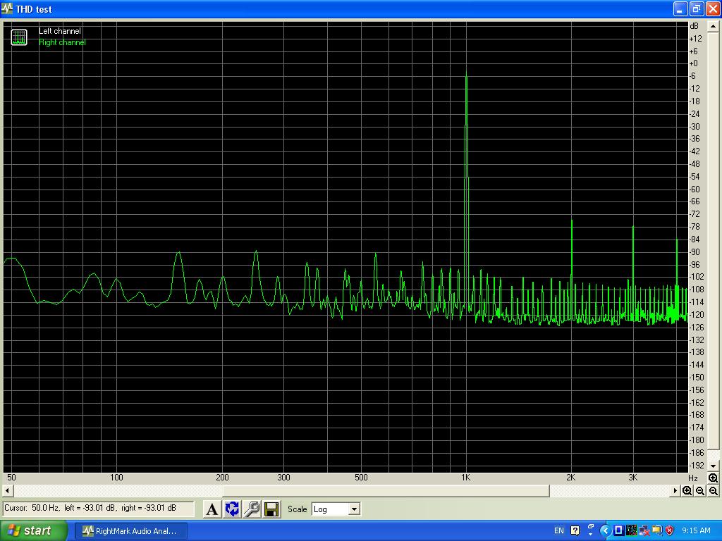

This photo is from a previous amplifier measurement.
You want a loop test with and without connection to a power on amplifier gnd if i understand well.

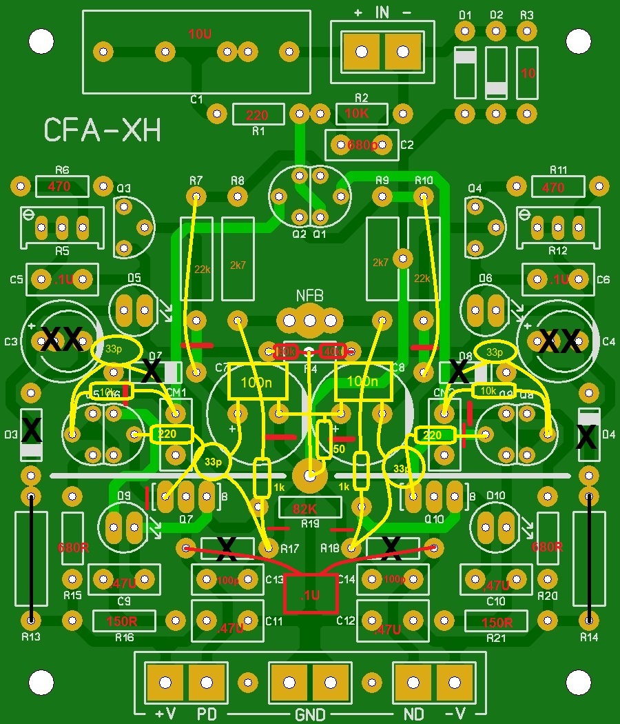

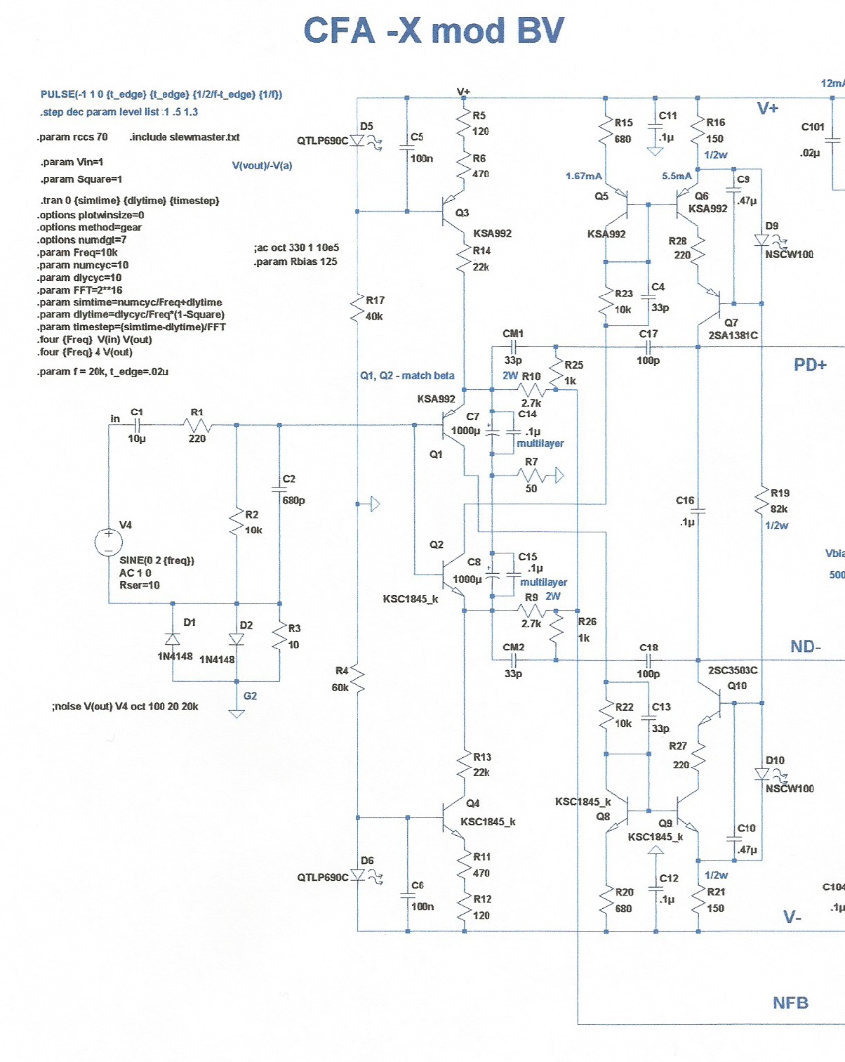

Which version of BV's mod did you do? I am trying to get the one attached to work and it won't. Today I built another board to see if maybe I had done something wrong with the first one and still it won't play nice. Would you or anyone have a look at the board and see if it looks like it follows the schematic properly. It may be that I just modified it wrong but I have been over it several times and I just can't find the problem. It sims fine but won't work right for me.
Thanks, Terry

Hi TerryHi Thimios,
Thanks, Terry
My last modification is according to pdf on post 2974.

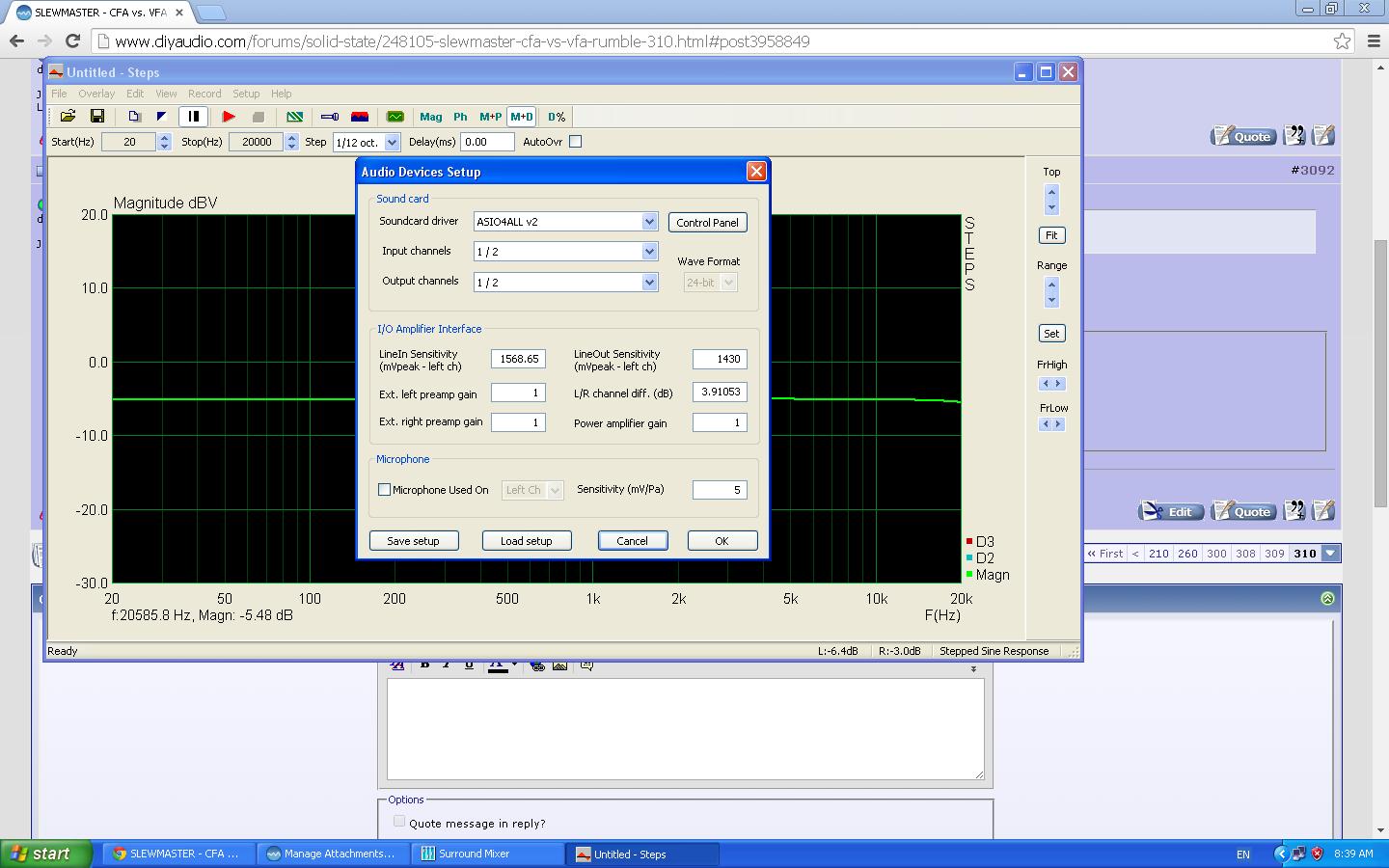

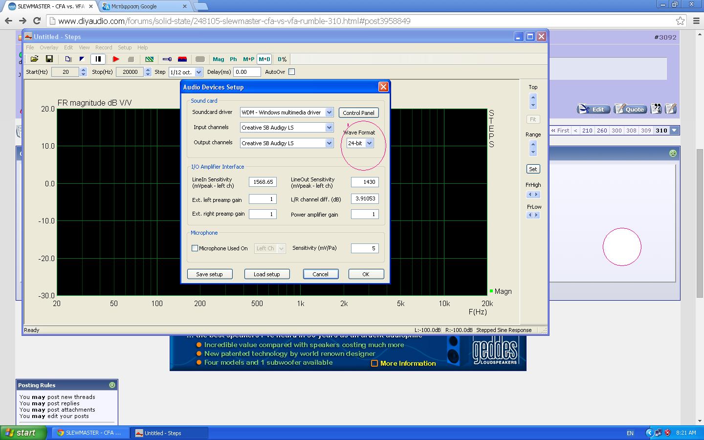

I will examine this soon ,i will try to find these adjustments in ARTA software.Thimios, I suppose (I hope..) you are using 24bit regime in measurments. And use ASIO.
Yes ,24bit
ASIO?
PS.This loop test ASIO used.
Hi Terry
Weird, that is the same one I can't get to work. If you can find the time, would you please look over the modified board layout I posted and see if you find any errors?
Thanks, Terry

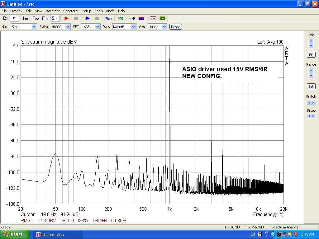

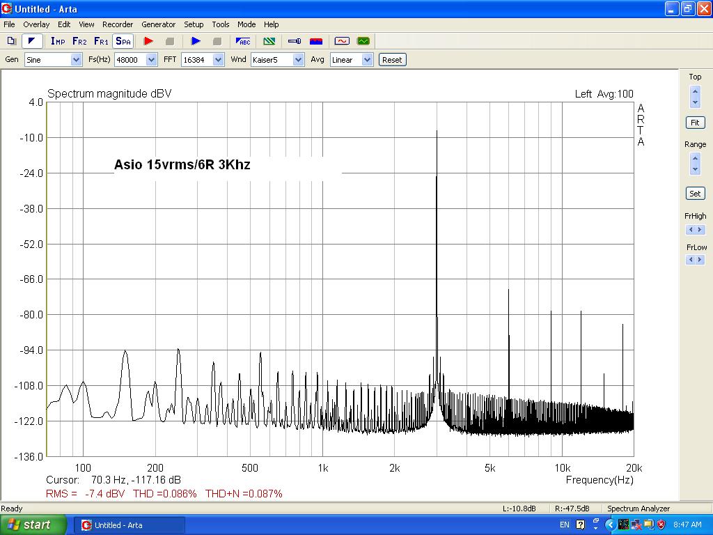

New configuration, asio driver
Asio driver based measurements.
The same with RMAA.
Amplifier is CFA simple.
The same with RMAA.

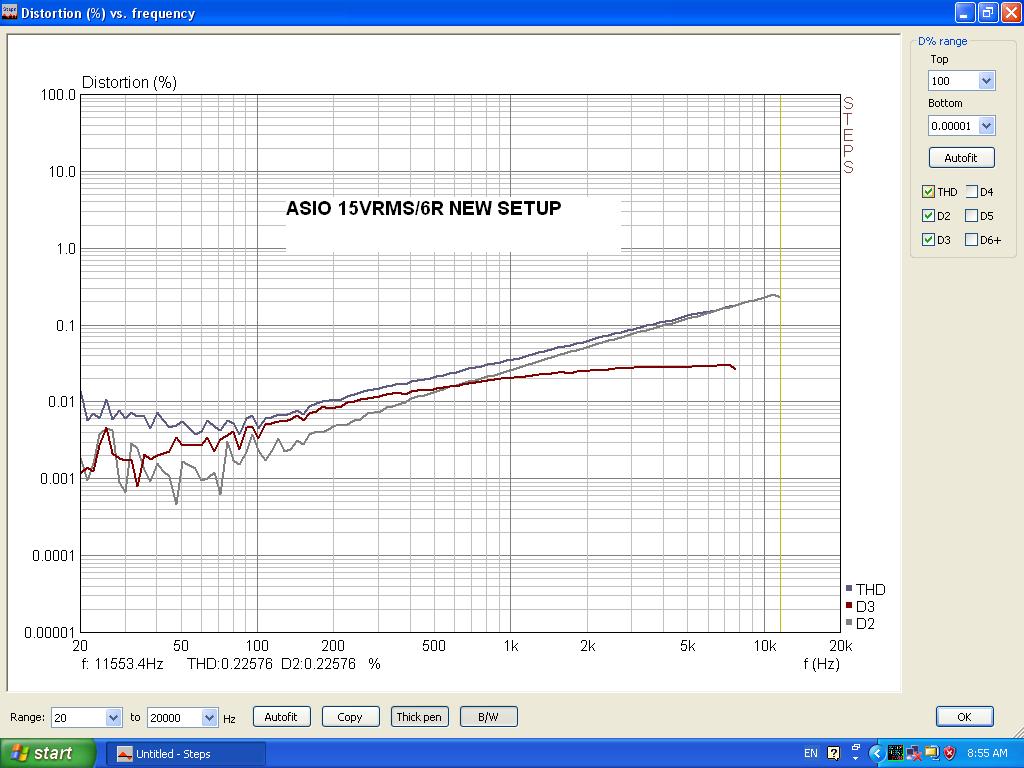

Looks nice to me. Do we need more than a simple CFA....
Hi Bigun thanks for reply.Looks nice to me. Do we need more than a simple CFA....
If this config. is ok i will try all my amplifiers.
I see your tests,what software you used?

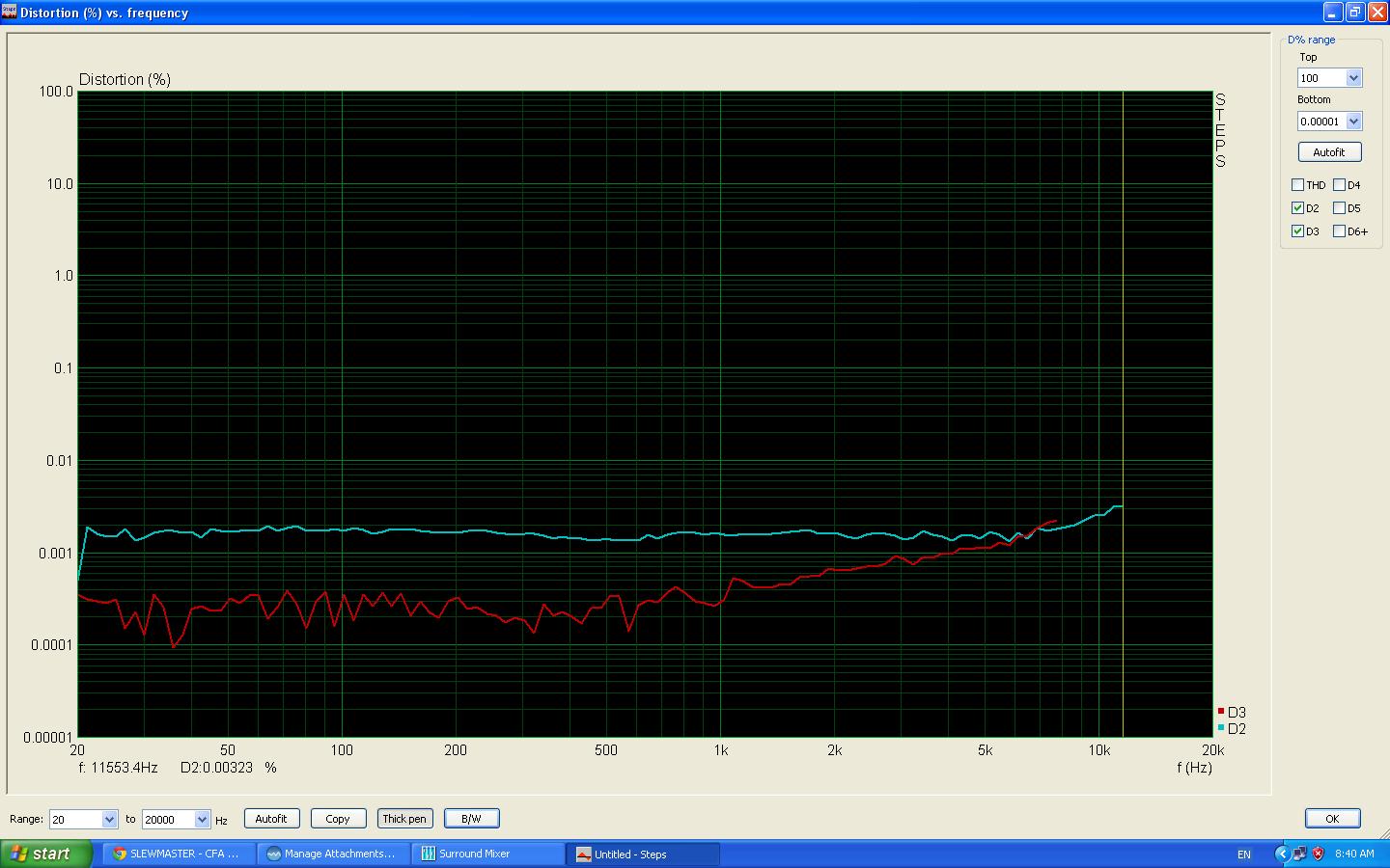

How is that nice? The CFA should be more like 0.003% at 20kHz, thimios would almost be at 1%!
Where are you see 1%?How is that nice? The CFA should be more like 0.003% at 20kHz, thimios would almost be at 1%!
BTW now we must be sure for test setup only.

Try a loop test, as in #3092, but with connected loop shielding to amp GND..
Measure with Fs=192kHz , so you can see distortion artefacts to 90kHz and do swwep 20Hz-20kHz.Where you see 1%?
