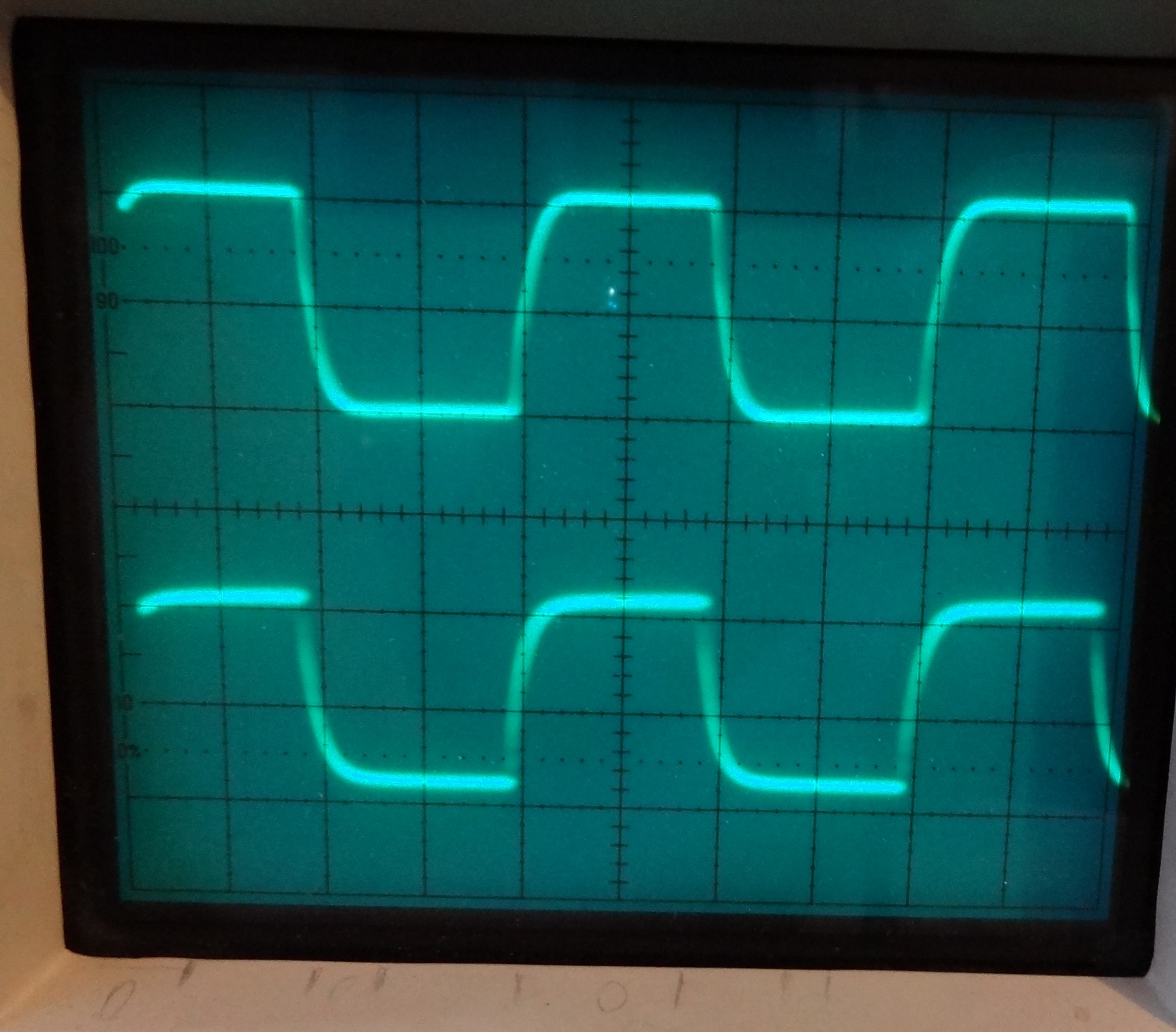

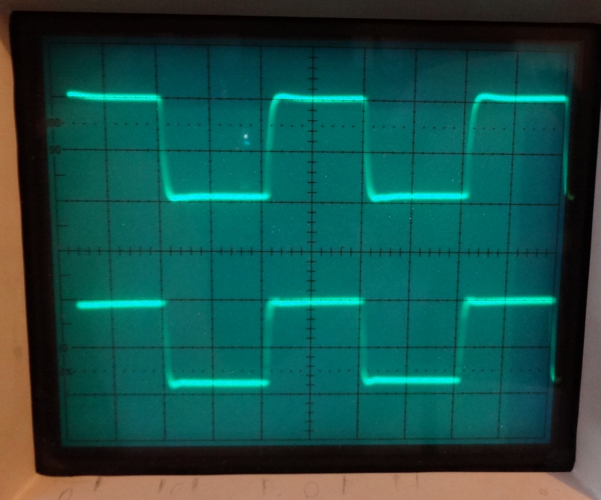

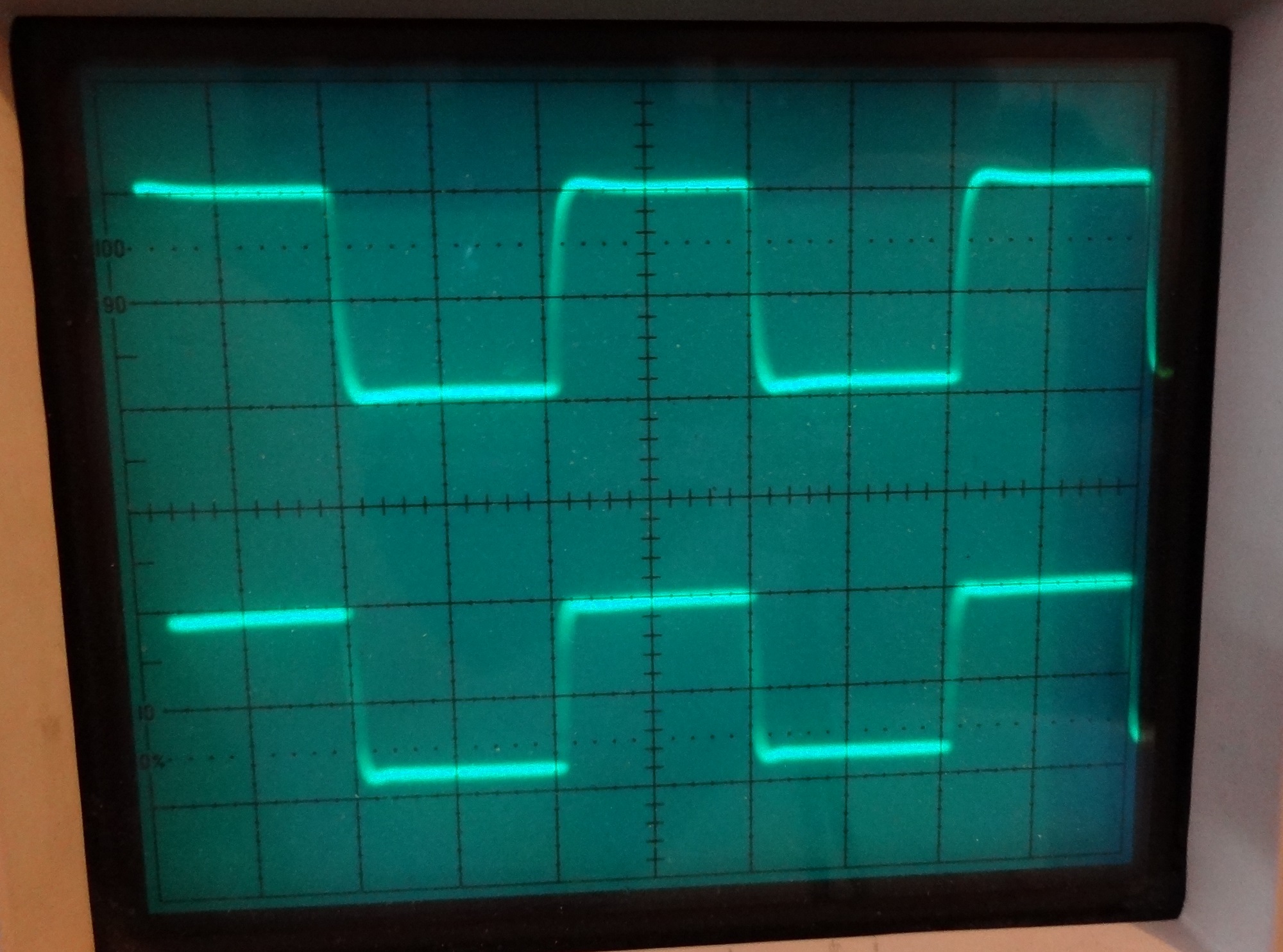

And input coupling cap value has nothing to do with rounded square, but HF filter capacity (150-680p?) , together with generator output impedance (compare input and output signal). But this CFA should be very fast. Terry, can you post a picture of this rounded square? And here,
you mean 884 miliohm or 0.884 megaohm? I suppose , the second value.Measures .884m
I haven't seen any difference in high frequency square wave changing value of input capacitor .It's good that you finally got it working! It can be quite frustrating when a component goes bad and you don't realise it.
The 10u input cap shouldn't affect the high frequency performance of the amplifier.

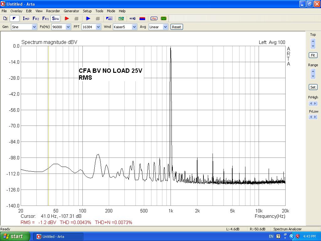

This occurs only for frequences under 50Hz
distortion measurments.
I believe that i know the reason for this increased distortion level now.

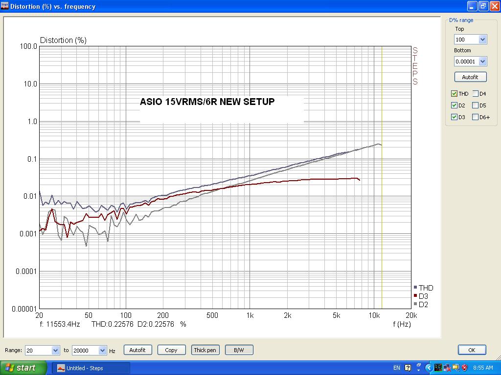

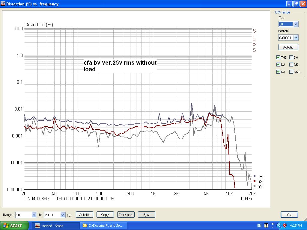

Look at picture No 4.What did you see here?
Distortion go up when frequency rises.
Why this occurs only when a load is connected?
Probably because this bad load has big electromagnetic value in those high frequencies.
I repeated all these tests without load and within a real loudspeaker.

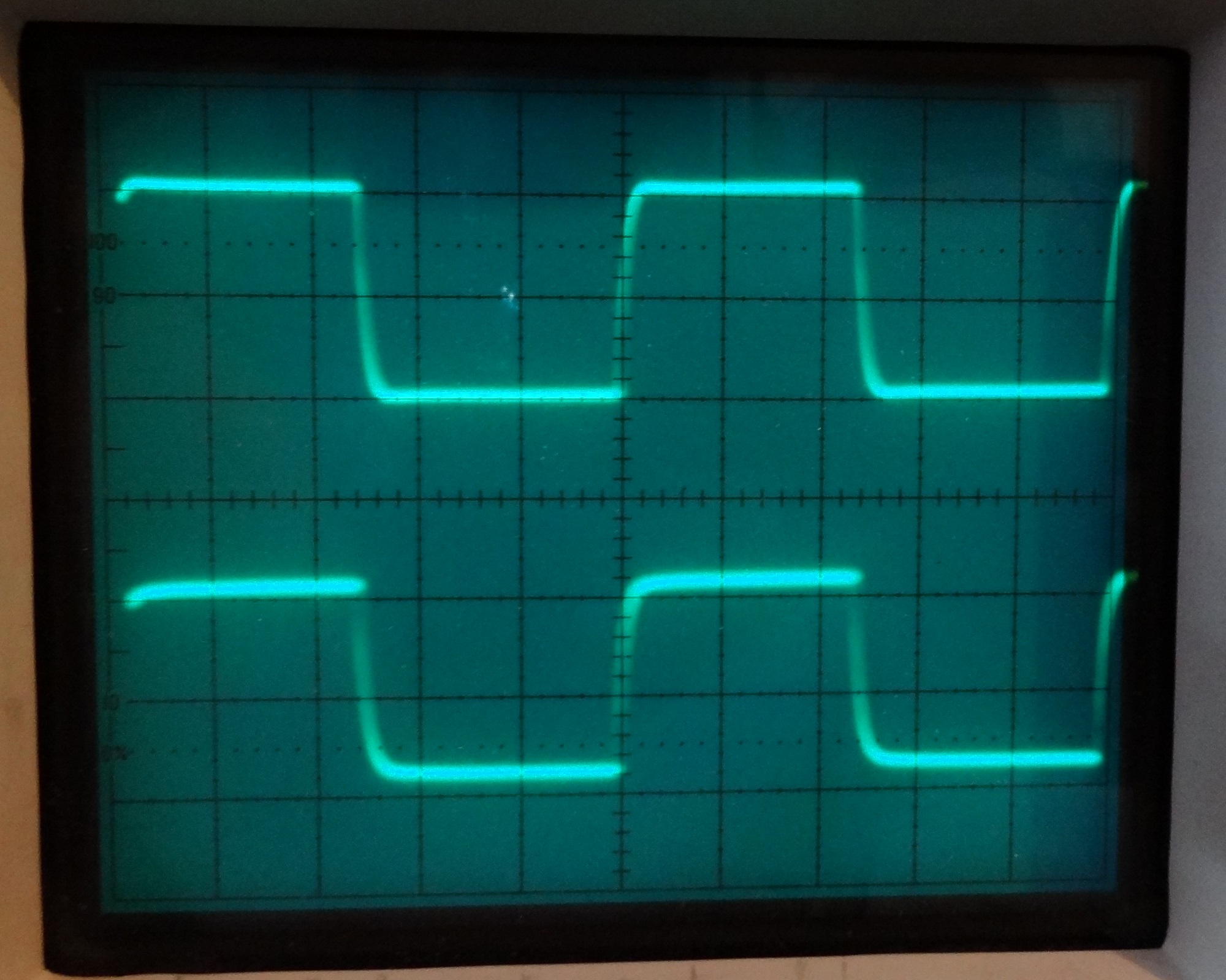

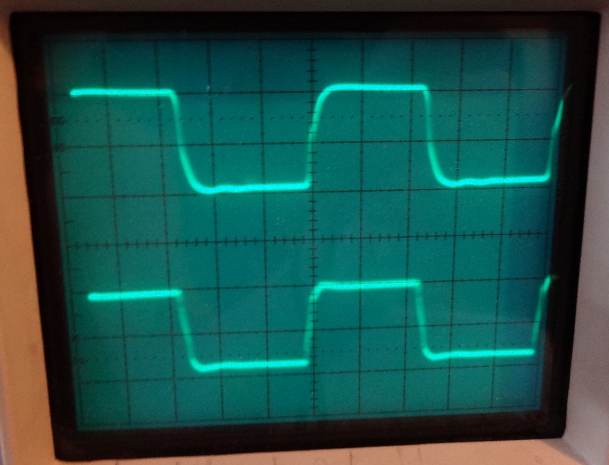

Hi Guys,

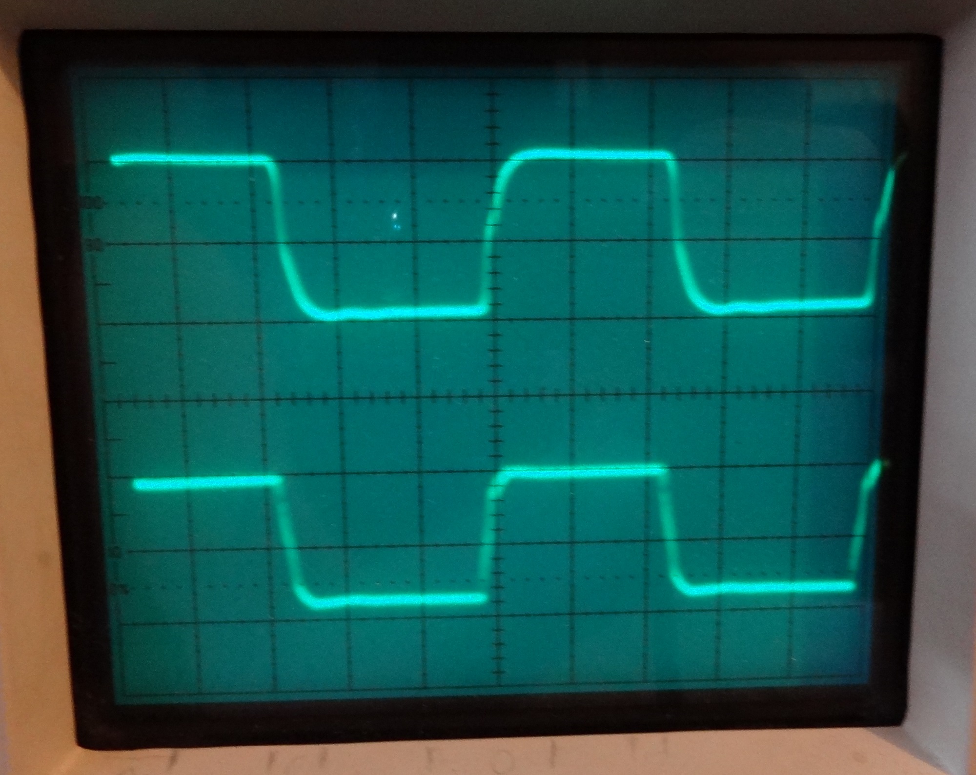

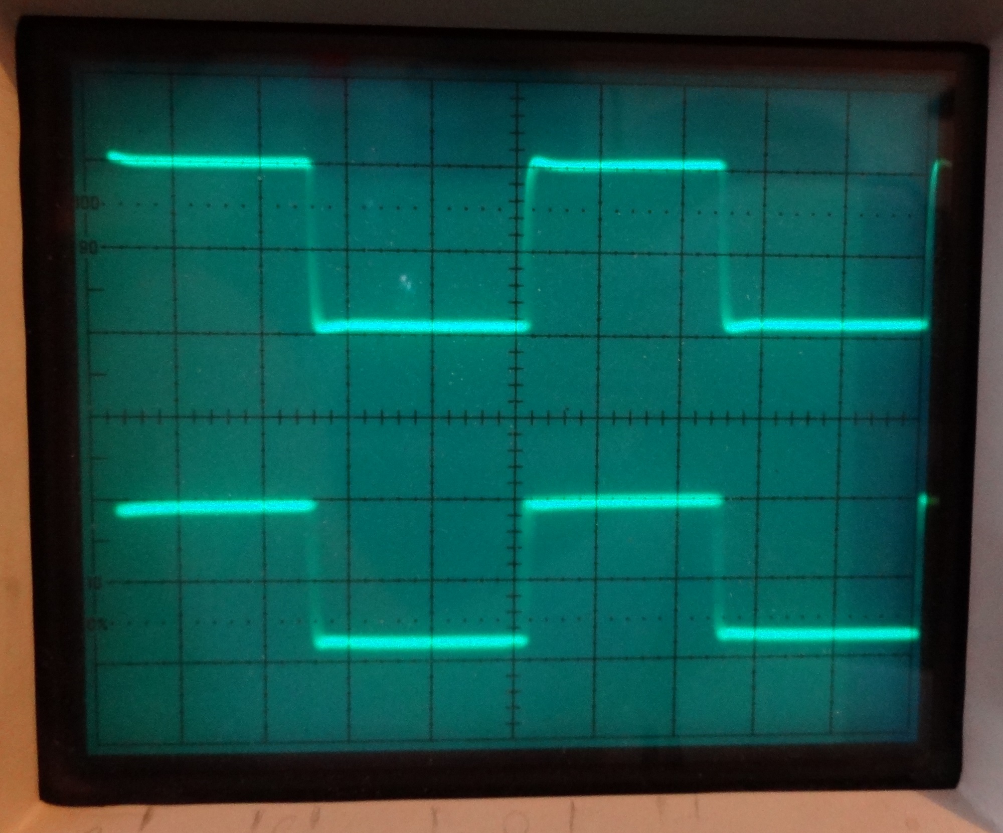

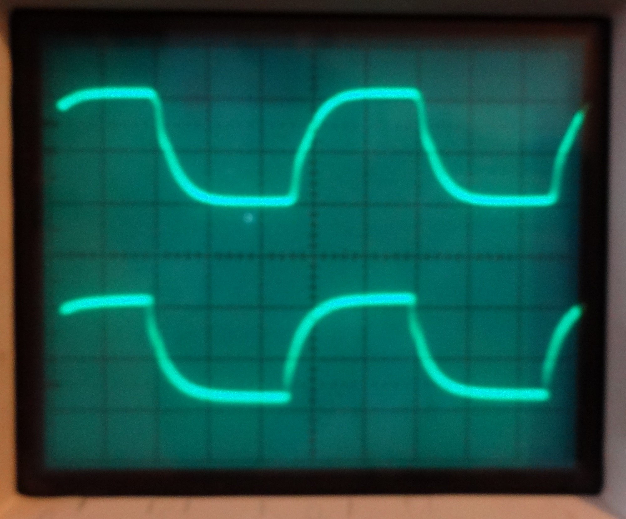

I'm not sure i'd pull the trigger on the BV mod just yet. Here are some scope shots. First three are stock OS CFA with 4.7uF input. Second three are BV mod #1 4.7uF. Third three are mod BV #2 with 10uF input. 20kHz, 50kHz, 100kHz

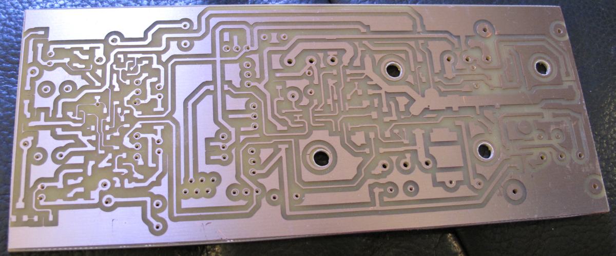

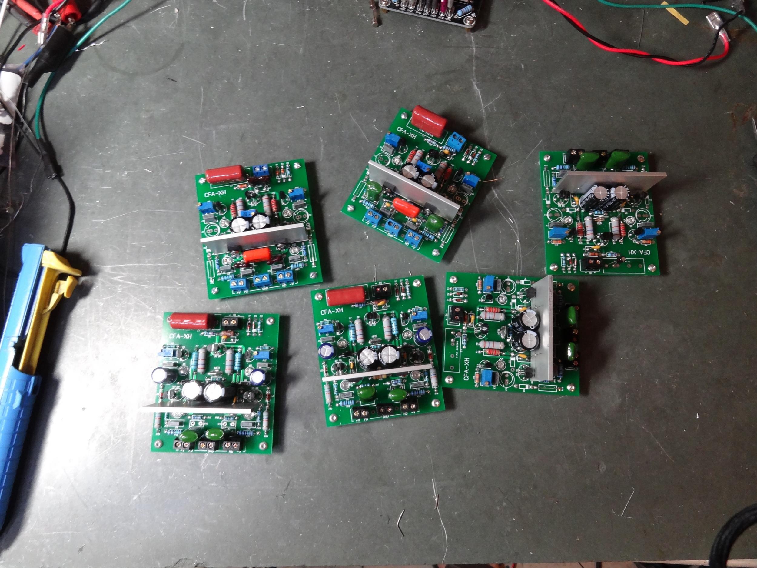

Good news, I got the CFA-XH mod BV boards working. Out of frustration I built a second board. Once I got all the parts in correctly it worked. So then my task was to compare the two until I found what was different. I pulled all of the extra parts that attach to the bottom of the board and cleaned everything up and installed new parts. I still had the same issue with this board. I got out the DMM and compared part by part with the working board. Everything measured the same until I got to R2, the resistor that BV had asked me about a week ago. It was a 10R resistor but had gone bad. Measures .884m. I put a new 10R in there and all is good. FINALLY.
Anyway, I posted all that to say that the board shot I posted showing the modifications necessary to achieve BV's latest mod is correct if any of you choose to do that mod. I haven't listened to it yet. Square waves get pretty rounded above 20kHz but I suspect that is due to the big 10uF input cap.
Blessings, Terry
R3=10R, R2= 10k..Terry where is this R2=10R?
Thimios, here can be nothing feromagnetic in your load , e.g. resitor caps or leads (try it with permanet magnet) or near load , it will act as a core, and can saturate, result is nonlinear load resitance-distortion. The same is valid for output inductor in amp, worst thing what one can do is to wound it on paraleled resitor. I hope, it is not this case..

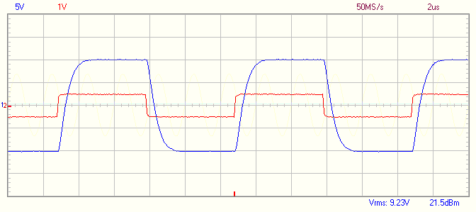

Terry, if you want "sharper" square, you need to decrease input filter capacity (680p to some 150-220p, as in slewmaster), input signal (generator source impedance loaded with this capacity) looks about the same as amp output. I posted picture about this few days ago..
Finally a new signal generator...

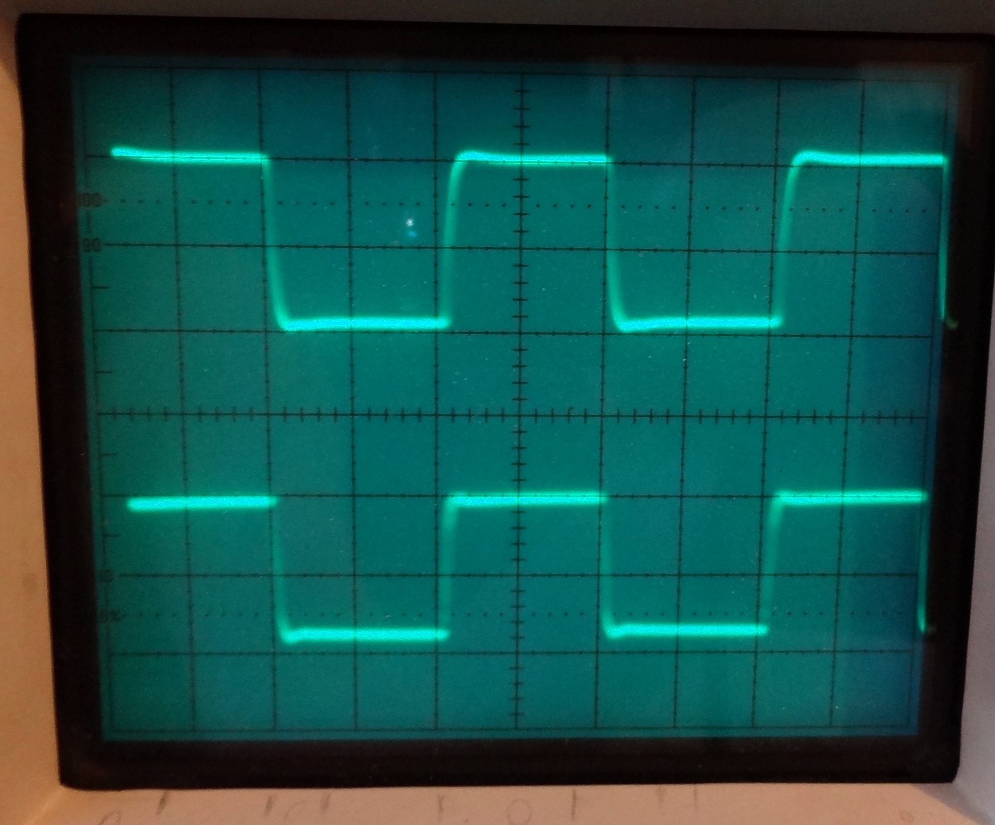

This is what a 100kHz square looks like with my unmodified OS CFA-XH operating in isolation on +/-45V, input filter in place set to ~1.5MHz cut-off (220R-470pF). I'm tempted to pull C2 just to see how an un-filtered IPS looks.
Sorry, typo should be 10K.
I stand corrected on the input cap too. I bypassed it and the square wave looks the same.
I used 8x1R/17W in series resistors as load ,i believe this is a bad load high mH VALUE at high frecqencesR3=10R, R2= 10k..
Thimios, here can be nothing feromagnetic in your load (try it with permanet magnet) or near load , it will act as a core, and can saturate, result is nonlinear load resitance-distortion. The same is valid for output inductor in amp, worst thing what one can do is to wound it on paraleled resitor. I hope, it is not this case..
Inductance alone will only increase impedance with raising frequency, and make things easier for amp.. Nonlinearity of this inductance with raising current (saturation and quick impedance change) is a bad thing.

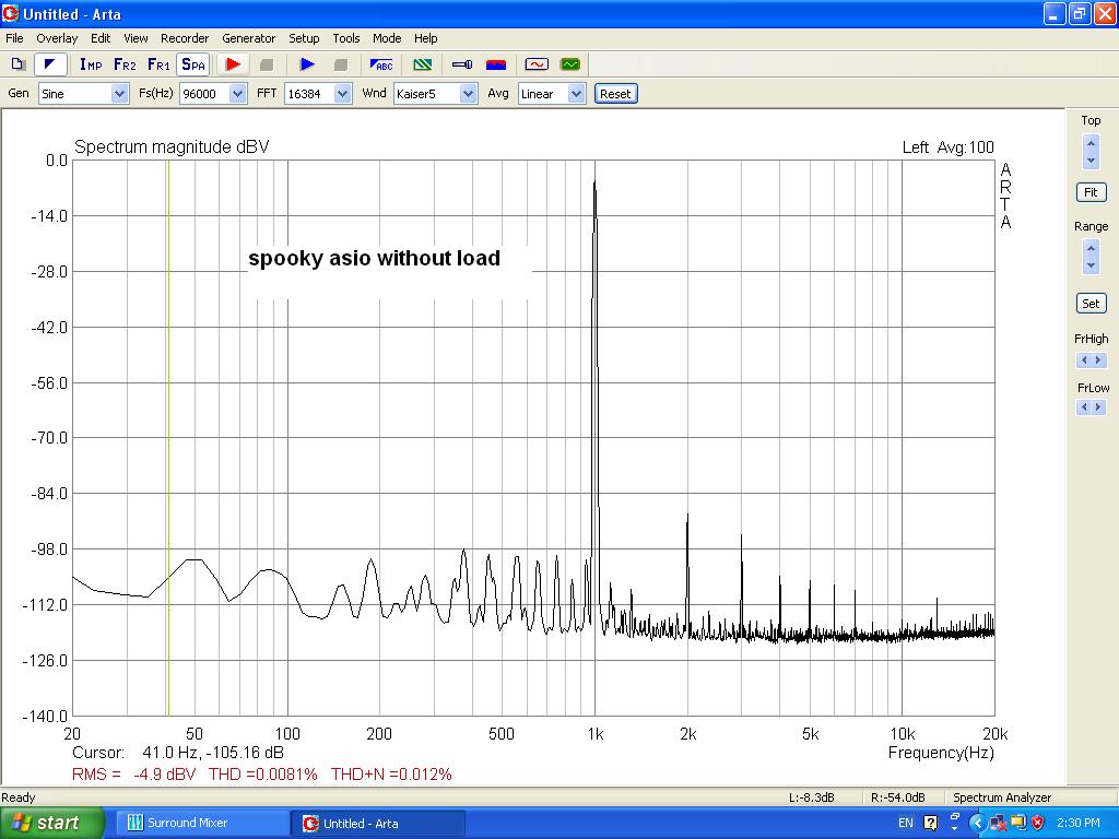

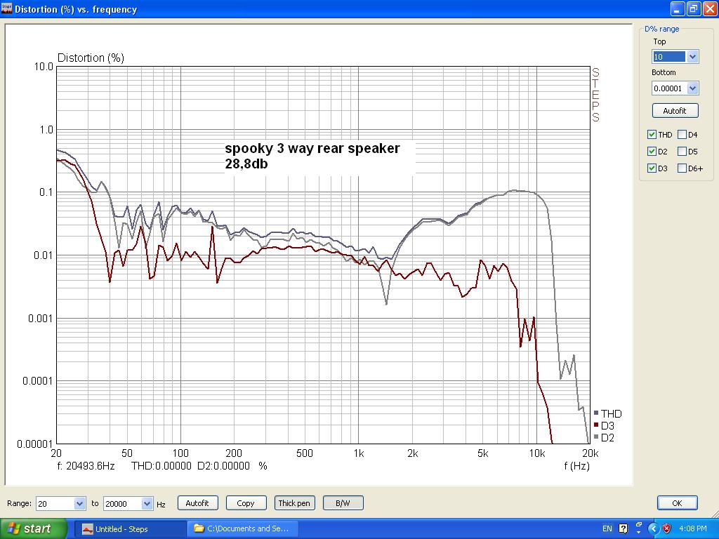

Are these measurements without load more realistics?

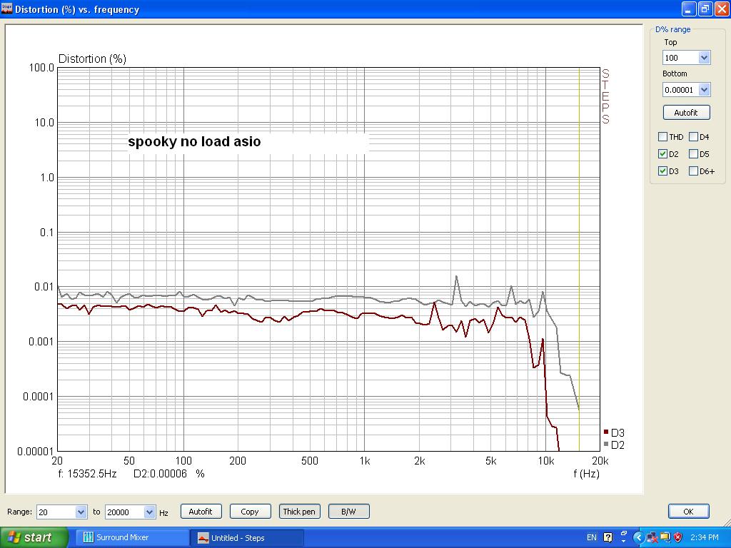

The high frequency distortion is still really bad. I think it's more reasonable to assume that the rise perhaps doesn't occur until later because the three ways impedance might be quite higher throughout the mid band, this would cause less current to flow inside the amplifier and reduce the distortion.
Spooky with no load should measure as your sound card measures. Spooky should have 2nd order probably around 0.0005% or so across most of the audio band, only rising with the fall in negative feedback at higher frequencies. As far as I am aware the 3rd order harmonic with spooky should be lower than the 2nd, but as your sound card has gross 3rd order here you're not going to be able to measure it accurately.
If your sound card reliably measures and produces very low levels of 2nd harmonic at various drive and measurement levels, then I would expect the no load measurement to pretty much look exactly like the sound card does.
The loaded measurement, at least into 8 ohm loads at moderate power levels, should look pretty much like the unloaded measurement. Low frequency distortion levels of <0.0005% with this only rising when feedback starts to decrease due to cdom. If you're getting a rise in distortion before cdom starts to operate then this is being caused by something other than the amplifier circuitry.
You've still got contamination occurring somewhere. Either induced within the amplifiers layout or due to the measurement configuration.
You're obviously not getting a traditional ground loop here as the FFT is completely clean, but I do think you have high level current flowing somewhere that you don't want it to, like down the shield to the input wire.

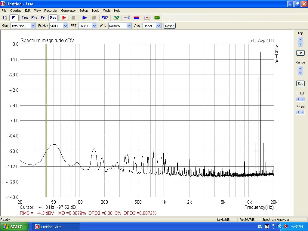

I only just realised that in the loopback measurement with ASIO 2nd order is dominant. In the loopback without ASIO the 3rd order is dominant.
Have you tried doing what I suggested before with the windows settings to try and get your card to actually work at 96 or 192kHz?
We can see that it isn't actually working beyond 48k because of where the distortion plots stop. When you're in 44.1/48k you get the 3rd HD up to around 8.5k and the 2ndHD stops at around 10k. If you manage to get the system to operate at 96k both these frequencies double.
Under the same conditions is spooky about 2 times worse as CFA (which is identical with card loopback). Spooky also "simulate" worse than CFA.Spooky with no load should measure as your sound card measures.
They are closer to real ability of tested amps, but card reslution and load properties are insuficient.Are these measurements without load more realistics?
