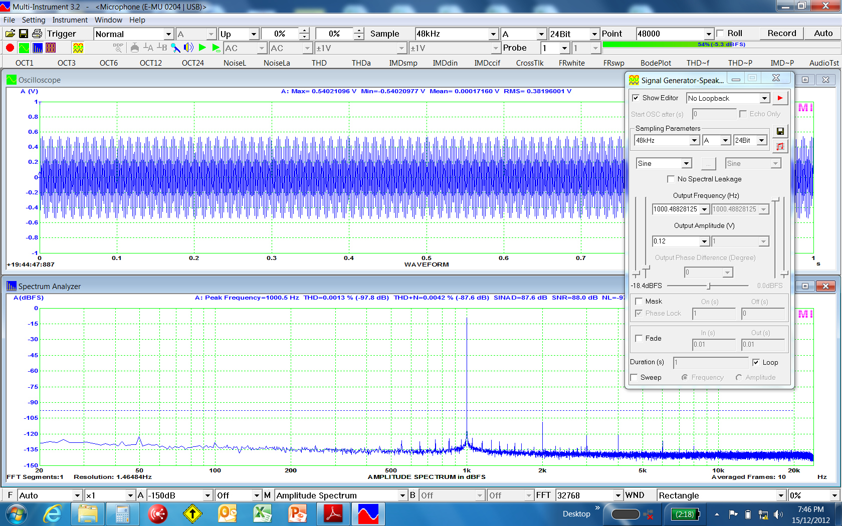

Distortion tests.
First pic. sound card loop test.
2)CFA-X Sine test
3)CFA-X Two tone test
4)Gnome Sine test
5)Gnome Two tone test.
All tests at 14V RMS OUT/7R load
You've got some real issues going on there that need figuring out.
The wiring up of amplifiers, with respect to return currents, both in terms of wiring up the amplifier for every day use and then wiring it up for measurements, is critical.
The results that you've posted clearly show that there is something contaminating the results from how they should otherwise be.
As a simple test could you perform a measurement, like above, 14VRMS out, but without any load connected?
Ok i will try this soon.You've got some real issues going on there that need figuring out.

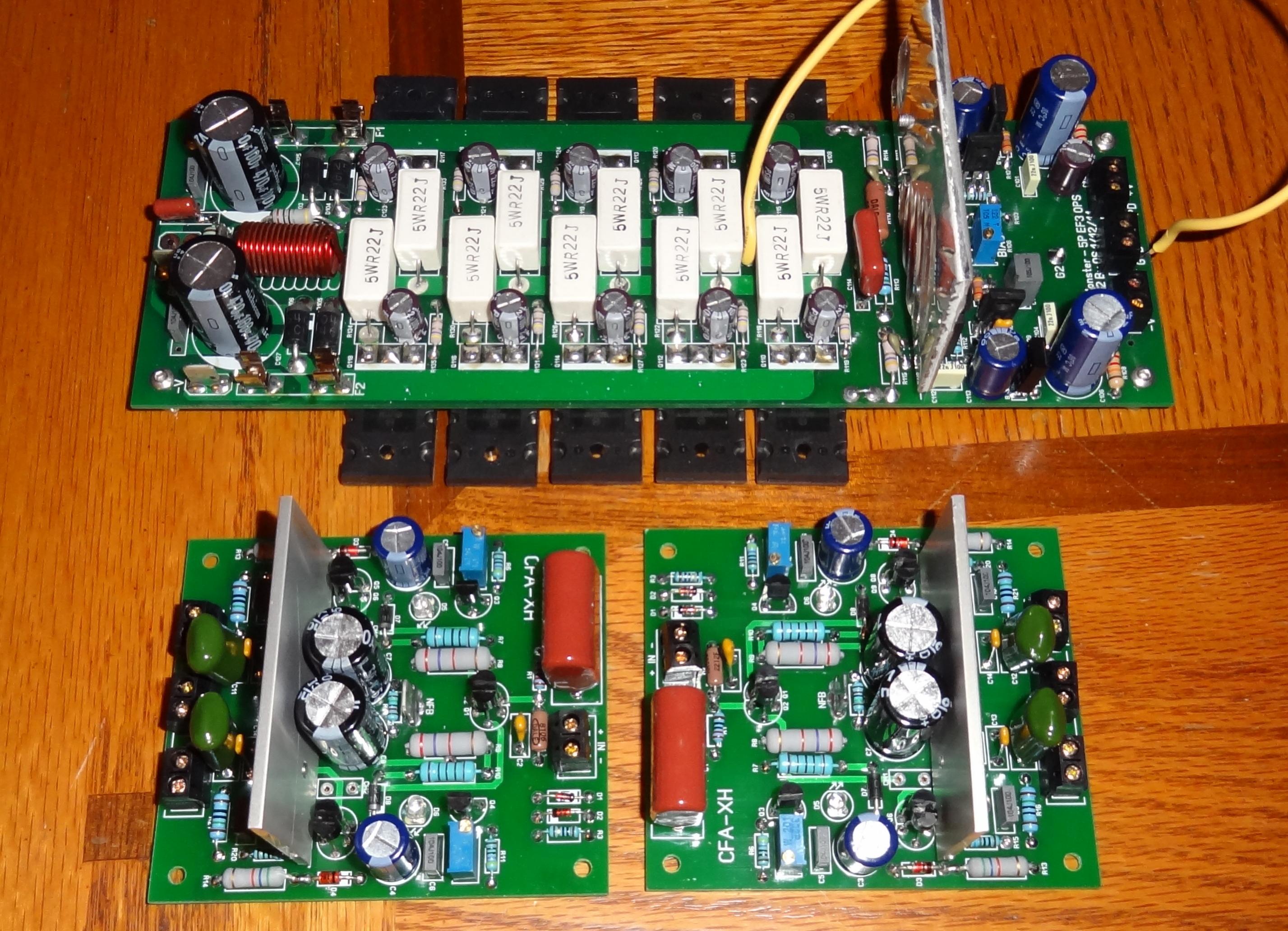

OK as usual I need some help.
I couldn't find a BOM anywhere for the CFAX-H so I used the schematic. I actually put together a spice file so I could try to determine the voltages on the caps but I couldn't get it to run. I want to test the board before I hook it up to the OPS but I can't seem to find any details about how to do the initial setup. I'll attach the spice file so maybe one of you can find my error so I can have a basis to compare to.
Thanks, Terry
Thanks, Terry
A quick pic of the completed boards. I'll keep searching. There must be adjustment instructions in here somewhere.
Blessings, Terry
Blessings, Terry
You should just need to centre the pots and adjust one or the other to null the offset. By design the currents should be close to the design target. That worked fine for me anyhow.
