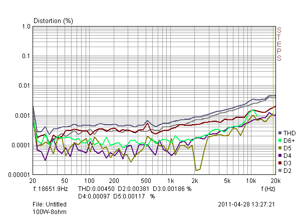

Well I know that 0.002% on the HD2 and HD3 isn't anywhere close to being bad, I was just wondering why the simulation is so different from the real world. I am not really interested in altering the compensation as I'd rather have properly stable amplifier.
By the sound of things though, it would appear that I don't have the OPS biased correctly. I adjusted it with respect to what Self recommends, but setting the bias correctly for the EF3 is quite difficult because there's a decent amount of thermal lag involved as the main heatsink needs to equilibriate every time you make a bias adjustment, which of course then alters the point at which you set it to previously.
I'll have a play with the bias setting when viewing higher frequencies on the spectrum analyser. All I did before was take a peak at the 1kHz spectrum and watched as the switching products disappeared into the noise. No matter what I try however, I can never seem to get spikes to appear again as a result of GM doubling.
Maybe all I need to do is observe the THD at higher frequencies to set the bias properly. I did notice that when doing say 1/10th of watt power tests that the THD fell completely off the chart.

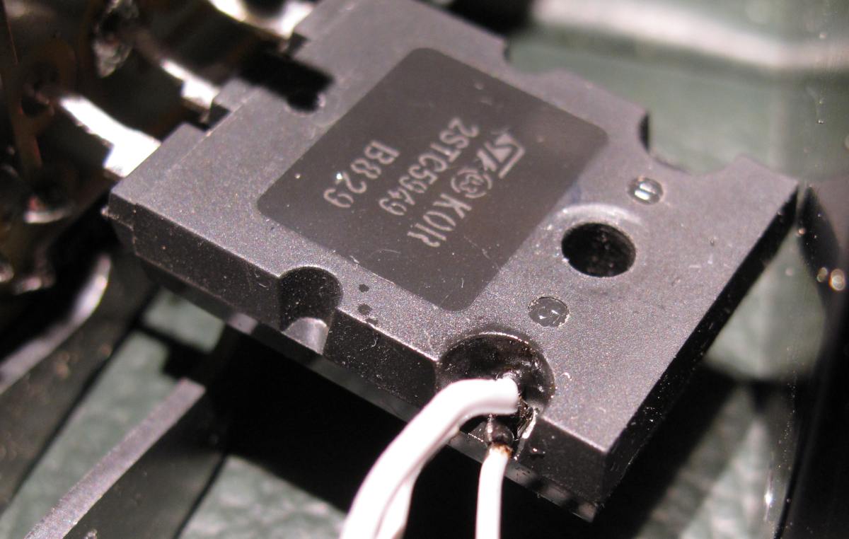

How can one mimic Thermaltrack BJT? 🙄
Well by using SMD BJT as a temp sensor by glueing it to the central pin of a power transistor, to the point where it comes out from a plastic case. There's usually wider area of a copper pin just of the right size to accomodate SMD BJT. Copper pin actually serves as the best temperature transferring media from a die to the outside world.

Improving the bias transistor a little.
I super glued a tiny SMD device into one of the 'hollowed' out parts of the transistor case.
This works far far better than the original method, but then again I don't know if in practice that it really matters. It's certainly helpful when setting the amplifier up, tweaking and measuring though.

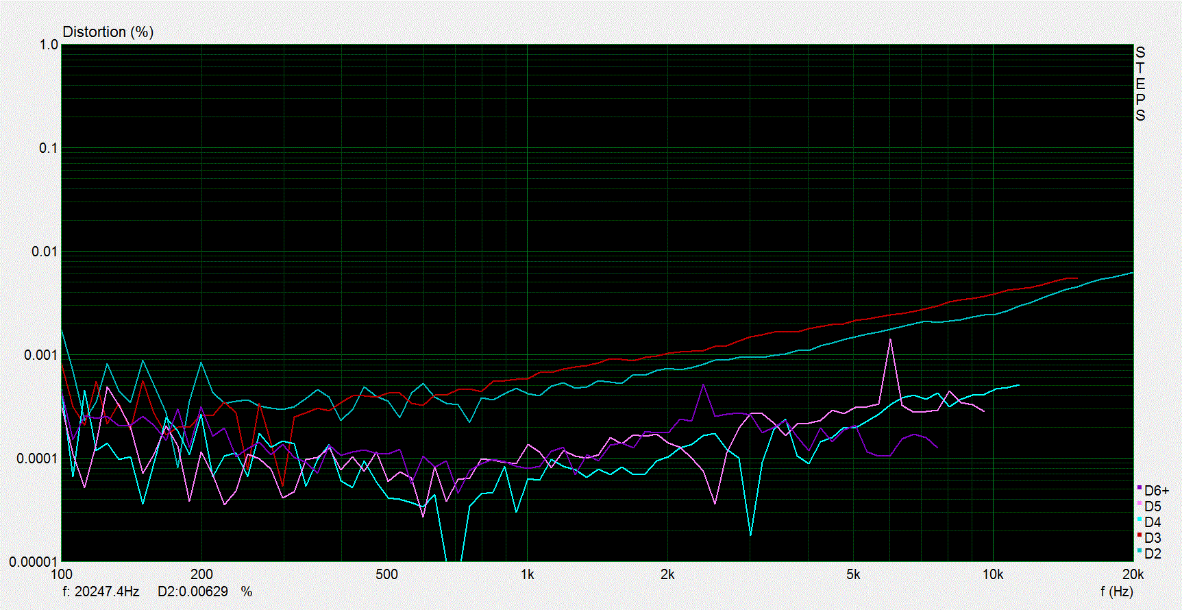

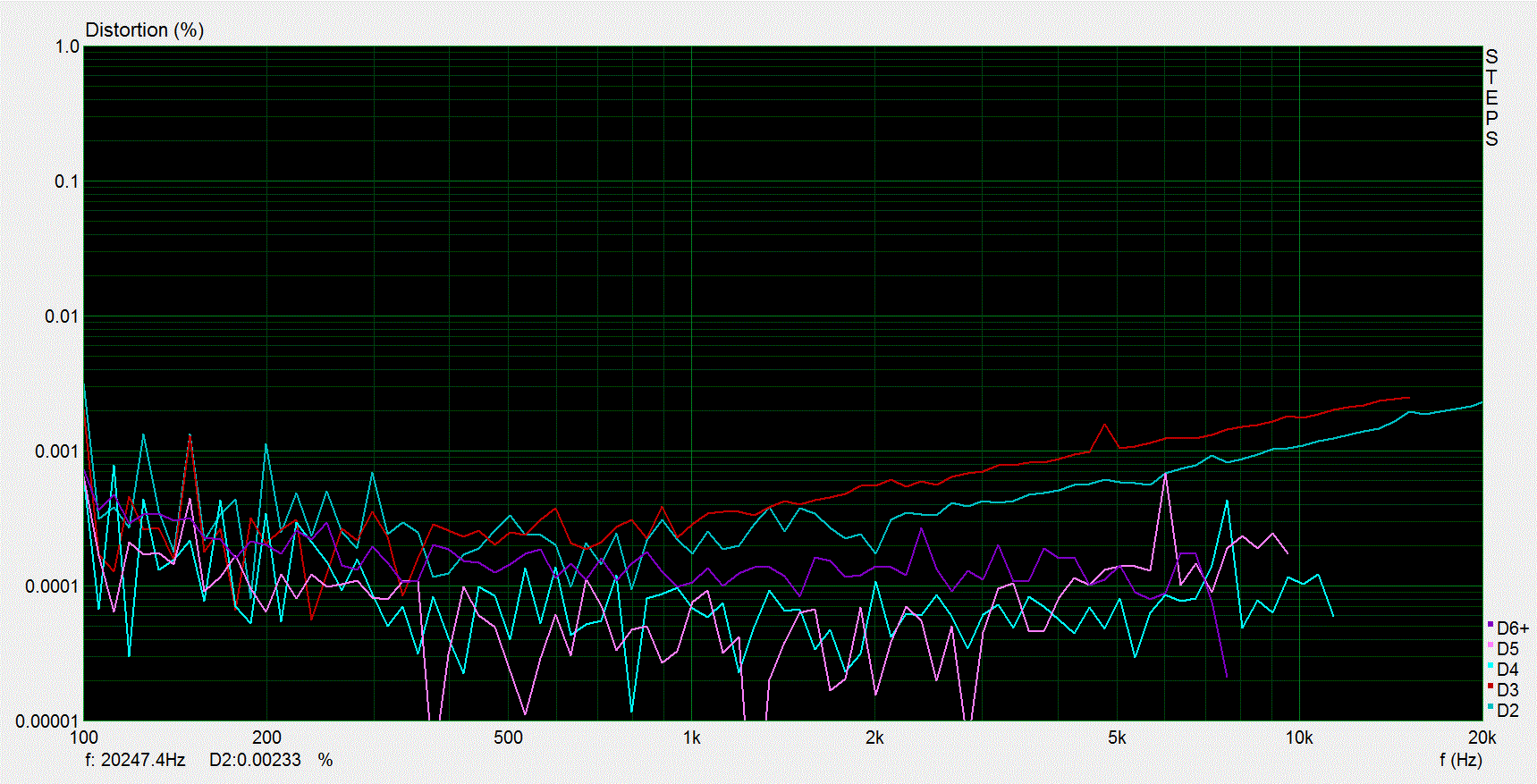

I had a bit more of a play around and it became obvious that I was suffering from some induction based distortion and moving some of the internal flying leads around helped reduce this to the extent that the amplifier is now less load dependent and the distortion is lower overall.
Optimising the wiring is clearly needed on a 'per amplifier' basis to maximise performance. Although distortion levels, even with the wiring neglected somewhat, are still very low by any standard.

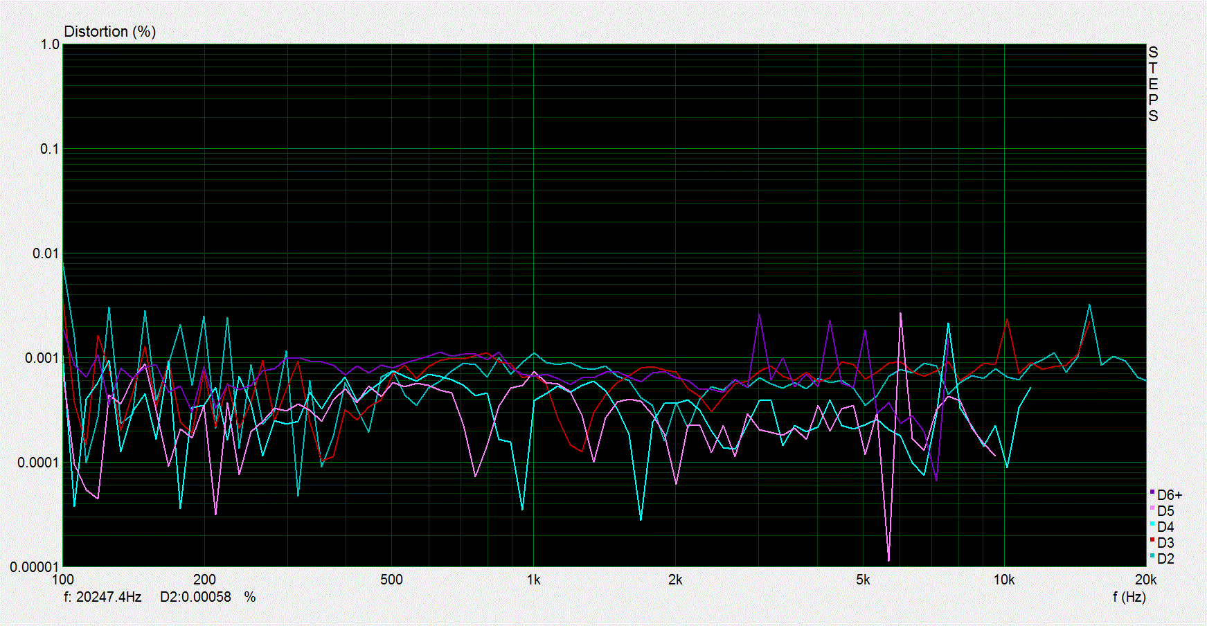

Here's the 2.83V into 9.4 ohm load again. And like last time ignore the spikes as they are a measurement issue.
Pretty much noise really. Distortionless one could say? 😎

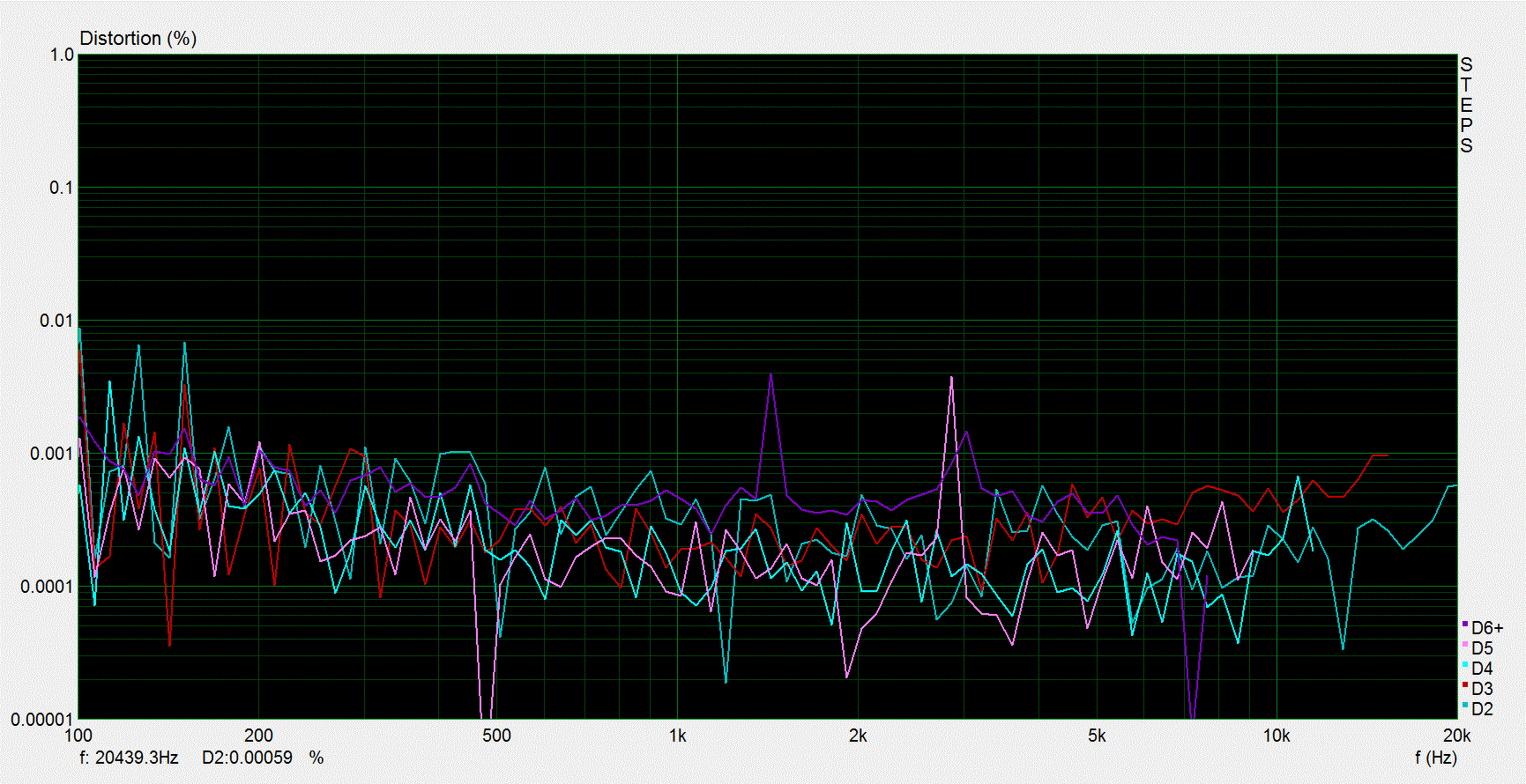

Now up is 12.5V into the 9.4 ohm resistor, which represents what one could call half the max RMS output swing.
Still very low and clearly the output stage is now NOT in class A, which is was previously I think.
Here is the same but into 4.7 ohms instead.
Is pretty much identical.

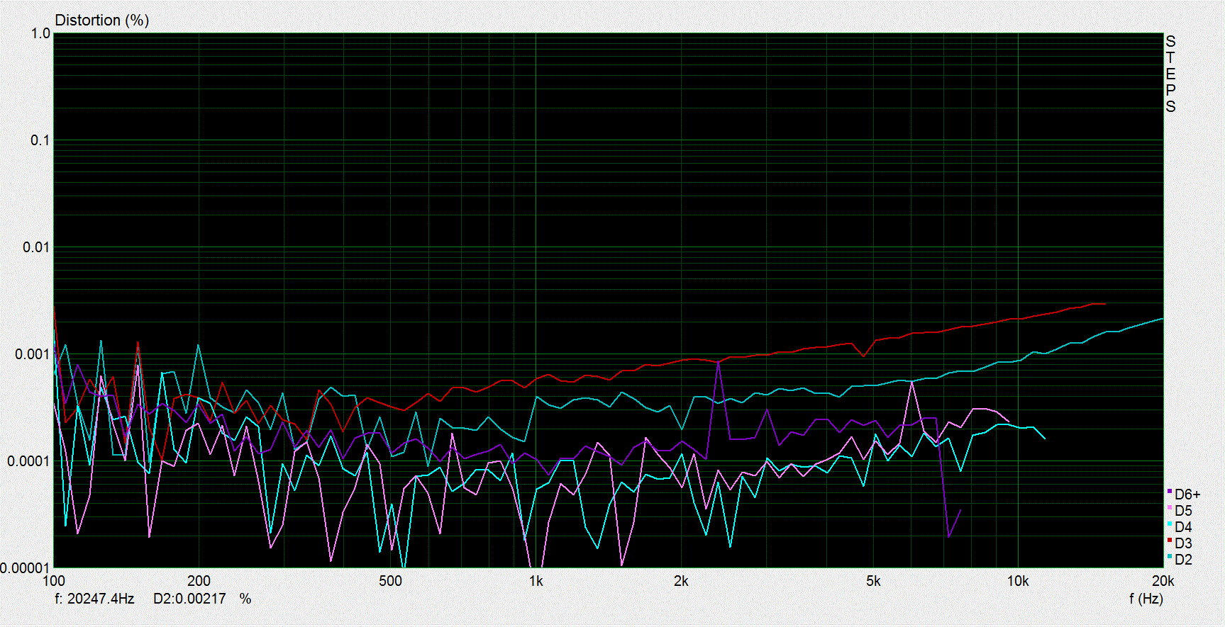

Now 25V RMS into 9.4 ohms, which is just a hair before clipping occurs.
Again distortion increases a little, which is to be expected.
And into 4.7 ohms.
As you can see, the amplifier seems pretty load invariant. It wasn't before. If any of the distortion mechanisms that rely on the injection of half sine-wave pulses into the sensitive areas of the amplifier were being contaminated in any way then I would expect the distortion to jump up when going from 9.4 to 4.7 ohms, here there's basically no change at all.
I don't think there's really much more to be squeezed out of the amplifier, unless one wanted to risk stability in some way (or go for higher power). The design now seems pretty free from layout and implementation issues and is certainly, I think, what one could call state of the art.

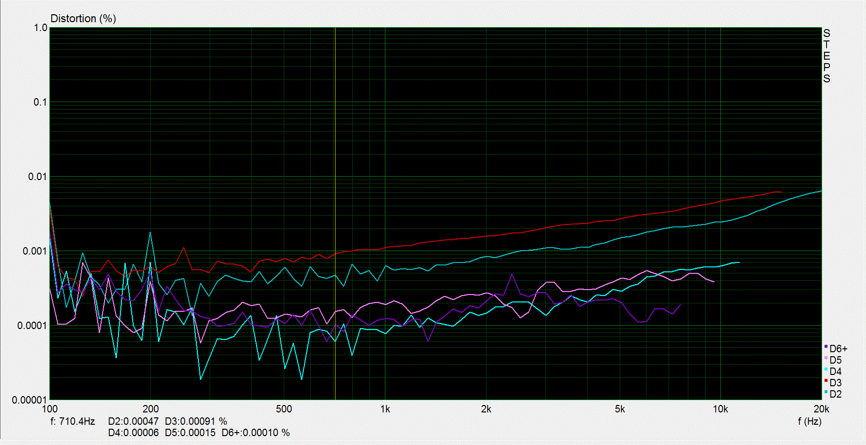

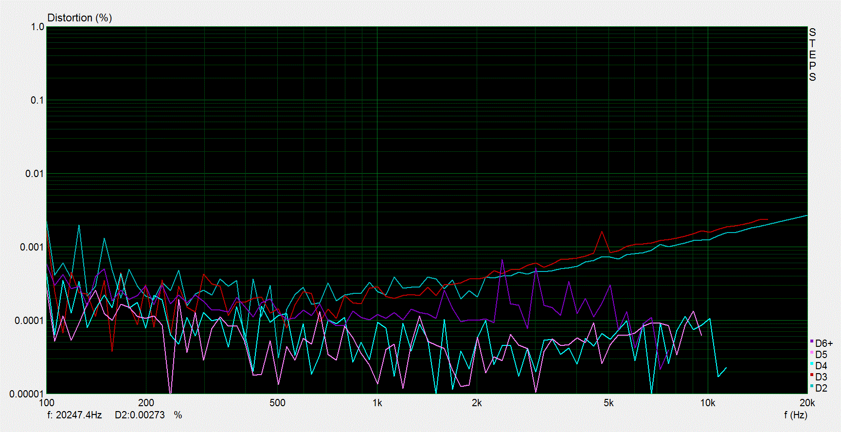

And into 4.7 ohms.

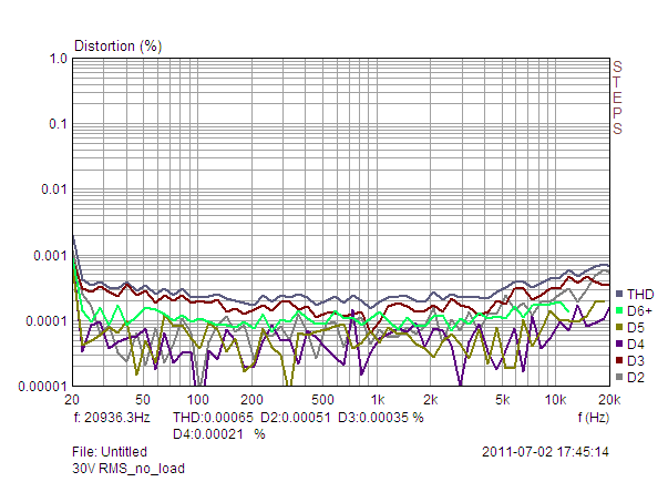

Okay so so much for calling this state of the art, there is clearly something *else* going on here that is reducing linearity a little.
Here is a distortion sweep of the amplifier doing 12.5VRMS into no load whatsoever.
That clearly isn't right as output stage distortion should be pretty much zero without any load attached, ie the amp should be running in class A with basically no extra current flowing through the OPS.
From memory input stage distortion doesn't depend on their being a load connected as it is loaded by the caps in the compensation network. Then there's the feedback network and compensation network itself. These don't depend on the load and if any component within is acting up it could cause something like this to show up.
There is still work to be done it seems.

What had you choosing that position on the transistor to mount your smd device? I don't know the layout of the die inside the transistor case but would have suspected that the center recess would be closer to the actual junction point. Does anybody know where the ideal mounting position would be to actually use this type of temp feedback controlling the bias voltage?
Mainly because the transistor fitted there 😀
No I kid you, that was part of it, but if you look at the power transistor itself, that little recess actually has the back side of the part of the metal 'slug' in it that would normally press against the heatsink. I figured that'd give a pretty direct connection to the die. The bias is now extremely stable.
Before when turned on at cold, the amp would start out at about 20mV, then increase to around 50mV, after which it would decrease again and stabilise around 23mV. This took a while to happen as the main heat sink needed to constantly equilibrate about a changing bias value.
Okay so I'm getting somewhere with the distortion measurements. It appears that the issue is with the resistor divider I am using to cut down the voltage prior to the signal reaching the sound card. I'll have to have a play with it to totally figure it out, but with a small change I've managed to change the 12.5VRMS into the 9.4 ohm load into this.
Okay so the noise floor is increasing as I'm adding in extra outboard attenuation to my box of tricks, but the distortion is way down at the high frequencies.
This needs to be figured out though because I've built some measurement hardware into my microphone pre amp to make measuring amplifiers and loudspeaker impedance etc, a lot easier. This is the first time I've used the amplifier side of it. It's quite possible that some of the surface mount resistors I am using and the DACT stepped attenuator I had left over (it provides variable attenuation) are becoming non linear with the highish voltage they are seeing.

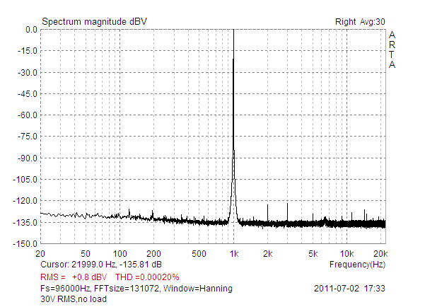

Here is what is able an amplifier with schematic very similar to the one I posted in this thread, 2 pairs SANKEN output transistors, 3EF output configuration (predriver, driver, end stage), Ub+-60V, SR 90V/us. SOAR protection implemented. Very low bias, only 30mA for one pair with Re=0,1R.
.33-.68R emitter resistors would be more optimal for 30mA bias, but if you can get away with 0.1R, I'd say it's a good deal.

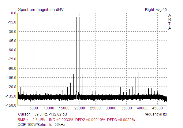

Those are actually very good. Would be interesting to see intermodulation picture as well, for example, with 2 input signals 14KHz and 15KHz, how high the difference frequency harmonic (1KHz) will appear? With the load (like 100W @ 8Ohm)...
Here is it. 1kHz difference about -120dB. With optimal bias it goes even lower, but with a lot of heath..
Excellent! Must be a very "transparent" one...
