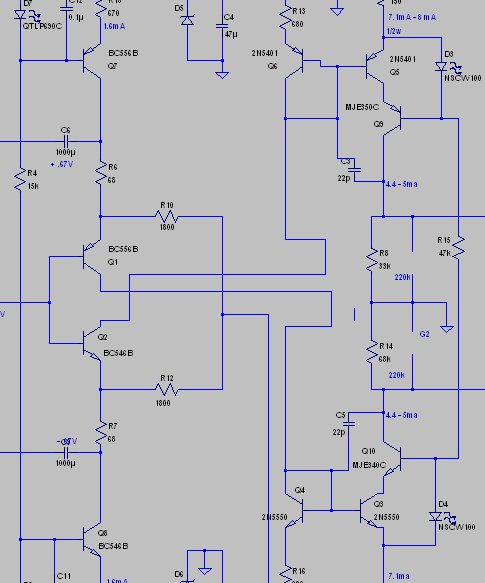

Imbalance in VAS loading
Hello,
I´ve been playing around with LTspice lately. Especially with the CFA-X model.
I have made an interesting observation by loading the vas unevenly.
Based on the simulation uneven loading at some resistor values actually seems to lower the total harmonic distortion while H2 is increased.
I am thinking of installing a pot together with the load resistors for listening experiments.
I just need to take the thumb out of the **** and finish the build during weekend.
BR,
J

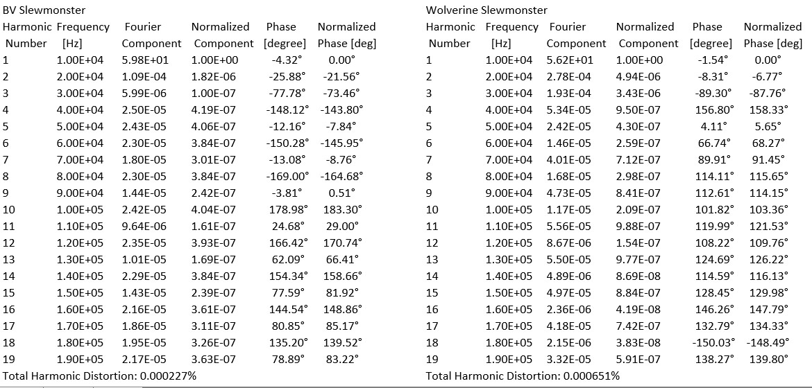

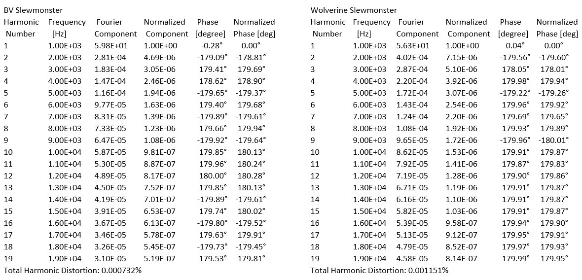

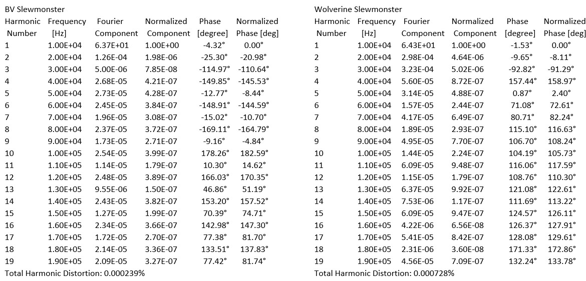

Try to use 10kHz input signal.
OK, this is the spice directive I used for both.
;ac oct 10 10 20000000
.options plotwinsize=0
.options numdgt=8
.param freq 10k
.param num_fft_pts 4096
.param timestep {1/{{freq} * {num_fft_pts}}}
.four {freq} 19 8 V(Vout)
.tran 0 {15/freq} {2/freq} {timestep}
Edit; I am adding a second chart. Both amps set to 130v p-p output. +-80vdc rails.

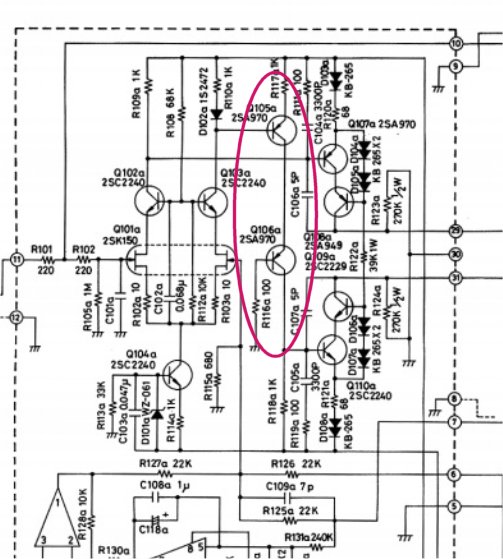

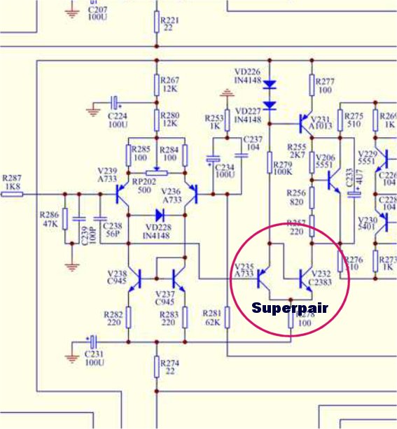

not gone yet ...
My "downtime" will most likely be 6/7 to 7/7 2014.
There are only a few topologies/variants that I have not touched on
that would go well with the slew EF3.
1. IC based .... either a high Vcc based LMxxxx based one, or a level shifted
symmetrical crown/QSC IPS with 15V supplies/TL071-5532 IC.
2. A simple ASKA/DX bootstrapped LIN amp without any CCS's.
Just simple resistors and a cascoded (low voltage)/ regulated LTP.
The regulated lower voltage would preserve PSRR without CCS's !
3. The "superpair" KODA type amp (below). Apex (audio) uses the
symmetrical version and Koda ... just a single ended version.
There are others ... but most fall into the "variant" category.
A fet IP pair "john curl" type IPS is the only other unique one.
Of course , with an error correcting or HEXFET OPS , there are
even more options 😀 .
PS- almost forgot .... a "wolverine" type input stage running a
Hawksford with a level shifter (like the original Luxman 120a -below 2) ...
might also make for listening pleasure.
OS

CFA-X (h) are both single stage CFA's that use just the single pair for
the high Z input and the low Z feedback.
NAD "splits" the job in two ... first stage is a high Z diamond buffer running
the low Z current feedback 2'nd stage.
PS- CFA-X is faster .... 2 stages increase group delay -(lower slew).
CFA-XH is fastest still .... hawksford feedforward (no early effect)
seems to increase speed even more (compared to "X").
OS
