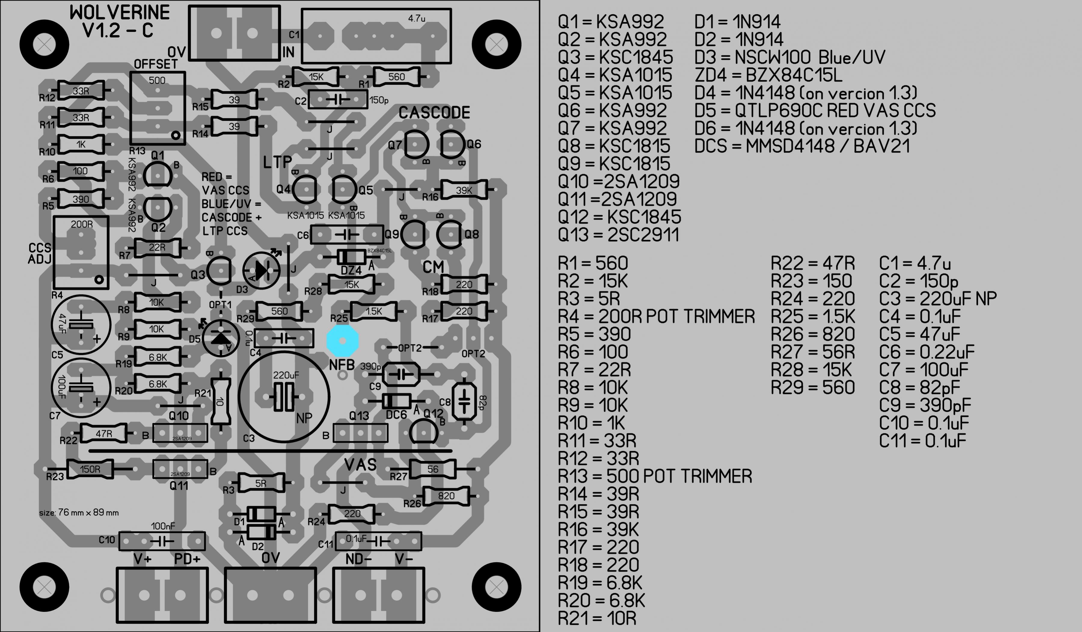

Hello guys
I decide to go with IPS "Wolverine" v1.3 and I have a few questions,
I was making a Part list and checking the data of the diodes and the LED's
are surface mount type
D3 = NSCW100 Blue/UV
D5 = QTLP690C RED VAS CCS
will any UV light LED will work ?

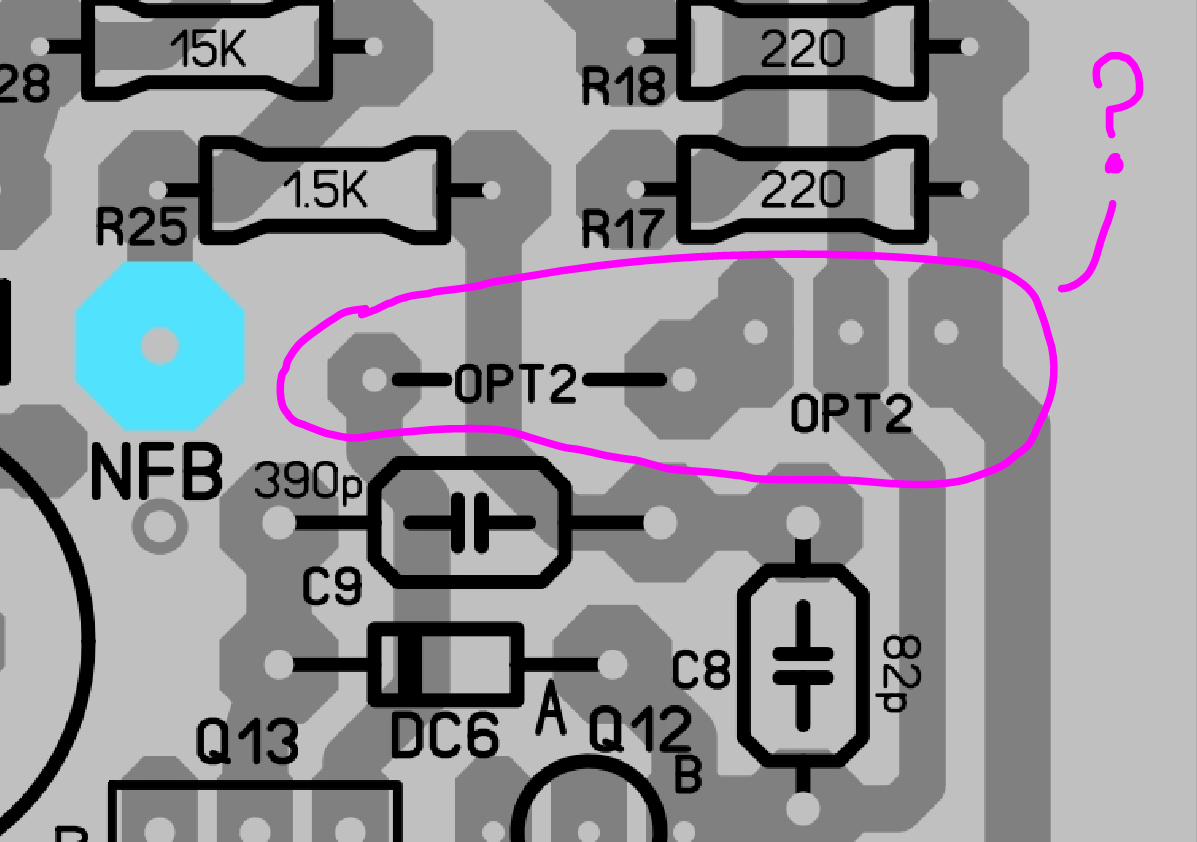

and the other question I see on the layout I see this "OPT2 and OPT2" I do not know what is it ? I'm not sure, look like an option to do something else 🙂
Juan

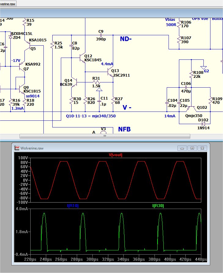

I explained the finer points of the LED metrics in the last post.
"OPT's" 1-2 ...
1 = ground reference of the input cascode. (just an option).
2= use of a active clamp for VAS saturation (instead of DC6).
Both methods result in the same clipping behavior.
(below example - R31 + Q14)
D. Self mentions and shows example of "opt 2"...
Edit - like the badger ... reverse leakage of DC6 is important. Find one with nA to pA
reverse leakage rating. The "option 2" (transistor) ... most have very low leakage --

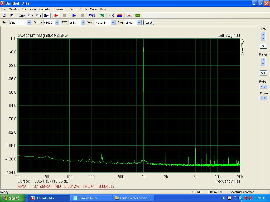

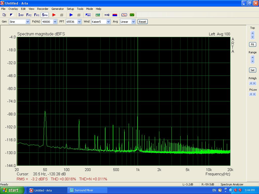

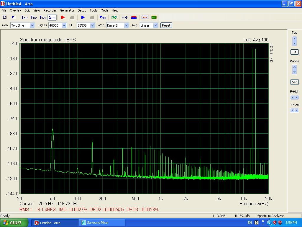

You've got some real issues going on there that need figuring out.
The wiring up of amplifiers, with respect to return currents, both in terms of wiring up the amplifier for every day use and then wiring it up for measurements, is critical.
The results that you've posted clearly show that there is something contaminating the results from how they should otherwise be.
As a simple test could you perform a measurement, like above, 14VRMS out, but without any load connected?

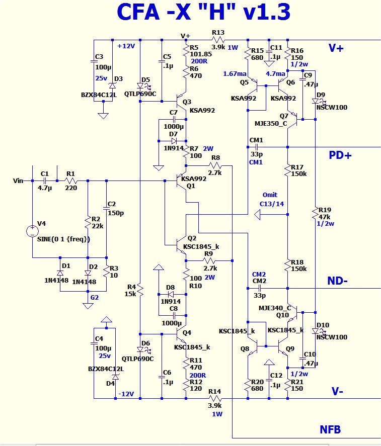

I know the problem. Thimios had it. C13-14 !!! Remove and replace those
33pF's into "CM1 and CM2" pads.
OS

Right. First of all, this helps to confirm what both I and triplej suspected. At least partially.
I do not know if you have read Self, thimios, but there are a few reasons why performance like this can occur.
Basically what we're looking at is low distortion with the sound card in loop-back mode and then distortion that looks almost identical with the amplifier working without a load. Things then turn sour when the load is connected. This isn't necessarily a surprise, as measuring power amplifier can be quite a challenge.
As the distortion is low without a load connected we can assume that there is no non linearity being cause by resistors or capacitors within the voltage divider to the PC and the feedback within the amplifier itself.
When you connect a load to an amplifier this causes several things to happen all of which occur because current is now having to flow within it.
The first issue is that as current is drawn from the supply rails it causes them to become modulated to the tune of what is imposed on the output. When a class AB amplifier is operating significantly out of class A the positive supply rail ends up being modulated by the positive going half of the signal alone with the reverse happening for the negative. When you decouple the power rails the decoupling capacitors couple some of this into the ground and contaminate it. This is why there are two ground listed in the schematics. The decoupling capacitors create a dirty ground into wherever they are connected and the sensitive areas of the amplifier end up seeing this and it destroys the amplifiers performance.
The way to go about making sure this doesn't happen is to split the grounds up inside the amplifier. Any decoupling capacitor should basically be connected to the same trace on the PCB and then this trace be connected back to the common point back at the reservoir capacitors.
The other areas on the PCB, such as the grounds where the current sources, the feedback network and the input network connect to need to go back to the common point via their own wire, however this in and of itself isn't enough. What you need to do is take a short piece of wire from the common point at the reservoir caps and connect it to a small piece of PCB. You then connect the wire from the feedback ground back to this piece of PCB. This keeps the dirty and clean grounds separate.
The return from the load, ie the negative loudspeaker terminal, needs to connect back to the clean ground and anything else, such as muting circuits needs to go back to the dirty one.
Doing the above sorts out one of the most insidious forms of distortion, the contamination of the clean signal ground from the dirty ground.
The next thing that happens with the modulated signal on the power rails is that it can inductively couple into sensitive areas of the amplifier circuitry too. If you've got power rails coming into the board via flying leads then how they are positioned can be critical. You need to keep them away from the input stage. This distortion gets worse as frequency increases and usually isn't particularly bad at 1kHz. That said, if this distortion is being a problem is can also be due to bad layout and cannot be fixed without a board revision.
If these two things are sorted out then there are a couple of other things that can cause a problem with the amp itself but they are usually quite benign.
The problem when you connect the amplifier to the computer is that you create loops between the mains wiring, the PC, the input connectors of the amplifier, the output of the sound card, the input of the sound card and the output of the amplifier. There is one important thing that you must make sure does not happen with this set up, otherwise it will destroy the measured performance. What can happen is that the return current from the load can end up flowing through the shield of the input connector/cable. If this happens it's bad.
Hopefully some of that might give you some things to try.

Here is the update 😱 (below) , DO NOT USE the C13/14 (shunt).
CM1/2 gave perfect operation when thimios switched.
Sorry - I have a lot going on now.
OS
