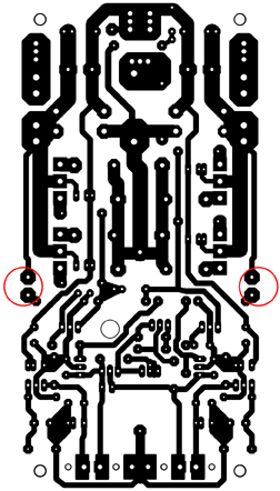

What are these pads / gaps? Mini-OS single sided boards. Thanks!!!
Jumpers. You can use them to run the driver stage off higher voltage rails (no jumper) or the same rails as the outputs (jumper'd).
Are there any other jumpers required due it being single sided? Thanks again!!!
Beyond those I've already mentioned, I'm not sure. I always built off my artwork and haven't etched any of OS's layouts
