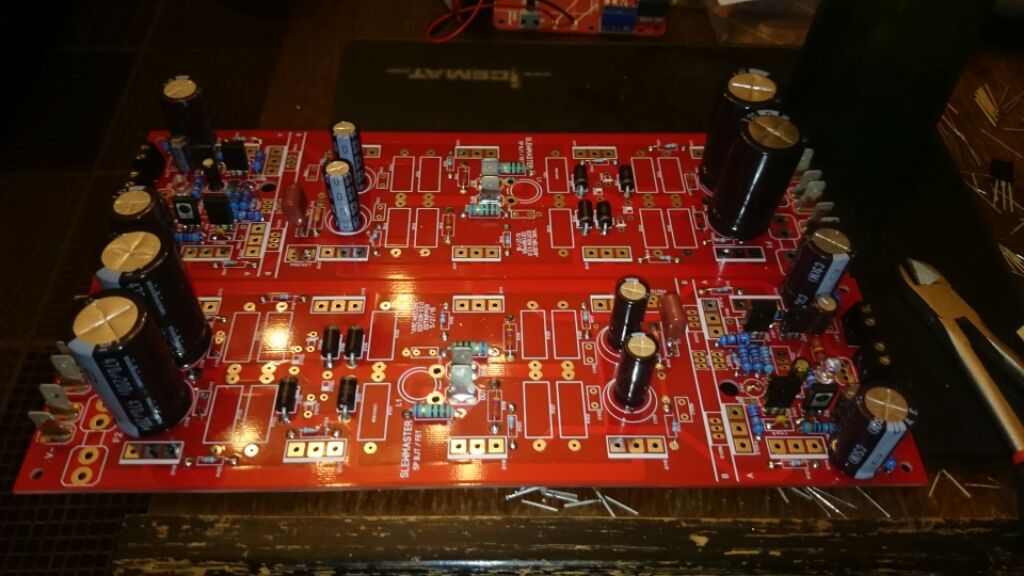

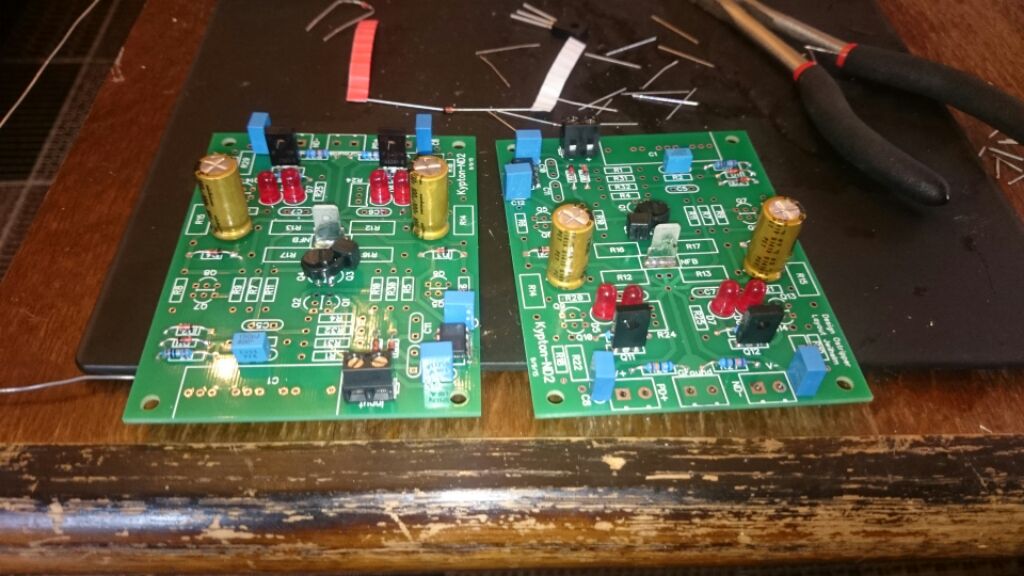

Started populating a pair KND and 5p ops today using parts from my junk box. 🙂
you are using fine parts, Nichicon Gold capacitors in inputstage?
Looking forward to hear about your setup when you are finish

I'm a little embarrased about the Nichicon audio grades because I don't believe in audiophile components. They cost about the same as the regular Nichicon and the gold color gives me the warm fuzzy feeling inside. 😛
+-70vdc should be OK for 5 pair output....wait for more experienced answers.
That is quite an experienced answer !
60 V is best for <4R , 70-75v for >4R. SOA can be even better with
typical musical material than a continuous test tone.
I've even paralleled 8R speakers on a channel with no issues @ 72V.
OS
Thanks Os, as I say, the secondary output wires of the 600VA transformers looks much thinner than the 400 Va trannies, about 2.5 mmsq against about 1mmsq. I suppose the voltage will will drop under more than normal load. I will give it a go for a complete dual mono setup.
I doubt you will see a voltage drop from thinner wires. The main thing to watch for is the wires over heating if there is too much current demand. Thinner wires may indicate that the VA rating is exaggerated. If that is the case you may see voltage drop due to low current handling.
