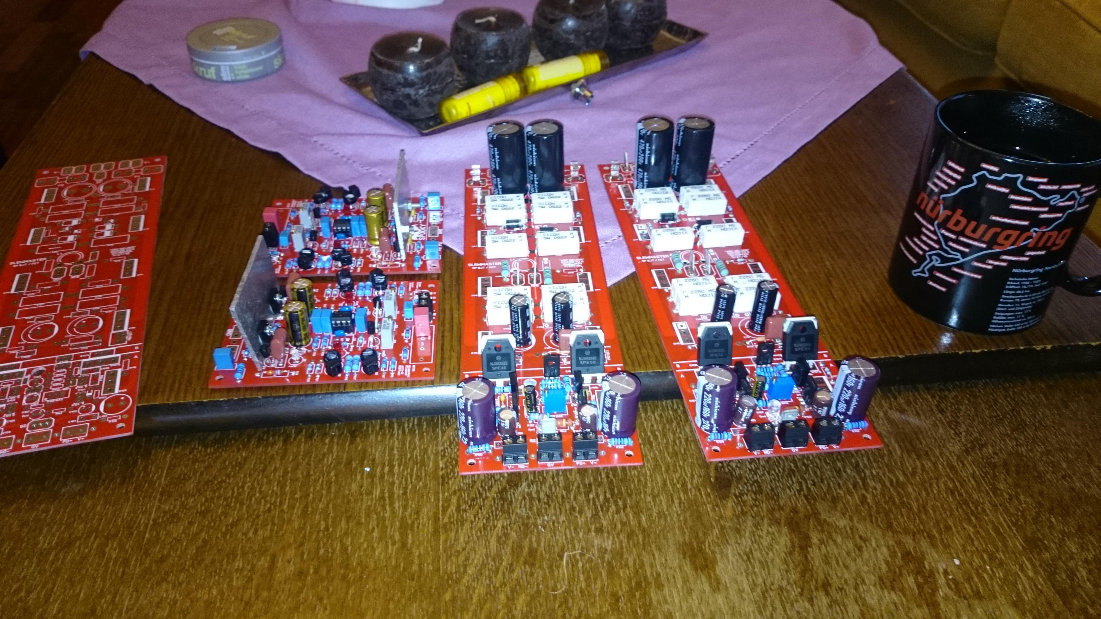

-post 1102Just a few more pictures.

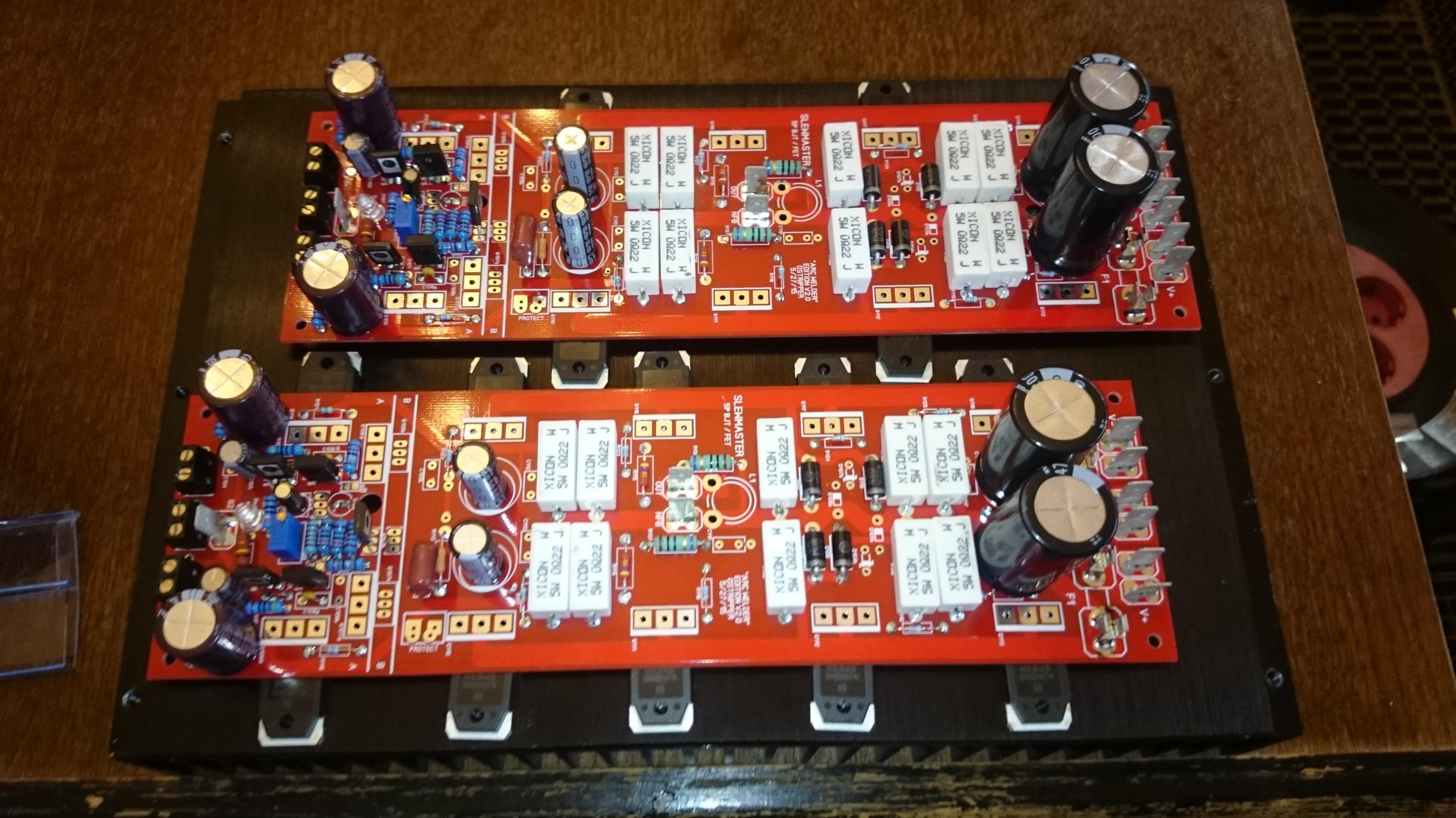

Hi Jason, i have installed only one pair of Ouput and measures the voltage across the 0.22R as in the picture but no readings. Should i measure any other readings else where to verify the circuit is working ?.

Trace out the board, you are measuring across the wrong 0R22 resistors. Move your probes over one set.
Jason, once again thanks for your help. You know what, i feel like a bloody idiot. Just to say never to make an assumption. I thought -last output pair would correlate with the corresponding emitter resistors. How wrong!!!. I am glad it is all sorted now. I just biased slowly to test it-10mA only. I will follow the procedure as outline previously earlier in the thread. Aim about 90mA ?.Thanks Jason.
Quan
Hi quan,
No worries, I'm sure if I hadn't spent some time really looking at the layout I would have made the same assumption. I missed the clue in your pictures, so I could have noticed earlier but apparently did not.
Either way, we still had to sort the bias generator. For bias, I believe Valery tested and got the best result at 90mA. That is in the ball park of suggested biasing seen elswhere, so the 90-100mA target I feel is good.
