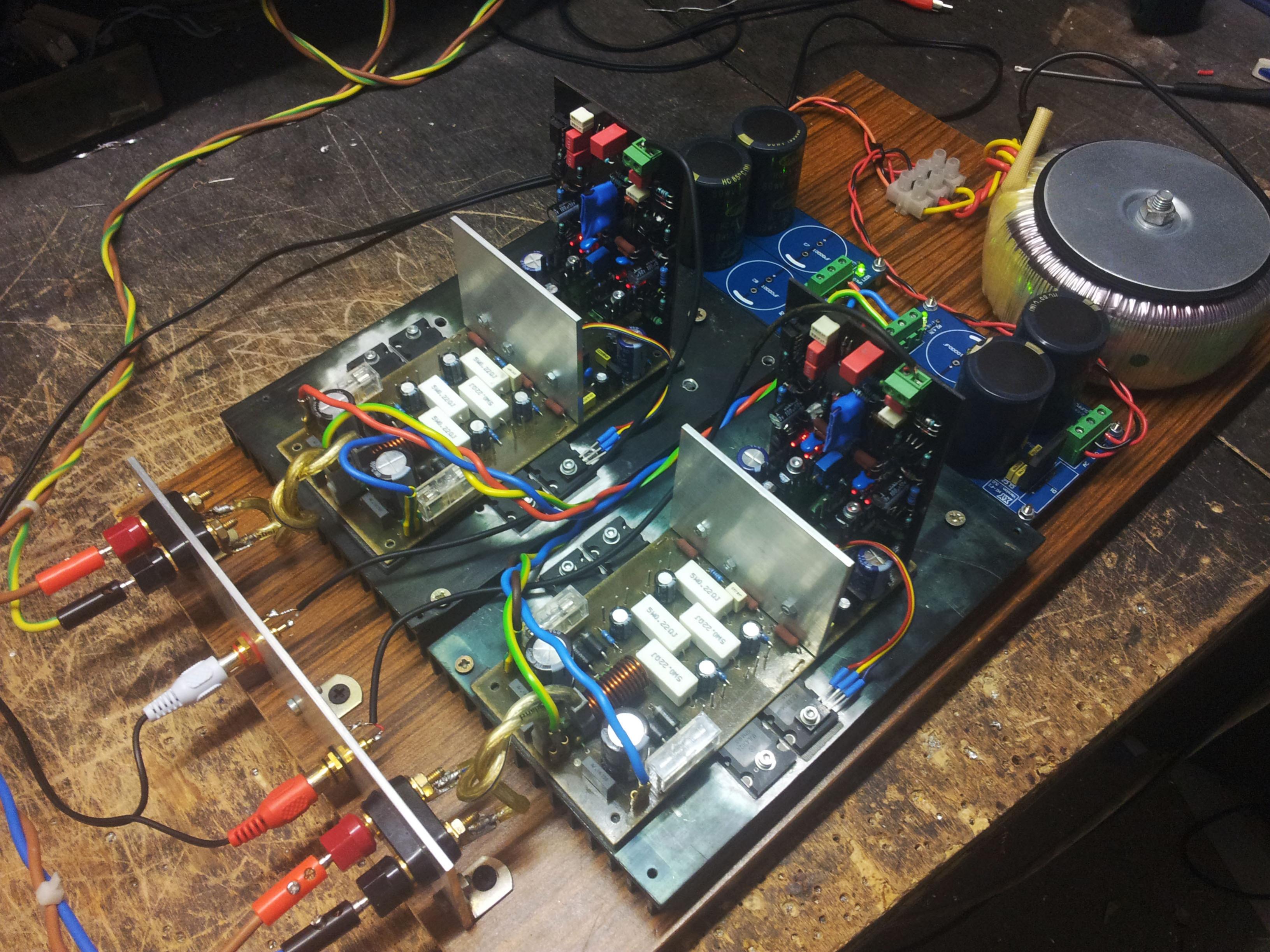

I built my HEXFET OPS from the altered schematic that Valery posted. It was a little tricky as I had not used those Vertical MOSFETS before. I had to rely on advice throughout the build. I know you have to use the search feature which takes time but if you want to learn it is worth the time to go back through the thread and read through whatever IPS or OPS you are planning to build. I build a lot but I am still quite the novice when it comes to circuitry. I am finally getting to the point where I can solve some of my own issues. I can relate to your pain. I blew up a lot of parts when I first started. LIGHT BULB TESTER!!!!!!!! If that wasn't loud enough let me repeat. LIGHT BULB TESTER!!!!!!!! You can build one for the price you paid for shipping on your last order. Stop burning outputs. You might still lose a small transistor here and there when your test lead slips or burn a few resistors but 99% of time it will save your outputs.

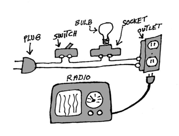

Would you mind putting up a schematic of the light bulb tester? I thought it was just a bulb put across the output.
It's a bulb in series with your mains power to your transformer. It will limit your available power to your power supply to whatever your bulb rating is.

I think something like these (please correct me if I'm wrong)
AndrewT gave the idea to me after I burn semis and other parts.

For some reason I thought that the bulb was used as the load on the amp. So it is just like a large resistor on the power line before the amp or whatever circuit you are using. I thought that some used the bulb with a variac?

If you have a variac that is the best at start up slowly raise the voltage but the bulb tester helps to. That give you protection not to blew up your amp.
Will glow if something wrong

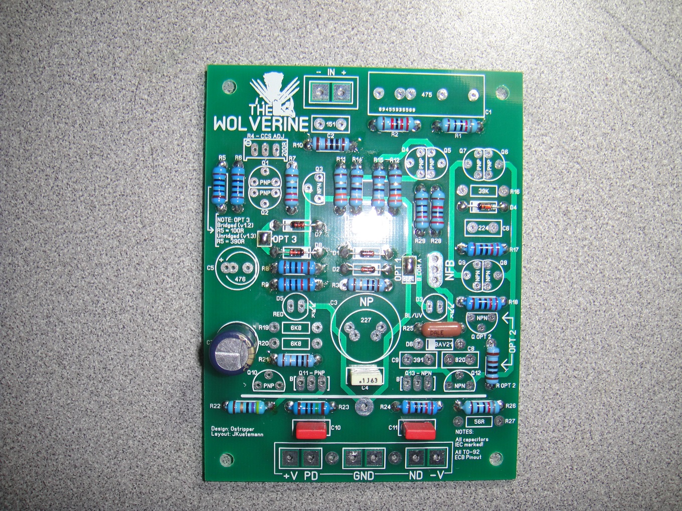

Hi guys, running into a bit of trouble. Spooky IPS D8 is not lighting up?. Any advice where to start trouble shoot?. Also when i tried to measured R28 or R29 current then the LED light up?. My other board D7 is not on either?.

Check the obvious stuff first, orientation, part values. ect. Next, compare voltages in the circuit between the positive side and the negative side.
Voltage drop across R25 should be close to the same as R29. If R29 voltage drop is high, you likely have excessive current flow through Q13/Q14.
I had some LEDs where the flat on the package was not the cathode. Verify your polarity with a meter.
