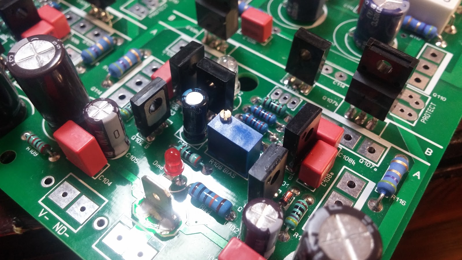

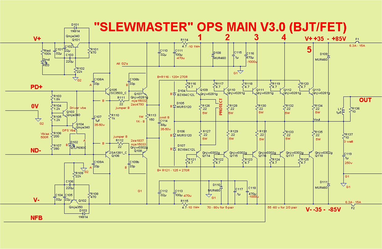

maxwell007,
I know that the build can be confusing...having more then one option on a board does not help. You need to follow option A in the attached schematic for your BJT output devices.
The mosfet option (labeled B on the new boards you have) was discussed around post 3795 in the main slewmaster thread http://www.diyaudio.com/forums/solid-state/248105-slewmaster-cfa-vs-vfa-rumble-76.html
and around post 160 in the slewmaster build thread. http://www.diyaudio.com/forums/solid-state/260268-slewmaster-builds-4.html

Maybe folks could check me here and correct or add as needed. I admit to not being the most technically adept person here...Just a good instruction follower.
For BJT outputs you:
install all the semiconductors
Jumper D102
Install c 108/109a not c108/109b
leave off zener diodes d104/105/106/107

Suggested parts are clearly listed right on the schematic for almost all inputs and outputs. That's really better than any BOM if people take the time to look at it. This latest output board definitely needs a little more though. I'll try to make it a little more useful later today if I get time. Part selection in one colour for BJT and another colour for FET would probably help a lot.
