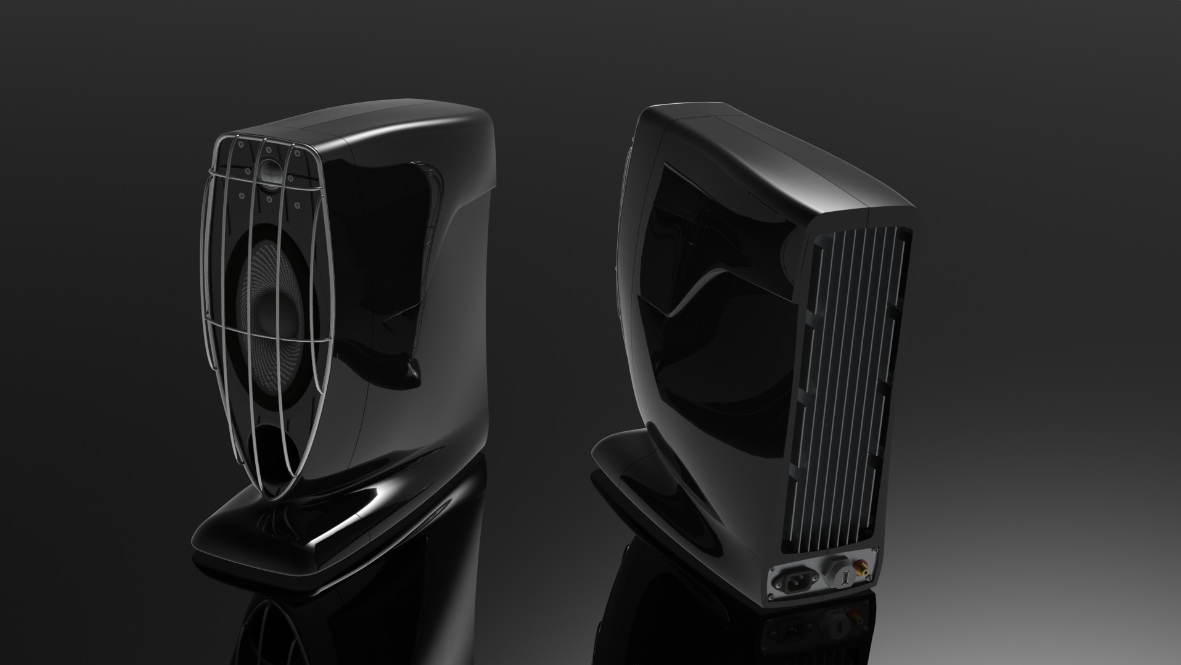

Okay,
Here goes the first published picture of my design as it stands today. I might as well get some feedback at this point on the looks. The screws on the tweeter will be gone, this was an early rendering and I will change the way it attaches to the enclosure. the four center screws will have to remain but the others will be gone. The port is going away, would need to be either to long or to small a diameter to be practical and not have chuffing noises from a to small diameter port.
Steven, it looks very cool. Being able to use a small signal xo and then separate channels for tweeters and woofers - gives a lot of freedom for tuning the whole thing up the optimal way. I like the concept, the size and the look
Thank you Valery,
I wish I knew as much about the electrical side as I do on the acoustics side but this thread and keeping my head in some books is helping there. Now I have to shrink all this Slewmaster design down to size.
Okay,
Something like that would definitely need a SMPS 35-0-35v PS running those 2 SMD OPS's I described. Those OPS' would just need 4 MT-100 devices
for 40W X 2.
If you are trying to make the sub more compact , SMPS might be the way
there as well.
PS - Or just put all 5 amps in the sub , that would allow for a unified protection (5 fet relays).
Here , you would need 15-0-15 , 35-0-35 and >50-0-50V (sub / satellites/control-EQ).
On my sub , I'm using my 15-0-15V for both Val's protection and the sub EQ.
You might want to wait till me and Jwilhelm finish the subs (we will perfect it).
I'd use a simple CFA-X type IPS for your satellites , as well.
OS
Os,
With no sub the speakers I just showed will hit 35hz. Yes you can add a sub but in normal use not listening to movie soundtracks not necessary in the least. They will make your cloths move, believe it or not. The motor on the bass/mid has a 1 1/4 long gap, the surround is limiting the movement, something I plan on addressing with something never seen before. The driver has a 1 1/2" voicecoil and will handle 150 watts, problem right now is you hit the end of the surrounds physical length long before anything else will fail, the only problem with the design to overcome. Right now the p-p movement is about 3/4" before it will bind the surround with full tension. I am serious when I say you can barely stay in the room at full output, as it is now, they are very loud. All the development was done with a round cone in a standard metallic frame and I have only changed the shape of the cone to the elliptical shape you see now. These are like nothing ever done before, not a clone of anything else but over 20 years of development. I need to finish this before I get to damned old to care!
This design has no normal frame, the frame is part of the molded enclosure and has very little surface area to affect the rear of the cones air movement. There are 9 piece of MGOe 52 Neodymium magnets in there and there is both a radial and axial magnet section. I have pushed the linear motor as far as you can, I have stayed on top of Neo development and when the energy goes up I will go up with that. Because it is a very long linear gap motor it does not act like any speaker you have ever heard before. Of course to do that I had to give up max efficiency to make the most linear design I could do. The overall diameter of the motor assembly is only 3" but very deep. Lots of high grade magnets and steel in that motor. No cheap Chinese 1010 steel in this design, electrical steel is the only thing that will handle the flux density. I have done the magnetic analysis of flux path and eddy current and there is a full length Faraday sleeve. This is no toy, I am trying to shake up the market with this design.
ps. The prototypes were used to mix the final soundtrack for one of the Superman movies and a few other albums. A friend who was the VP of music development at Disney had a pair at the studios. They were the only speakers allowed in the facility that weren't by Sony, they had an exclusive deal for all internal speaker systems. When he left there he took them out. I have some pairs out there that have been running for about 20 years now, the only failure was with the tweeters I originally used which I did not make. The design that you see has a 1" Be tweeter that I designed to go with the cone driver. Very different than anything else I have ever seen. Closest thing would be a Revelator and I think my design is better than that.
