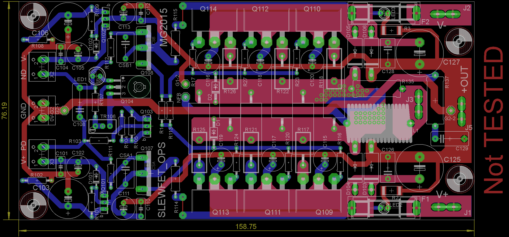

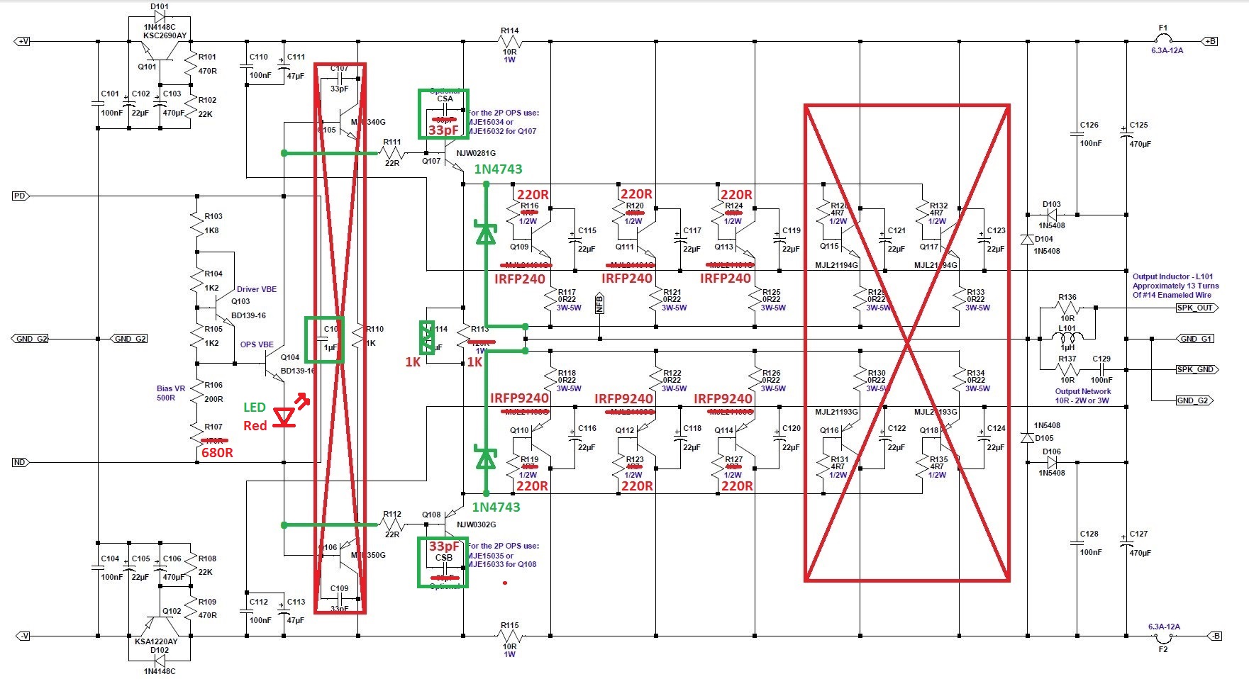

You are building a mosfet output board so you can't use the normal Slewmaster output board schematic.[/QUOTE]
now you lost me again
printed from os site slew main schematic called slewmaster ops main.
if this is from his site and can't be used what now?
how is anyone going to know this.
man this is a crazy to find info project.

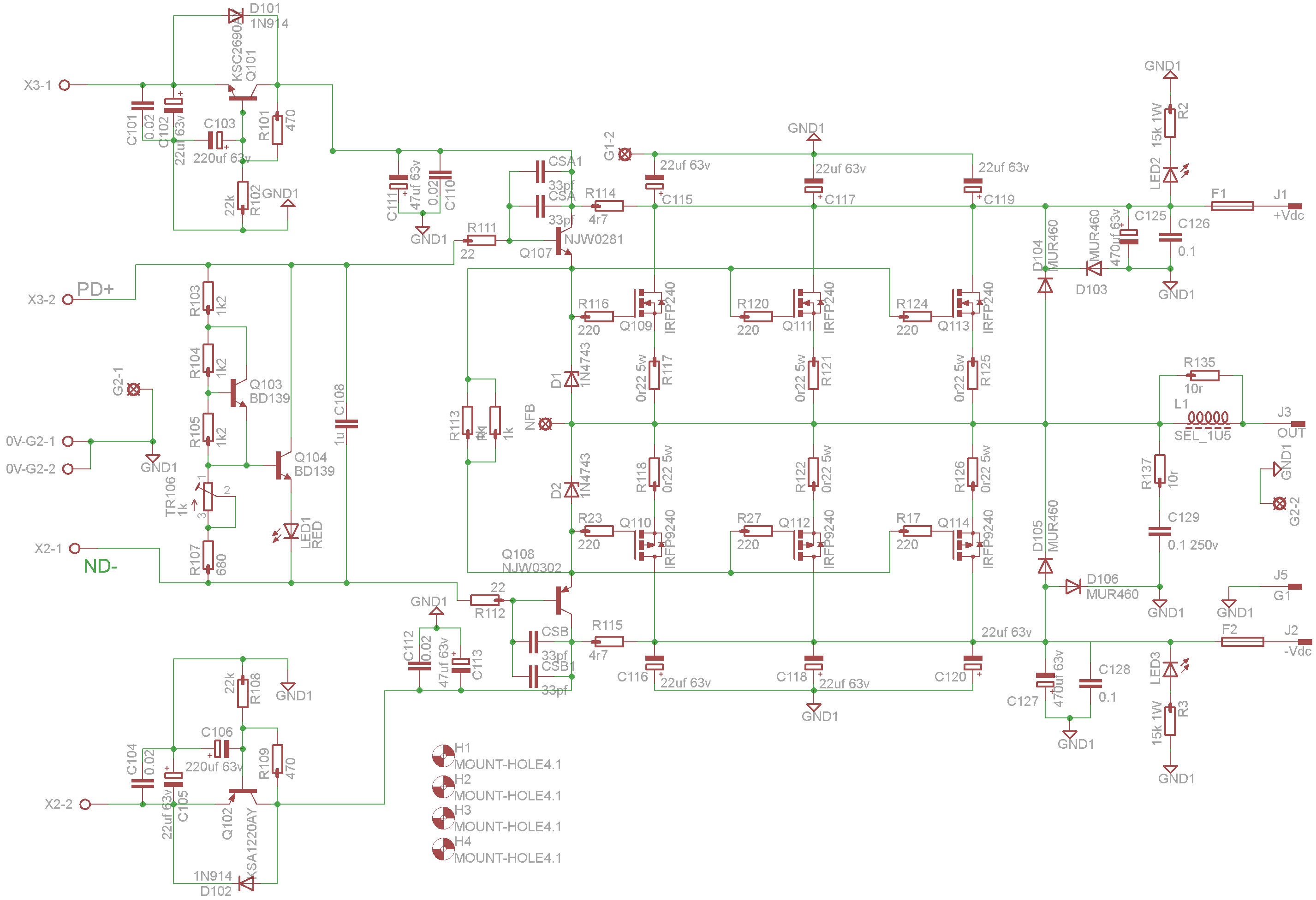

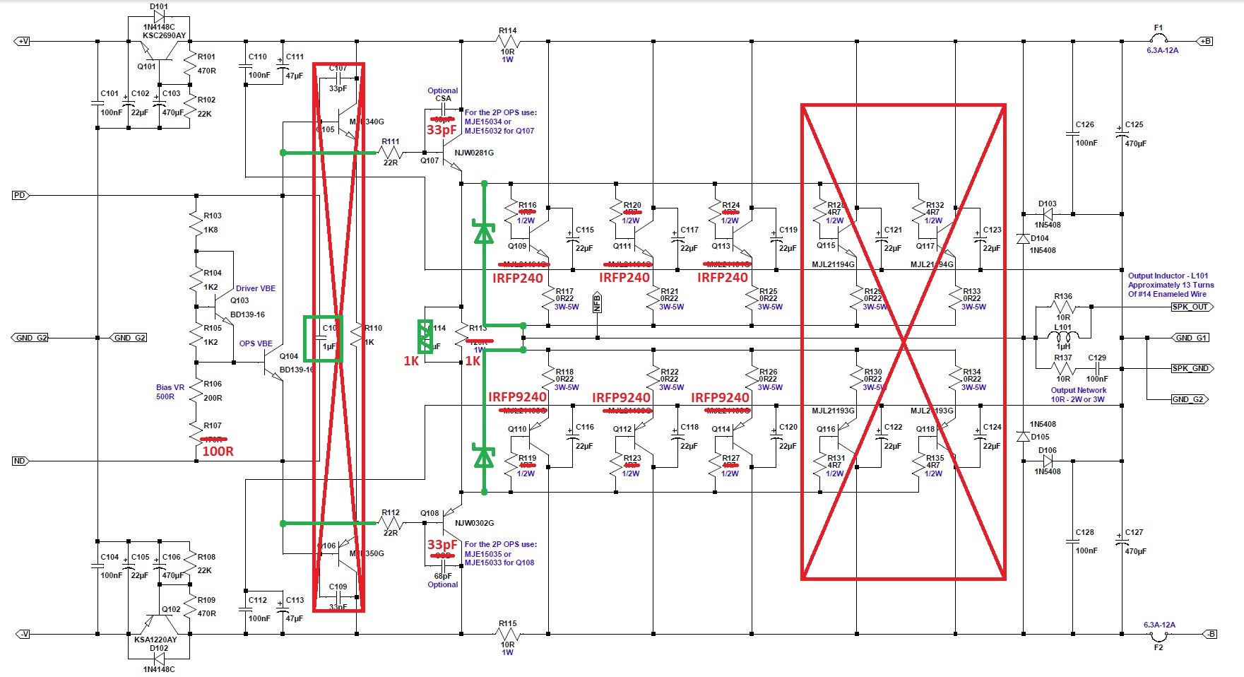

Valery and Jason did some custom designing to make these boards work with Hexfet output devices but you need to follow a different schematic if you are going to use them. You don't use pre-drivers with them and your bias circuit changes a bit.
Here is the schematic for the MOSFET version. I built mine with 5 pair because I plan to use it with pretty high voltage rails. I hope to get around to that some day.
There's an LED missing in that schematic. This is the schematic Valery posted yesterday.

guys tonite you have me dumb founded
mosfet ? i was told this board uses hexfet which i have on order. so which is it?
the above schematic is nothing like what is from os site.

You can run Hexfets in these boards but you need to follow the Hexfet schematic and do a little modifying on the board. If you want to run BJT outputs you need to follow the standard schematic and use the boards as is.

Hexfet is another name for Vertical MOSFET. If you bought IRFP240/9240 you are golden. A little history. A few months ago OS had to move and because of that he was gone for two or three months. Us Slewmaster fans got bored and in a effort to keep the thread interesting, Valery provided some IPS units as well as the idea to use vertical MOSFETs with the Slewmaster OPS. A few of us built it. It works great and takes fewer parts. The hexfets are a little cheaper too. You're going to be fine, don't panic we are here for you.

The term MOSFET covers a very broad variety of devices. HEXFET is a type of MOSFET, an 'enhancement mode' type of device with a 'cellular' vertical architecture. In the case of what you are talking about, if I understand you correctly, is that you chose to order some IRFP240 and IRFP9240, which are International Rectifier's HEXFET technology, now available via second source supplier such as Vishay. There is nothing wrong with using these.
Let me try clarify the situation, hopefully. The designer, ostripper, created the circuit as a BJT based 'Triple EF' style output stage. At some point, both myself and Valery were thinking that vertical MOSFETs would also be usable with the boards that were already laid out. After some trials we found an arrangement that allowed the use of the boards with vertical MOSFETs. We ultimately settled on using one stage of BJTs to drive the gates of the MOSFETs and modified the bias circuit to get good thermal behavior from the MOSFET devices. The MOSFET 'option' will require you to follow the modified schematic. Not a big deal, just be aware that a few parts are replaced with jumpers, some left off entirely and one part (the LED) was never in the original design. The boards do not have to be cut or damaged to go with MOSFETs.
If you are really new to this type of build you have a couple choices to make. You have the MOSFETs already on order, so you can choose to use them with the understanding that the arrangement was developed after the boards were already in existence as a BJT based design, or switch to BJTs and build it as ostripper originally designed.

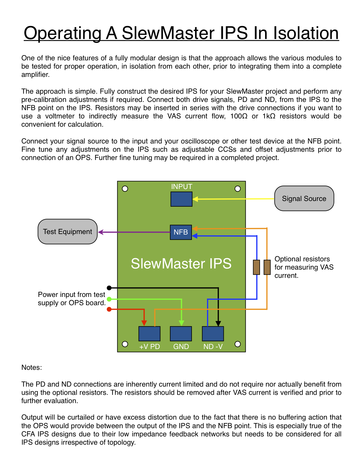

One of the nice aspects of this design is that it is modular. You can build and functionally check the individual boards on their own. If the OPS is making you uneasy, start with the IPS.

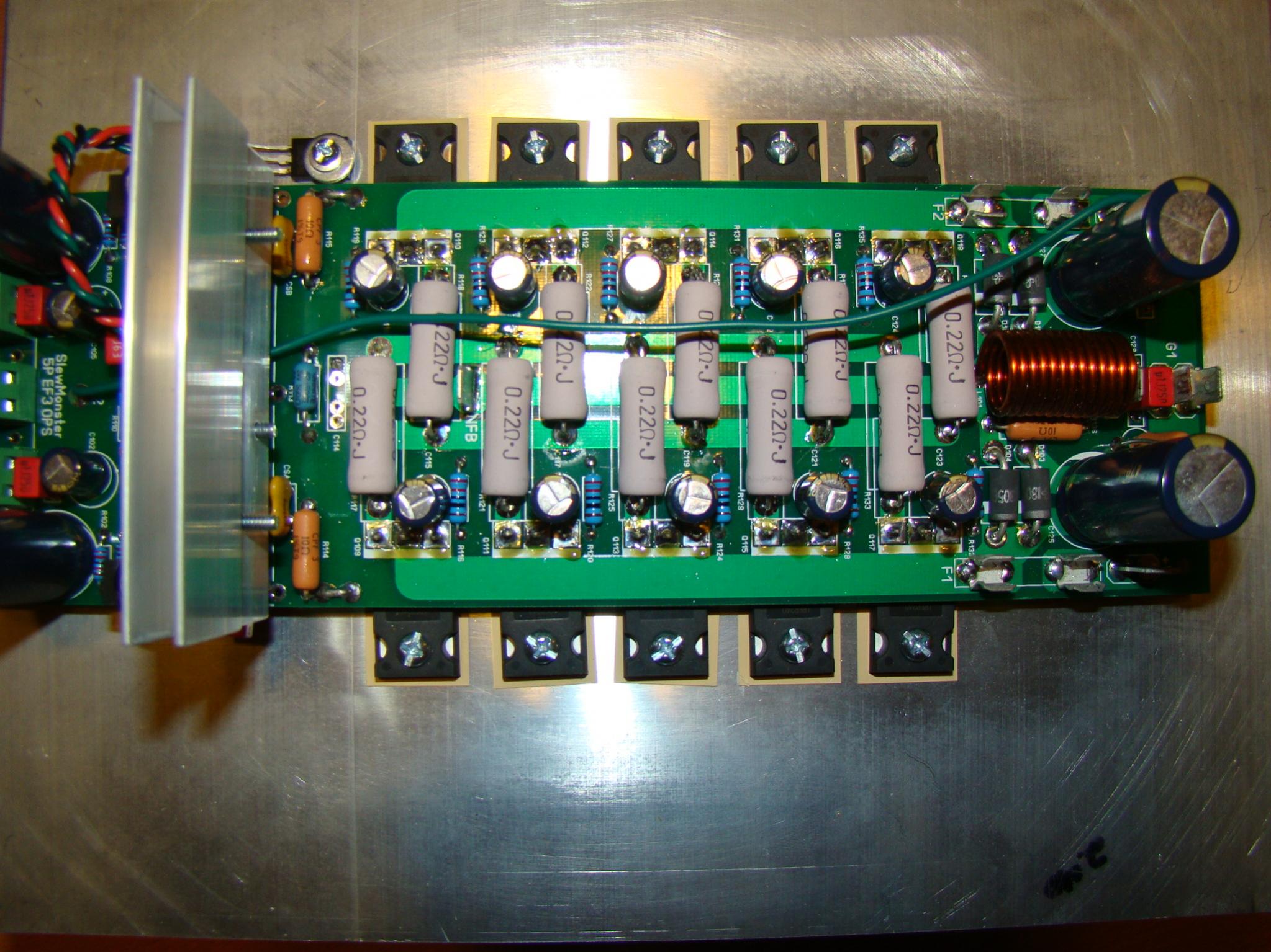

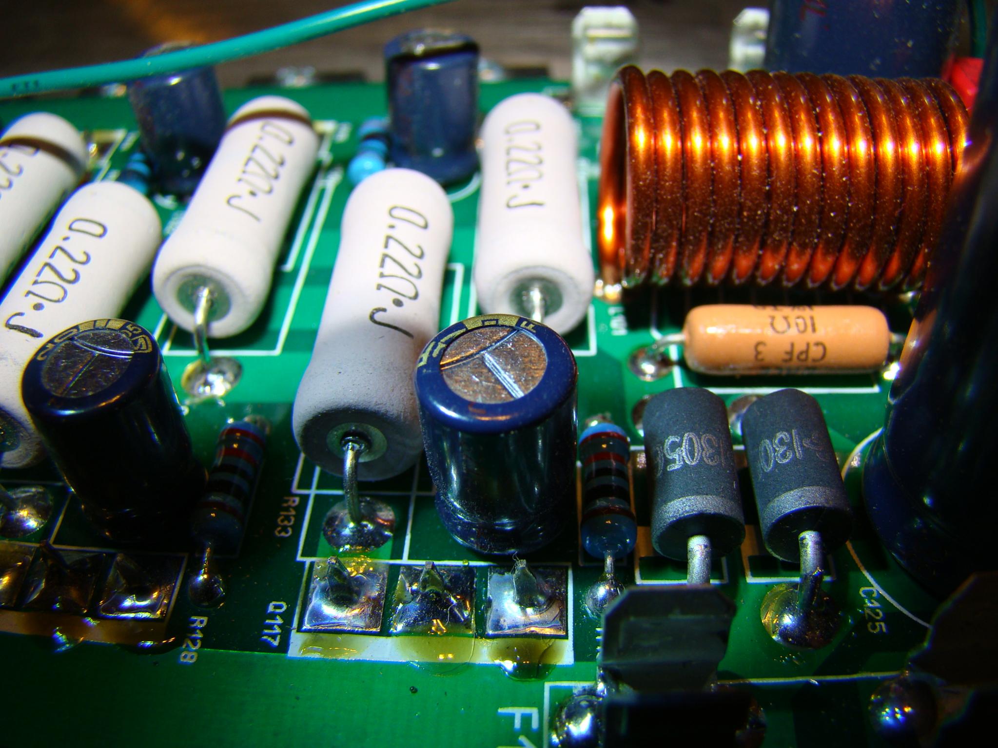

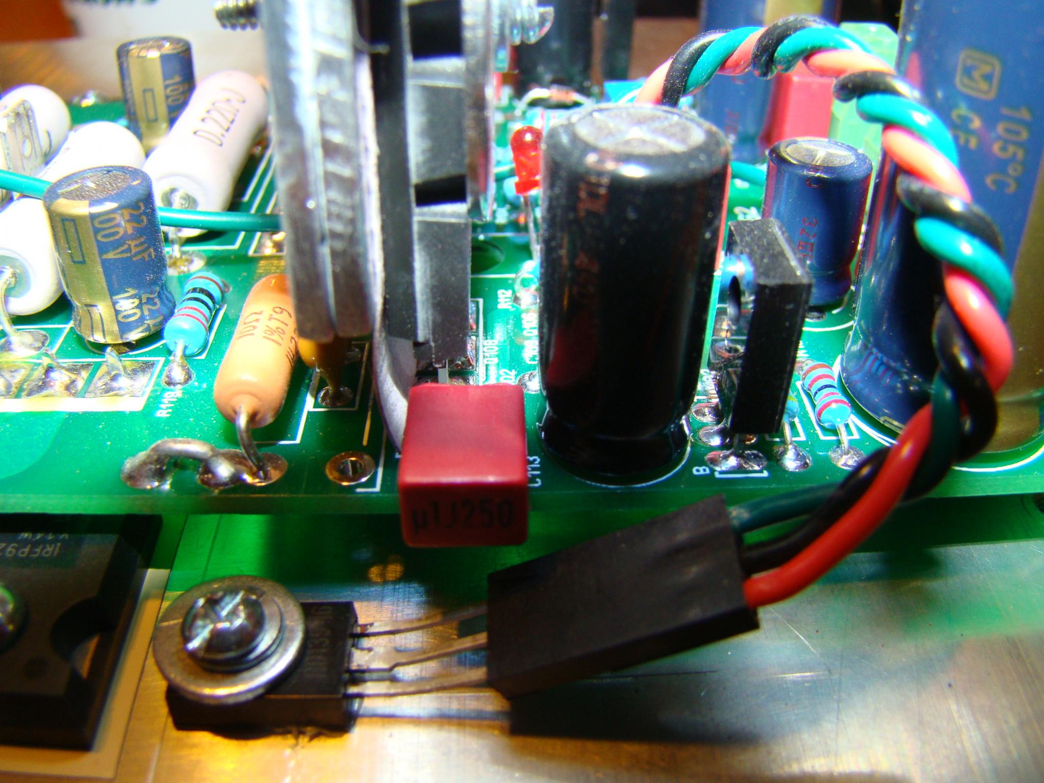

Did you need to cut a trace for the LED or did you get creative with one leg on Q104?
Just got creative, no cutting required. I think Terry and evanc drilled a hole in the board to 'mount' the LED, but I believe that was it for board modifications, and even that was not necessary.

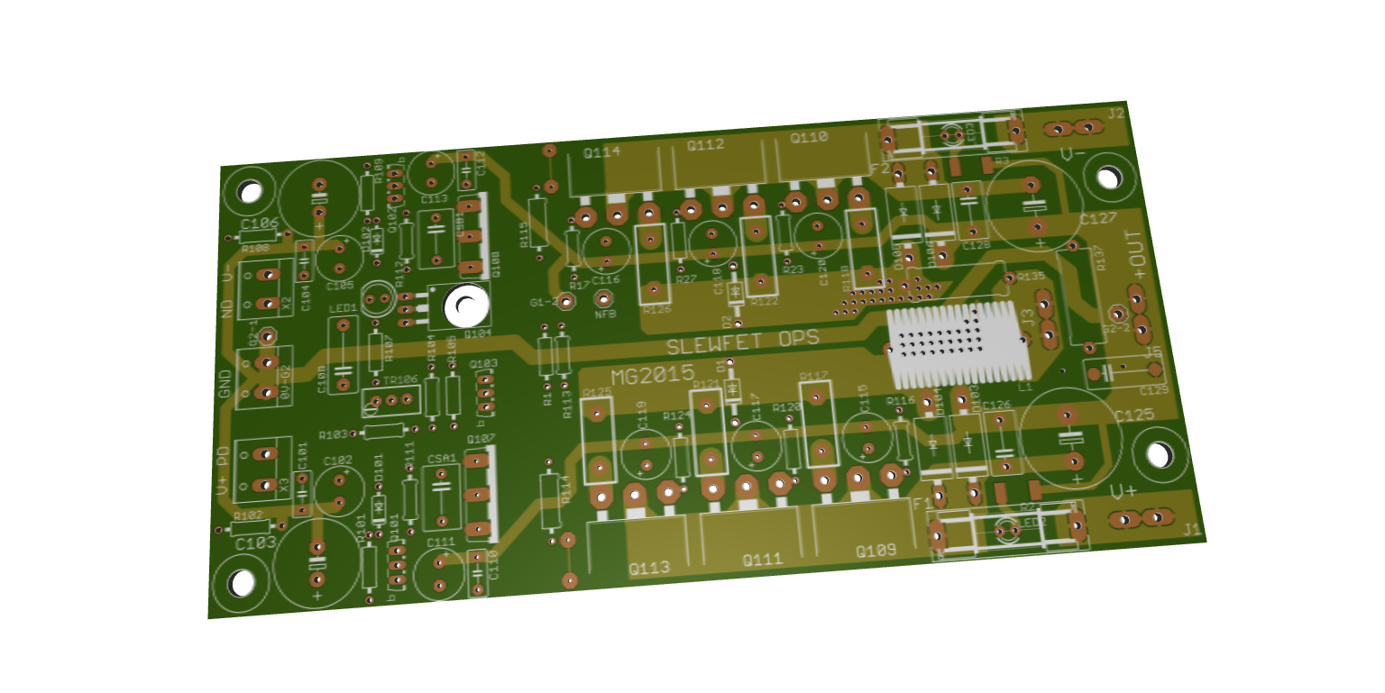

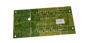

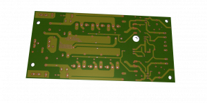

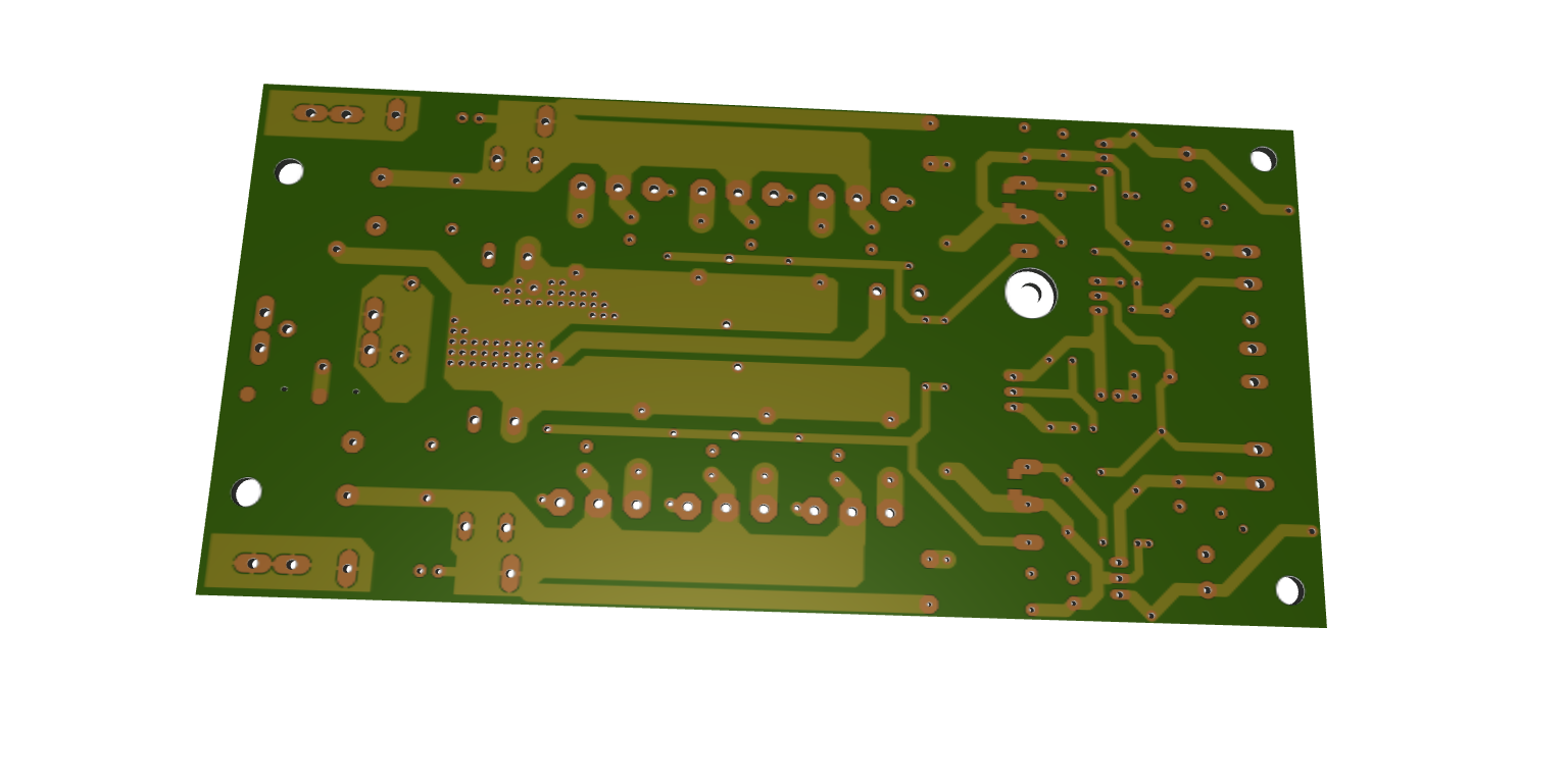

Hi GKF!
So, first you need to get the PCBs (either original Slewmaster, or the one Marc just presented above) and order the required parts. For better understanding - schematic in post #406 is correct. I just was too lazy to re-draw it, so I have only showed the changes. I also did not re-draw the mosfets instead of BJTs, only changed their names.
Now, based on that, Marc went further, and now we have the full schematic and even a Pcb, fully following it (post #414).

all i can tell you about my boards is they are marked slewmonster 5p ef3 ops.
i bought a matched set of 20 irfp240 and irfp9240.

I like to make a list of all the parts as per the schematic. Then I sit with the boards in front of me and using the mouser or digikey site choose the parts being mindful of not just the values but also size and pin spacing. This can take some time but is better then getting a bunch of stuff that does not fit the board.
On my mosfet slewmaster I used fairchild fjl43150/42150 parts as drivers, otherwise I used what the schematic called for.

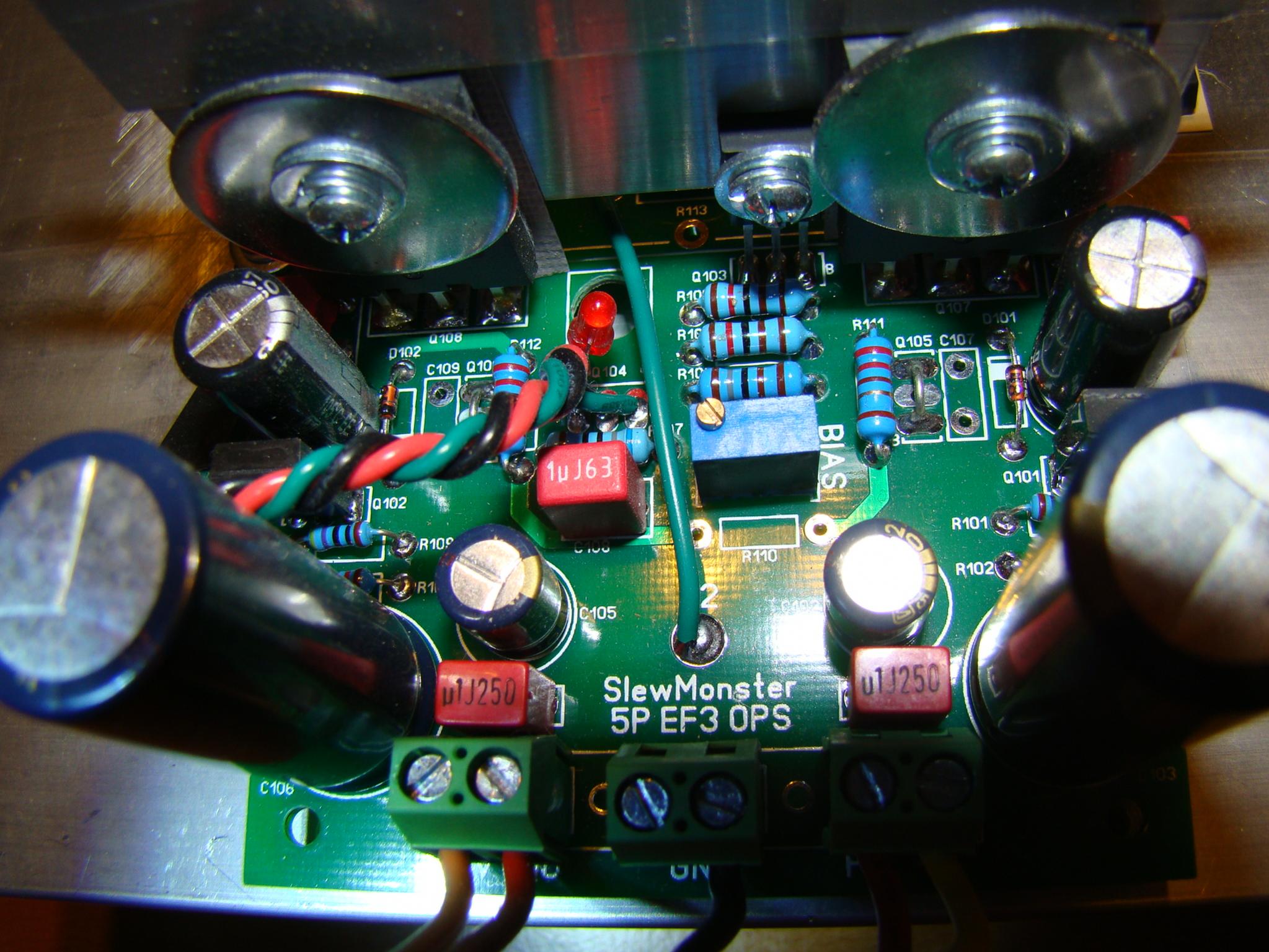

I'll post some photos of the completed boards when I get to my home computer

terry posted the cfa schematic above , this took about 1 hour to do material list.
he also posted the ops schematic showing red boxes and green lines what is this about?
