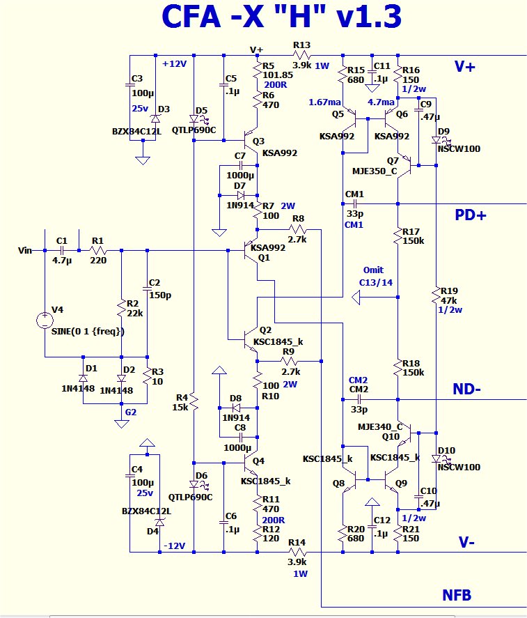

There hasn't been any real BOM for these boards. Most items are pretty generic and that means you can just build off the schematic.
Most resistors can be 1/4W unless you see a larger footprint on the board, in which case you need a larger unit. The semiconductors on the schematics are usually the recommended ones, though substitutions are possible. Just mind the pin-out of the devices.

Just a note. I checked ostripper's archive and he has put the CFA-X v1.2 there but not the CFA-XH v1.3 which is the version of the schematic you need to reference for the boards you have, linked above.

A Slewmonster is a Slewmaster with 5 output pairs. It's just the big daddy of the Slewmasters.

Slewmonster is just nick name. Slewmaster is the proper name.
