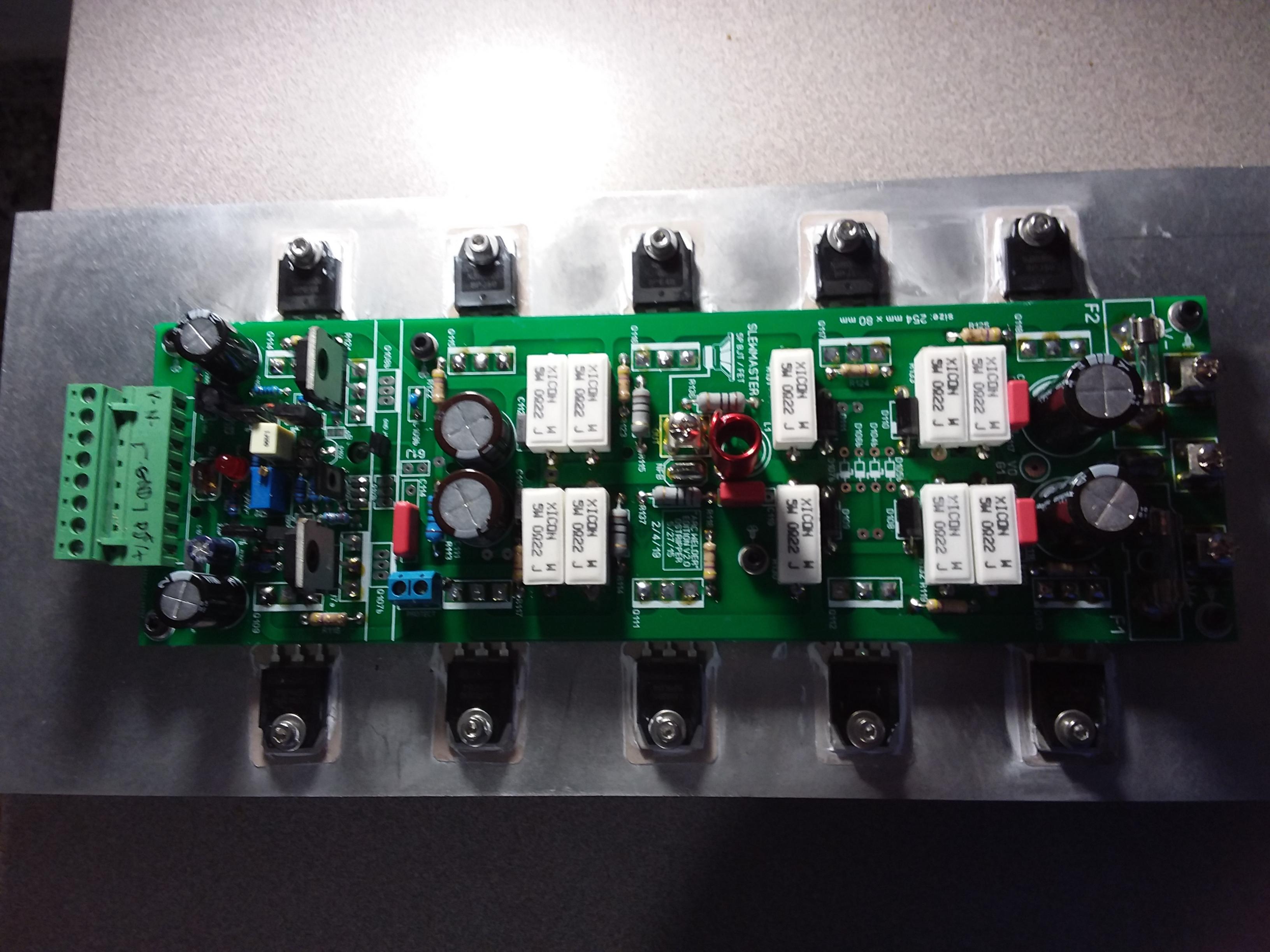

Hi Vargas, something is wrong.
You need to set the bias with no bulb tester, in normal working conditions.
Set 24mV, wait for around half an hour (you can listen to the music in the meantime), then readjust it again.
After you play some music at high volume - the heatsinks get hotter - the bias may go down a little bit. Then, if you leave it idle, it will come to 24mV again.
It will never go down to zero though.

I only use the light bulb for initial turn on to see if any mayor error happen all was good I mention that I removed after so I can then do bias adj I was playing music for a while all normal no distortion at all good music definition but why when I check bias it doesn't show any number? is really weird I will try tomorrow again to see if I can adjusted correctly I'm gonna fallow your advice to see what is going on this is the first time that I have this weird behavior on bias adjustment 😕
Check the VAS current on the Wolverine board. If it's low you won't have enough drive available to bias the output stage.

I was thinking about possible reasons for the bias going to zero. Here is one of the possible options - if you measure the voltage over a single emitter resistor and DC offset goes away from zero, you end up with DC current flowing through the speaker and one side of the OPS, and no current and zero bias on the other side.

The Wolverine I have does not have a servo but I can try with the Greenamp V1.2 the last IPS that OS made the schematic I'll if I have DC on the output but is weird because I was playing music for a while and I didn't see any signs of distortion the audio was great

Juan - standalone OPS test with 15K resistors - good way to test the bias tracking system, but please do it with no load. You may have some offset at the output - no problem, no issue as far as you've got no load connected.

oh man sadly I already installed all power transistors 🙁 you think is I install those 15k with all pairs installed and try again?
oh yes with out the load got it, this is my first board picture look awful but I will clean better
ok I will wait for the replay if I can do this " The output board can be tested by putting a 15k resistor from PD to V+ and another 15k resistor from ND to V-. Install 1 output pair and you should be able to set up your bias."
with all pair installed 🙂
You can test with all transistors in place. Potential drawback - if something goes terribly wrong, with 1 pair you lose fewer transistors than having all of them in place 😉
Set the bias pot to the position of minimal bias, before you power on the thing.

I will minimal bias 🙂 last question with those 15k installed I can then adjust bias even I have all those 5 pairs?
One more thing I just noticed in the picture - 2 drivers and TO-126 transistor between them (part of bias spreader) must be placed on the common local heatsink.
The aluminum plate will be fine. With no plate, the bias tracking system works incorrectly!

Yes, but you measure just one pair (any of them).
Note - this is just for the purpose of testing. As soon as you remove 15K resistors and connect the OPS to IPS board, you need to set the bias pot to the minimum bias position again ard re-adjust the bias from scratch.
If I remember correctly, those drivers run pretty warm. That plate should be of good size.
oh yes that most be the problem! I run them without the small heat sink for the drivers and the tracking small bias transistor the other ones is correct is under the PCB with thermal grease and insulated Q104 so Q103a most be on heat sink with driver together oh ok
