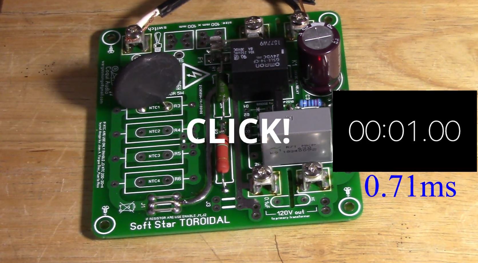

hello guys I tested the soft star yesterday with my 600VA torid and works no house dim lights 🙂 I was afraid that the fuse might blow up 😛 but that didn't happen the circuit is from diyaudio.com but I think the timer is too fast I'm not sure is this is correct it should be a bit slower right?
grey large caps is 1uF (timer cap)
two resistors 220 ohm and 1M ohm
supply electrolytic cap is 1000uF 50V DC
input AC voltage is 117V

Hello Vargas,
The 1000uF is supposed to the timer cap.
1000uF should give about 300-400ms softstart delay, which should be ok to limit the in-rush current. Andrew_T had mentioned this a long time ago if I remember correctly.

Yes. I second that.Andrew_T had mentioned this a long time ago if I remember correctly.

My ebay soft start boards have two 1000uF caps in parrallel which would double the switch on time.
You can try a 2200uF cap if you like.

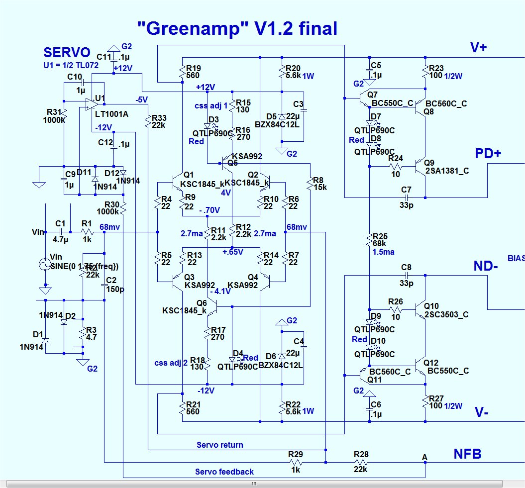

oh I forgot to mention that is the last design from Ostripper and I think his still working on another one that is gonna use SMD devices I'm not an expert but the sound of the Greenamp is really good 🙂

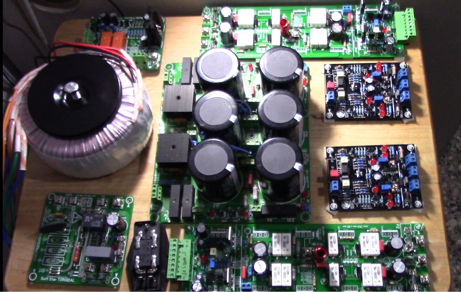

hello guys this is what I have so far two Arc Welders two Greenamps soft star, power supply, speaker protector from G. Randy Slone circuit and the new 600VA toroid that after rectification y got 66V DC 🙂

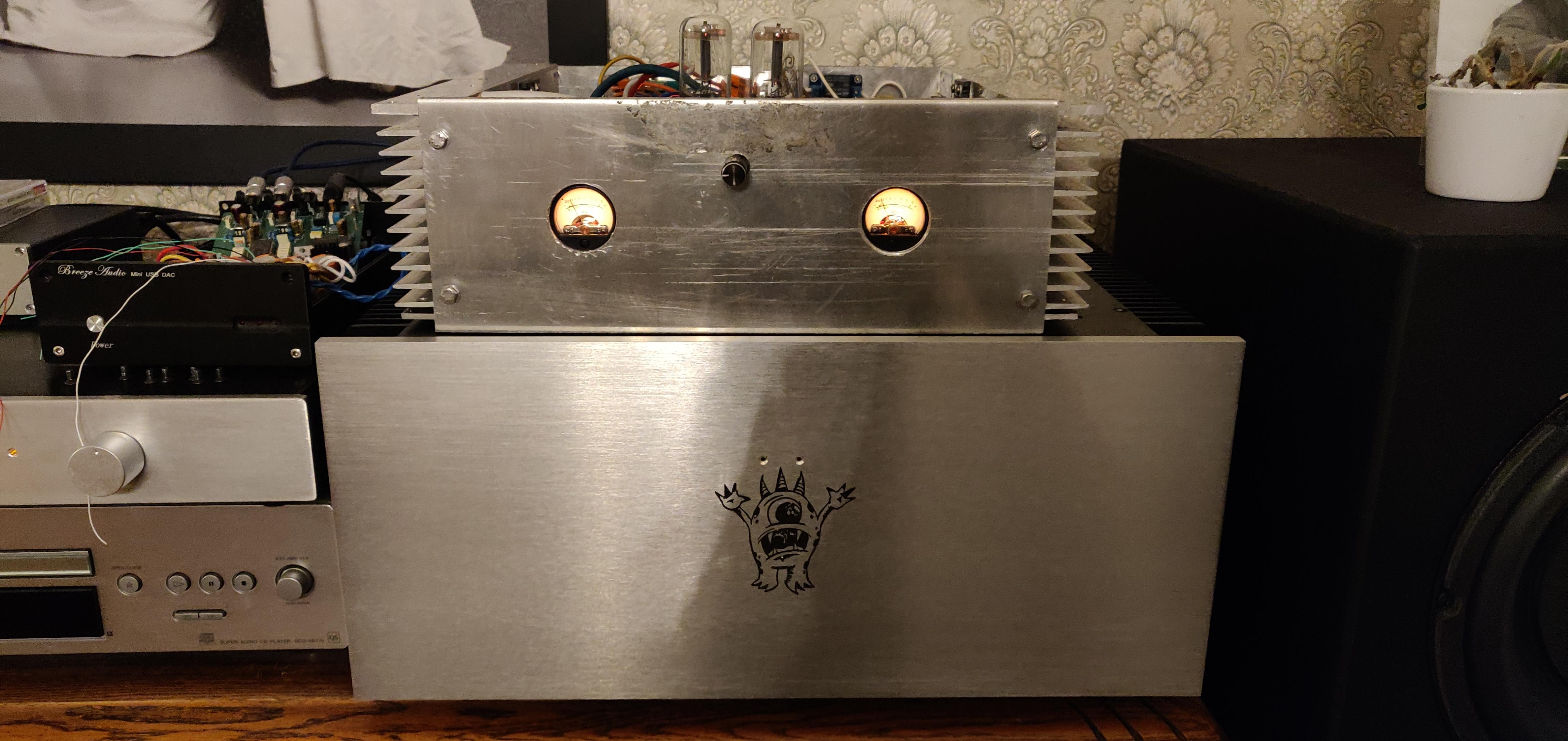

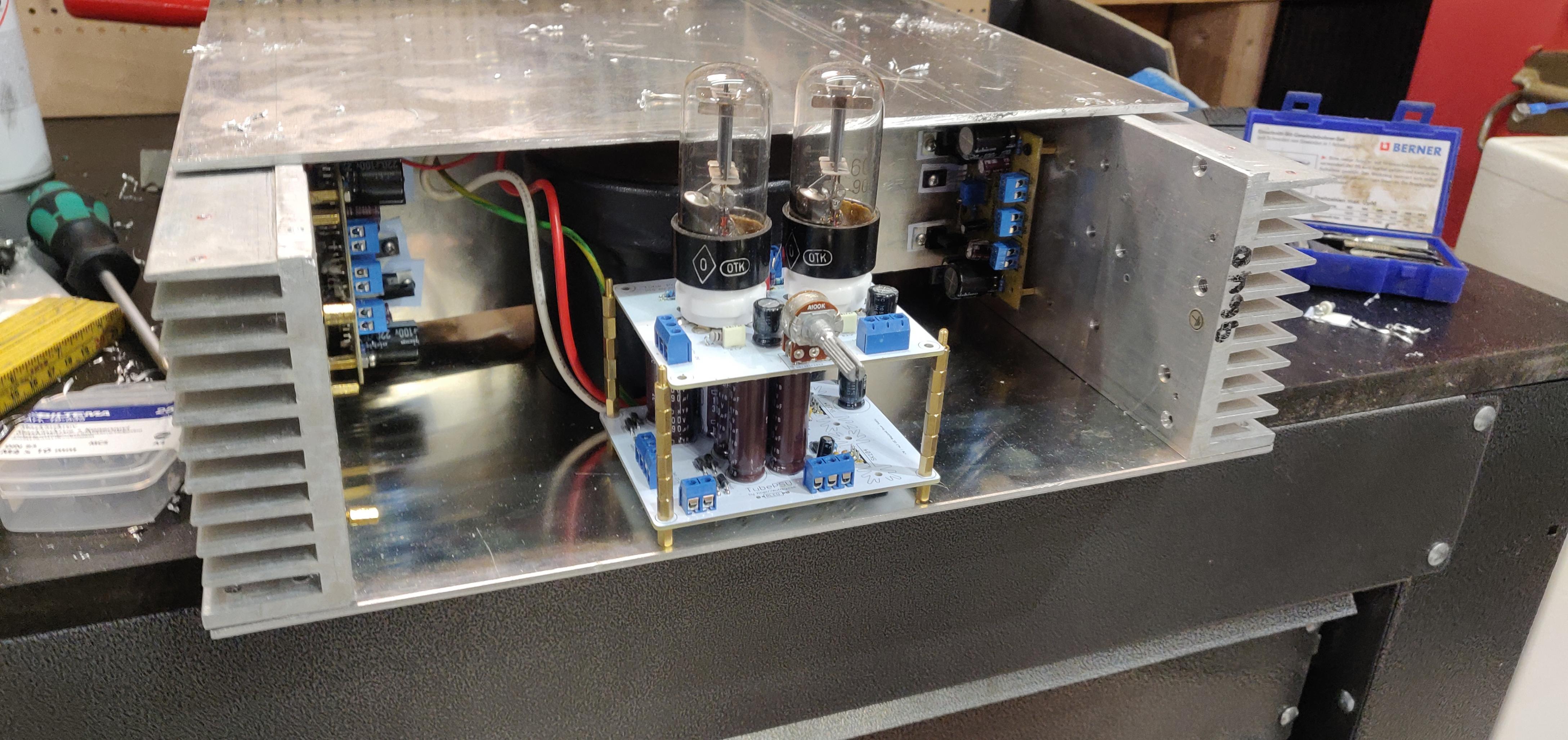

Have had these baby slewmaster laying around for some years.
It's time to make an enclosure for them.
The IPS are Kypton V. I'm also putting a BSTRD tube pre-amp in the box.
The transformer comes from a HK 690. 500va and 55v at the filter caps if I remember correctly.
