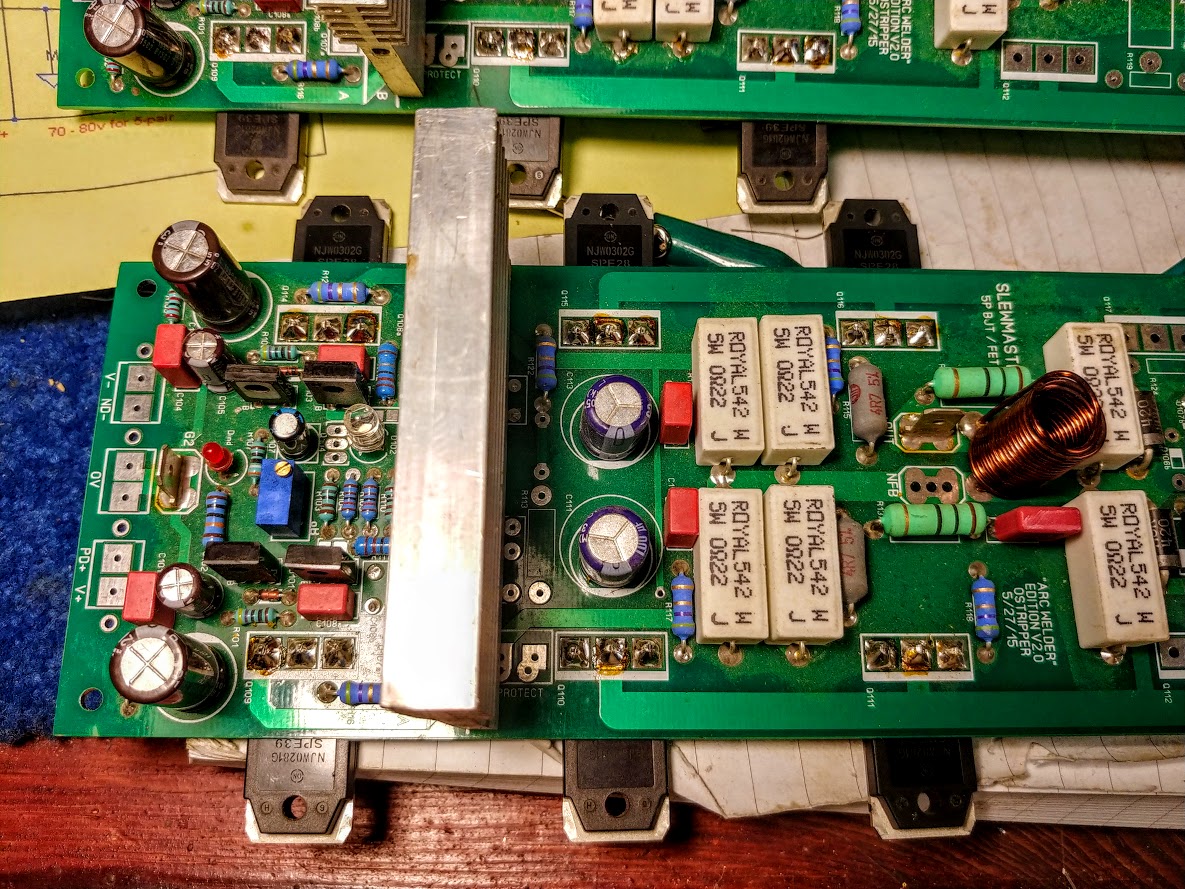

Guys, after very long time i decided restore this project....Just checking my errors... My question is about Q104, have to be mounted on heatsink together with Q103,107,108 ? Any reccomendation for IPS?
Q104 has to be mounted on the main heatsink (under the board).
Q104 needs to be mounted on the main heatsink so it can measure the output
device temperature. Q103 measures the driver temperature.
