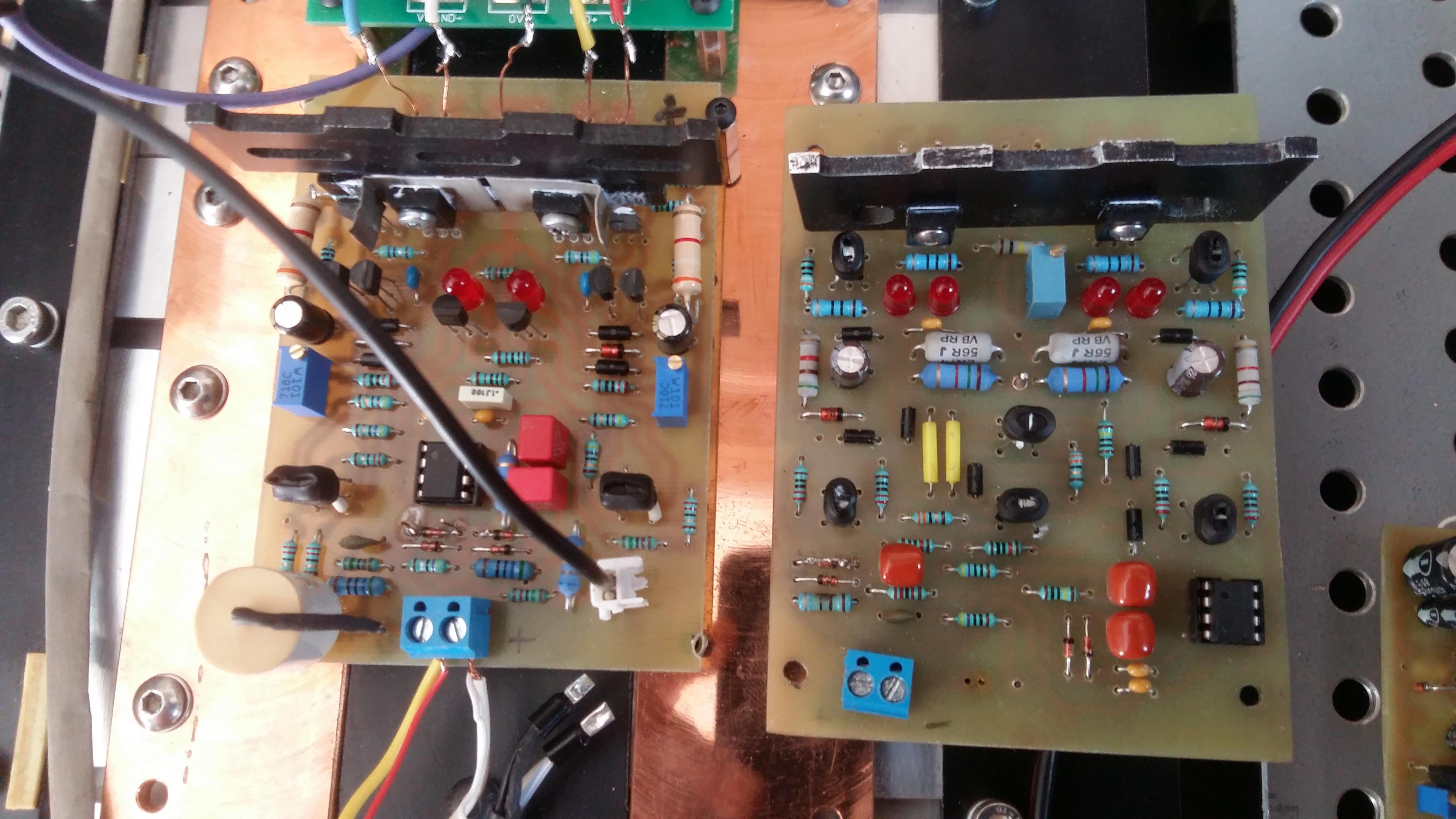

I have build both and have tested them, but not before blowing the test speaker. 😱 I forgot to connect the feedback to the Spooky IP board and there were just one monstrous shriek and then quietness. So out with a better speaker then.
I have found the Spooky very good and with a tad more bass overall than the Kypton. But my choice is still the Kypton. Good bass and very good mid and high frequencies and bit more clearer than the Spooky. At least now I can put my mind to rest and enjoy the music ,otherwise I would alway's have wondered which is the best for me. The proof is in the pudding !!😀

Today I did some work on one of my two Slewmasters. This one is with the Spooky IPS.
Unfortenatly the PD+ connection(screw) to the OPS(Arc Welder five pair output) was disconnected, and when I fired up the signal was very much distorted. After a while this channel is now silent. I am sure that it is something wrong with the Slewmaster, because the loadspeaker protection lights up when I disconnect loadspeaker out from the Slewmaster. I will start to search for failure, but first ask members what would be a good starting point. What transistors would be the best to start up examine/measure on?
Eivind S
Eivind S
Why don't you start by measuring the DC out on the speaker output? That's a standard test to rapidly find out if there is a short to + or -, or somewhere in between. That will immediately tell you in which direction to search further. It is called 'fault finding' 😉

You can also test the input and output boards in isolation which will assist in narrowing where to look.
Thanks to good advises so far. Measuring DC output was on my list. Separating IPS and OPS and repeat the tests/measurements from the first time I run the Slewmaster is also on the list. I will start there and may be come back to new questions later on.
