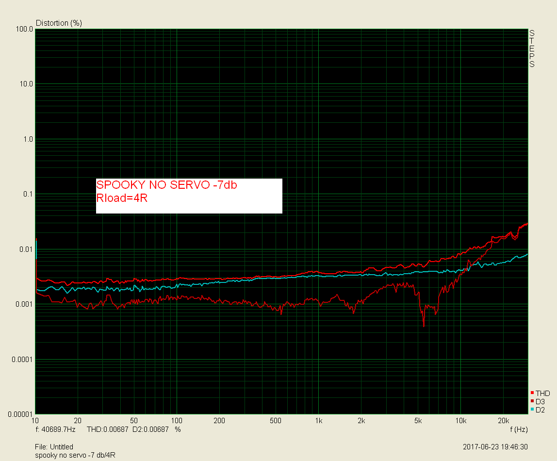

Sorry Jeff for the late reply.Looks pretty good without the servo! Is this with the feedback ground connected to the lifted input ground?
Is your software set up properly? In the first graph, shouldn't the 1k spike peak at 0db (I'm still trying to figure out how to use the software)?
Yes ,the feedback resistor's gnd connected to lifted gnd, gnd of the bipolar capacitor connected to star gnd.
The 1khz spike peak is the testing level not at 0db.(max. sound card output level=0db= max amplifier output level). When an amplifier driven with this 0db sound card out level may be goes to clipping levels.A clipping indicator or a scope is useful when a full power test required.
Look at picture one left bottom , where testing level is written.

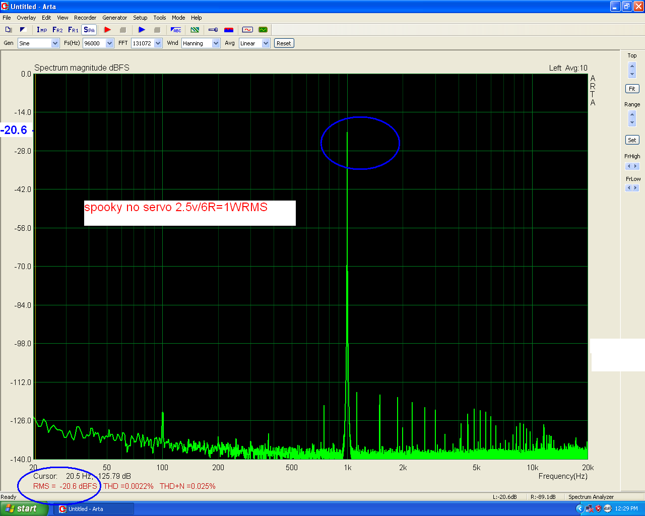

Someone ask for a 4R load test.
Here it is,picture 2.
