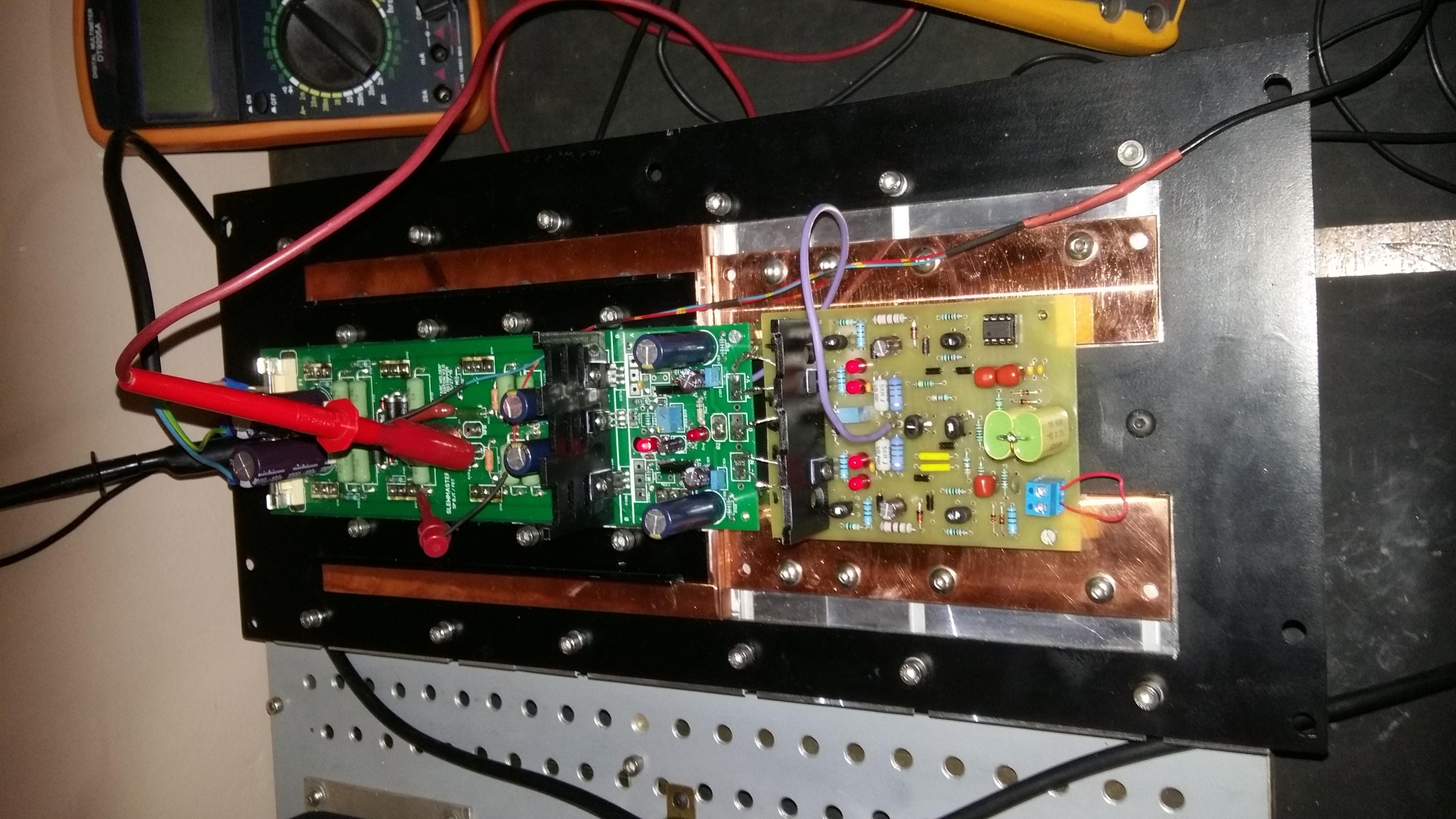

I am now working on my second Slewmaster. This time the IPS is a Spooky and the OPS have five pair 5200/1943 as output transistors.
I tested OPS yesterday with my buble lamp. Light faded down after a short time. I measured 10 mV on one emitter. So far so good.
Today I fired up the IPS with 10 ohm connected to NFB and ND-/PD+. I measured 0.61 over 10 ohm. Over R12/R13 I could easily set 3.8 mA. Offset a dissapointing 50 mV with a TL 072 connected.
I also measure the voltage between PD+ and ND- and came up with 1.2 V !!!???
In my first Slewmaster I changed TL 072 to another TL 072 with a dramatic fall in offset. So far I have not tried another IC here. By the way, can I use a OPA 134 instead of TL072?

An opamp used as a DC servo requires low offset and low drift in offset as temperature changes.I am now working on my second Slewmaster. This time the IPS is a Spooky and the OPS have five pair 5200/1943 as output transistors.
Eivind S
Both these are stated in the respective datasheets.
TL07x are poor as DC servos.
LF412 is better. but it is very old and there are many newer opamps that can do a lot better. Any that do significantly better are usually much more expensive.
When you find a cheap alternative that is significantly better than an LF412, please shout it out so that we all can go buy them.

Yes, LF411 / LF412 (single / dual) are the perfect choice for the purpose.
They are internally trimmed for low offset and demonstrate very low temperature drift.
I think, at around $2 per piece they are rather inexpensive.
There's also an enhanced version from Analog Devices - AD711 / AD712 - I used them as well as a servo with great success, but they are 3x...4x more expensive.
I never noticed any difference between particular instances of the same type - all of them performed equally well.
