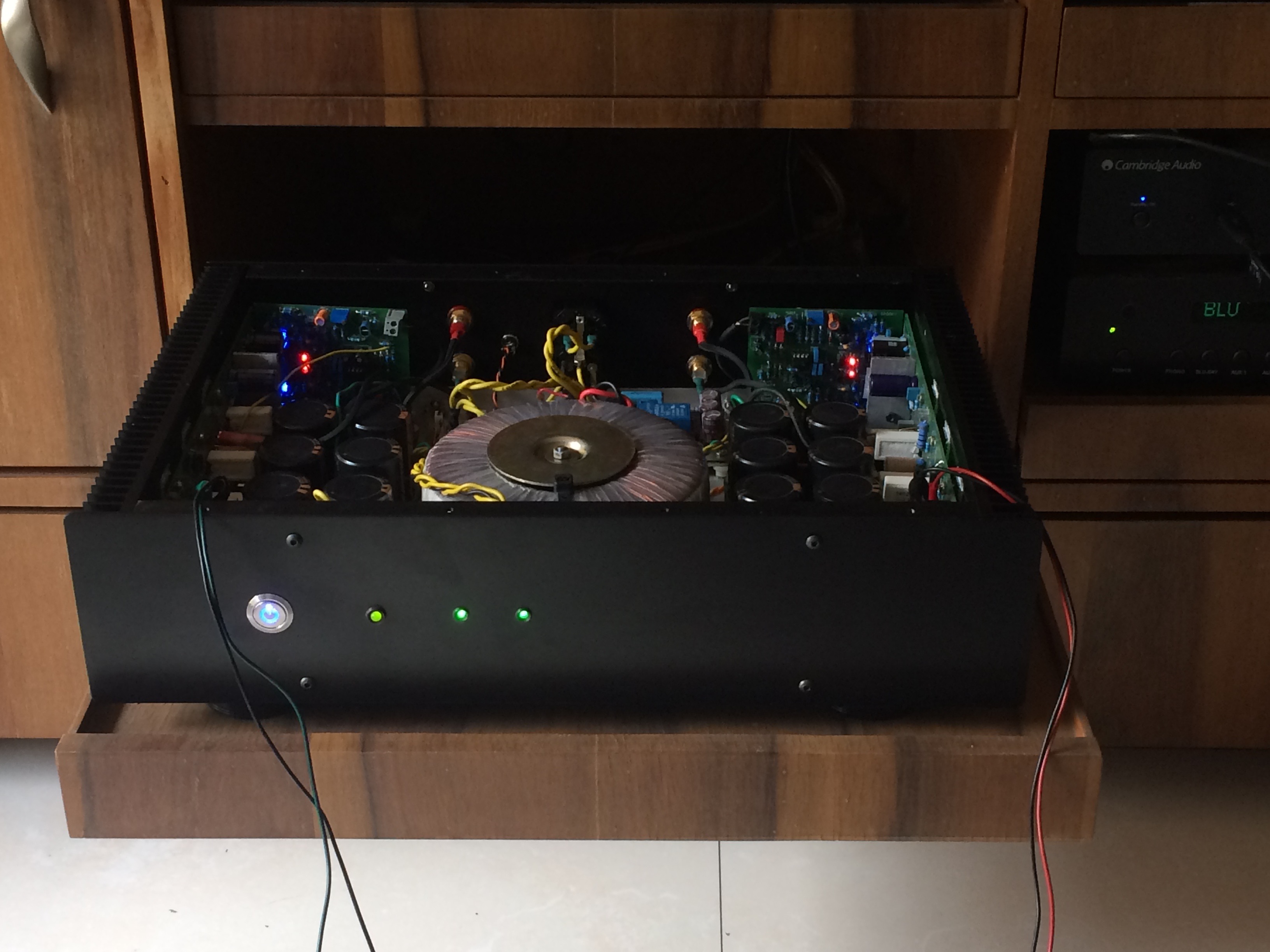

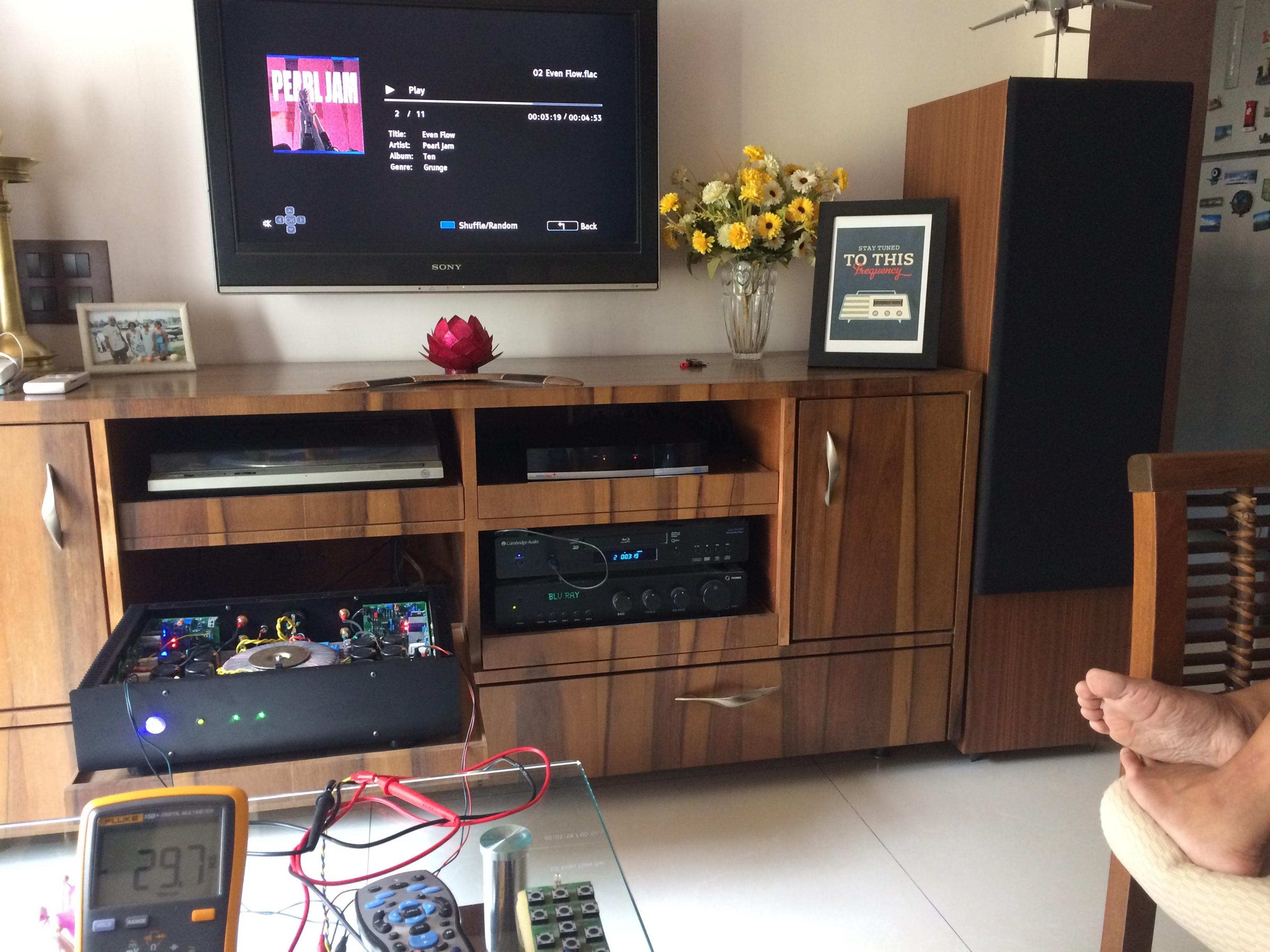

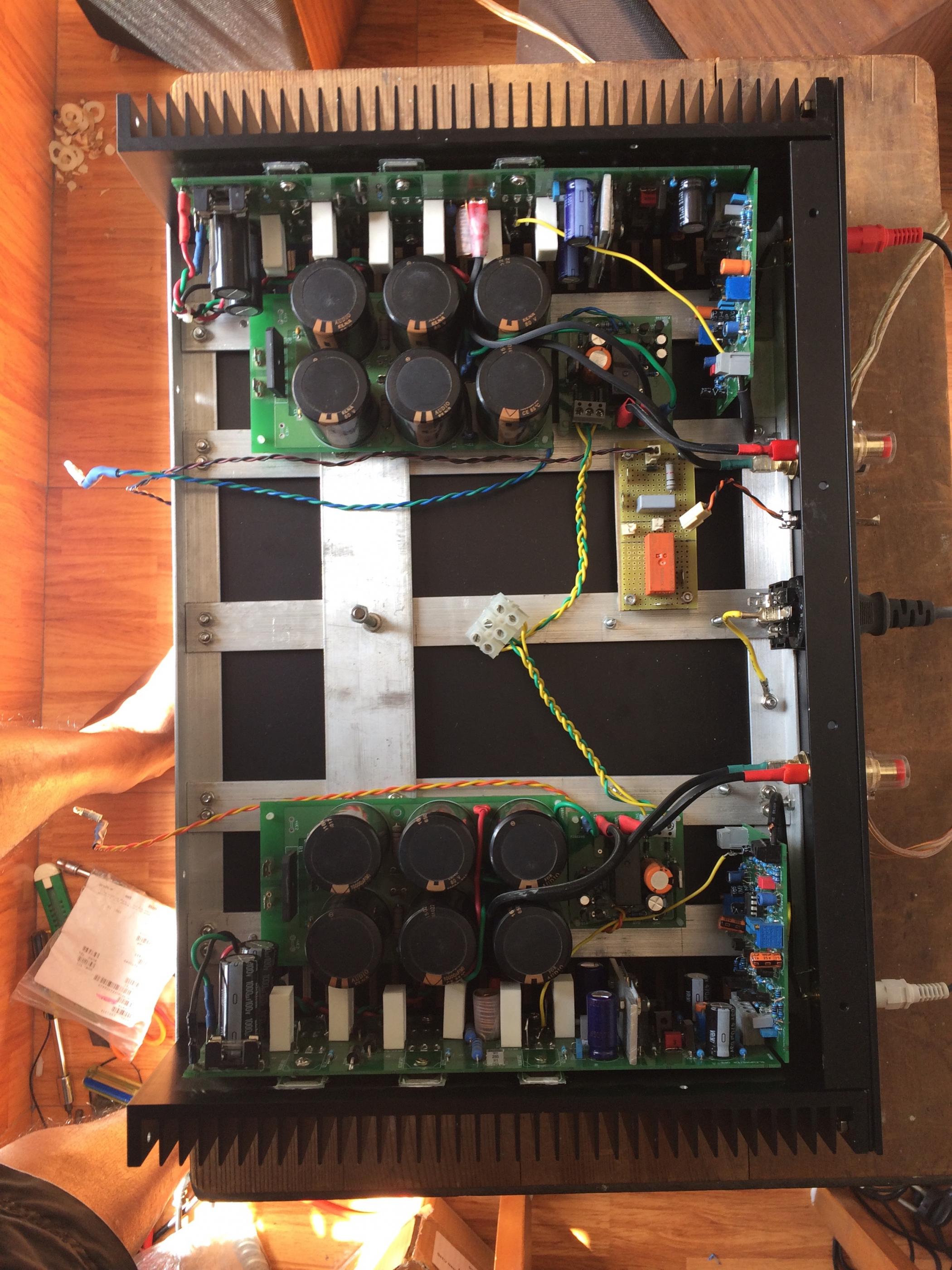

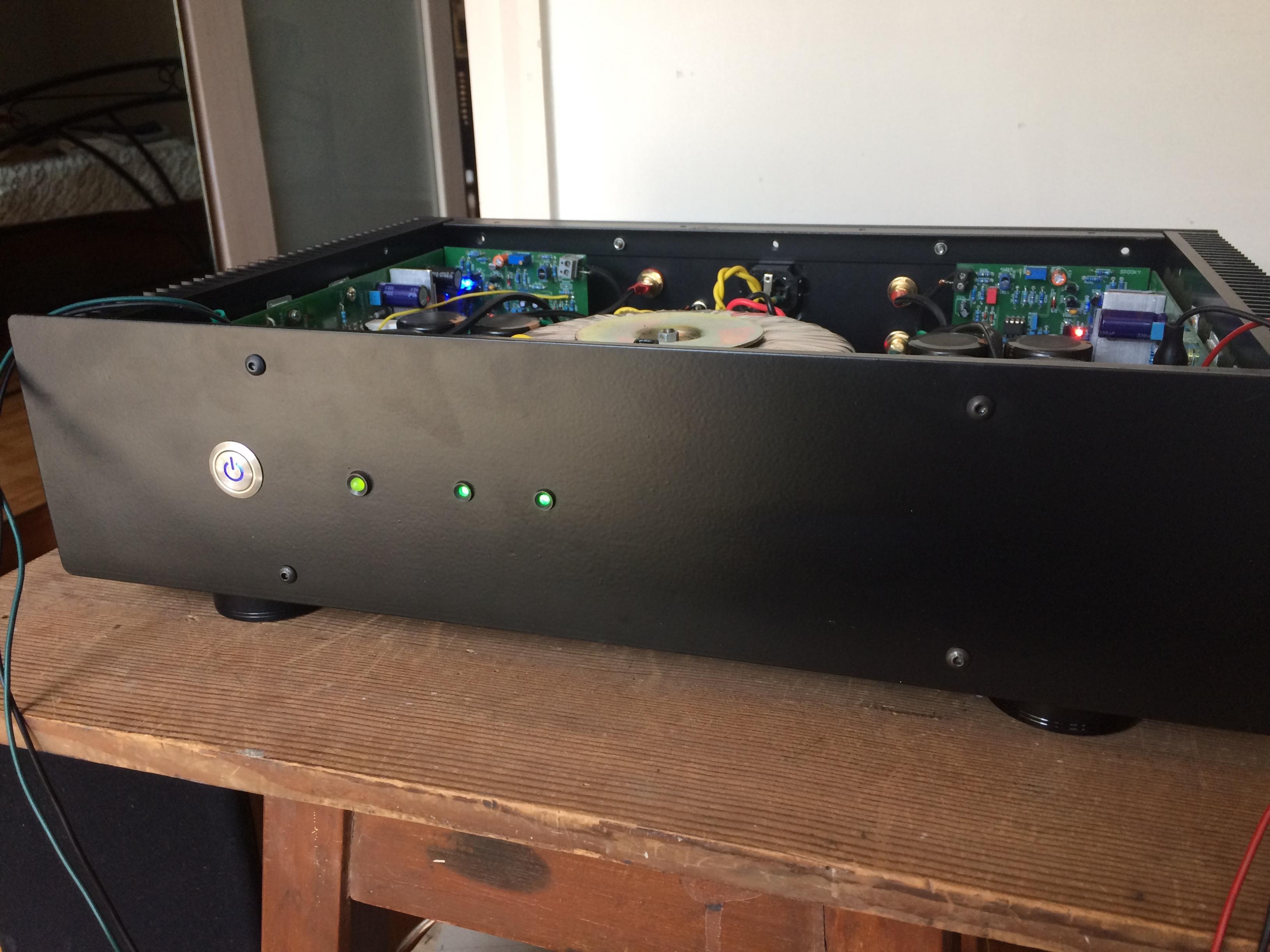

Final assembly and testing
All the bits and pieces have gone in finally. The amp is on endurance test, monitoring the bias continuously. Sounds great, with no glitches so far.
Hari
Hari

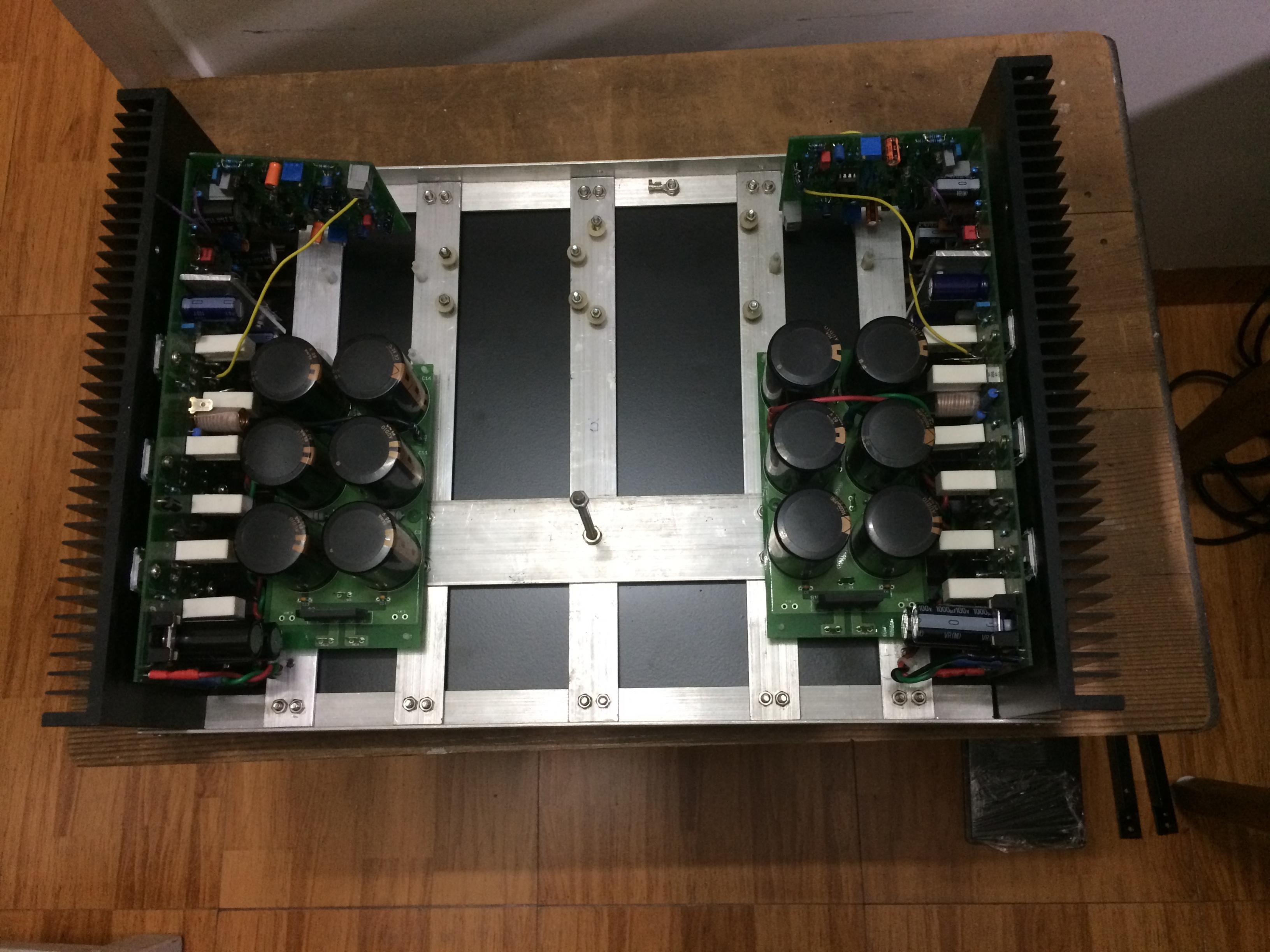

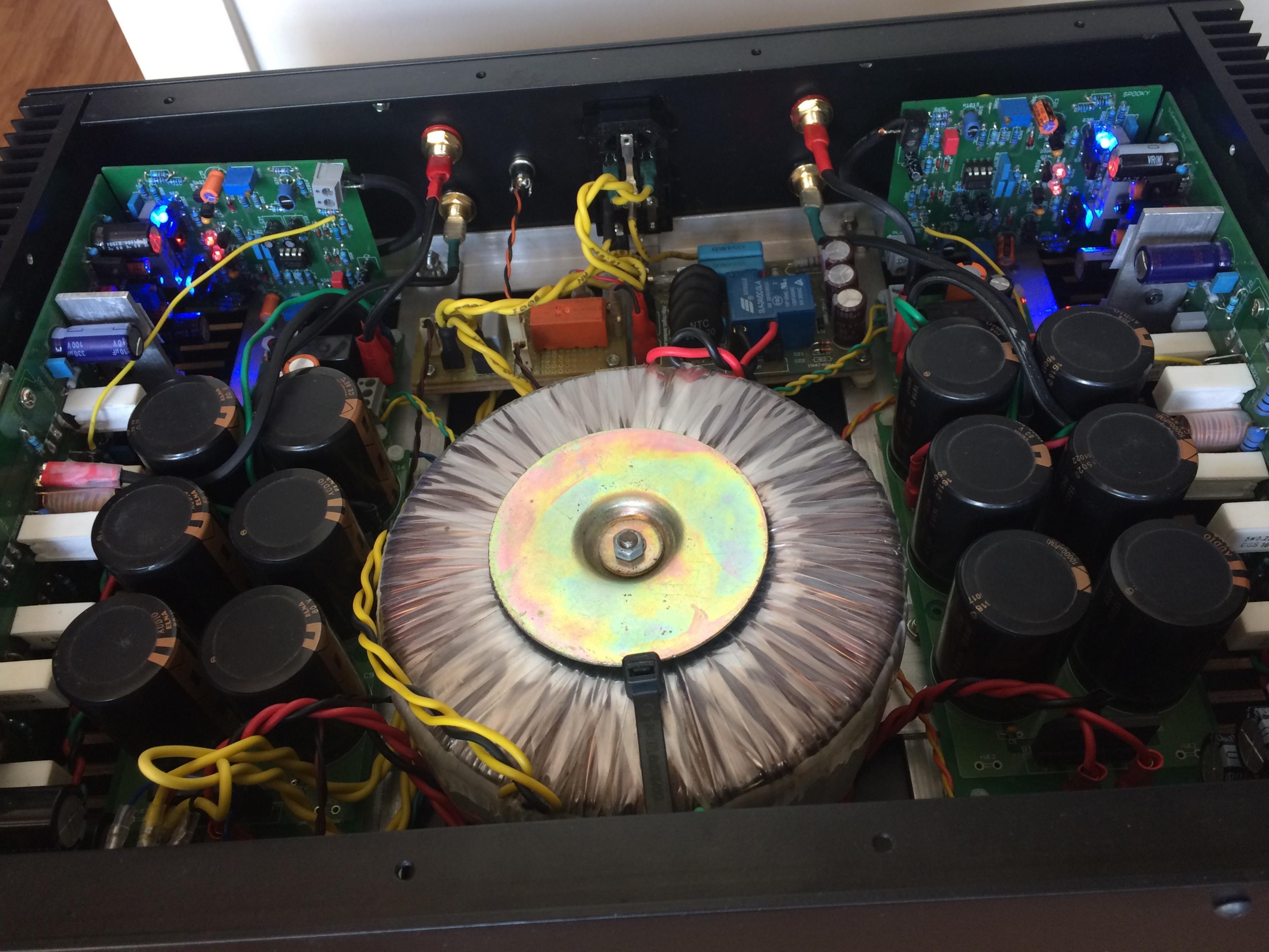

Is that a centre tapped secondary supplying two rectifiers and two separated capacitor banks?
Your amp turned out well! You definitely have excellent layout skills, I wouldn't have been able to fit an over 150W amp in such a relatively small enclosure.
That's correct.

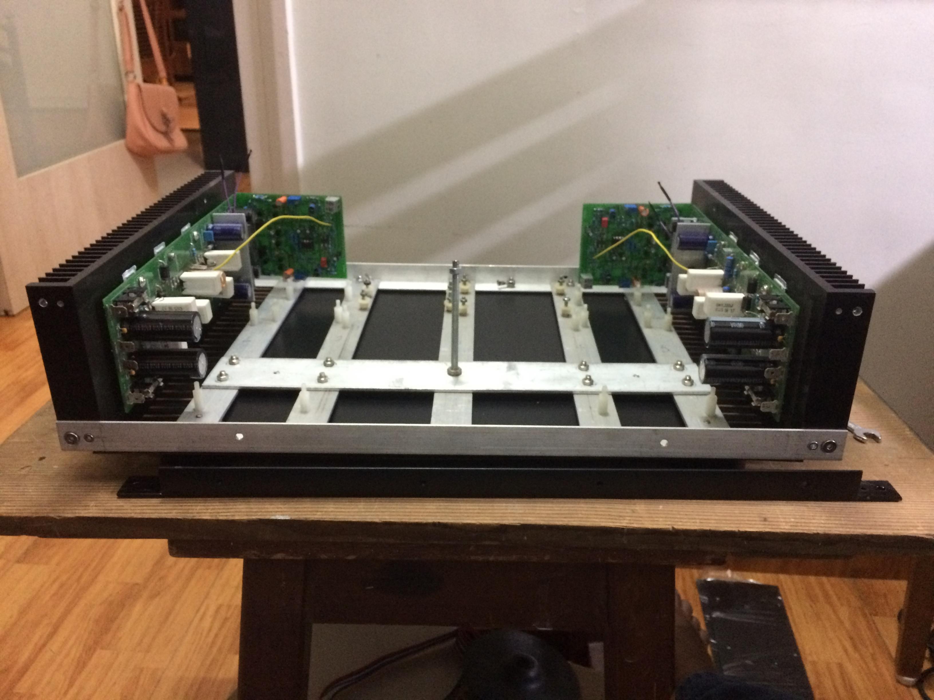

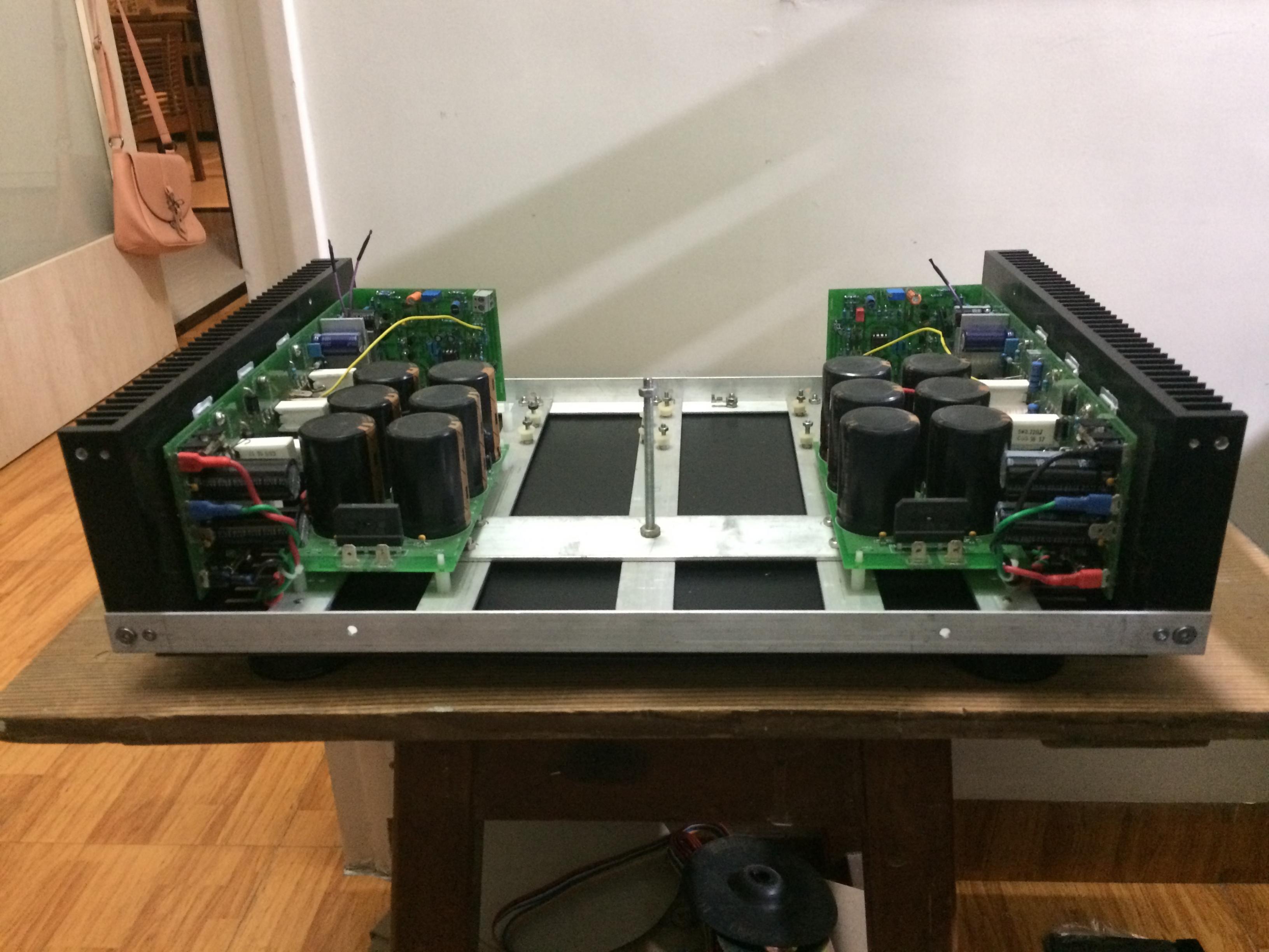

Thanks akimmet. I do a lot of fabrication with aluminium. This enclosure was built around the 100mmX300mmX25mm heatsinks. Did quite a lot of simulation with cardboard templates before finalising the enclosure. Mind you, I had to test the amp extensively and be 200% sure everything's working before sticking them in!!

you must be careful to avoid creating a loop between the two amplifiers.That's correct.
At present there is a common Zero volts connecting the two amplifier together via the zero volts that starts at the centre tap and goes through both PSUs to both amplifiers.
