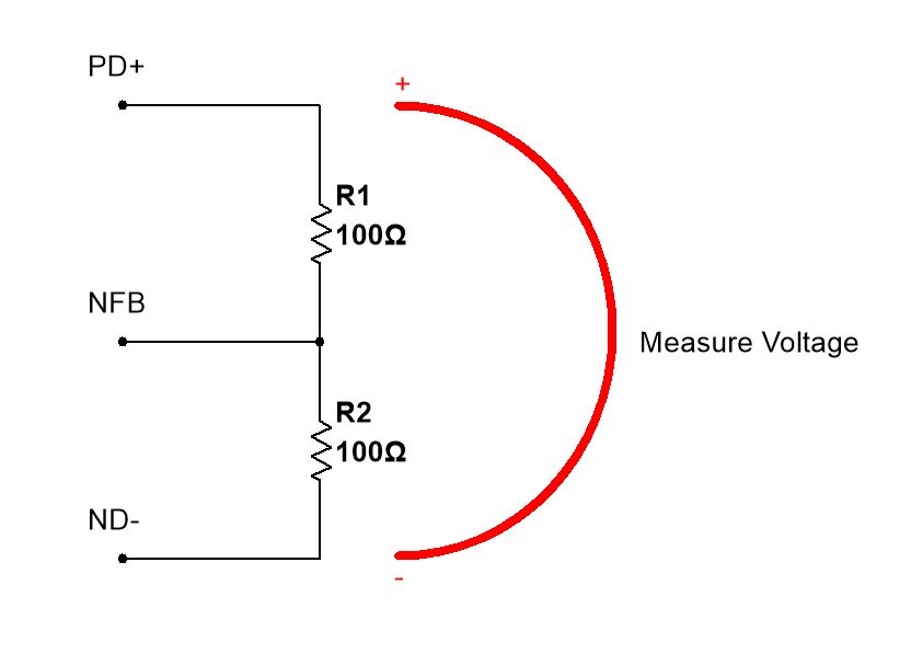

Does anyone have a comment to my measurement? I remember from my build with Kypton IPS, the voltage measurement between ND- and PD+ should be 11-12 V. On my Spooky I measured only one tenth of that: 1.2V. The mesaurement was taken with the 10 ohm connected to the NFB point. What is the correct value here for the Spooky??
In post 2035 both V has fallen out and a 0 . I measured 0.61V over the 100 ohm resistors.
0.61/100=0.006. This means 6mA through this resistors.

Eivind, measurements with the resistors (standalone IPS testing) and with OPS (normal operation) are completely different stories.
You normally connect 2 resistors from PD+ and ND- to NFB point (treating NFB point as output in this case) only for making sure the front-end board runs fine and see that the offset is close to zero and measure the VAS idle current.

In post 2035 I wrote:"Today I fired up the IPS with 100 ohm connected to NFB and ND-/PD+. I measured 0.61V over 100 ohm. Over R12/R13 I could easily set 3.8 mA. Offset a dissapointing 50 mV with a TL 072 connected".
0.61V over 100 ohm gives 6mA trough the 100 ohm resistors.
The measured 3.8mA over R12 and R13 is also according to schema. It is what voltage I measured between ND- and PD+ that I find confusing (1.2V) according to what jwilhelm wrote in his start up prosess on Kypton: "After that set, measure the voltage between PD+ and ND-. You should read around 11V if everything is working right".
My measurement 0.6V x2= 1.2V (over both 100ohm) must be correct. May be jwilhelm have used 1K resistors when he came up with a result of 11V.

Well, that's fine - if you measure 0.6V across 100R, you measure 1.2V across 200R - that's what you have between PD+ and ND-, right?
As soon as you connect a real OPS instead of two resistors, you will see higher voltage (having the same VAS idle current), as impedance of OPS's bias spreader is higher than 200R.

If I recall correctly my chart was written using 1K resistors to measure VAS. 6mA is the correct VAS idle current.vzaichenko

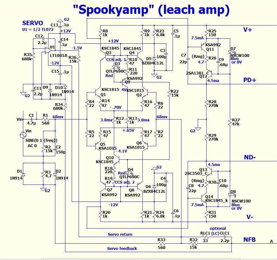

New measurement:
Over R25: 8.1mA
Over R29: 8.8mA
Schema say 7.5mA
Any changes recommended, or it is close enough to connect IPS to OPS?

Can you measure the voltage over R14,R16,R15,R17 & R8,R9,R20,R21 & the zeners & D3,D4 , D7,D8.
R25(8.1mA) andR29(8.8mA) (you mean R31 8.8mA)
You should have near same voltage drop over those R25,R31 . You can adjust the 3.8mA over R12,R13
smaller it will drop the voltage over R25,R31 depending on how much the led D3,D4 voltage drop is.
I have voltage over R14,R16,R15,R17 84.5mV-85mV over R25-R31 7.6mA
R8,R9,R20,R21 1.75V-1.76V

Anyway, at 6mA VAS idle current it's ok to connect the OPS and test the amp as a whole. Just make sure to set the bias trimmer in OPS to minimum bias position for safe first power-on.

R106 must be in the max ohm position (200 ohm). The higher R -> the lower the bias.
8.1 mA and 8.8mA over R25/R31 is fine - those currents are always higher than VAS idle current in Hawksford cascode, as part of the current, flowing through those resistors, goes to the LEDs.
