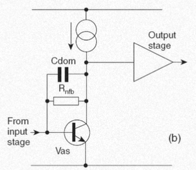

Hello
Why a resistor across cdom cap are bad ?
Thank

Gaetan, I can think of several reasons, but my amplifier fu is not strong enough to say which are the biggest problems. My guess would be the main issue is the asymmetry between charge and discharge rates created by putting a bleeder on the cap.

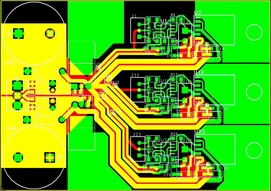

Oh, I'm well aware correlation doesn't imply causation. Schematic and layout attached---J1/J11/J21 are the ins from the active crossover and J2/J12/J22 go to the drivers. Some of the supply bits---100uF and 10000uF caps, diodes, and the regulators---aren't stuffed yet; rails are currently +/-12V off an HP E3620 lab supply with minimal length jumpers tacked to the board to provide continuity. C1/C11/C21 are X2Y caps---they're just a cheaper way of getting a well matched pair of C0G 100pFs. Board's 3 by 4.25 inches.

From a quick look at your layout, it does look like R3's grounding could be the culprit. In my experience the gain/feedback resistors do need their own clean ground back to the star earth. You have it going to a rather large node which includes the output ground and decouplers (but I can't see that too clearly so I could be mistaken).

Hello
I've ask this question because Douglas Self, in his book Audio Power Amplifier Design Handbook 5th edition, suggest to put a 100k to 500k resistor across the vas cdom cap to reduce the vas gain.
Hmm, interesting. From the standpoint of imposing the desired voltage on the driver it should be correct to tap the ground sense off the connector pin that goes out the driver. The choice is, however, consistent across both R12 and R23---the only thing that changes when A/Bing between the 49713 and 49990 is whether the driver's plugged into J12 or J22. U12 and U22 are adjacent parts on the tape so they're likely decently matched and any deltas in their current draws small. I chose this ground structure to minimize the loop inductance back to the 49600 supply caps---that second set of thermal reliefs is the via up to the bypass components. My signal integrity experience tells me that's probably better than injecting a couple more nH into the signal path by splitting the ground tounge, but it's the sort of thing where you'd have to build the board both ways and measure it to verify. I don't mind taking a Dremel to the proto and cutting a split into the board but I'd like to get a better handle on the problem before starting destructive testing.

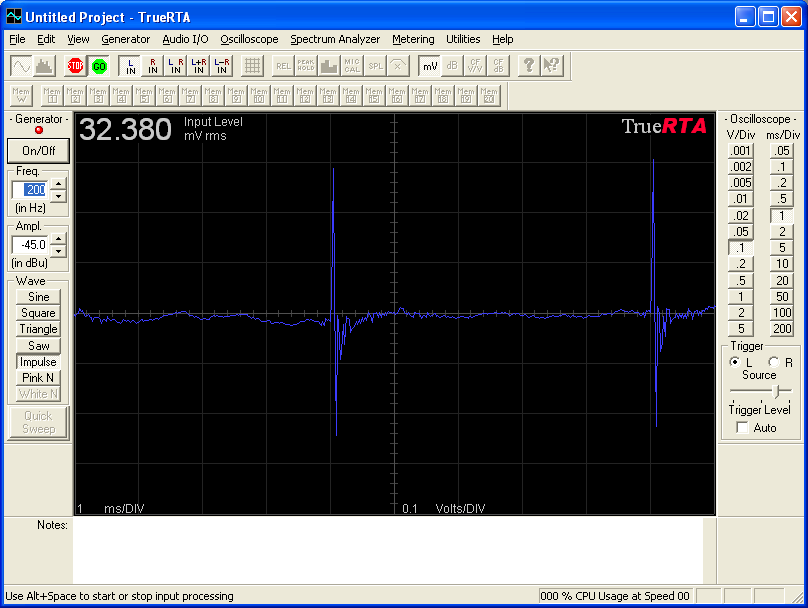

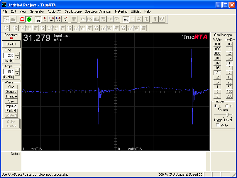

I've been poking around with measurements and came up with the attached a few minutes ago. These are close mic measurements of the impulse response on the driver with the 49600s remaining within their class A range. Left one's the 49713, right the 49990, and the wobbles between impulses are ambient noise. The RTA's running at 44.1kHz so there's presumably a fair amount aliasing of the post ringing. I'll remeasure at 96kHz when I get a chance but this calls for getting a decent scope on the driver leads and that's gear I don't have handy. I can, however, easily fish around to see if it's a bypassing issue by varying the signal level, shortening up the zip cord to the driver to reduce the capactive loading from something like 100pF to 30pF, stuffing the bulk caps, or tacking on additional 100nFs and 3.3uFs.

Yes, what you're saying makes sense to me in a classical sense. However my working hypothesis is that RF ingress is the main villain in regards sound quality, which is why its so hard to pin down. Besides my own experience of grounding changes, there is some anecdotal evidence of low noise opamps being susceptible to RF. I think it was Ed Simon over on the Blowtorch thread who recently recommended a series air-cored inductor to the opamp input because RF was affecting his measurements. Walt Jung (or was it Jan Didden?) took out an AD797 from his low noise power supply and substituted a JFET one because of the former's extreme RF susceptibility in that particular application.
The key difference to my mind between your 49713 and 49990 is in the input stage - the latter is so low noise it can only have an undegenerated LTP with an extremely narrow linear differential input voltage range, ripe for RF aggravation.
Hi Gaetan

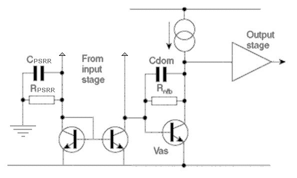

I can think of two issues. Firstly, it reduces vas gain so there is less global feedback to correct distortion. However it also reduces vas output impedance, which reduces distortion of the vas and output stage. The final result is still a bit more distortion, but not too bad.
The second issue is power supply rejection. With that type of vas the output voltage is relative to the negative supply voltage, so any ripple voltage on the negative supply rail is also on the output. Global feedback reduces this, but if feedback is reduced with a resistor across Cdom, PSRR will be worse.
The PSRR can be fixed by adding an extra capacitor and resistor as shown below with Cpsrr = Cdom and Rpsrr = Rnfb. Even without the resistors, adding the extra capacitor may be a good idea.
I like the idea of doing it like this as it allows a wide open-loop bandwidth.
That certainly is true for a single-ended design as ground currents in the feedback ground connection will introduce "crap" (yes, that's the technical term) into the amp input via the feedback network. However, this is a differential amplifier. The feedback should be taken across the load. The differential amp sets up a voltage difference across the load that depends entirely on the voltage difference between the (+) and (-) inputs of the amp. The output voltage is not referenced to ground at all (assuming high CMRR anyway). Hence, this circuit should be immune to ground bounce as laid out.
Yet in similar configurations, I hear improvements in sound when grounds are cleaned up. So I accept your 'classical' arguments here, but they don't explain the sound quality differences. Perhaps the assumption of high enough CMRR when extended into VHF territory doesn't apply. Certainly I've never seen an opamp datasheet showing decent CMRR into 100MHz territory.
