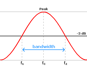

I think it depends what you mean by "bandwidth".
For example, if an amplifier's open-loop small-signal frequency response rolls off above 5 kHz, it's closed-loop small-signal frequency response rolls off above 500 kHz, and it's maximum output power rolls off above 100 kHz, then the slew rate is directly related to the "100 kHz" number, which is often referred to as the "power bandwidth".
Those three numbers are independent of each other to a large extent.
Take Cdom as an example. If the least current available is 1mA and Cdom is 100 pF, the slew rate (SR) is less than 1mA/100pF=10 V/us. Increasing the current to 5 mA, increases the SR to 50 V/us. It has nothing to do with bandwidth of your amplifier. However you can calculate the max SR from your source (e.g a CD player) from its max bandwidth f (e.g 20 kHz) and amplitude (e.g 1 V) by finding the max SR as the max time derivate of the amplitude (e.g. SR = 0.13 V/us for our CD player).
bandwidth represents the difference between the frequency limits of an amplifier, the range of frequencies over which an amplifier has a linear function according to some definition. Bandwidth needs to be very much wider than the intended operation frequency. I just stated that operational amplifiers suffer from slew-rate limiting because of poor bandwidth, in that context, there`s no need to assign further conditions. Slew-rate limiting was provided with, in my view, unambiguous meaning. I did not mean gain-bandwidth product, which is the product of the closed-loop gain and the -3 dB bandwidth.
Its common for consumer audio amps to have a frequency response of 300 KHz and a power bandwidth of 40 KHz. The reduced power bandwidth is due to slew rate limiting (or sometimes destruction of the output Zobel network). Your definition of bandwidth is inadequate to describe this situation.
As a designer of amplifiers that definition would get me into a lot of trouble. I need to know the requirements for the load to swing the full amplitude at the maximum frequency of the design. Its relatively easy to calculate back the necessary current at each stage to keep the amp linear at that maximum frequency working from the slew rate and peak currents required at each stage. But the calculation is independent of bandwidth and may (will) get you into trouble managing the phase margin at unity gain crossover if you don't watch all of the independent variables. At 500 KHz you find you need a lot of current in the input, vas, and driver stages, which may leave you with a lot of gain to manage and no phase margin to mange it.
