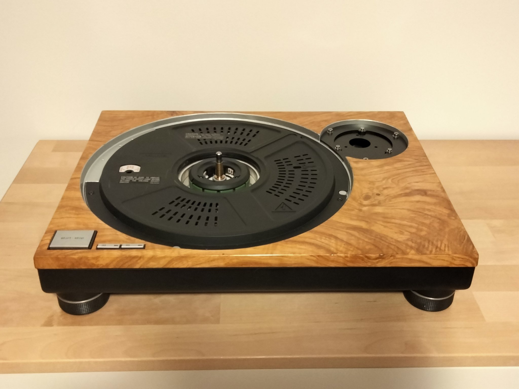

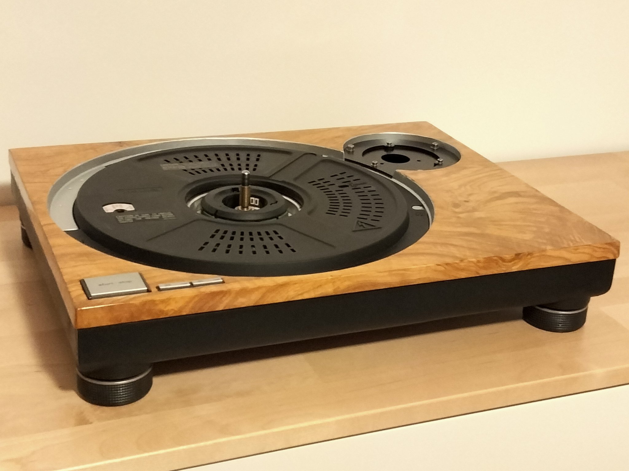

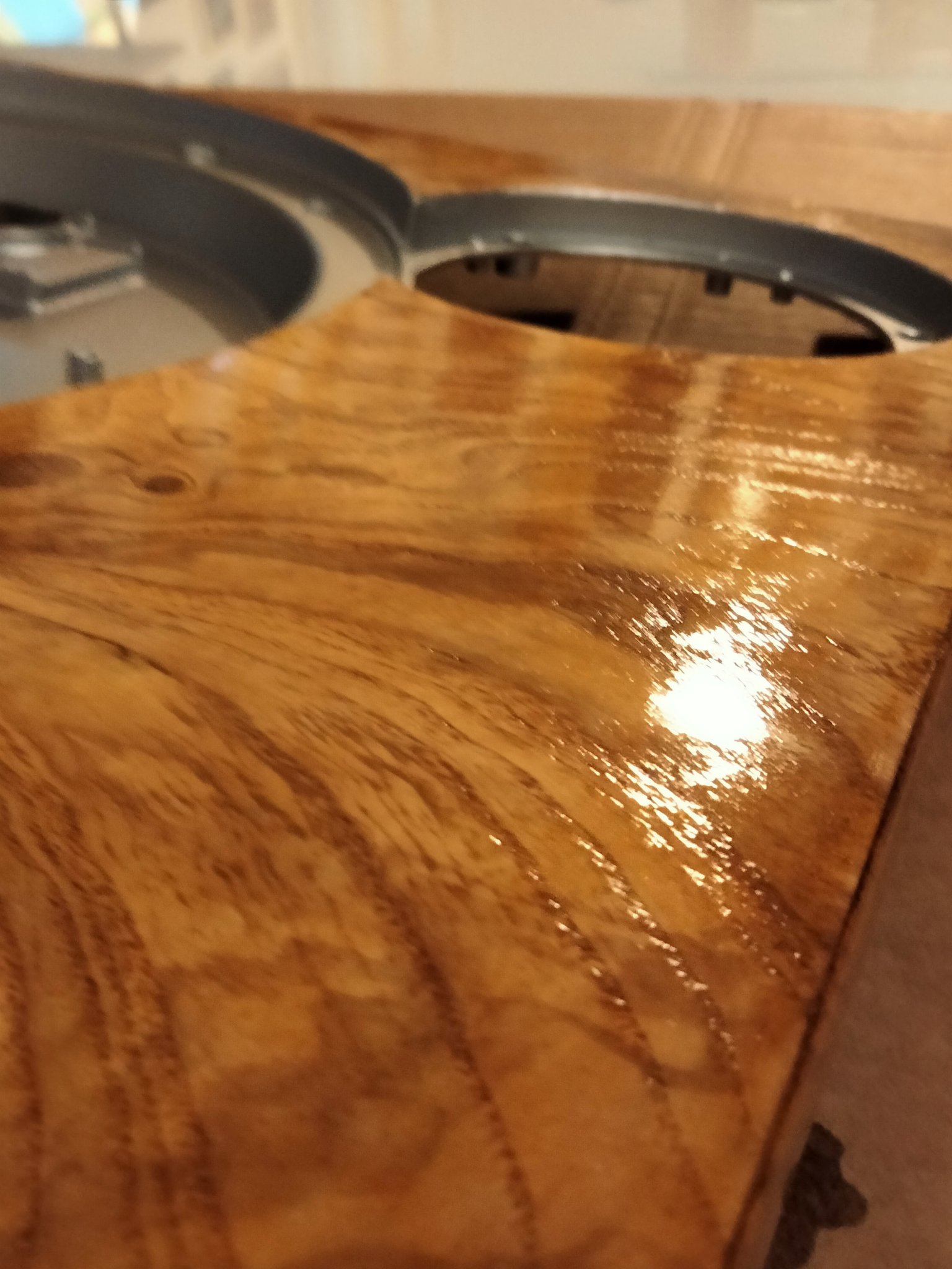

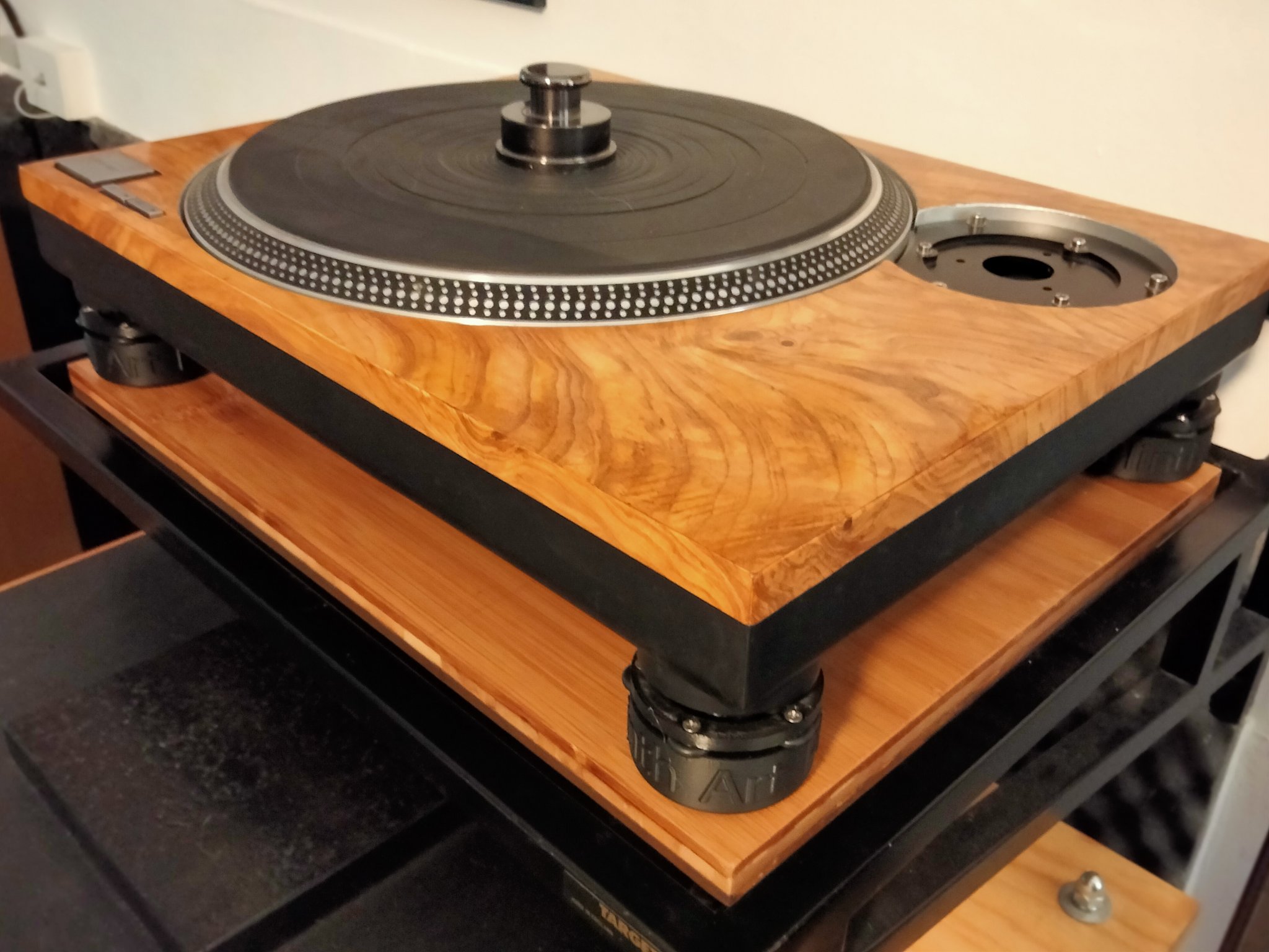

Beautiful!! It’s going to look so very good. 🙂 🙂 🙂
I think I may do this to mine if I ever get the backlog of projects cleared out…

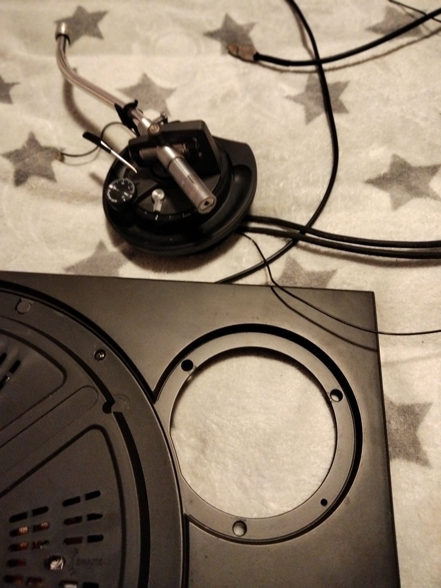

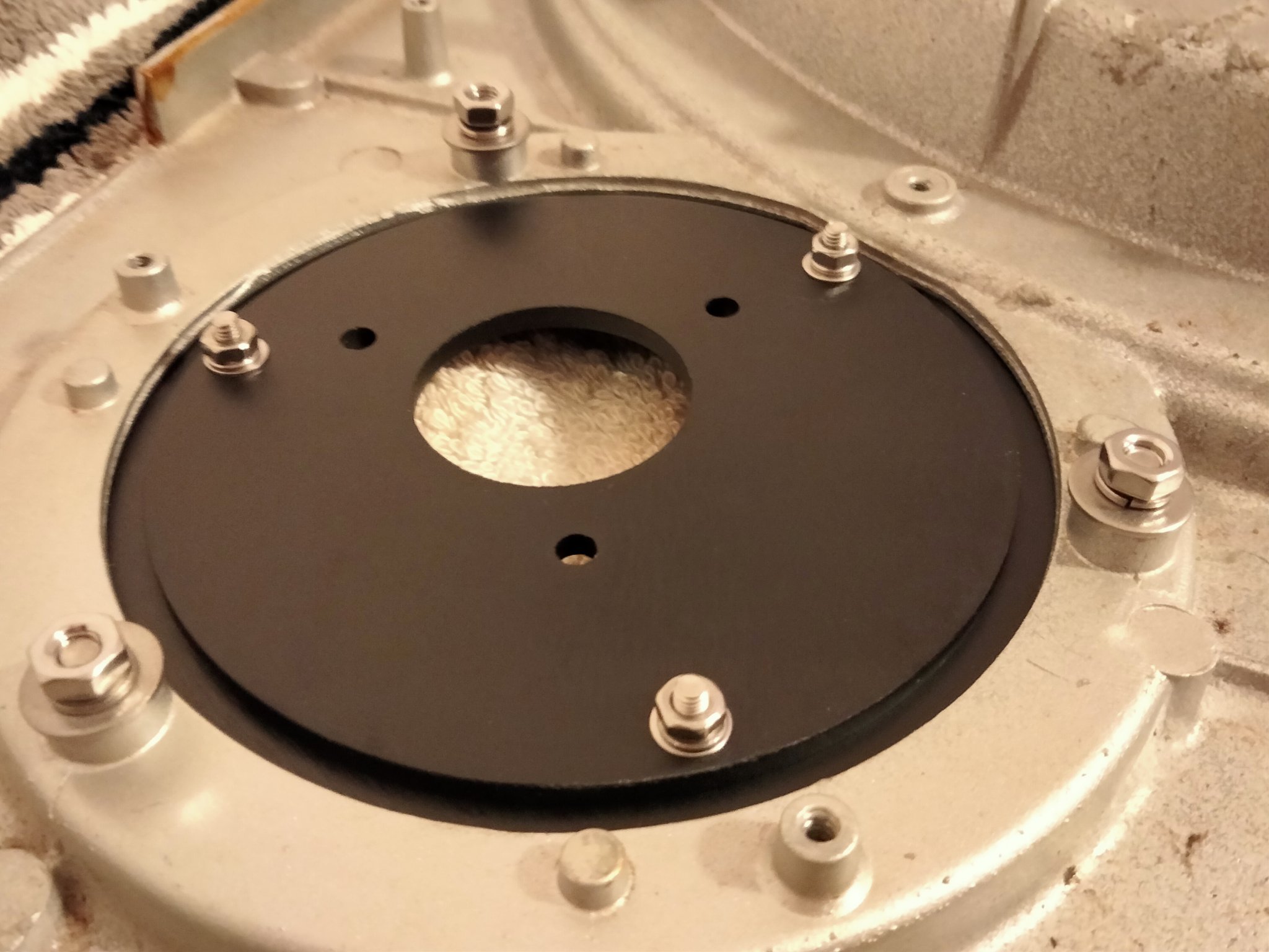

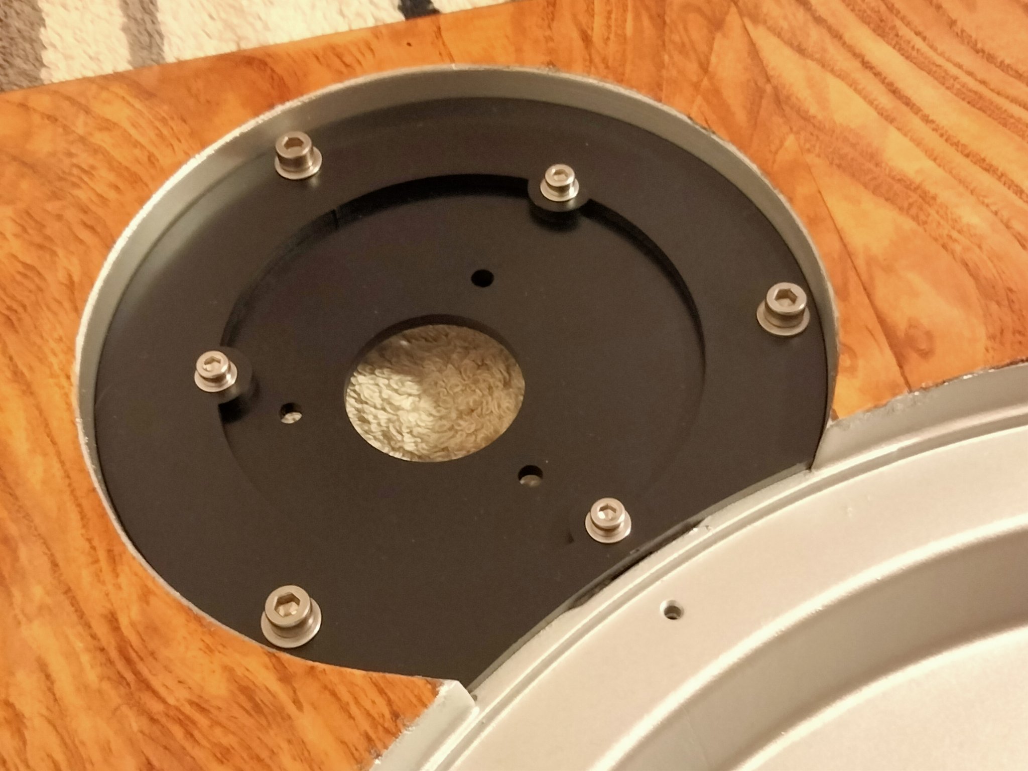

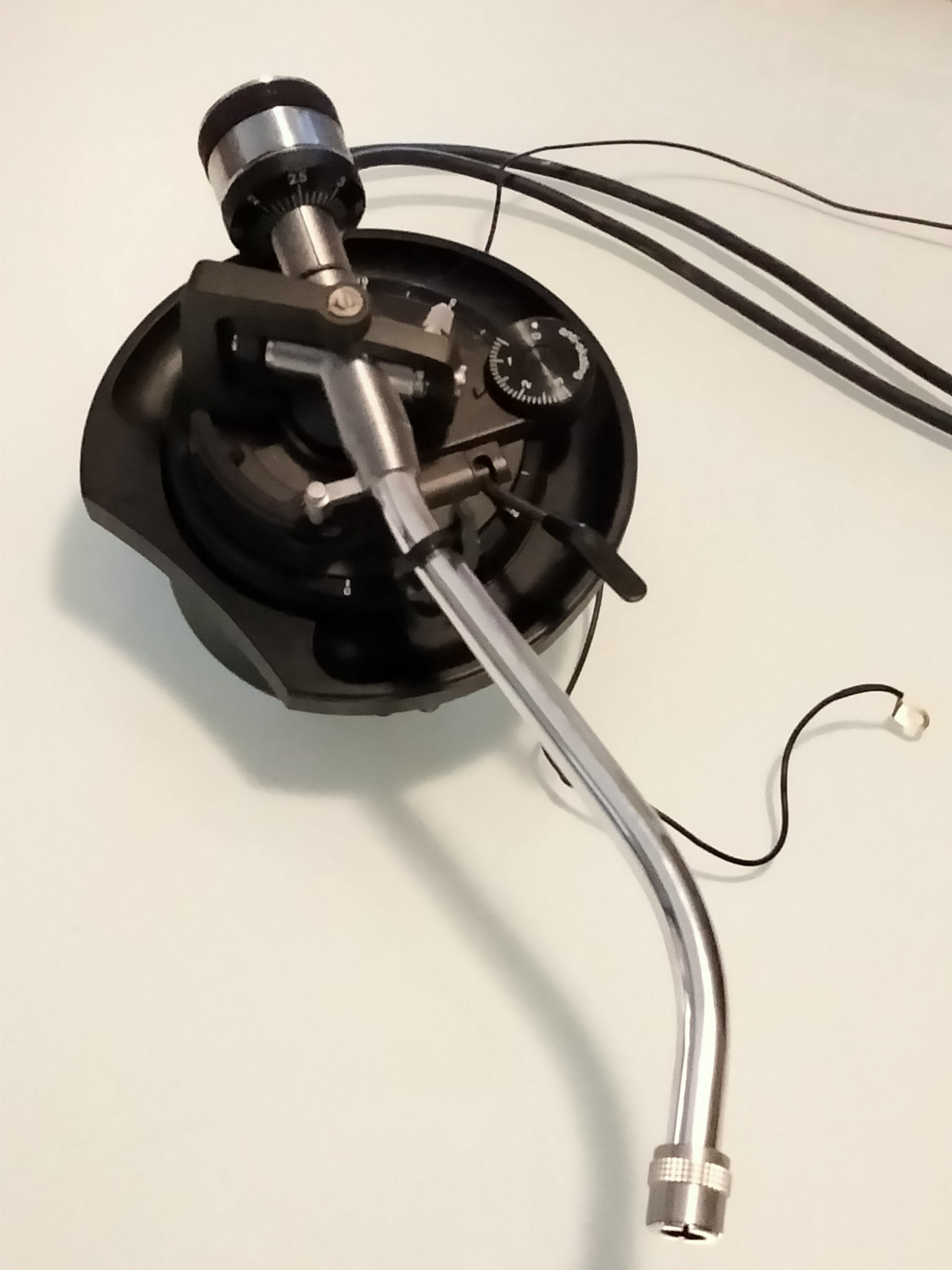

Has anybody here experience with armboards for Jelco tonearms? There're some options on eBay:
https://www.ebay.it/itm/332419422821https://www.ebay.it/itm/164454118064https://www.ebay.it/itm/162751810492
And also these:
https://soundsupports.co.uk/product/jelco-armboard-for-technics-sl1200-sl1210/https://ammonite-audio.co.uk/product/technics-sl-1200-armboard-jelco-fit/
Maybe others?

https://ammonite-audio.co.uk/product/technics-sl-1200-armboard-jelco-fit/ Exact fit. I use the 550s

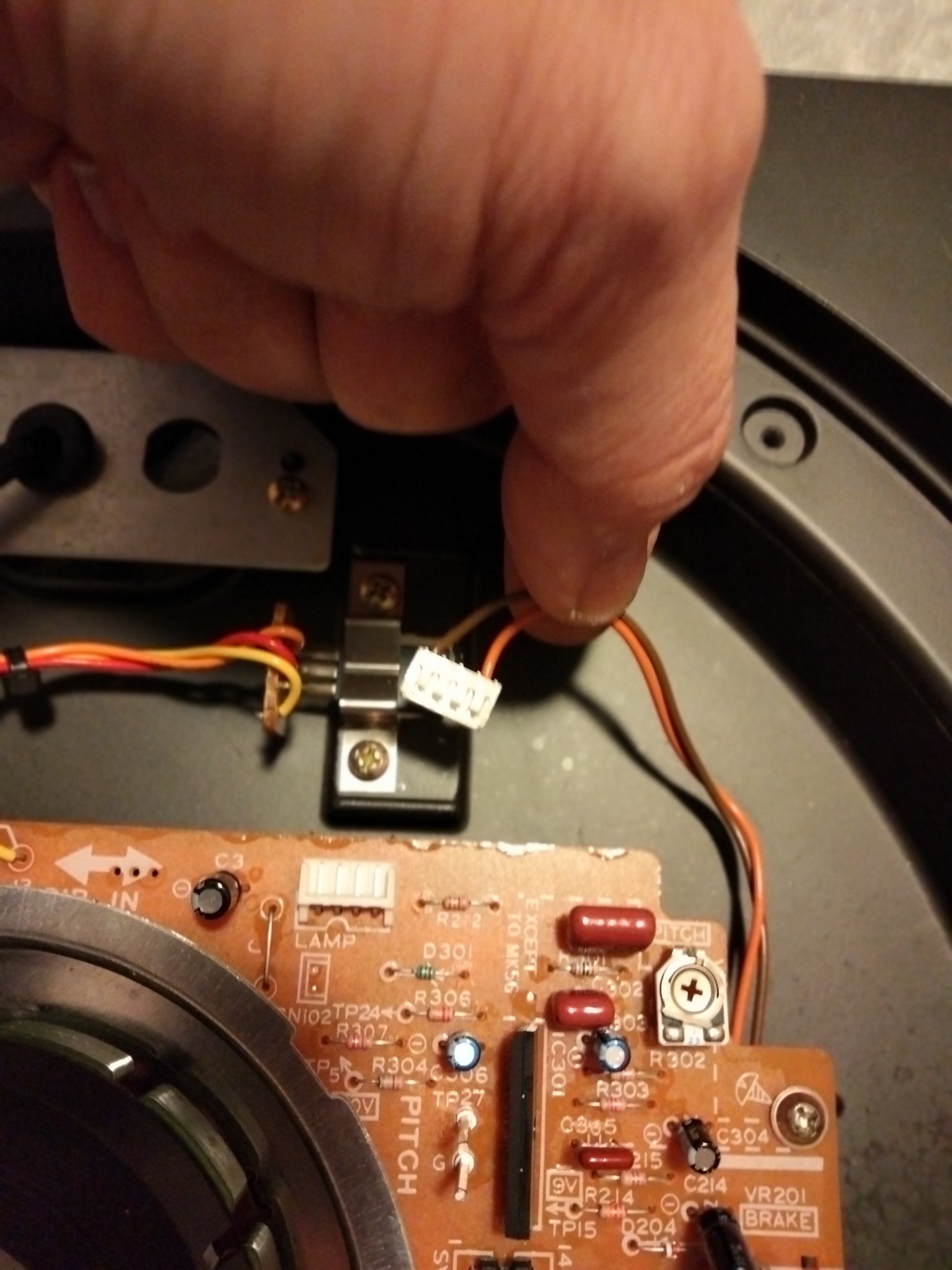

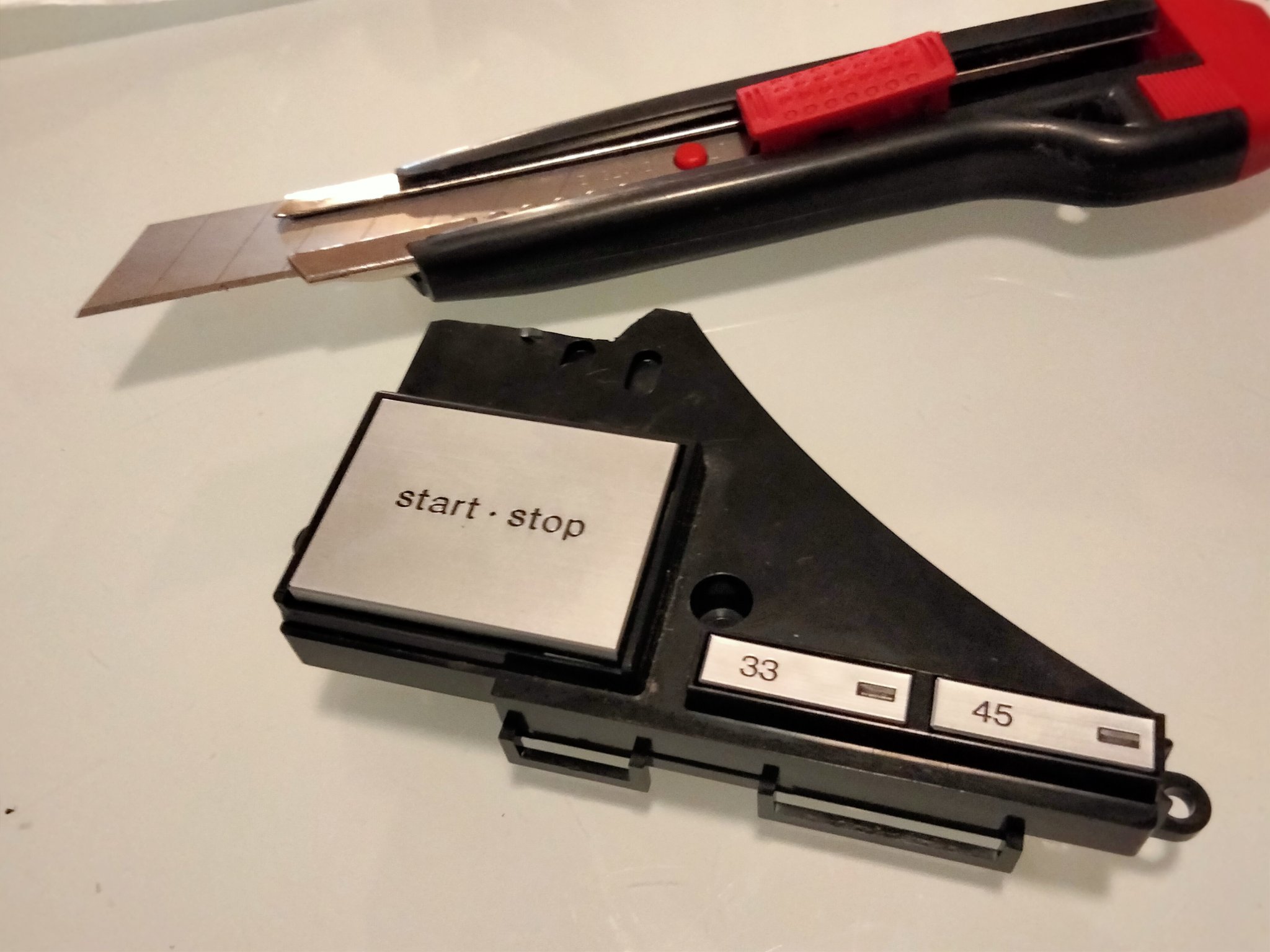

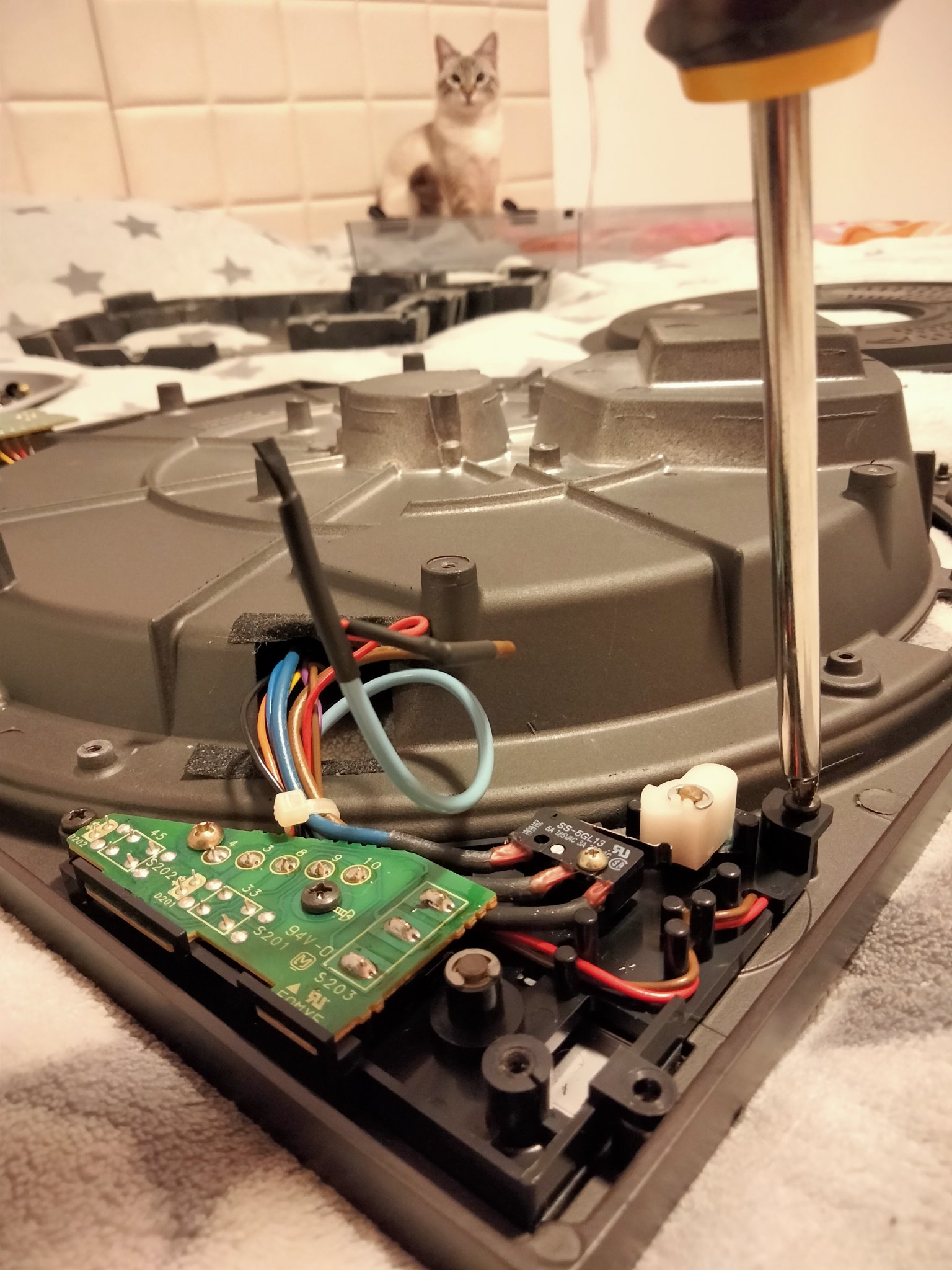

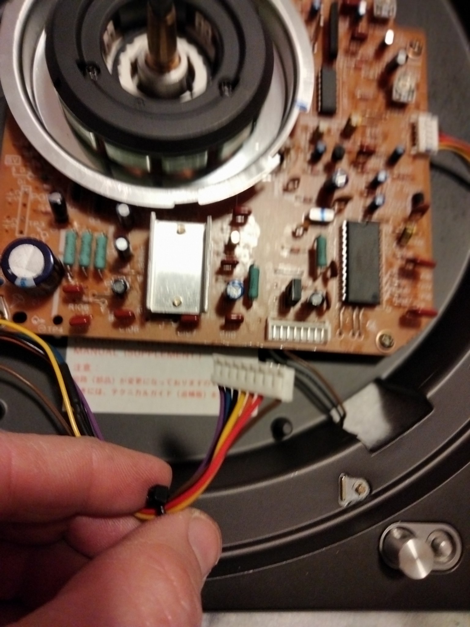

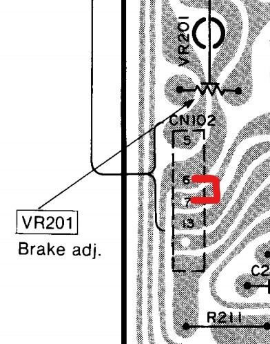

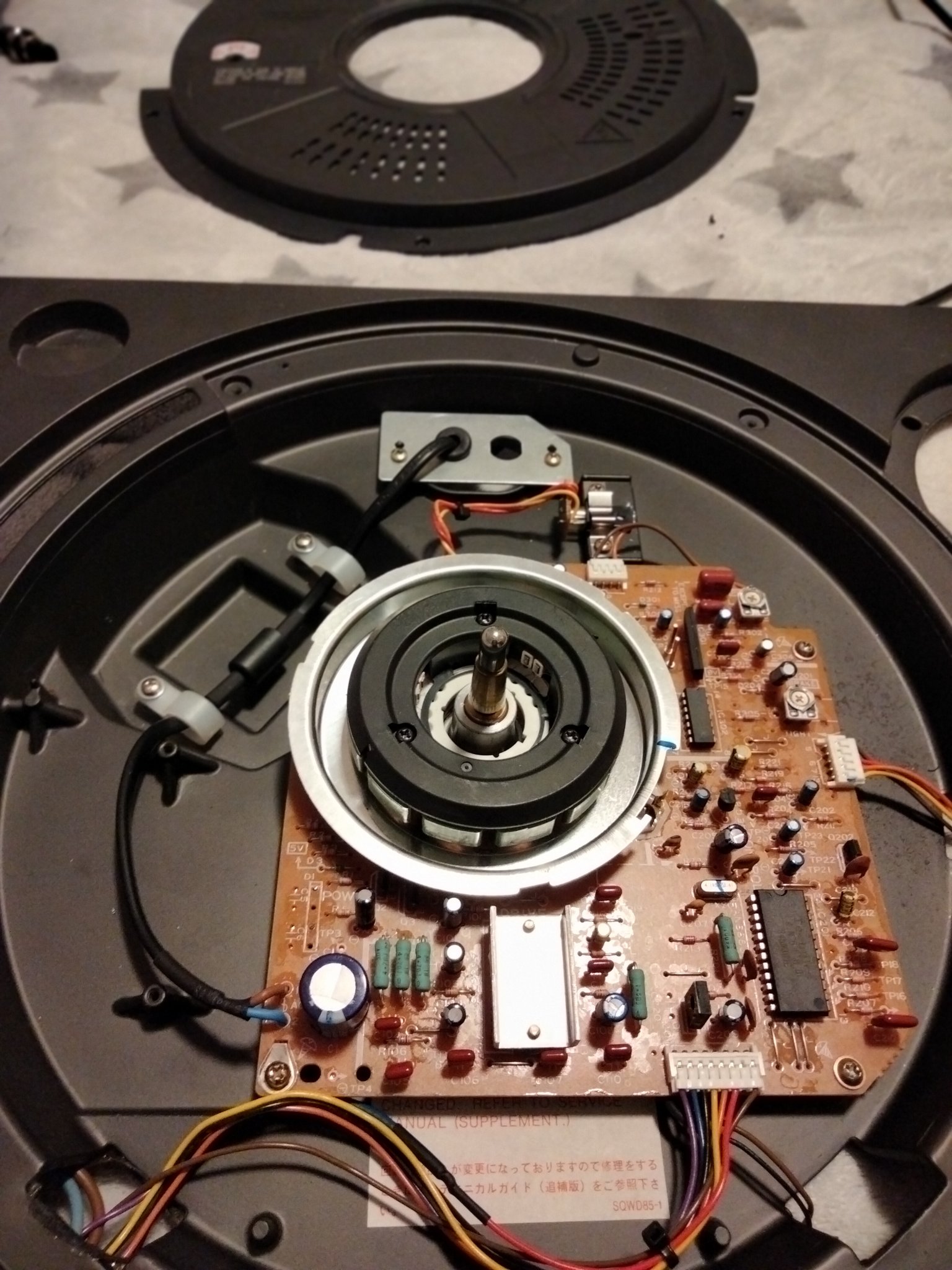

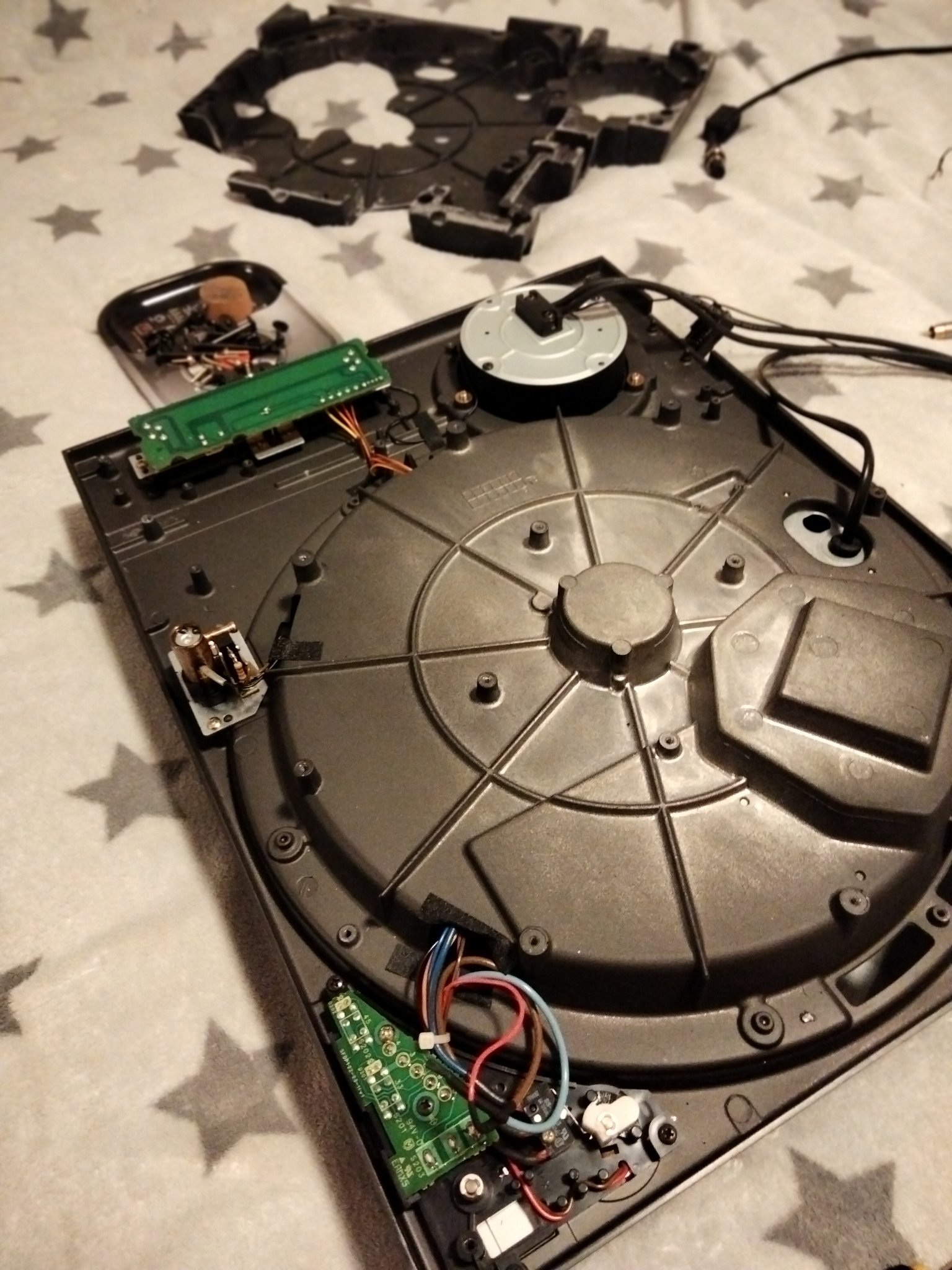

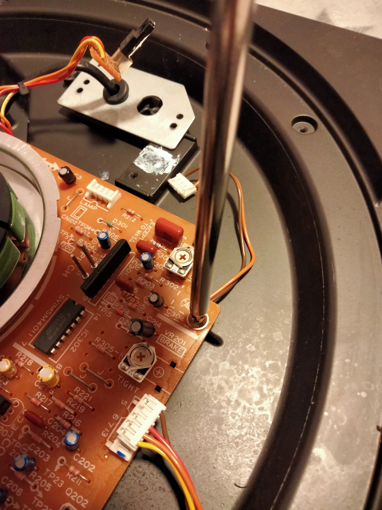

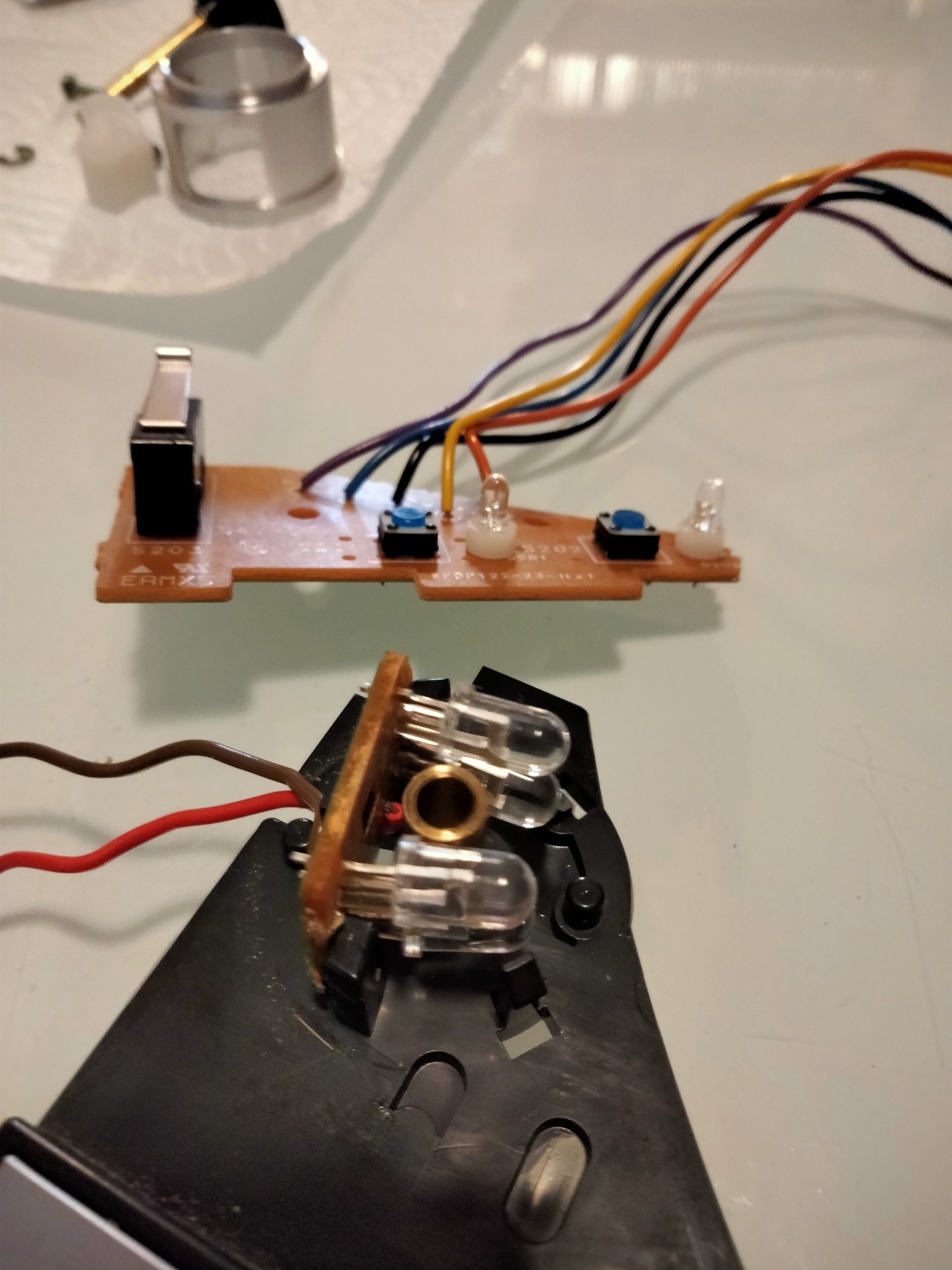

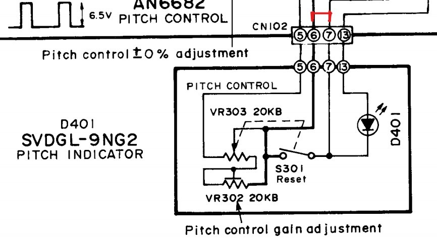

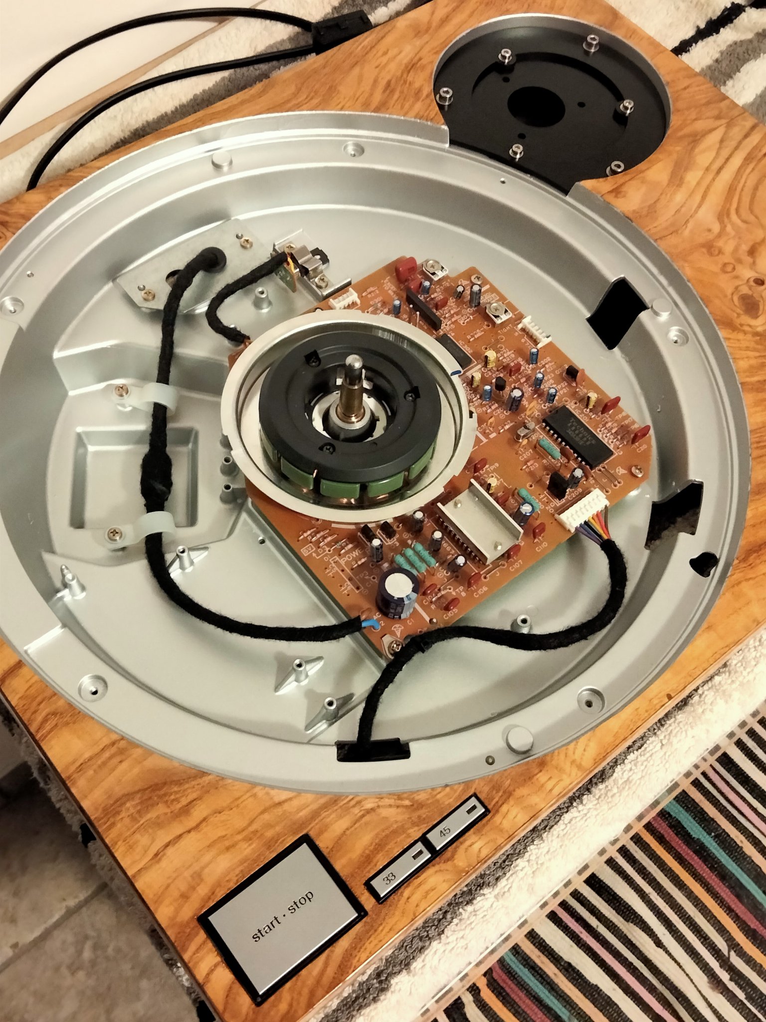

As the Pitch Control has been removed, I need to jump Pin 6 and 7 on mother board (Molex CN102), corresponding on red and orange wires on pitch control:
The jumper has the same function of "Zero Click" on slide potentiometer (reset switch S301). You can solder a jumper downside or put a simple PC jumper on molex.
