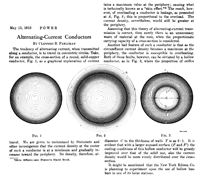

Skin Effect BS certainly runs back to 1913.
I have no idea what "overloading a conductor" is supposed to mean. Apparently not "melting"; anyway we avoid that if only for its increased resistance. Maybe he thinks the electrons start to flow outside the wire at some current density? (Of course there are no electrons, or they don't matter, only fields.)
I also do not see how his hollow conductor has more cooling effect (except very short busses).

Superficially (especially if you think "KA/in"), current can rise as square of diameter. But heat loss (cooling) rises directly as diameter.
Once you get to hot wire, you kinda need to think KA/diameter, not KA/area.
Say you run large current in a 1" wire and it gets as hot as you think is wise. Now you need to run twice the current. A 1.4" wire has twice the copper but only 1.4 times the surface area. It will have a 1.4X higher temperature rise: too hot! What you want is twice the copper *and* twice the surface area. This leads to a 2" wire with a 1.4" hole in the middle so you are not buying 4X the copper, only 2X. (The illustration in the May letter should have shown this larger outside diameter.)
There are other ways. Two 1" wires parallel will do, it enough air can pass over both wires. A hundred 0.2" wires would also do, if they were spaced-out for ample air. Any way you slice the copper, it needs to be that 2" diameter with the copper of a 1.4" wire in it. Slicing copper is expensive, but routine. For much ordinary work we use a couple or three standard conductors carefully paralleled. But for HUGE work it may (does) make sense to have copper hollowed-out to give large surface area without paying for all the copper the diameter implies.
And yes, Aluminum is often used for big current because while it is not so good per square inch, it is lighter for the same conductivity and presently much cheaper per conductivity. The downside is more careful connections to foil the oxide film, but huge copper is huge money so there is incentive.
And no we never want conductors *anywhere* near "melting, just a figure of speech (we hope). A real drawback of hot metal is increased resistance. If you figure the dry voltage-drop at 5%, but that increases to 10% at full current and heat, your furnace which should melt a ton an hour is only melting 1,795 pounds an hour and the customer get angry. Yes, we do have examples of "doubled resistance": modern PA loudspeakers "can" survive power level where their voice coil resistance doubles. Of course voltage-drive sensitivity falls off, though on high efficiency speakers not to half; and this is hotter than any wise user will drive them, more to reduce sudden failures which spoil the show. And as you say nearly all connectors suffer from thermal cycling, and most cable is rubber/PVC which melts a lot-lot easier then the metal.

The skin depth of copper is 8mm or so at 60Hz, why the 2" thick walls?
Skin effect is hardly important. As discussed, when wires get hot, you need *surface area* more than *area*.
Continue my 1" wire up to 4". By area, it would carry 16X the current; by surface area, only 4X current. So it can only carry 4X the current, if current is limited by heat. Then you want 4X the copper in 16X the area: you want 3/4 hollow. 3.46" ID 4" OD pipe, 0.27" walls.
That's just an example from an assumption that a 1" conductor gets hot at high current. JN asserts that 2" walls work for him--- he does bigger stuff than I want to work with. The implication is that conductor 2" thick and cooled on one side is about as thick as is worth doing; any thicker is a waste of copper. At some point we could write an equation comparing lateral thermal resistance to lengthwise electrical resistance, then factor in acceptable temperature and cost of metal (of various shapes).
