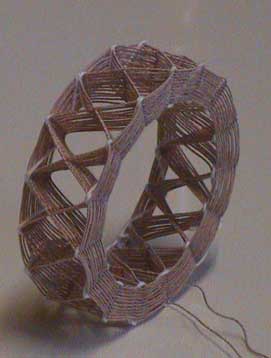

Beautifull wire plaiting was done in "Honey comb coils"
Honey comb coils and how to make them: Dutch Amateur Radio Station PA2MRX.
Being fascinated by audio as sculpture, I just love what is in this link - thank you for making the day brighter. ToS

The aim there seems to be to maximise loop area. Maybe minimise capacitance, or proximity effect?mchambin said:Beautifull wire plaiting was done in "Honey comb coils"
This ends maximizing Q.Maybe minimise capacitance, or proximity effect?
