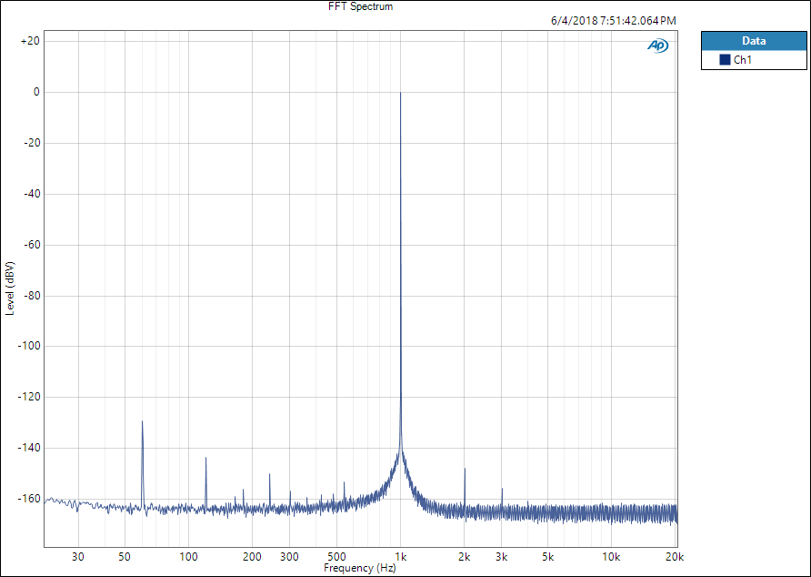

I stumbled across this plot from a few months ago. I bought 20 or so wet slug tantalum capacitors on EBAY.
I followed Douglas Self’s method and tested one for distortion. I put the test inside a rather large grounded NEMA 1 enclosure. There is a non-copper clad 1/8 inch thick piece of fiberglass sheet insulating and separating the DUT from the bottom of the steel enclosure.
You can see that the FFT is at the distortion floor of the APx analyzer. There must be more to the story of eddy current distortion.

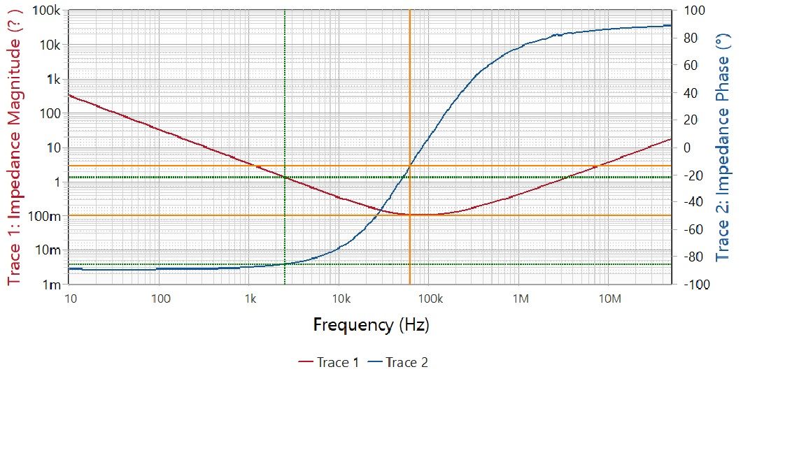

Also attached is a LCR / phase plot.
