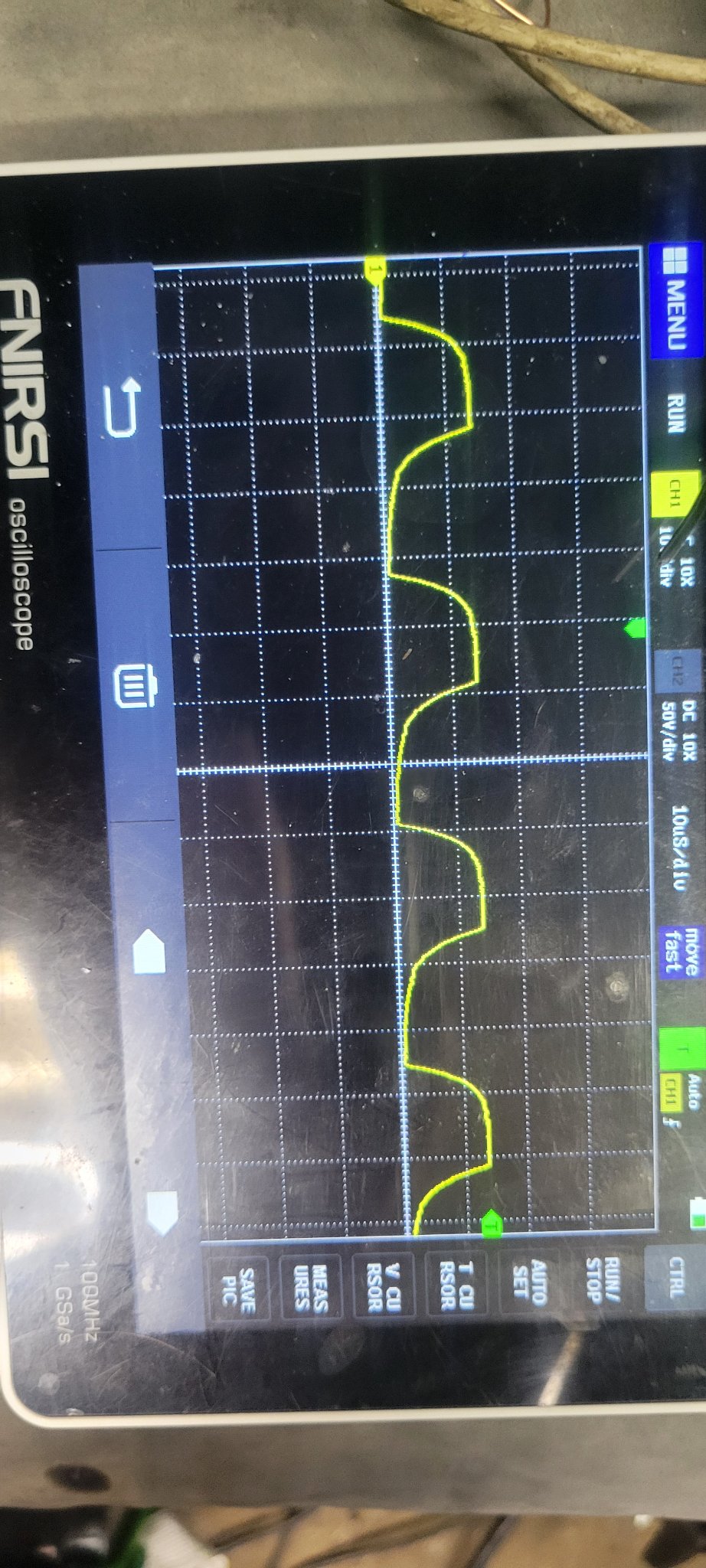

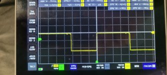

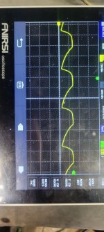

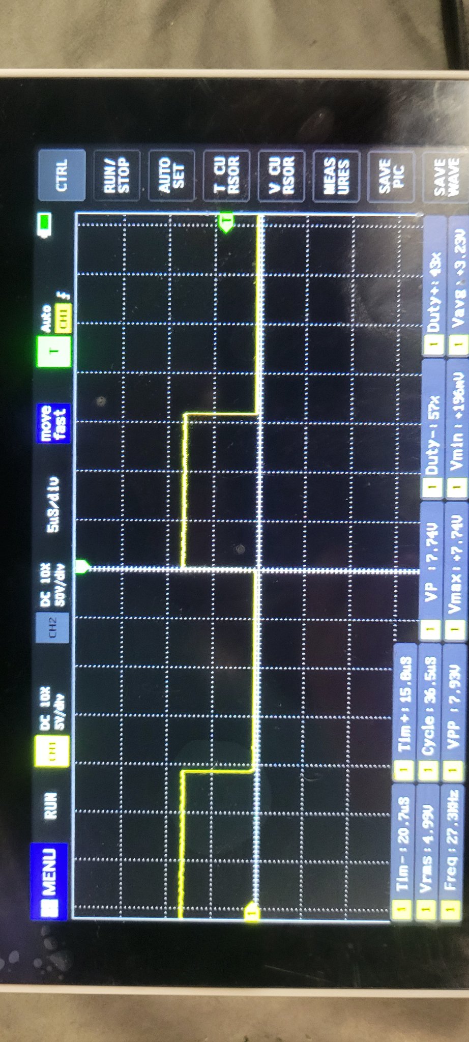

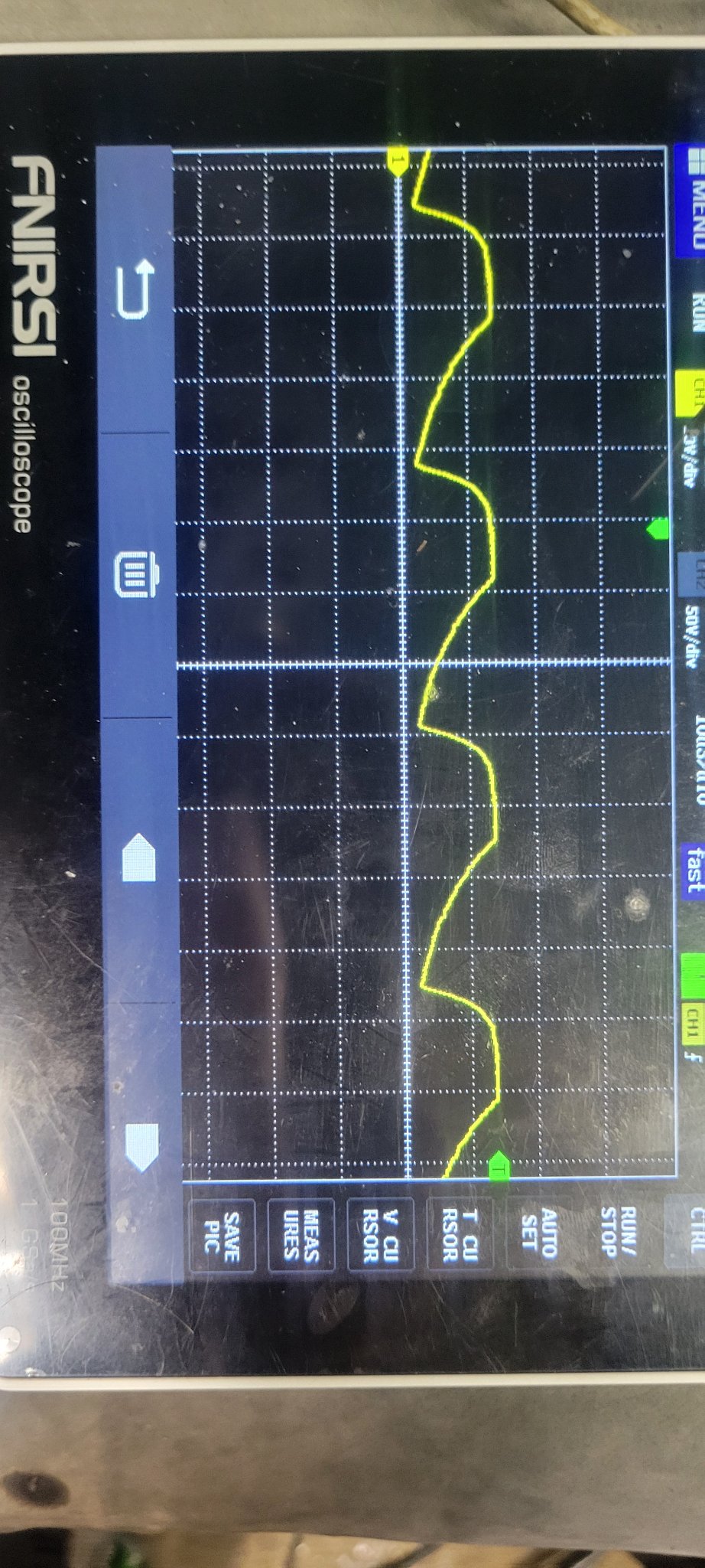

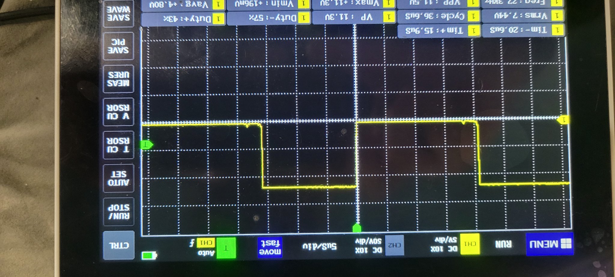

The duty cycles were the same between the two outputs of the tl494 I just thought the off and on times would be even but it's probably just for a safety cusion so they arnt on at the same time. But I have 4 fet pads when load testing look funny. Does this just mean the drivers are bad? Pic 1 is a good load test pic 2 is the funny one. I was load testing with the 47 nano farad cap.
