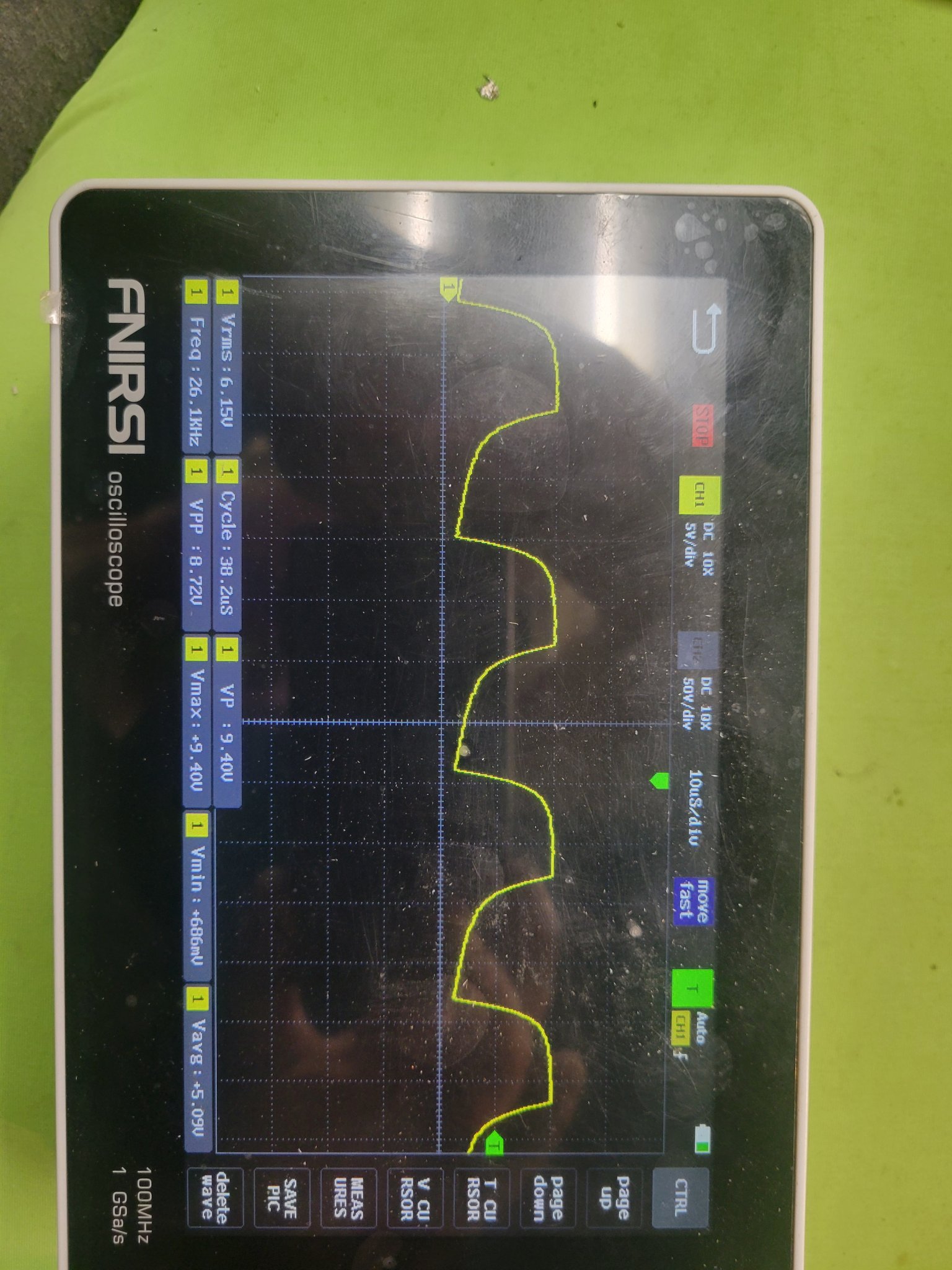

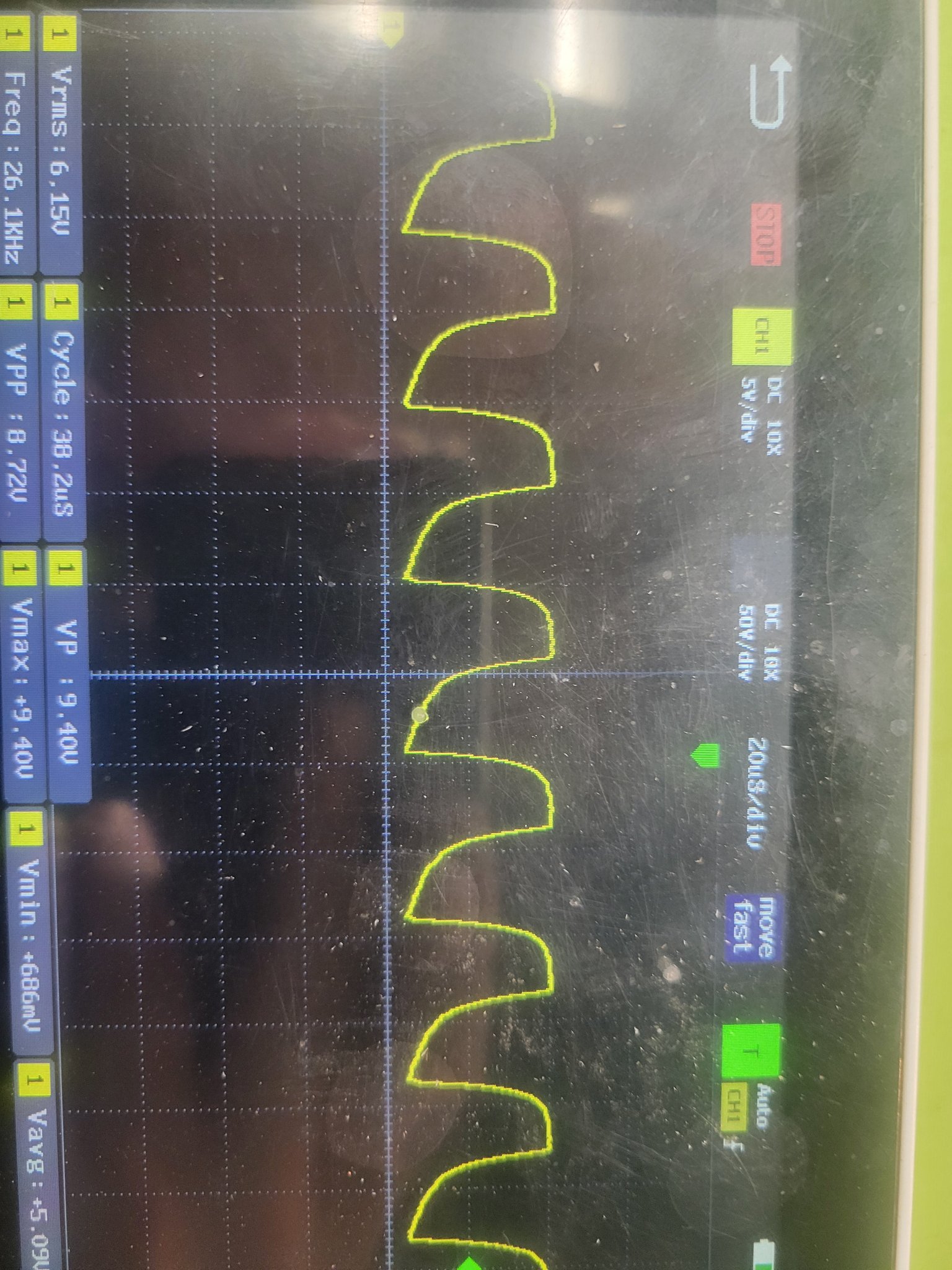

That's fine. it doesn't have to go to 0.000v DC.
Look at the drive's purpose. It's to ultimately drive an N-channel enhancement mode FET. That type of FET requires about 3v to begin conducting. 10v is the sweet spot for driving them on. For them to stop conducting, the gate to source voltage will typically need to be below 2v. That drive signal is going well below that. You get about 3/4v of loss through the drivers but even adding 3/4v to the 0.1v of the 494, you're below 1v and the FETs will be completely off at that voltage.
Some amps have a resistor (R48 on your amp?) between the gate resistor input and ground to help the drive go closer to ground.

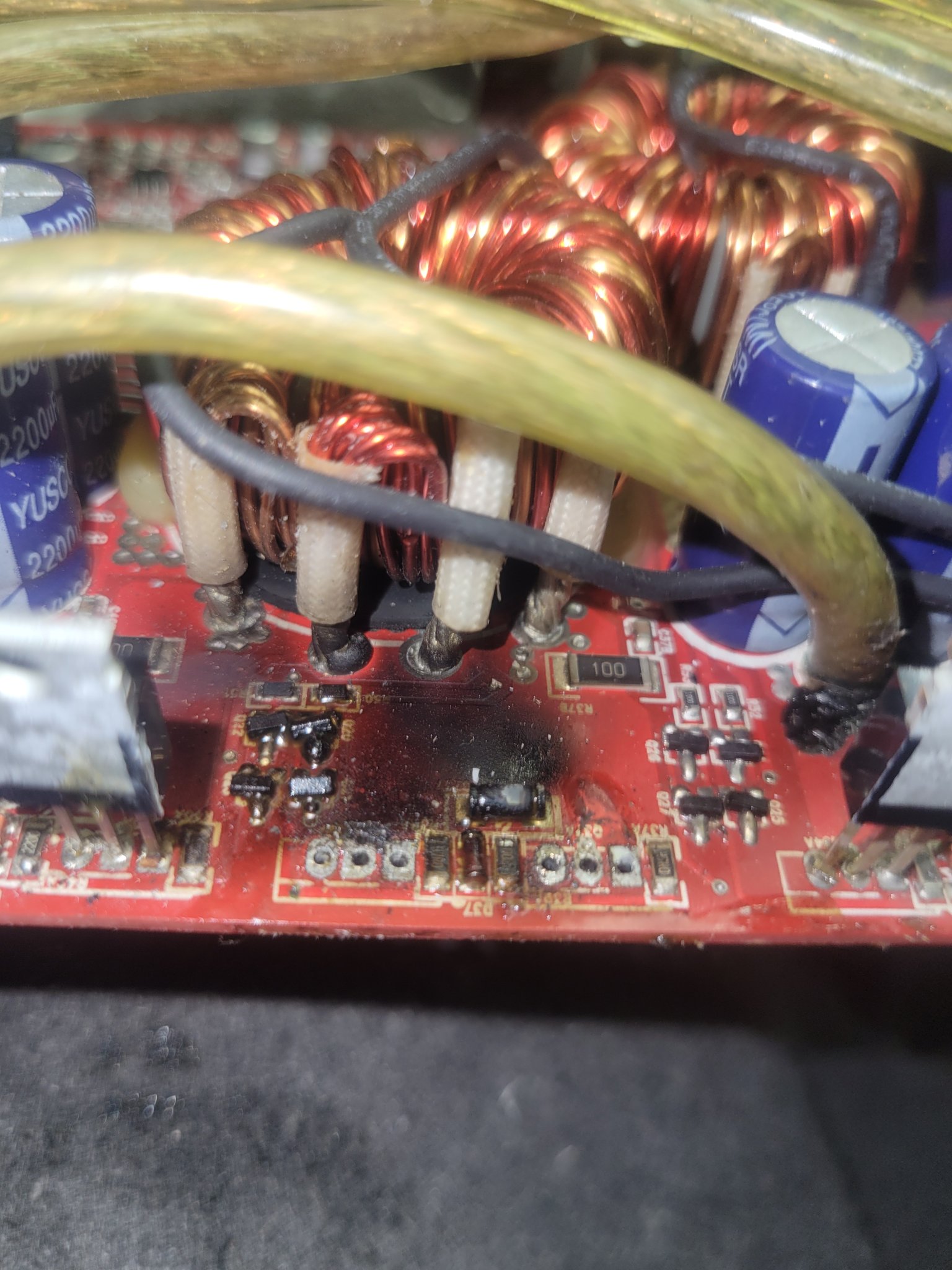

Either bad 494 or drivers... but the amp wont go out of protect.it workrd tjough for about 5min then pop smoke.....
What smoked, the power supply FETs?

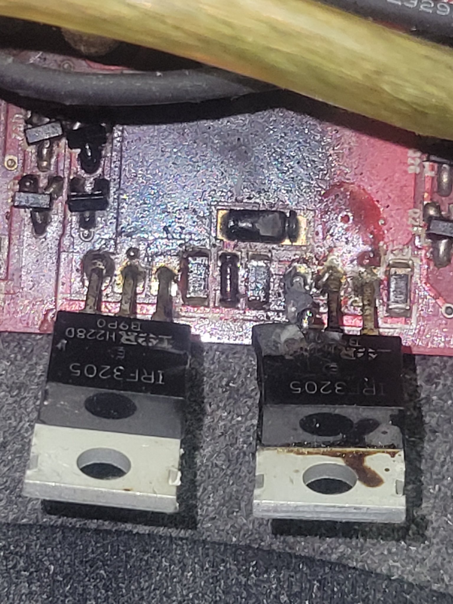

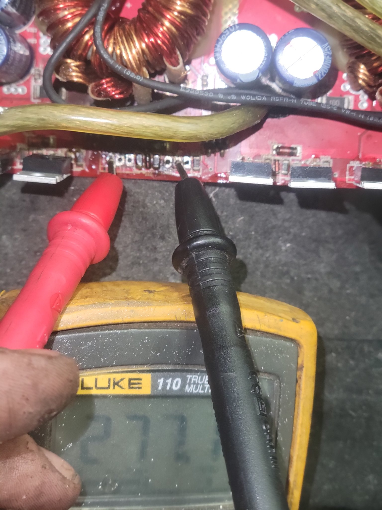

Well only two ps fets burn up and it looks like it burt the zener diodeas well but i have continuty between gate and source and drain and source pads it starts at 100ohm then the capacitors charge and it goes up to 600ohm. Is that normal? It would have surly burnt all fets if the drive signal was not norm correct?theres got to be a reson why these two burnt...drivers? Let me know thanks
