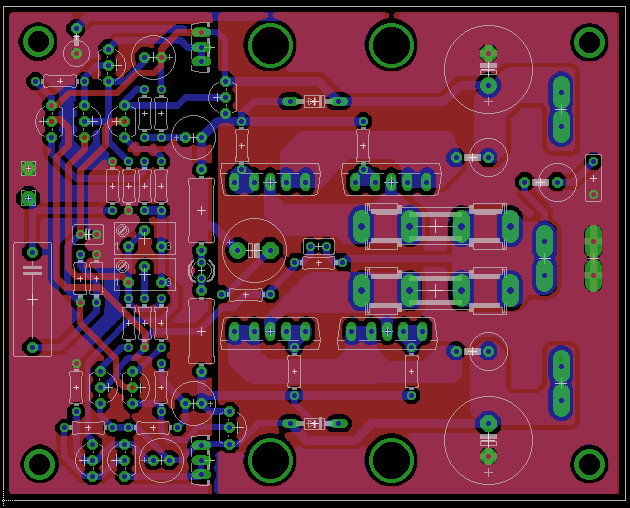

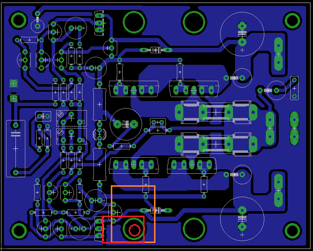

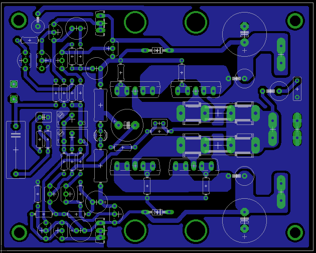

Wouldn't it be a good idea to mount the thermal sensing transistors in the CCS closer to or between the output mosfets?
D
Deleted member 148505
I think this is ok. Sensors can be mounted alongside with the mosfets.
Size is reduced to 3.05" x 3.875"
Since this is difficult to etch, I'll also give the gerber file once this is finished. 🙂
Alongside the outputs is a poor measure of die temperature unless the heatsink is very small. When a large heatsink is used, the device and mounting thermal resistance become very significant.
Bolted on top or glued to the drain lead is the best way
D
Yes, I changed the layout to make the sensing transistors bolted with the mosfets.

Hi guys, can this amp be designed to drive a very low impedance load (say 0.5 ohms?)
Like my other works, I believe the layout is 100% accurate.
Attached the layout and gerber file. The PDFs and the GERBERs are free for all 🙂

How much power?Hi guys, can this amp be designed to drive a very low impedance load (say 0.5 ohms?)
To drive 0.5R sensibly, the rails would have to be MUCH lower, different output devices as Rds on of 0.5R is too high and reduce the output source resistors to 0.1R or less
This topology works well into low Z loads as it can swing close to rail to rail

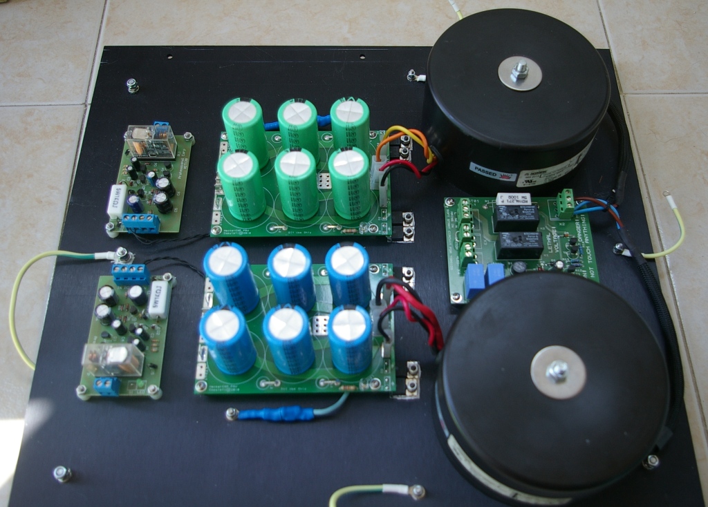

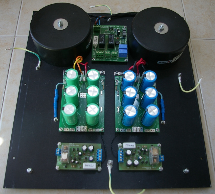

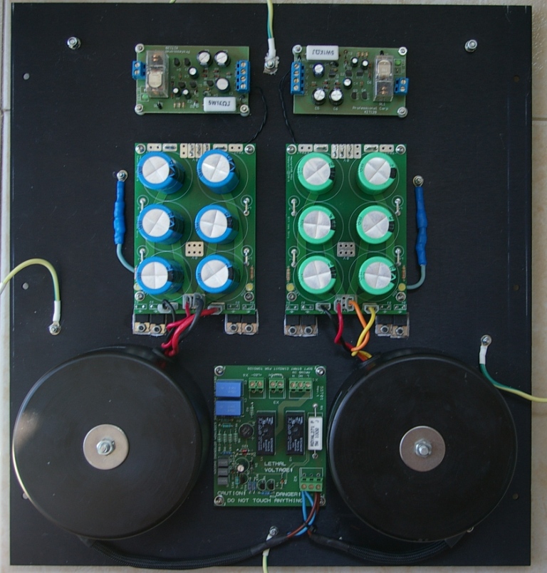

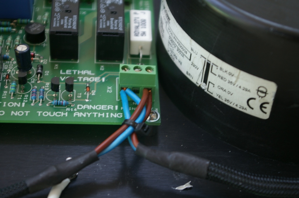

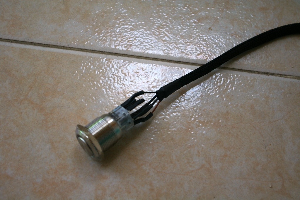

Please check my build
I'm building the GB150D and while I wait for the amplifier pcb's to arrive I started building the power supply section.
I'd like to ask you if my build looks safe and robust. I'm particulary worried about the transformers connection to the soft-start board and the on-off switch wires.
Does it looks fine?
I attach some pictures.
Thanks! 🙂
Does it looks fine?
Thanks! 🙂
