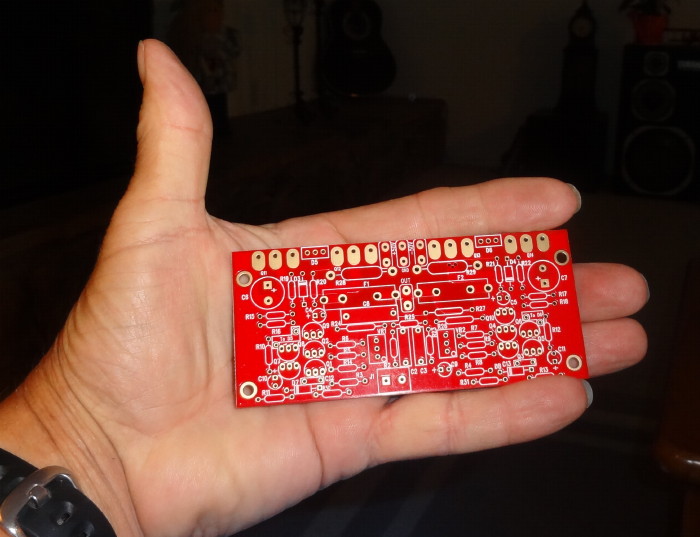

For those who bought the boards I had talked about, I just received an urgent update and you should have too but there is a critical change to be done, Q1 to Q4 uses 2SC2240BL/2SA970BL or compatible (pinout).
According to the author, here's what happened
"I did three versions of layout, one using BC, and the other two using Japan transistor, and I fab the Japan ones instead." ... "but misplaced the BC BOM into the documentation."

Obviously not the sharpest pencil in the box. Rather than design for the very obtainable BC546/556, as Greg did, he designs for an obsolete part. I guess it would seriously affect his sales if he made that known to prospective buyers.
He just told me he has the BC546/556 and can run a batch if interest is there. So if there is enough interest he said he would make it available.
Also, BC556C is not easily obtainable, although 546C is.
These boards are tiny. Where the originals this small? I have found the 2SC2240BL/2SA970BL units on ebay so I guess I'll go that route. I didn't notivce that Greg called out 546c/556c for Q1&2 and 546b/556b for the others. I suppose the 2SN's will be just as easy to source.
Thanks, Terry
From memory they were pretty close to that size.

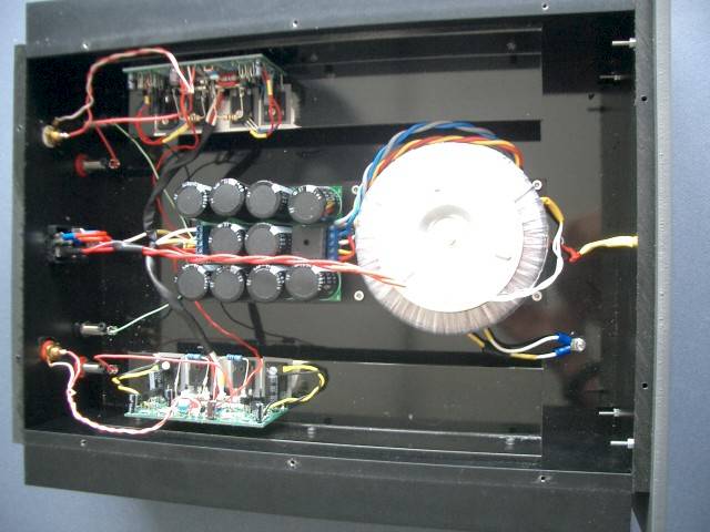

Someone from a dutch DIY forum is selling his SKA 150 .Two completed boards with PSU but without the trafo.It's ready to use he's asking 175 Euro.See pic only the boards not the casing
