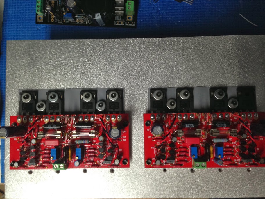

Hi Still4given,I hope to get it working the way it was designed. Paulo seemed to so I have hopes.
I built the SKA with Jim's boards and and I can assure you it works flawless. Be patient and your efforts will prove worthwhile. This is a very beautifully sounding amp! 🙂

I wonder if the Zener mod could have anything to do with it. I believe you used something else.

I used the RCR mod.I wonder if the Zener mod could have anything to do with it. I believe you used something else.
Terry, one thing I can say is that the Jim's board definitely looks as if he has had in his hand a copy of Greg's board, because the layout is practically identical from what I can see. My point being that the traces may even be spot on...negating some of the concerns of bad layout.
I think it's too close to be done just from internet photos, unless Jim is very good. Greg's has a ground plane across most of the spare space on the top surface of the board, but the Jim's one doesn't look like it does. Other than that, they look VERY similar.

Pinnochio, would you be better off removing the insulator from under the diode connected BD's (temp sensors) so they'd thermally couple more efficiently? They don't need electrical insulation.

I haven't seen Greg's board. For sure it is not an exact copy since it uses SC2240/2SA970 in place of BC546C/BC556C. They have different pinout so the trace layout has to be different. Paulo says his plays perfectly so it is probably some of my components that are causing the problem. I see pinnocchio used all Deans for his resistors. It will be interesting to see if that is audible. My parts should be here Tuesday so I'll see then if it is a parts issue.

You know the design is going to be sensitive to layout when the feedback compensation capacitor is specified as a small value and in a narrow range. The pcb parasitics and component intrinsic capacitances and inductances are going to be half the compensation story. Jim's Audio (who are the owners of that business ?) tried to clone the pcb by using the same parts layout (probably violating copyright at the same time) so that pcb parastics are likely to be close to the original - except for use of ground plane ?

You can try the RCR mod if you wish:
Take out the 15V zeners and use these values for these resistors: R11, R13=100k, R30,R31=330k, Keep C12,C13=100nF.

I will try that. One of the boards i have doesnt have the zeners installed because I ran out of 15v zeners. I will swap out the resistors on that one when my BC556B's get here and see if there is a difference.
