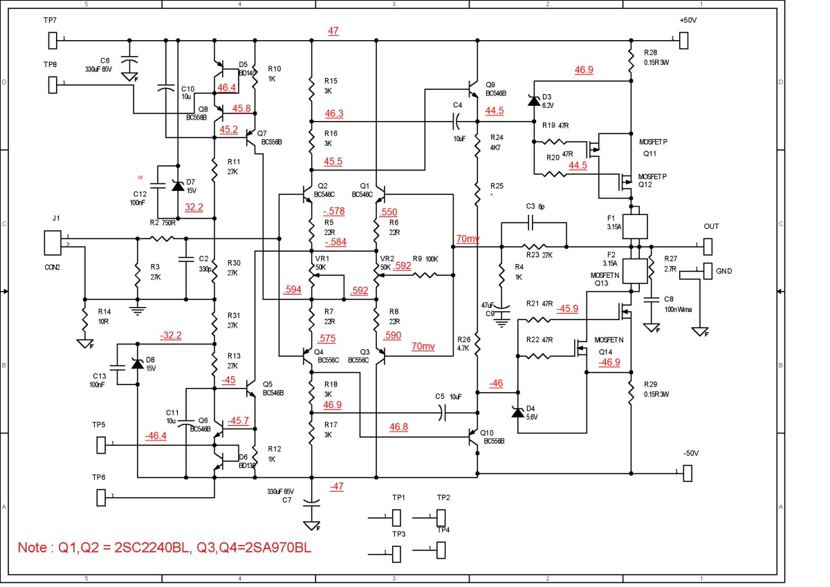

You still have a problem with Q7. Look at Q5 and Q6 where you have 0.4V drop, which is due to the Vbe junction of Q5. See that the voltage Q7 and Q8 is identical, therefore the base-emitter junction of Q7 must be shorted.
I suppose you could be right but I did replace Q7. Looks like Q8 has the same voltage on all three legs. Could it be Q8 is shorted? I will replace Q8 first and see how things look. If no change I will replace Q7 again.
check the voltage across R4. It should be passing zero current and thus should have zero Vdrop.

OK I got a chance to change out Q8. That has me closer but I still can't raise the bias. Bias is .013mA at the rail. VR2 has to be all the way up to get the offset down to 63mV.
I have posted a new schematic with the voltages I have now.

Please check r6.
I see, vr1 should be shorted for zero bias current, I was wrong.
Sorry, I had it noted incorrectly, Q1 emitter is -.550.

Looking at it again, Q10 looks suspect. Collector and base have same voltage. Q14 is the MOSFET that shorted. It would make sense that Q10 could be damaged. I will change that and get back to you.

Great news, that was it. I just replaced Q10 and now all is well. Now I just need to look back through and see what I had the bias set to. Thanks to all of you for letting me work this out here. Now I can finish my case and get this thing melded into my system.

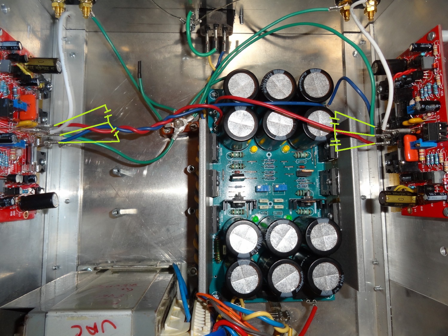

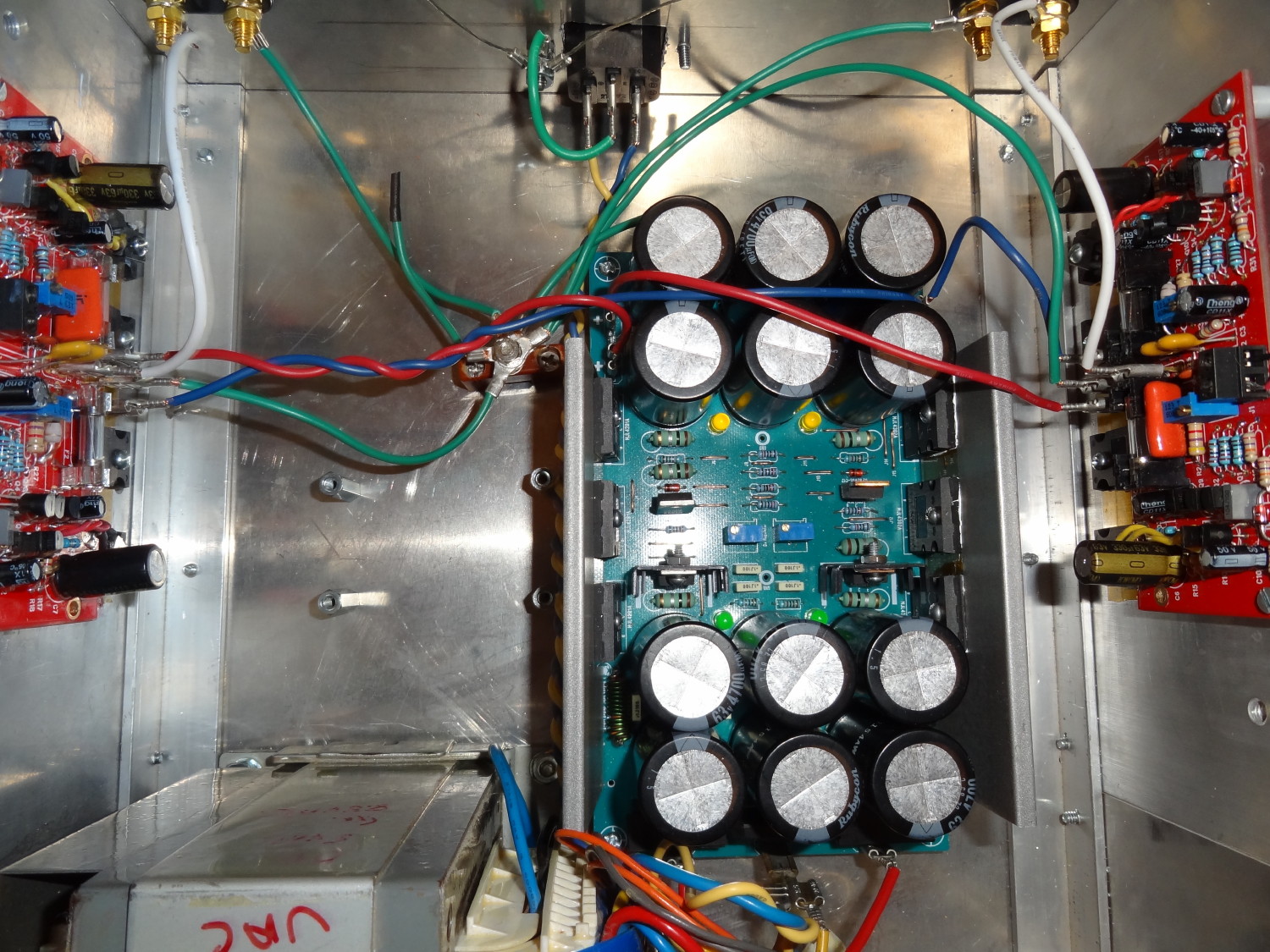

Something weird is still going on. It played "OK" for a while with a stand alone CD player but when I plugged in a preamp and turned it up the power supply fuses blew. I may be that I am creating some type of electric field or something. I replaced the fuses turned down the volume and gave it another try. After playing for a few seconds it will start making a sort of sizzling sound. If I pull the power cables from either one of the channels it plays fine. It also played fine when I had the heatsinks laid flat on the work bench with the power supply in front of them. Tomorrow, I will run some longer wires so I can route them around the end of the PSU and see if that cures it. I have included a pic of how it is presently wired.

Try to decouple supply wires by 220nF capacitors. Because of MOSFET sources coupled to rails the two channels interfere.

I'll see if I have some 220nf caps. I wonder why it worked perfectly on the bench? Seems one channel is more sensitive to bias adjustment than the other. Thanks for the suggestion. I will try it out.

Look carefully at the earthing, this is one bit of wiring that probably changed when you moved it all into the chasis. I can't see from the photo what exactly is connected to what and to where. But any speaker currents that end up on the signal ground will be bad news. And earthing also includes your mains house wiring so you will want to have an earth loop break somewhere. The fact that the mains house wiring is part of the earthing can influence stability when you plug in and out the source into the RCA inputs. If you can post a clear diagram of your wiring scheme the clever chaps here will likely spot anything out of sorts.
You may have something there. When on the bench there was no earth ground at all. I used only a two wire cord which hooked to the primary of the transformer. The only thing earthed right now is the case and the shield on the input cable but the shield is only connected to the case. In the picture I posted, the green wires are the the circuit ground.
I do believe that the preamp leads are earthed at the preamp so that may be the issue. I will have to rethink this.
