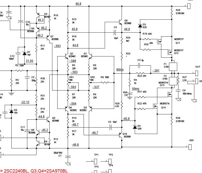

Hi Guys,
I need a little help. The amp was playing fine for a couple days so I finally got around to building a case for it and once I had everything bolted in I brought it up on the variac through a light bulb and see the bulb getting brighter so I know I have a problem. Once the rails reached about 25V R8 smoked on one channel so I shut it down and pulled that channel and started testing things and found a shorted IRFP240. Seems somewhere along the way a metal sliver shorted it to the heatsink. So I pulled the two outputs on that board and installed new matched parts and replaced R8. I dropped the bias pot to zero and brought it back up. R8 still starts smoking so I lower the voltage and start measuring things. I see that though R8 is dropping a lot of voltage R6 is not so I checked Q7 and see that it looks shorted so I replaced it. Now R8 & R6 both smoke at about +/-25V. I don't want to just willy-nilly keep replacing parts. Any suggestions for how to test from here would be greatly appreciated.

testing MOSFETs can be tricky, did you check it out of the board? There is gate-drain capacitance, if gate is positively polarized N chanel MOSFET will be low resistance between drain and source. And when polarized opposite it will be open circuit.
For bias adjusting, vr1 regulates bias current. For this topology, when vr1 is zero, current through MOSFETs is max. You should start with vr1 max resistance position.
You should measure voltage R5, R6, R7, R8 and output for further conclusion.
Vr2 is for output offset, start from central position.

Only one MOSFET was shorted but it requires a matched set and I didn't want to go through a big matching session to try and find a match for the good one so I just replaced both with a known matched pair.
I found out the hard way, at the first start up, that VR1 has to be all the way counter clockwise for low bias. You can see that earlier in the thread. I have a feeling that Q1 and/or Q3 have gone bad just not sure how to test for that in circuit. These boards have fairly tight through hole cladding so part removal is tough, even with a solder pump.

OK, so I went ahead and replaced Q1-4 with matched units. I'm not burning resistors anymore but still can't adjust the bias and have 350mv offset the won't change per the trimpots. Obviously something is still broken. Any advice would be appreciated.

Can you measure voltages on vr2, r4, r6 and r8 vs gnd please?

Well, it points to q9 and q10, I would change it also. There was strange breakdown.
This is more than you asked for but here is a pretty complete voltage reading using a lower supply through a lightbulb.
